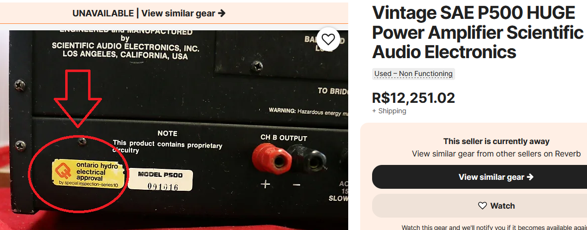

Looking at an SAE P500. I'm very, very uneasy about it since the output transistors are not rated for the supply voltages. I'm blown away they all haven't died, every single one.

Hi Ron,
Canadian market amplifier, shipped to your country. I see those stickers often, it cost the distributor $10 per unit for the sticker and a mains examination.
That approval only covers the mains circuit. It isn't CSA or UL approved. CSA approval is expensive - and sometimes very silly.
