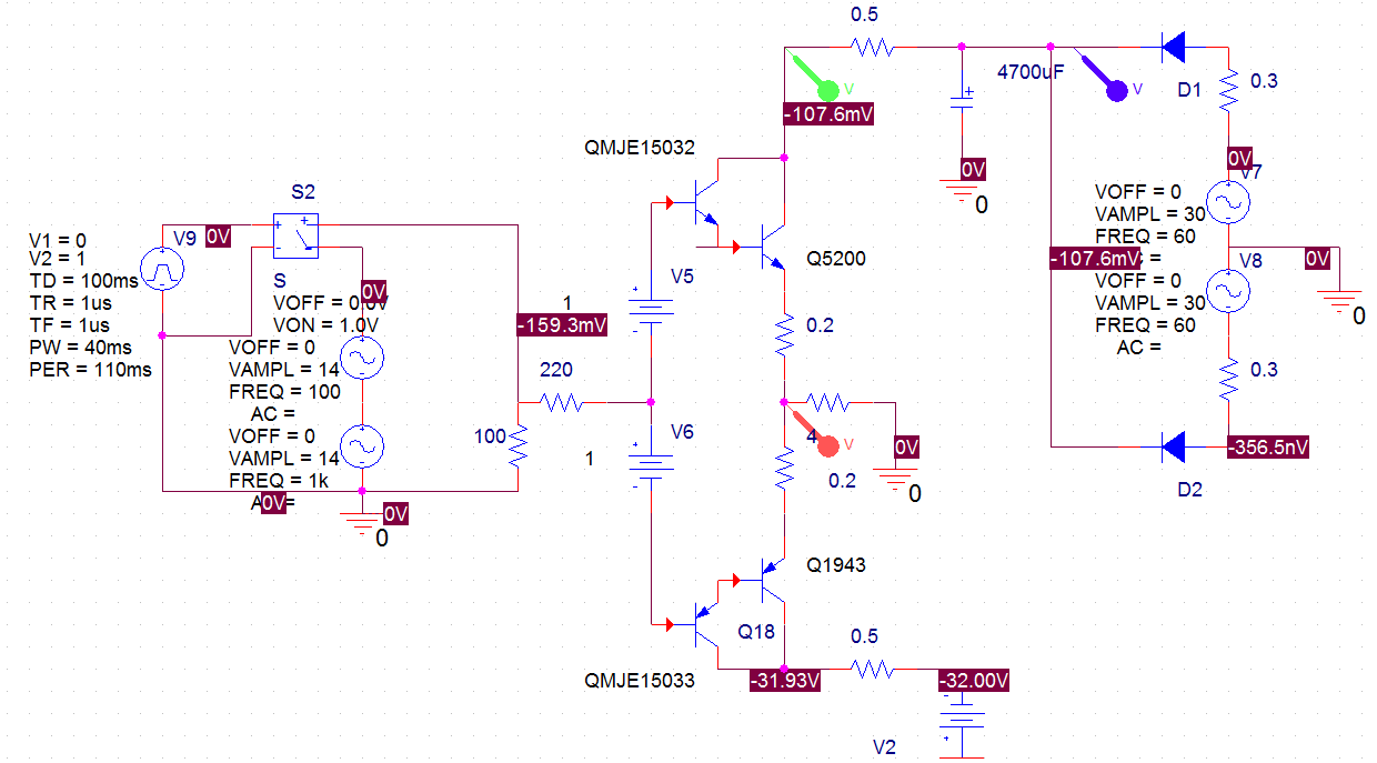

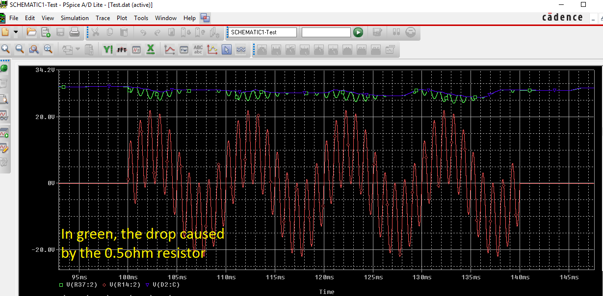

If we introduce 0.5ohm after the capacitors as a way of emulating fuses, cables and connections, you loose considerable power.
A good construction and selection of fuses would not reach 0.5ohm. You have to build with much less total resistance.

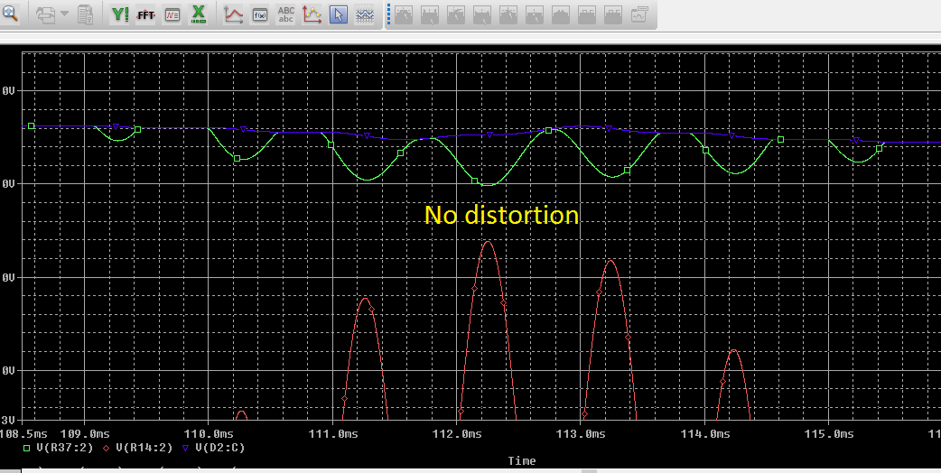

Even though you loose power, as long as the output doesn't get close to the rail voltage, there will be no distortion caused by this resistance.
You can decide to increase voltage and be more relaxed with resistances (less efficiency) or you make the resistances smaller (more efficiency).

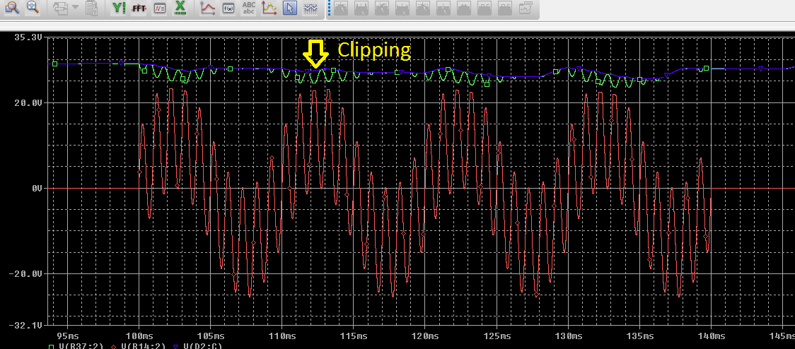

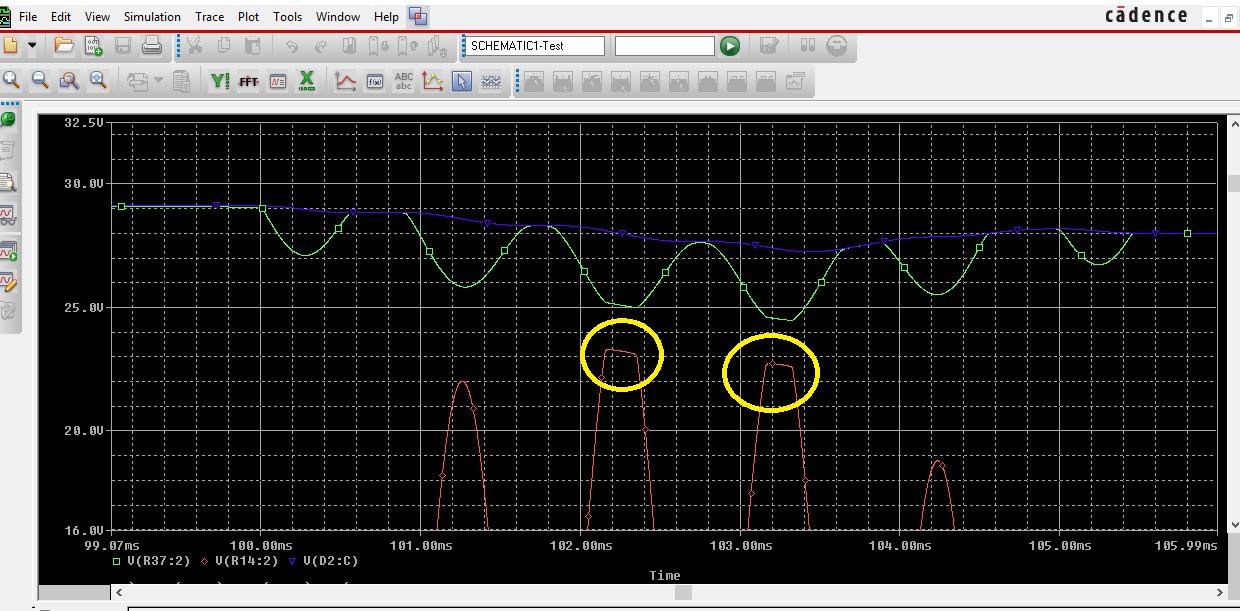

But, as an exercise, let's see the results with this scenario with 2 sine waves 100Hz +1kHz superposed.
In this example, using 4,700uF plus 0.5ohm, you drop from 83W maximum to around 59W without distortion.
Max power 59W - no distortion.
If pushing power a little bit to 64W, you get wave clipped.

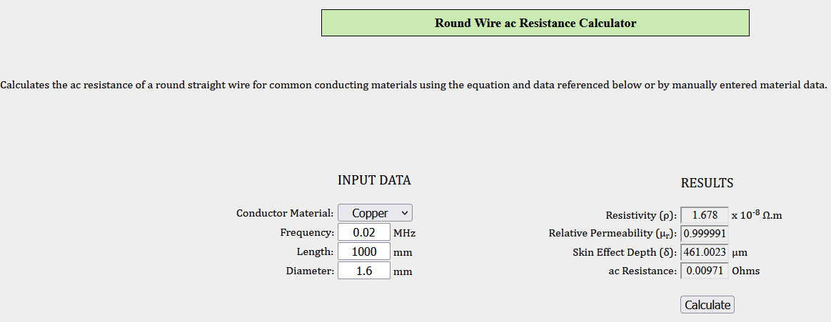

About skin effect, her's the calculation in order to not be just an opinion.
14AWG @20kHz 1m cable will have 0.00971ohms, so very close to what I've calculated from Pirelli cable 0.0088ohms.
