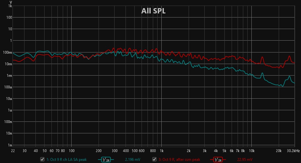

Today I run something that can change picture on one subject: overload margin.
Personally I believed in it all the time, now I measured, and it confirms with small test.
Test song is Strange Angels from Laurie Anderson, 1st from A side. This LP (original Warner Bros issue from 1989) I bought new at time of issue and is being played a lot, it's not a perfect LP by any means, but not worst neither. In any case I choose this as it is somewhere in the middle between new audiophile records and overused - misused scrap, this LP is kind of thing we like to play, glorious music of choice but not an audiophile record.

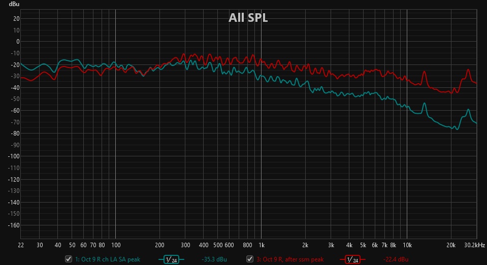

On the picture below are one song peaks recorded from beginning to an empty end, including stylus being placed and removed.
Red: measured straight at points A and B (post #399 above), just x 1000 x 2 gain of first phono stage
Green : final signal after complete preamp (added passive Riaa + 20db gain), ready to listen
What I want to say with this little test is: even there is x1000 x 2 gain (2x ssm2017 with gain of x1000 in opposite polarity) , there is still no way to reach overload in HF region whatsoever.
Soon I will run the same with different variety of LP's to confirm, but Im kind of sure that x1000 or 60db gain directly after MC cart with 0.xx mV output will do no harm, instead just improve SNR of total system

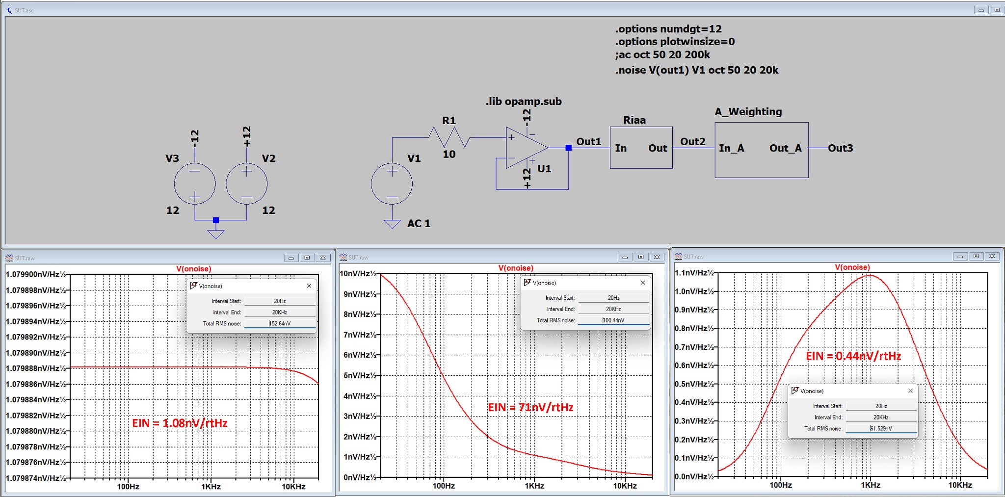

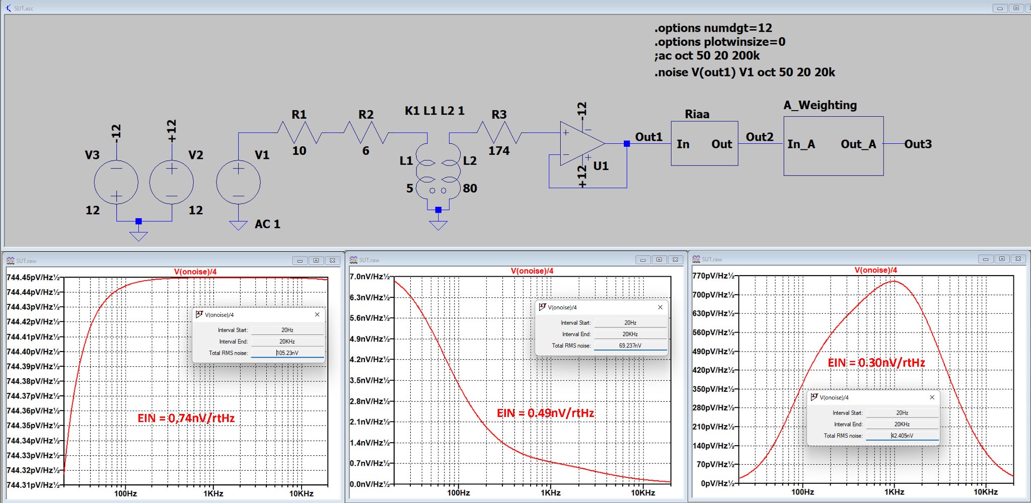

As promised, I've simulated a 1nV/rtHz and 2pA/rtHz op-amp with and without SUT with a turns ratio of 4.
For both I have shown the noise spectrum at 1) the op-amp's output, 2) after Riaa conversion and 3) after A_Weighting.
I also have calculated the equivalent input noise, which is in case of a phono preamp the (cumulated noise from 20Hz to 20KHz)/Sqrt(20,000Hz).
My previous computation was pretty accurate, proving that only the 174R is prone to the op-amp's noise current.
So when only the input op-amp is producing noise and what comes hereafter doesn't add any additional noise, a 0.3mV Cart at 5cm/sec@1Khz, will have a S/N of 20*log(0.3mV/61.5nV) = 73.8dB-A
For the SUT version this will be 20*log(0.3mV/42.4nV) = 77.0dB-A
Hans

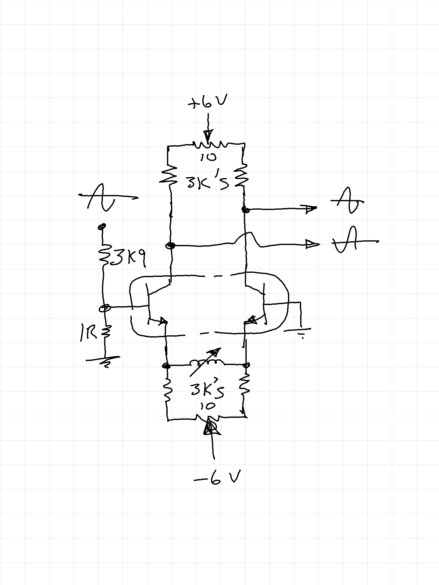

One issue that seems unlikely to be a problem from your earlier dialog in another thread Hans, is the net current flow in the coils caused by mismatched transistors when the bases are tied together. Not that it can affect the sonics, I nevertheless added a 10 Ohm trimmer on the negative lower side of the 3K resistors (not shown below) to allow trimming of the emitter voltages to equality. Although the current balance is upset to some minor degree the potential difference at the collectors is zeroed at the collectors by the upper trimmer.
Of note in this network is that when all resistors are equal (in this case 3K Ohms) with equal +/- supplies, the potential at the collectors is approx. equal to the emitter voltage in the opposing direction or about +0.6 volts. Meaning that the operating voltage drop across the devices is limited to about 1.2 volts for thermal considerations, potentially leading to lower thermal drift. I didn't try this network with the ZTX's though.

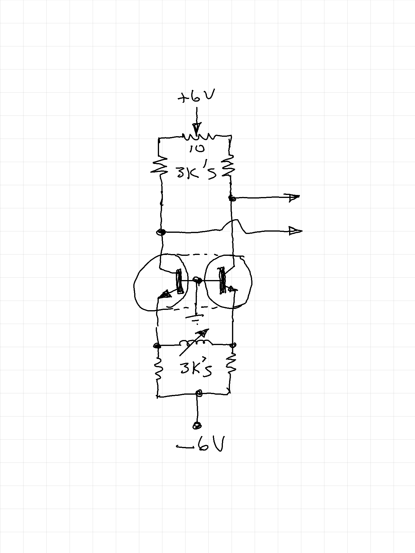

In response to: "Nevertheless this is absolutely valuable question, what is actually coil Z, how is it dependent on frequency, and how to measure all that??? Particularly with trans impedance amps this will matter a lot..."
This was tested using the above network Drbulj. For a square wave signal fed into one side of the differential pair the output was a square wave well out into the 100's of kHz. The coil behaved as a pure resistance even with a balanced interconnect cable attached to the turntable. If the coil had significant inductance or was capacitively loaded the response would changed from seemingly ruler flat. There seems no issue at all. By the way I have left the resistive divider network in for test purposes.

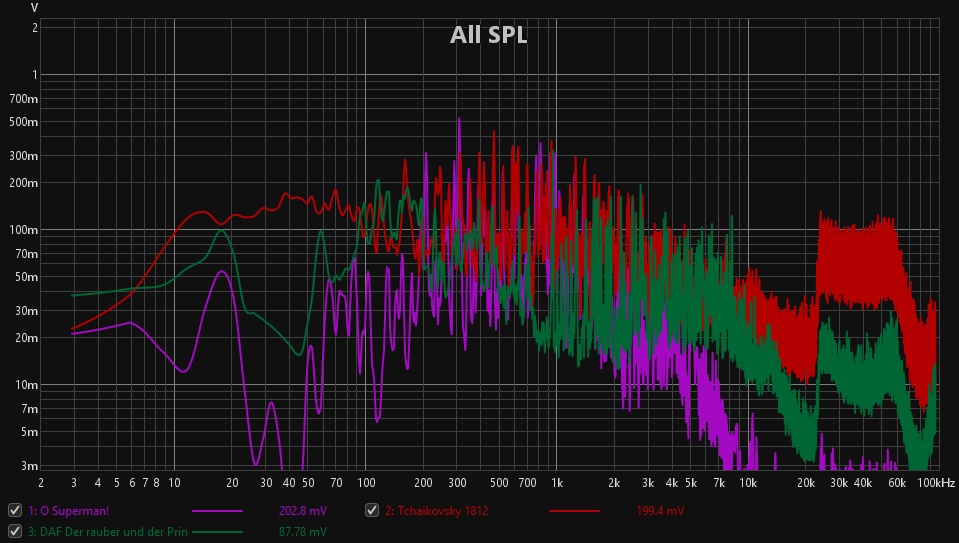

Coming back to headroom testing, I played another 3 records and recorded peaks after 2 x 60db gain and before RIAA.
Music played was :
1. O Superman, Laurie Anderson. (purple trace) @Hierfi , unfortunately I don't have original Big Science, but I do have United States live, 5 LP package. O Superman is from there
2. Notorious Telerac 1812 by Tchaikovsky (red trace), real cannons and real bells!
3. Der Rauber und Der Printz by DAF (green trace), This is little bit of electronic on EP at 45rpm
And traces:
Please note we are not coming even close to 1 V RMS and this amplifier is fully balanced; each + and - leg can easily deliver say 8 V RMS giving total of say 16V.
What clipping? What exactly one needs to play in order to clip preamp? Particularly in HF region, max signal at 10kHz was 55mV (bells from 1812)
Please let me know what you think about it, for me so far it looks that overload margin myth is busted 🙂
Drbulj,
I probably missed it, but could you please repeat what exactly the spectra are showing.
Is it the average sound level over some recording time or is it the maximum level that was recorded.
And what is the bin width of your filters.
When too large, the peaks may well drown in the other content also falling in this filter bin.
So I would suggest to use a filter bin of 1 Hz.
Hans
The barcode is about the date of manufacture, not when the master was cut, nor does it tell you how many mothers have been created from the master. Nor does it tell you who did the master cut - this is something to look up. Check the stamping numbers on the disc, I believe these can provide information on number of the mother. Do you find zebras aesthetically unpleasing?!
Prior to the 16th century "stripes" were considered diabolical. I suspect the devil painted the stripes on some innocent ponies... so zebras seem the devils work... as aesthetically pleasing as god himself could have done... its their eyes and teeth that scare me...
Reactions: Drbulj
Drbulj,
Hans

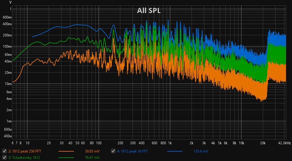

Hello Hans,
Traces are maximum recorded sound levels in the course of recording, peaks.
In REW I couldn't set bin width directly, but via FFT, this is explanation from REW site:
FFT Length​
The FFT Length determines the basic frequency resolution of the analyser, which is sample rate divided by FFT length. The shortest FFT is 8,192 (often abbreviated as 8k) which is also the length of the blocks of input data that are fed to the analyser. An 8k FFT has a frequency resolution of approximately 6Hz for data sampled at 48kHz. As the FFT length is increased the analyser starts to overlap its FFTs, calculating a new FFT for every block of input data. The degree of overlap is 50% for 16k, 75% for 32k, 87.5% for 64k and 93.75% for 128k. The overlap ensures that spectral details are not missed when a Window is applied to the data. The maximum overlap allowed can be limited using the Max Overlap control below to reduce processor loading at higher FFT lengths.
I recorded with 192 kHz ADC resolution, and original post was 512 FFT. Here is picture of captured peaks at 16, 256 and 512 FFT. The LP is notorious Tchaikovsky Telerac with live bells and cannons. It changes, but doesn't change the point I think, we are still not close to even 1 V RMS
Sorry, but I'm a bit lost.
What exactly is a 16, 256 and 512FFT ?
When the bin width is getting larger, the lines are becoming more fluid as in your blue spectrum, but what I don't get is why the orange peaks with a smaller bin width aren't peeping above the blue spectrum or be at least equal in amplitude.
When having a single tone, the level in the spectrum remains the same, independent of bin width.
I don't see that in your spectra.
I find it a bit hard to believe that Karlov and Happ, working for Sure at the time were so wrong in their analysis.
Hans
