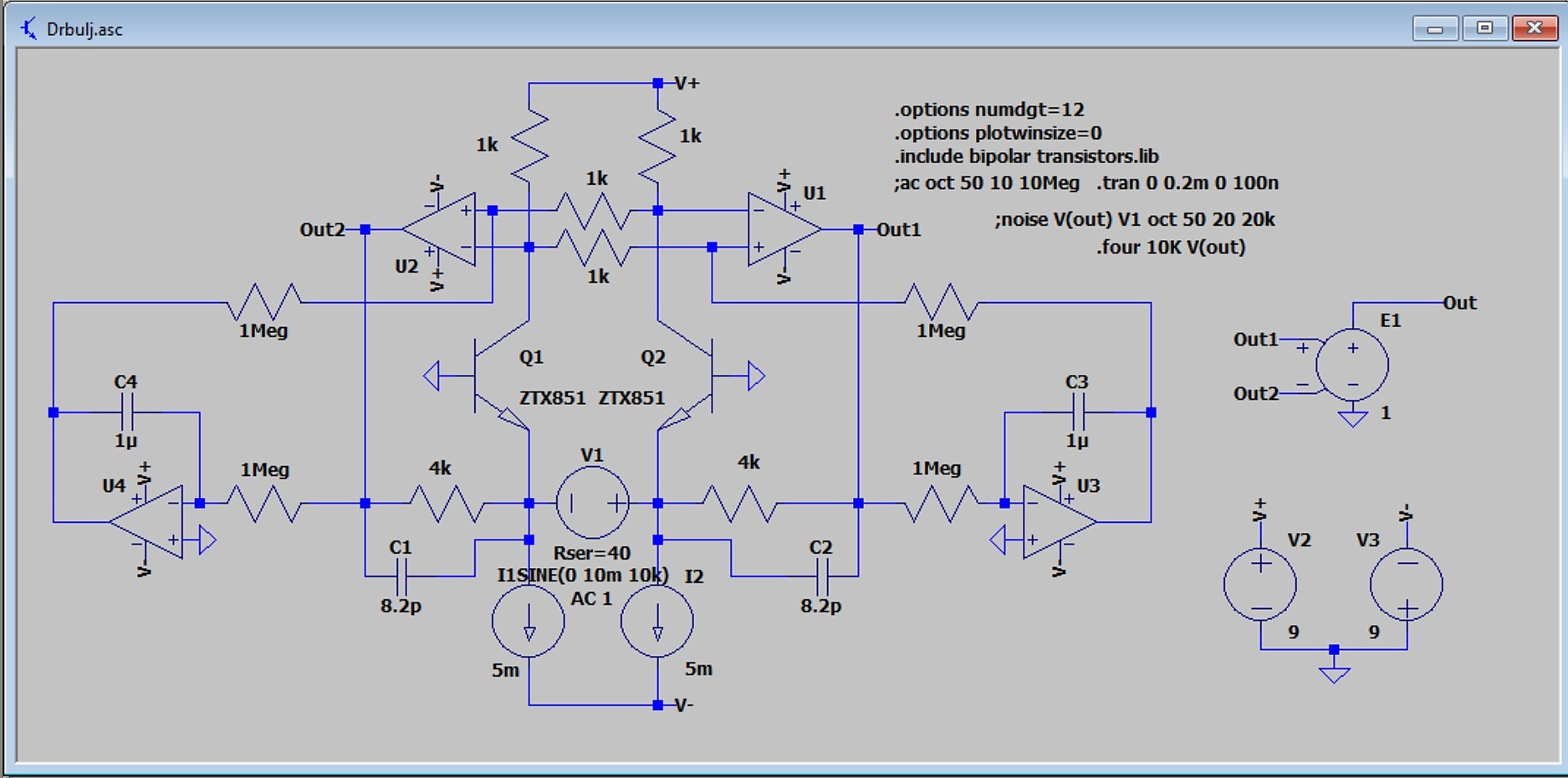

I understand your concerns, and yes the SSM is an fine component to use, ready to go.
Nevertheless, it's sometimes challenging to look over the fence looking for possible alternatives.
And for almost every problem there is a solution, in this case to compensate offset voltages.
A servos will do the job, without affecting noise, Frequency response or causing unacceptable currents from flowing through the Cart.
I'm not defending any solution, just showing what can be done to overcome a possible problem.
In this example with the given servo components, +/-4mV offset can be compensated, a dual opamp like the OPA1656 or even an NE5532 will fit.
A dual servo on both sides is the most accurate but even a single one is already very effective, see attachment.
And yes, the collector and feedback resistances should be tightly matched, not a real problem.
Being "concerned" seems suggesting being overcharged with emotion Hans. Rather, having two amplifiers sharing the same common nodes across their inputs, both operating open loop, just appeared "highly problematic" at the time, and still does. To use trimming components, or alternatively using lower offset opamps as Drbuj suggests, is a patch that doesn't directly address the significance of sharing the same nodes, rather your solution does, as it breaks those direct connections.
Basically I don't use coupling capacitors unless unavoidable, rather DC servos if needed. This is mainly because they can have sonic characteristics as much as cables. Okay... now for my official disclaimer... before the forces of the double blinders descend like resplendent emancipators of the universe... I am completely dillusional... I hear nothing... I hear nothing...

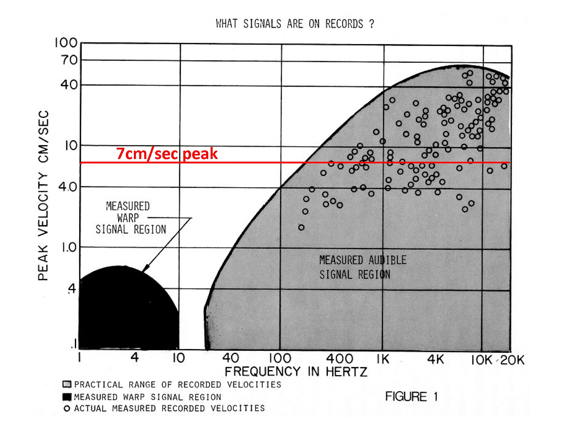

Sure investigated the peak velocity versus frequency on LP's, performed by L.R. Happ
Assuming that the usually 5cm/sec is the rms velocity, if so this can be translated in 7cm/sec peak velocity.
Now looking at the image below with recorded peak velocities as published by Sure, at 1Khz peak is at ca. 30cm/sec and around 10Khz ca 60cm/sec,
Versus the 7cm/sec peak this means a factor 8.6 or 19dB more output at the 10Khz region as maximum peak velocity, this being caused by the anti-Riaa emphasis.
So for a Cart specified at 0.35mV@5cm/sec, this is not the maximum output, because around 10kHz level can go up to 3.0mV rms.
To give the amp some extra headroom for scratches or dust, an extra 10dB margin can be added, thereby increasing the maximum input level to 10mV rms, or almost 30 times the original 0.35mV@5cm/sec.

I think this chart you posted is main picture from Shure document I mentioned earlier. Also fully agree with your comments.
Still, what you also described; 0.35mV x10 (20db increase for RIAA) x 3 (for margin) results in about 10mV RMS, , all good Than if we , as I suggest, apply "mad" gain in first stage of x1000 or 60 db, it still result in worst case at 10 V RMS, not a big deal neither for amplifier if +-18V PS is used, neither for resistors and capacitors in RIAA EQ filter.
Then in practice , these high frequency high level signals cannot be and will not be at any continuation, this can be only an burst of triangle in worst case, most likely an record scratch, so no high power calculations are needed., at least I think..

No need for precision opamps, they will reduce the output voltage to within their own offset voltage.
But because of the 1Meg input resistor, fet opamps should be used.
All dual fet opamps with offsets below a few mV will do, there are several to choose from, speed or noise are unimportant parameters.
