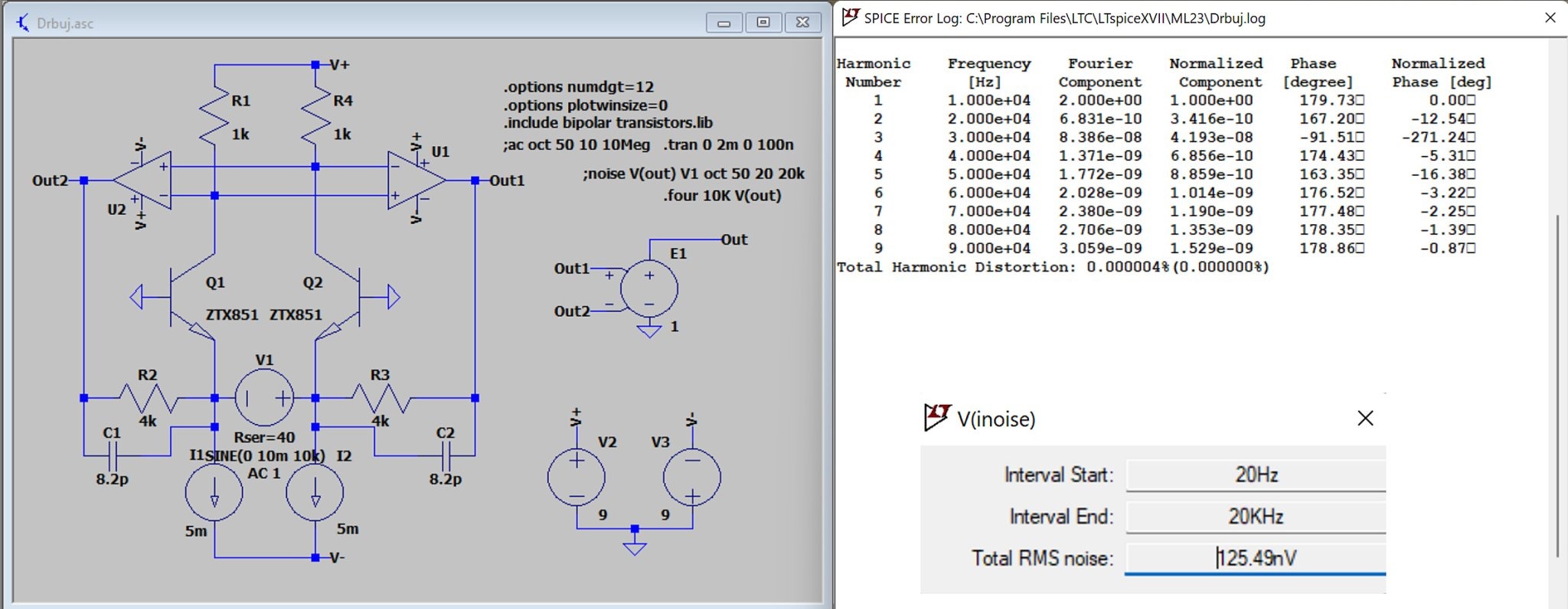

Here are the results with a 40R Cart, still using 46dB gain.
THD with 10mV@10kHz is now even (unrealistically) lower, and noise has risen to 126nV or 0.89nV/rtHz including 40R cart.
S/N is now 20*Log(0.35mV@1kHz/126nV) is 69dB, still very good.
Hans
Hans

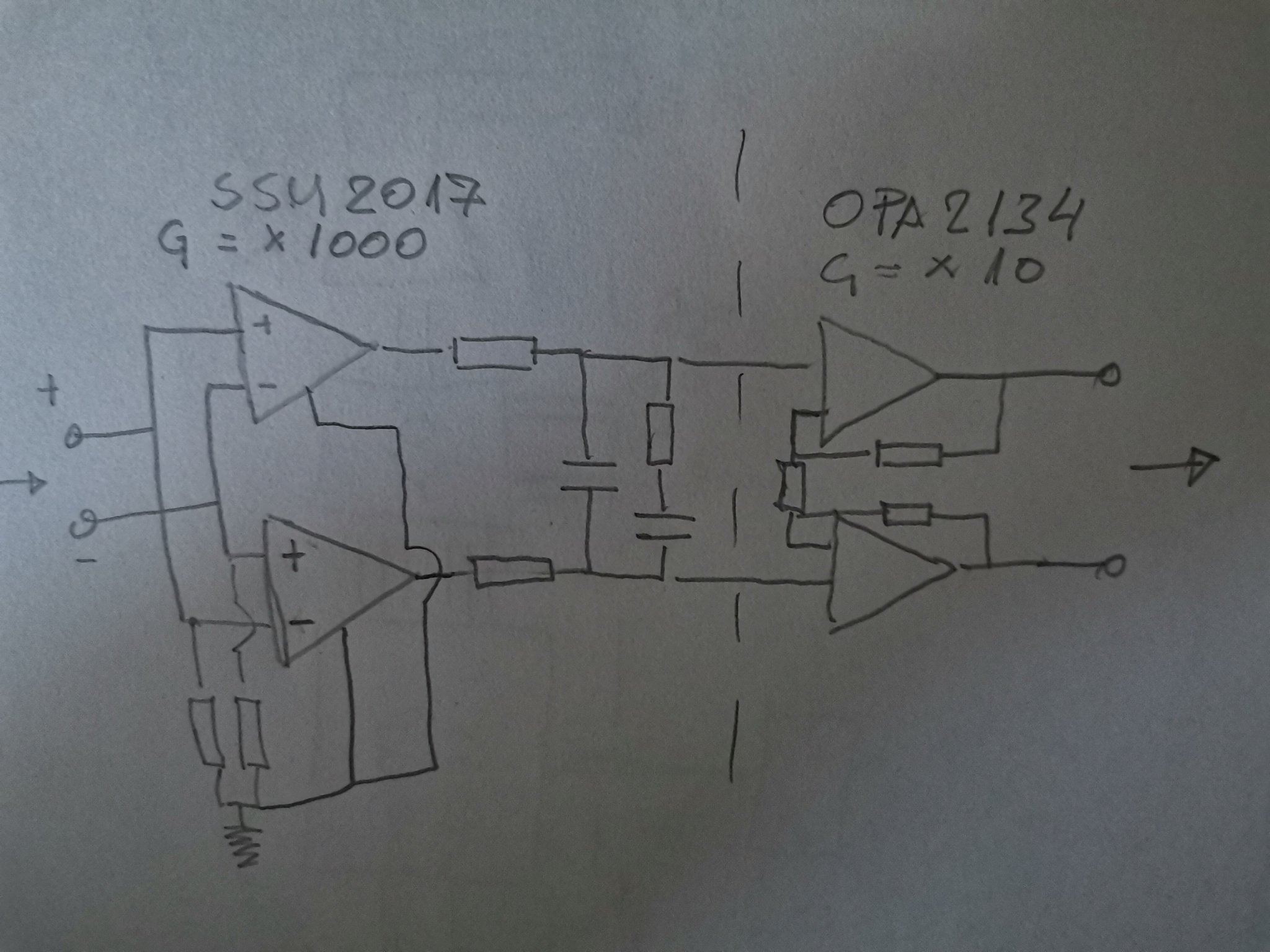

Hi Hierfi,
I can confirm that circuit you draw is very good, excellent actually!. It is qualified by more than 20 years of use 🤣
That is exactly my original preamp posted at beginning of this thread https://www.diyaudio.com/community/...ono-preamplifier-thoughts.414816/post-7731430
However good they are, SSm2017-9 are tuned as mic preamp and microphones normally have much higher Z than MC carts . By rconstructing the model we can fine tune it with better input transistors and higher bias currents as Hans just did 🙂
I remember your post. The question is why change and move on when noise performance is already verifiably low... perhaps low enough for your application? What about the sonics is expected being "fine tuned" other than noise?
The SSM2017-9'S may have their main application in mic preamps but aren't tuned before the value of the gain setting resistor is decided upon, with the value of resistance strongly determinant of noise performance. For moving coils the gain needs to be set to the highest possible for lowest noise. Certainly the noise performance is adequate in current mode using a single device when using a Denon 103r.

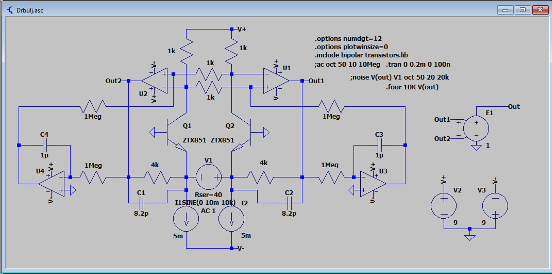

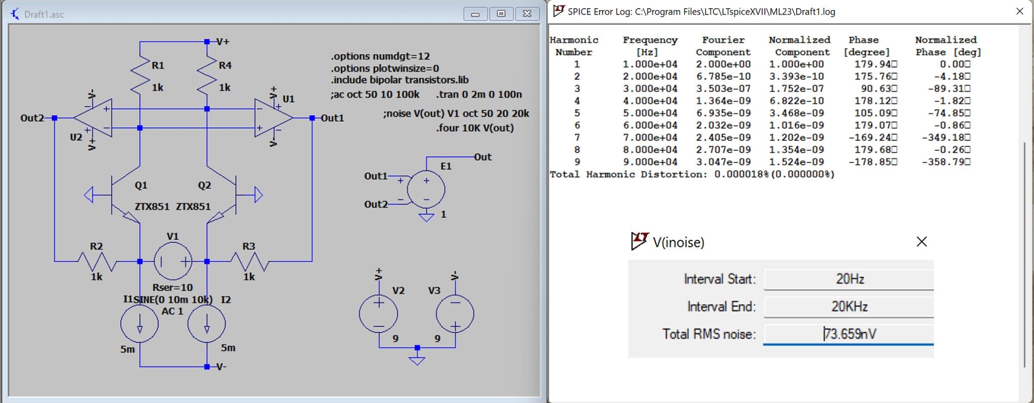

I simulated just a possible version of the circuit as a transimpedance amp with Rcart=10R and diff. gain of 46dB.
The two Opamps where ordinary 5nV/rtHz versions but the transistors the very low noise ZTX851 with 5mA feeding them.
THD with 10Khz@10mV and the gain of 46dB was -135dB, while noise from 20Hz to 20Khz was 74nV or 520pV/rtHz, which is all very good.
Hans

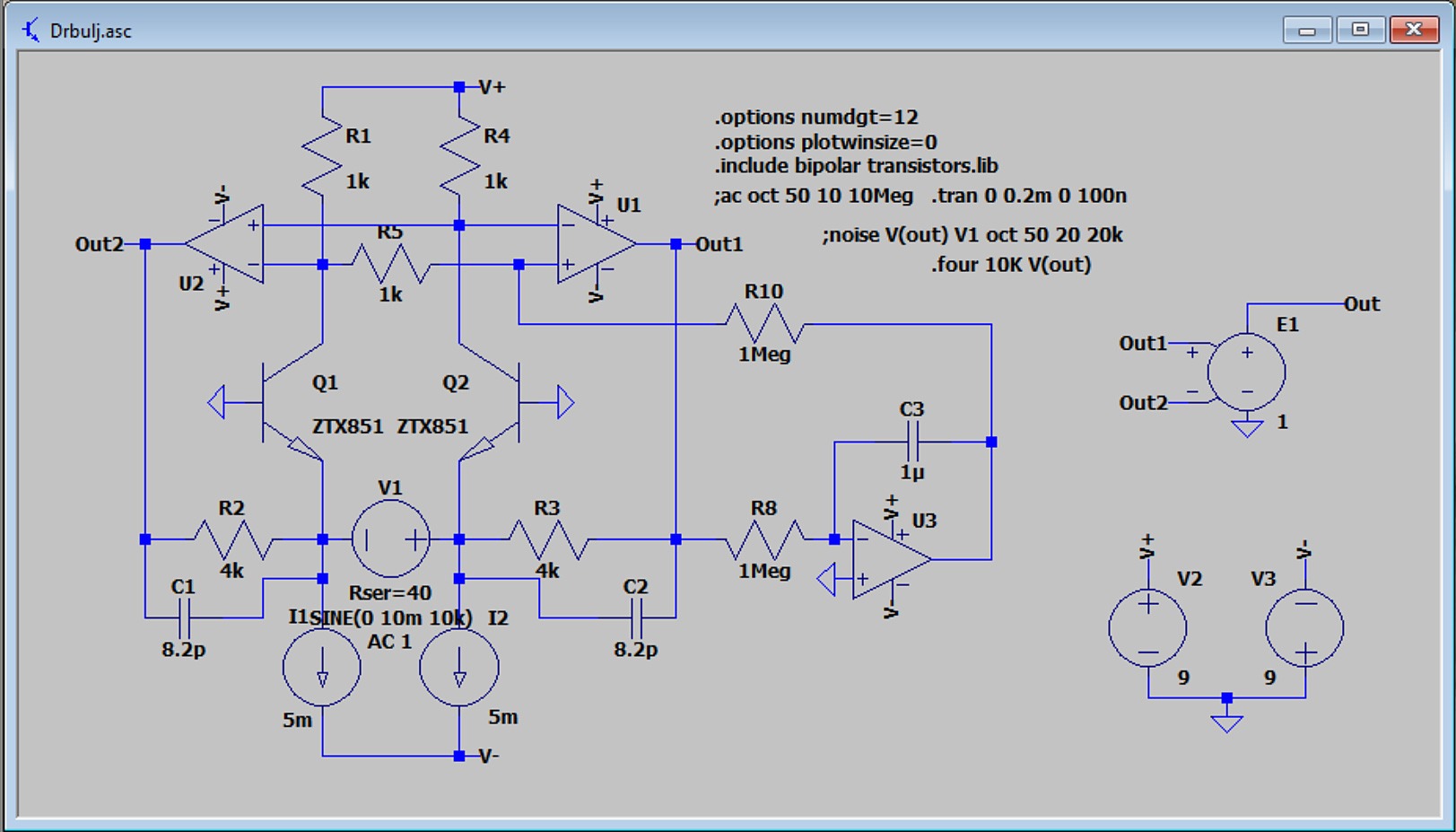

The reason I suggested this could be problematic is because the DC operating points could vary dramatically with tolerance variations. How do input offset voltages of op-amps get corrected? What is the value of the output voltages in balance? It seems at the very least that creating signals about 0 volts can require some attention.
In contrast an integrated package like the SSM2019 seems having internals perhaps laser trimmed with cross-coupled thermal tracking internally. It does a very good job of DC control, hence a trimming potentiometer seems all that is needed in it.

I understand your concerns, and yes the SSM is an fine component to use, ready to go.
Nevertheless, it's sometimes challenging to look over the fence looking for possible alternatives.
And for almost every problem there is a solution, in this case to compensate offset voltages.
A servos will do the job, without affecting noise, Frequency response or causing unacceptable currents from flowing through the Cart.
I'm not defending any solution, just showing what can be done to overcome a possible problem.
In this example with the given servo components, +/-4mV offset can be compensated, a dual opamp like the OPA1656 or even an NE5532 will fit.
A dual servo on both sides is the most accurate but even a single one is already very effective, see attachment.
And yes, the collector and feedback resistances should be tightly matched, not a real problem.
Hans

The main problem appears that difference signals on the inputs of the opamps are magnified by the open loop gain of the xxx27/37 devices, if that is what is being used. Lets say the offset is 100uV with open loop gain of 120dB. If one device has zero offset and the other 100uV the average is 50uV (50uV neither wants to see), creating 50 V of differential output offset after the gain of 1 million. That's beyond the power supply limits. Basically you have 2 devices fighting each other for supremacy using their open loop gain to do this.
Luckily here i have bit more, even still modest, experience. In the past I used OP27-37 and TLE2027 quite a bit. These have DC offset in average about 5uV, 100uV you mentioned is extreme limit of specifications. Additionally they also (all of them) have offset trim pins that if someone has nerves and time to measure nV DC offsets, can be brought to virtual 0 DC offset.
Hereby I mentioned just vintage opamps that I am more familiar with, quite confident there will be more contemporary chips with those characteristics, and hopefully better sound.

What do you suggest for U3 and U4 servo amps, just that I have them in drawer when assembling time comes. Guess some jfet input precision opamps ?
No need for precision opamps, they will reduce the output voltage to within their own offset voltage.
But because of the 1Meg input resistor, fet opamps should be used.
All dual fet opamps with offsets below a few mV will do, there are several to choose from, speed or noise are unimportant parameters.
Hans
