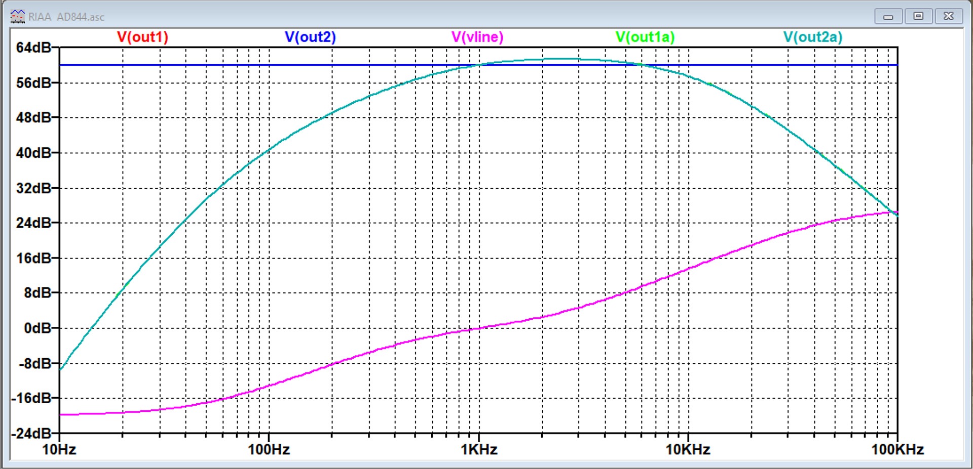

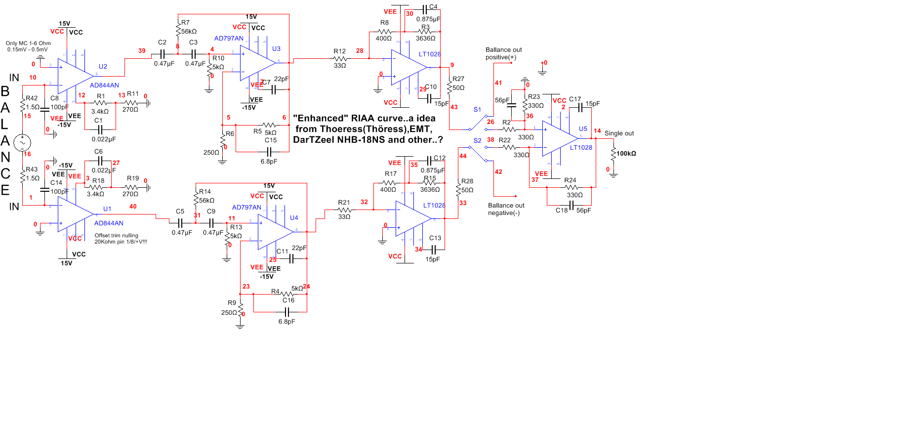

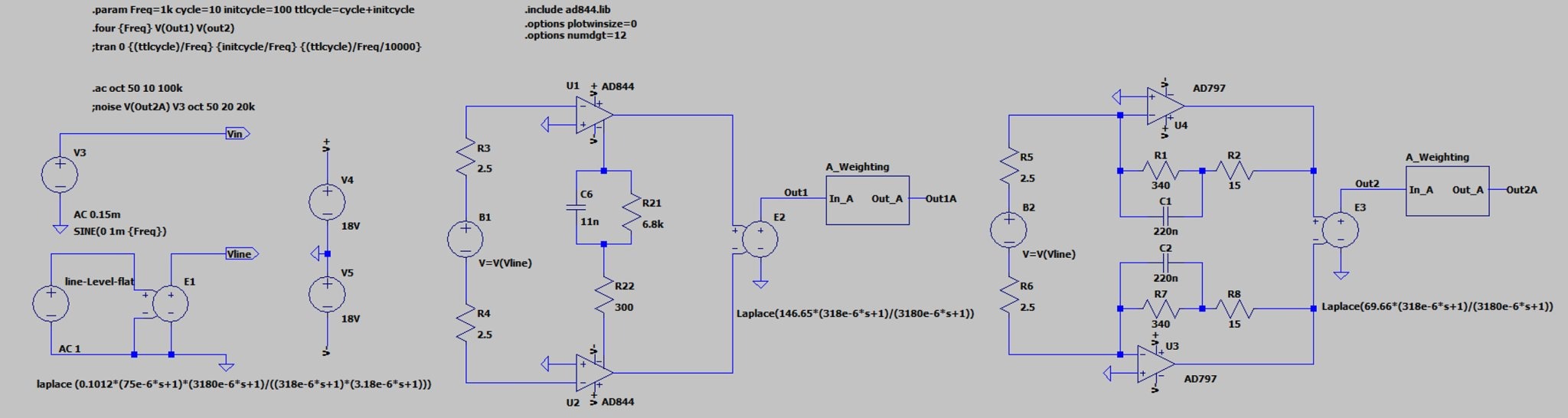

To bring the discussion back to a technical level, I made two preamp versions for a 0.3V 5R Cart.
One is the proposed version with the AD844 and the second one is based on a AD797
Only the first stage with the 75usec and the 3,18usec time constants were simulated , while the 3180usec and 318usec where put via Laplace in a Voltage dependent voltage source, also given the task to bringing the overall gain to 60dB@1Khz.
I have connected both AD844's T outputs to one network of dual values, which is the same as two individual networks but more elegant.
Cart B1 is connected to both AD844's minus inputs, who have a 50R internal impedance each.
The dual AD797's are configured as inverting amps, also having these 75usec/3.18usec corrections, where the Cart B2 is connected to their very low impedance virtual inputs.
Finally to be able to calculate the A weighted noise, a dedicated module was placed behind both amps.
1) the first image shows the circuit diagram with both amps.

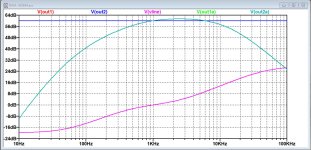

2) second image shows the Anti Riaa curve Vline in purple and both outputs Out1 and Out2, both having exactly the same perfectly flat 60dB gain.
Also the outputs of both A-Weighting modules are visible, confirming the intersection at 1Khz.

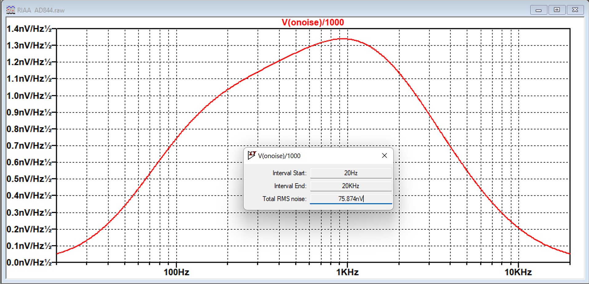

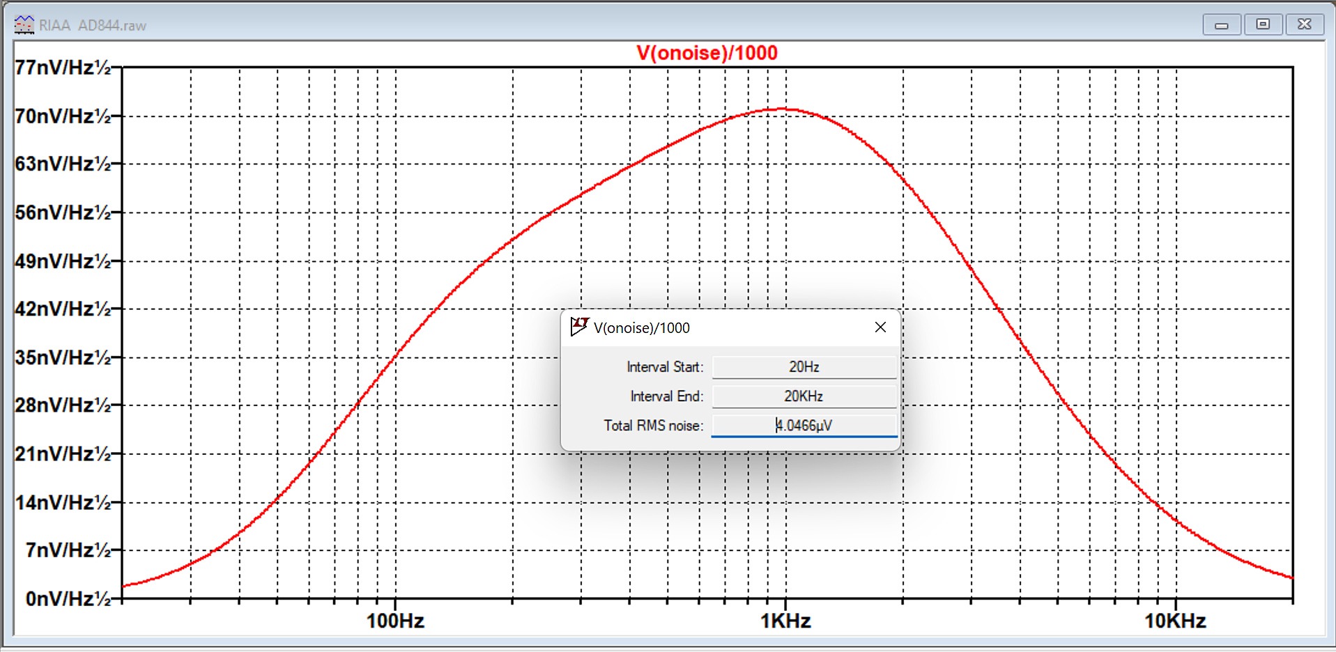

3) Third image shows the A_weighted noise referred to input from the AD844 version, being 4.05uV from 20Hz to 20Khz

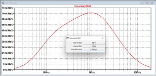

4) Last image shows the noise from the AD797 version, being 75.9nV over the same BW.
Now with a Cart producing 0.3mV@1Khz at 5cm/sec, S/N for the AD844 becomes 20*log(0.3mV/4.05uV) = 37.4dBA
The AD797 version on the other hand has a S/N of 20*log(0.3mV/75.9nV) = 71.9dBA.
Two reasons why the AD797 has a much better S/N: these amps have a 0,9nV/rtHz noise figure instead of the 2nV/rtHz, giving a 6.9dB advantage and the two 50R impedances in the AD844 give another 26.4dB disadvantage and there you are.
Hope this helps to make things clear.

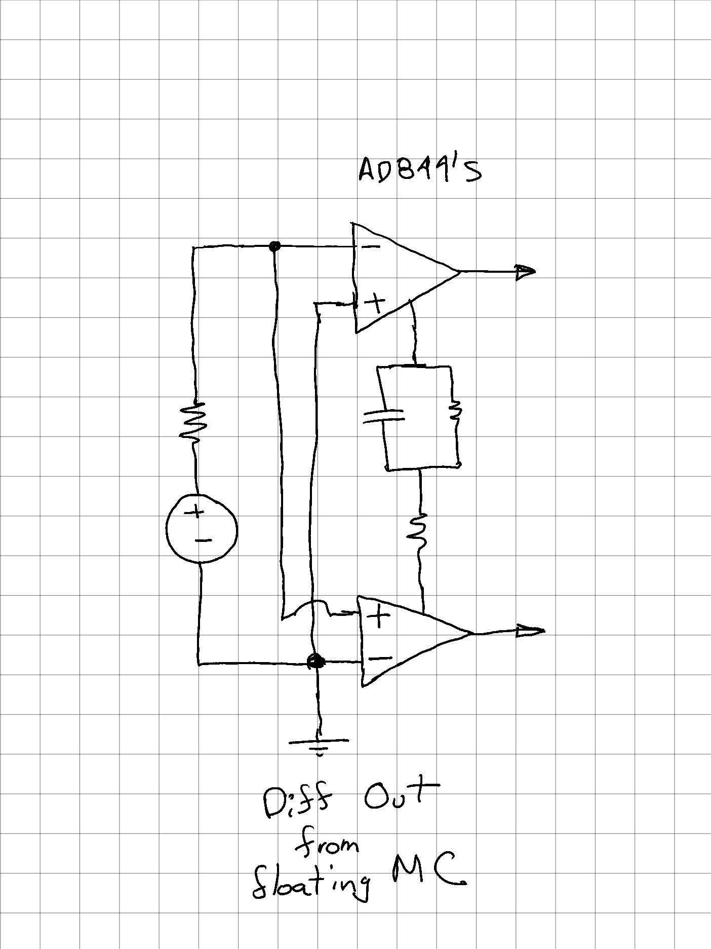

Looking at the input network as outlined by STEP RESPONSE it isn't clear that this is the best approach to achieve a balanced output using a pair of AD844's. An alternative approach would configure the network as per below:
The moving coil cartridge is a floating source. As far as the upper AD844 is concerned the voltage developed across the inputs is a function of the input current imposed on ~50 Ohm input impedance as specific to the +ve terminal of the AD844. This potential also appears across the lower AD844, however this generates equal opposing currents through the ~50 Ohm into the terminal connected to ground. It seems likely this parallel connection would generate considerably less noise (and you can always start stacking too...).

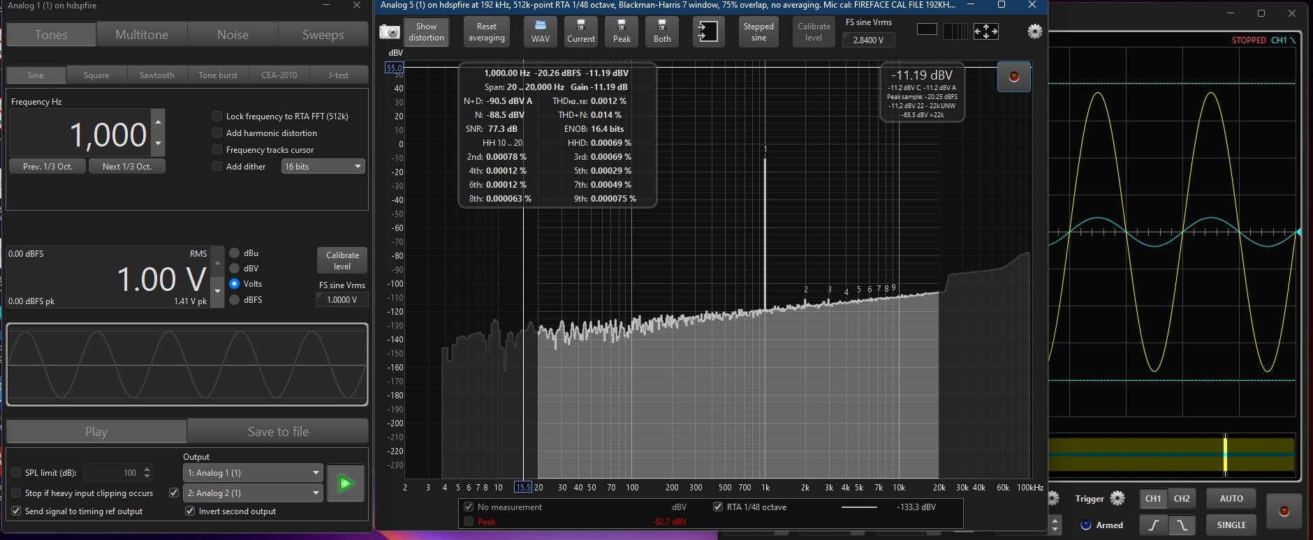

So i start again (this time with correct bandwidth 😎 ), SSM2017 in current mode (bus summing) , Rg 33 Ohm, Rin 2 x 47k.
Input from soundcard is 1V reduced by 47k and 33 for approx 2850 times to bring it on MC cart level
Output from Amp : 314 mV, gain approx x100 or 40db
SNR is now -77,3 db, THD 0.0012%. Now it looks right.
In my opinion above will be masked by even the best cartridge - TT - LP combo and make it irrelevant... Such circuit can go in as it is, SSM2017 is great...
But I'll continue.
PS, for some reason also 50 Hz noise vanished today????
Dear Drbulj,
Maybe you can help me in understanding the above image with due respect for all your extensive efforts so far.
To summarize when I'm correct:
A Cart, operating in current mode, is represented by Rg=33R giving a gain of 10K/33R = 303 or 49,6dB.
Signal on Cart is from a 1Volt@1Khz source, fed through two 47K resistors on Rg, causing 0.35mV on Rg.
With the calculated gain of 303 this should result in106mV, which corresponds nicely to within 0.77dB with the -20.26dBFS as shown in the image .
But the spectral 1Khz line in your Image is at -11.19dBV, or at 276mV, which is 2.8 times or 9.07dB higher as the -20.26dB, but nevertheless the -11.19dB was used to calculate the S/N.
There must be something I'm missing here in the calculation.

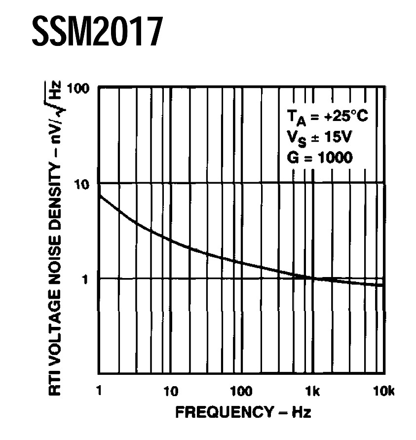

The other thing I don't understand is the shape of the noise spectrum in the image which increases by almost 30dB from 20Hz to 20Khz, while the SSM2017's spectrum as shown in the attachment goes down with increasing frequency ?
Sorry for all my questions, but be also aware that Riaa and A-weighting both improve the S/N by almost 10dB, so without one should measure somewhere in the lower 60dB range.
This can be confirmed by a quick check.
The SSM2017 produces ca. 1.5nV/rtHz at a gain of 303.
For a BW from 20Hz to 20Kz this results in sqrt(20Khz)*1.5nV/rtHz = 212nV.
For a cart producing 0.35mV, S/N now becomes 20*log(0.35mV/212nV) = 64.4dB without Riaa and without A-weighting.
With Riaa this becomes ca. 70.4dB and with added A-weighting ca. 74.4dBA.

There is nothing to stop this little stage operating in balanced mode. I'm just going to try that.
