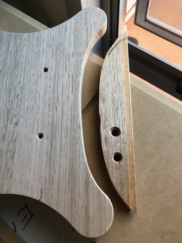

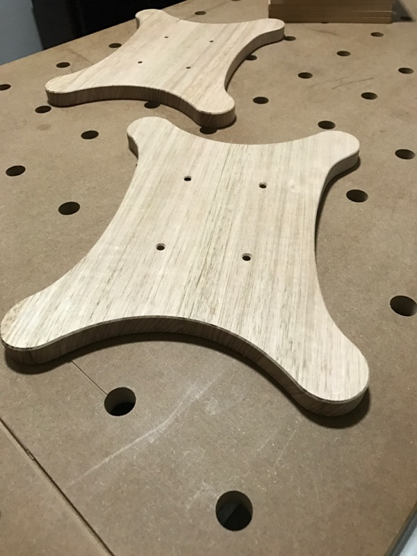

The hardwood bases are the right shape and have a little chamfer added

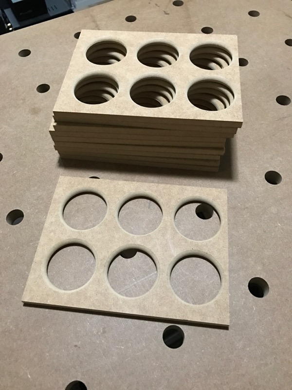

The window braces have had roundover's put on to reduce any chance of creating small resonators!

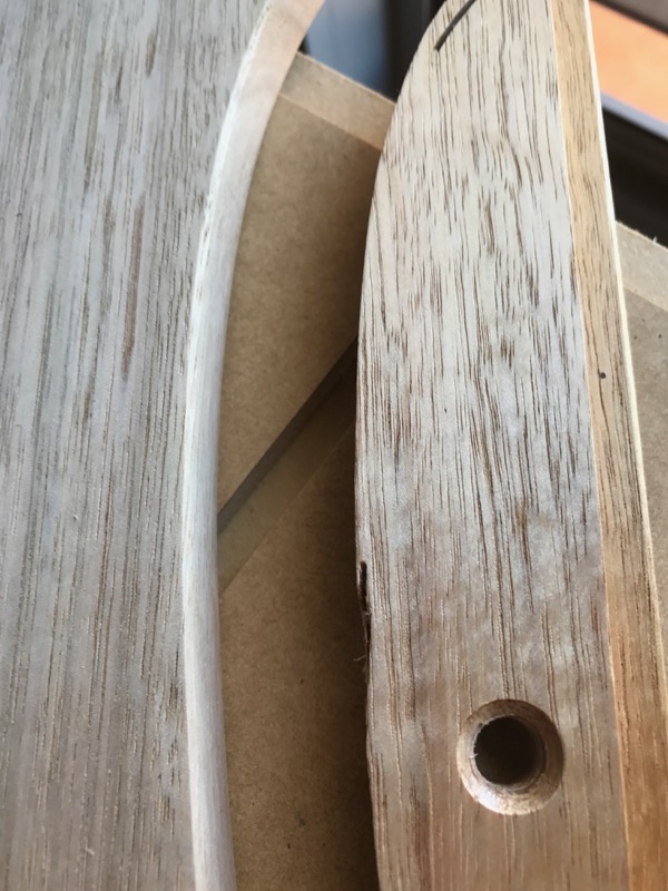

A heavy rainstorm prevented much being done today, I managed to complete a strange task which was to file the threaded inserts I have for the bases to the same size, some of them were almost 1.5mm bigger than the other's. I wondered why the wood had seemed to lift on some corners when the nuts were flush, now I know why.

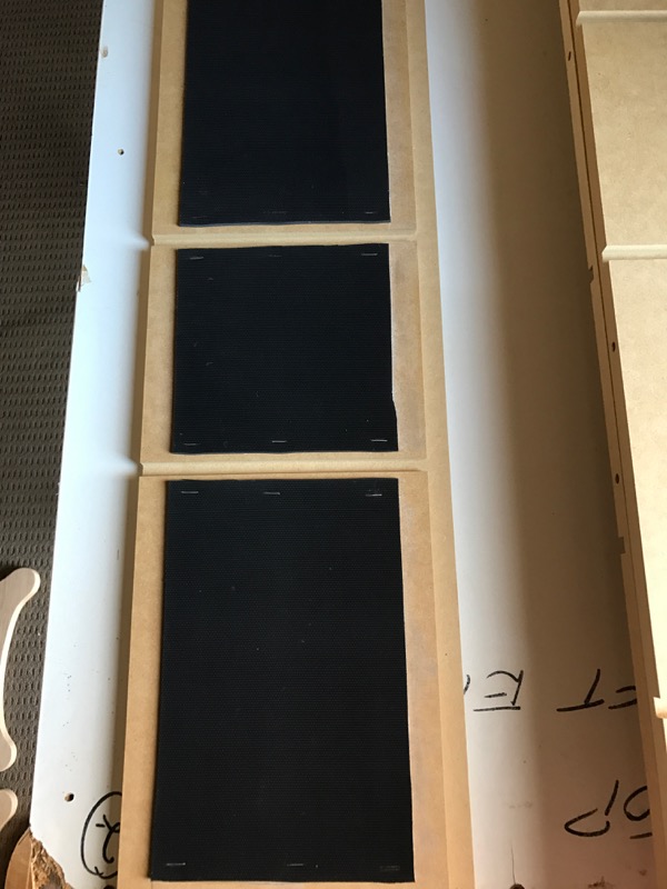

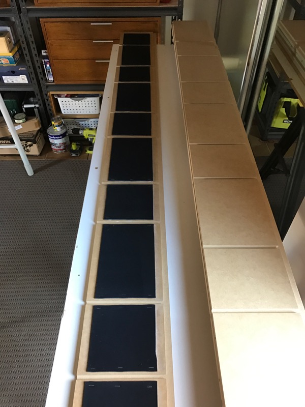

The rubber sections have been glued and stapled to the sides. I had forgotten how much I hate using a caulking gun and I seemed to get a few hit and miss staples but in the end it is all done. Not the prettiest work ever but they won't be coming off any time soon.

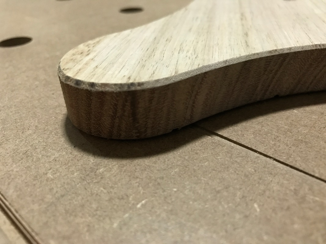

The bases have been finish sanded to 400 grit and are ready for a finish to be applied.
attachment.php
I have tested using a Tung oil mixture Feast Watson 'Floorseal Oil'. When wiped on it leaves a very nice finish, leaves a slightly darker finish than bare wood be doesn't darken it too much either. The oil really highlights the figure in the timber. Not too easy to see on a small test piece in photos.
attachment.php

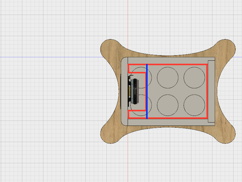

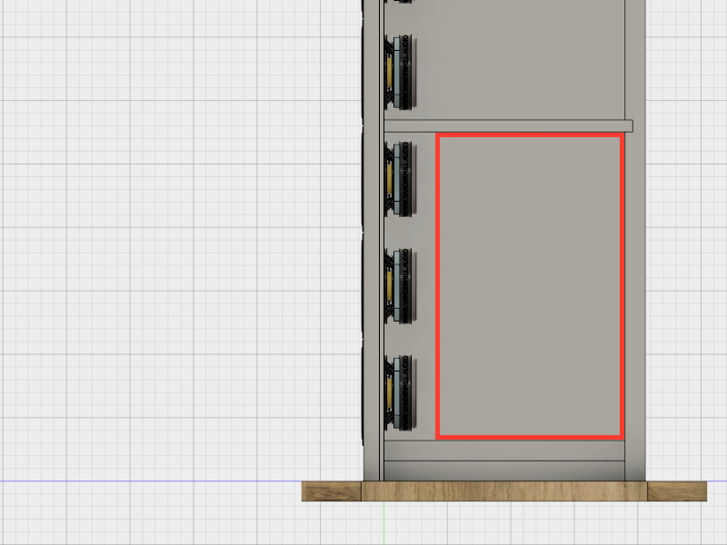

It won't be too long now before I need to start cutting the fibreglass stuffing.
I asked some questions over on the Twin Towers thread but I am still unsure just how close to the rear of the driver I want the stuffing to be. I am still undecided if using some to either side drivers to go right up to the baffle is a good idea. Like the red line in this image or to just cut off at the blue line.
attachment.php
attachment.php
Any experience or opinions would be welcome :)

At the side of the drivers I only used wool felt. The distance looks fine to me this way.

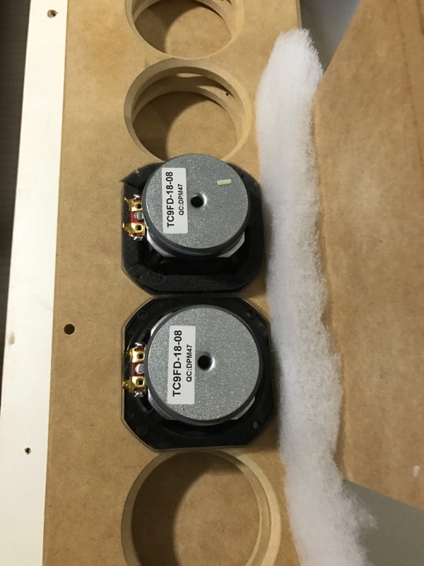

It looks like you could place it out into those corners. Are you planning to put something between the fiberglass and the back of the drivers? Just to prevent the driver from sucking in loose fibres trough it's vent.
Can you build a test box holding one driver? Some impedance tests could tell you a lot! It doesn't need to be pretty, just the same size ;).
Thanks for the response, I was going to use some acrylic damping material (that I have plenty of) to create a barrier between the fibreglass and the drivers. Perhaps I can create a shallow U shape and fill in the sides with the acrylic and cover the fibreglass at the same time. When I have a basic enclosure glued together I can test to see how it moulds and if it will stay in place.
Well I think I can already discount that idea as the damping material is too thick to fit nicely in the side gap without almost touching the magnet.
If I cut it in half then it fits much better.
attachment.php
I am thinking that getting the thin felt might actually work well because then I can use it to press everything down into place a bit like wesayso did. Except mine will be in two or three drivers groups due to my bracing structure and the felt will be thinner.

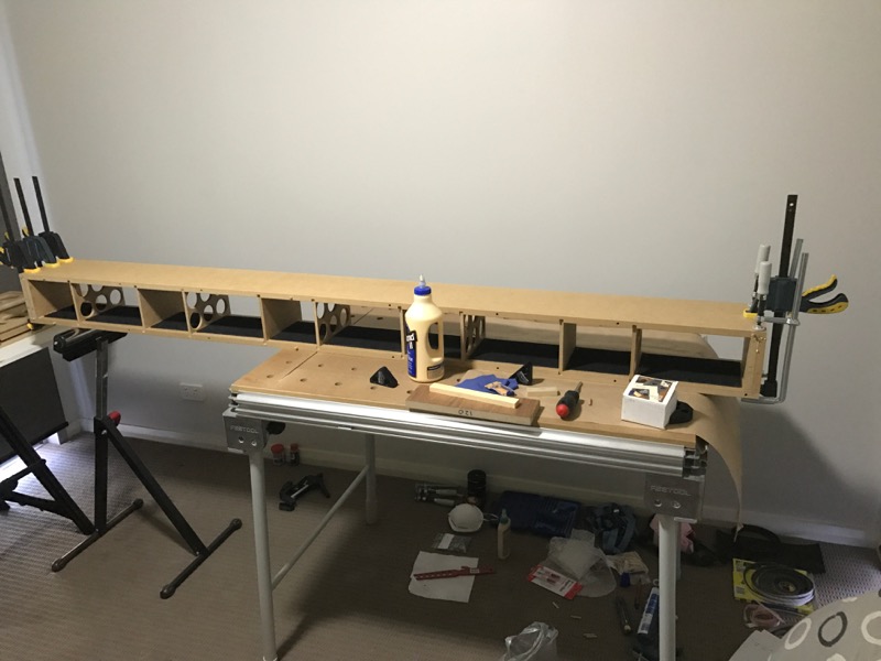

More clamps! Nice project
Thanks! Only the two pieces on the ends are being glued so I would have struggled to fit more clamps in!
