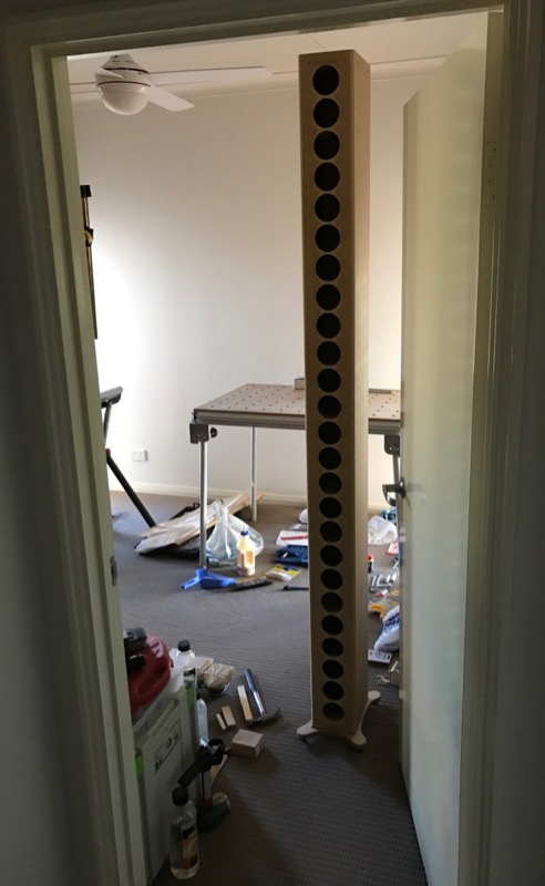

Tip for gluing:
You should mask along either side of a glue joint with masking tape. It's then MUCH easier to clean up after the glue dries.
Thanks for the input, I have used that method before and where I can I often pre finish the panels as it is much easier to remove the squeeze out off a finished panel than it is the bare wood.
I took a quick snap just after clamping so the squeeze out is pretty visible in the picture. 5 minutes later I had used my little plastic scraper to remove it all when it had solidified but before it had dried if that makes sense. I find this works better than taping. The whole thing will be covered in glue to stick on the leather look fabric anyway 😀

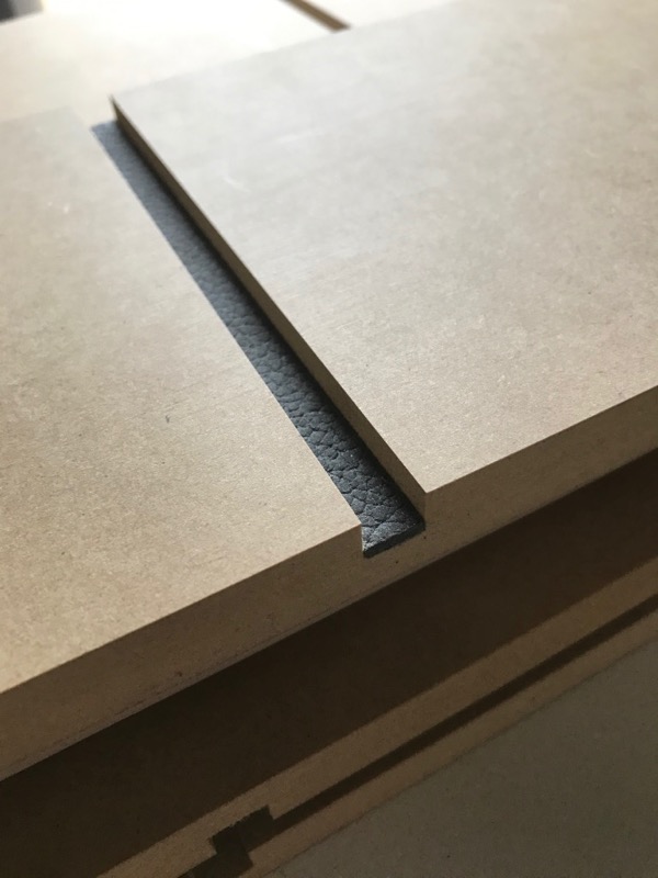

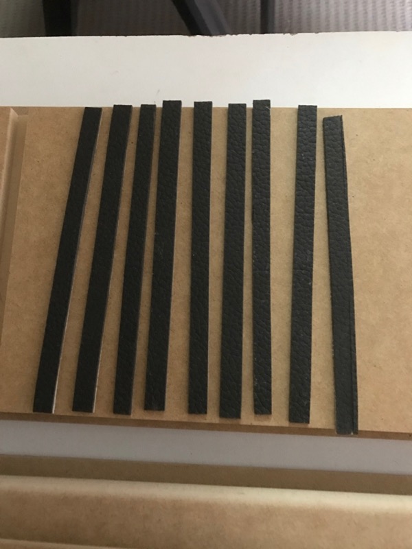

Some more progress today.
I have cut the strips to fit in the dados to fill in the gap that the CNC people left me by not reading my drawings properly 🤐
attachment.php
attachment.php

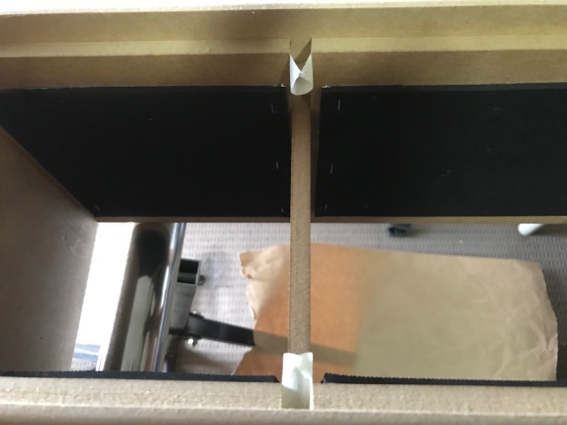

Here's one for Brisso, I taped the dado channels to make sure no glue got in them to make fitting the braces more difficult
attachment.php

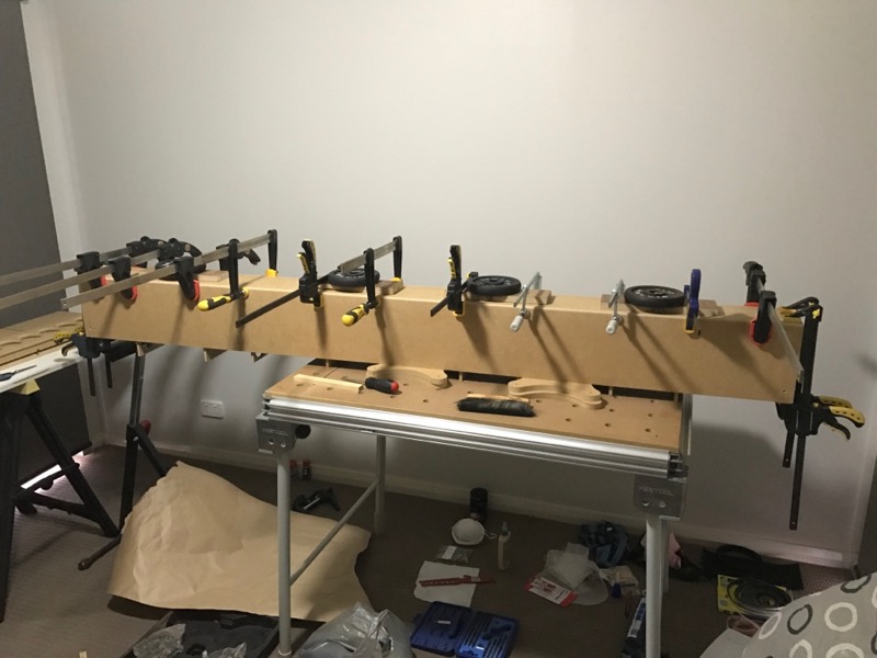

The back is glued on one now, I couldn't get much glue in as it was virtually a press fit, turns out the weights have been more useful for building speakers 🙂
attachment.php
