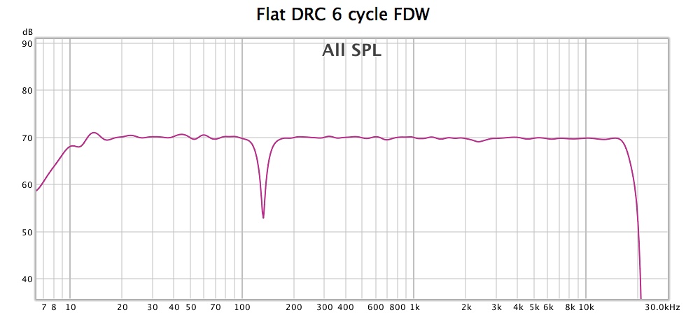

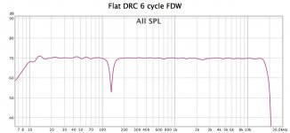

Here are some graphs of two different crossover topologies that I have tried by virtually combining impulses in REW.
I have started off with a Flat DRC correction shown with a 6 cycle FDW as that is the closest to how the correction was aimed for and also it allows easier comparison of the graphs. This is the baseline measurement. This shows the 140Hz dip I am getting from the front wall.
I am using perfect impulses from Rephase to simulate the sub and crossover slopes. The corrected impulse has the IR centre exactly at 0 to avoid and timing induced errors.

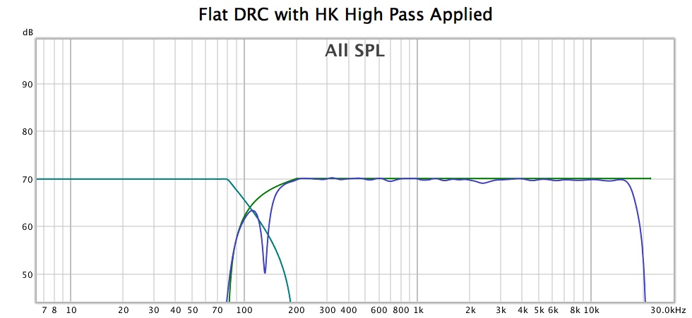

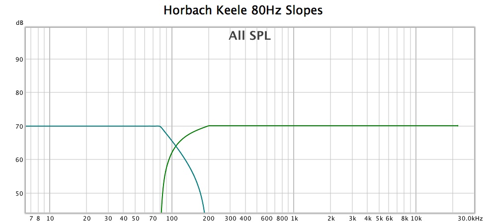

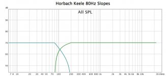

These are the Horbach Keele filter slopes for an 80Hz crossover
attachment.php

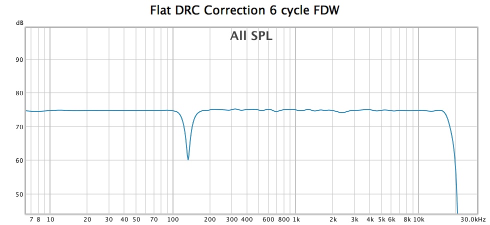

This is the Flat correction with the HighPass applied, low pass also shown
attachment.php
This is the combined result, showing very good integration of acoustic slopes to the ideal ones.

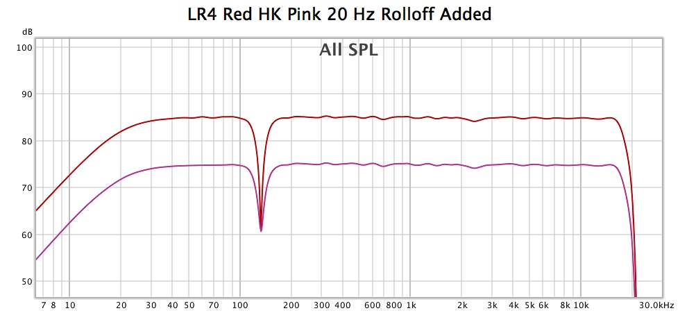

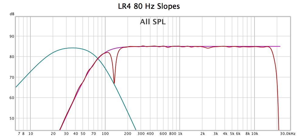

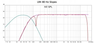

I tried a more standard LR4 linear phase at 80Hz, this graph shows the targets and Flat correction with High Pass added
attachment.php

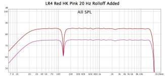

This graph shows the difference between the two with a 20Hz second order rolloff added, very similar apart from the fact that the 140Hz dip has been made quite a bit deeper 😱 More experimentation needed with slopes and frequencies to see if the dip can be left as it is in the baseline with more standard crossover types.
There isn't much withholding you from using some EQ on the subwoofer side (on top of that crossover) at the problem frequency of the arrays. Just don't use too high of a Q and limit the amount of boost. Should work well to balance out the dip. Maybe it works even better if you remove energy at that dip from the arrays. Check the processing (FIR file) to see if there's a peak in the processing at that 140 Hz frequency. As it is a null, more energy there leads to a bigger problem, so creating a mild EQ dip on the arrays while creating a similar peak on the sub side might work well to lessen the total effect of that dip.
That's what I do with the left/right arrays in my room due to not having symmetric loading. Way less EQ is needed than one would expect, just try it.
Something like this works if the dip is consistent over a larger area, as this is an average that should be the case. As long as the sub has an even FR output over that same frequency area.
Your 80 Hz XOs LPFs are down over 10 db by 140 Hz, limiting how much the sub can help fill in that dip, as Wesayso commented. You will get some marginal benefit from raising the XO. I'm using 100 Hz with no sub-localizability issues.
But even the .3 loss factor on the boundary interference you mentioned may be enough to reduce the depth of the null so that you have enough headroom to equalize it away.
Interesting points, a combination of acoustic treatment, crossover frequency, slope and reduction in level in the main speakers should help to make it much better.

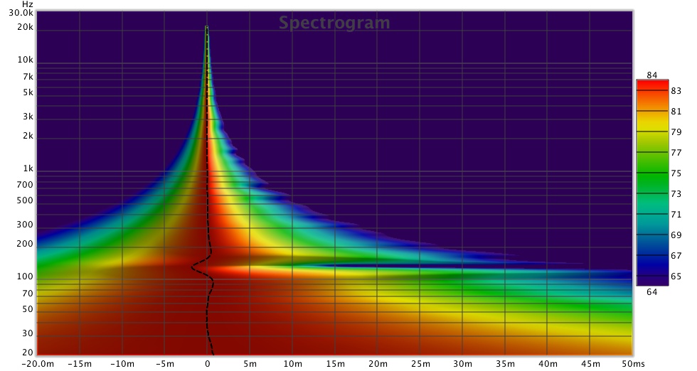

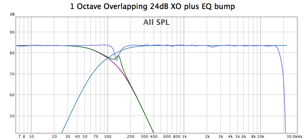

This shows an overlapping 1 octave 24dB slope crossover at 100Hz with an EQ bump in the sub, it has definitely helped as the null in the spectrogram has been pushed out in time. EQing on the sub side is a bit trial and error as the shape has to be different than filling the gap in the overall curve.

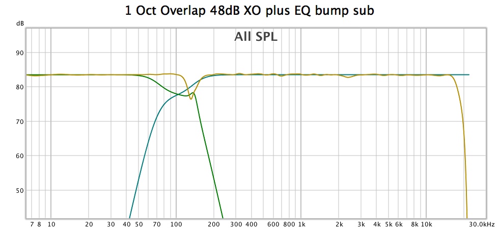

The 1 Octave overlapping at 48dB could be interesting as it has similar shape in the top of the crossover before dropping more rapidly afterwards. I will simulate that when I free up some measurement slots in REW, sometimes 30 is not enough for this sort of virtual testing 🙂
1 Octave 48dB Crossover with EQ bump in sub channel, pretty much the same spl response around crossover much steeper outside that band.

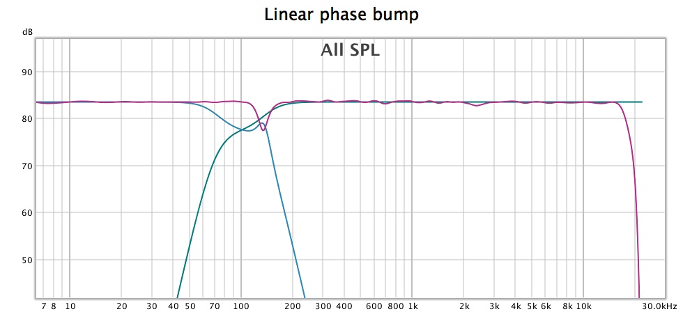

This the linear phase version with a different EQ shape from rephase, looks better on an spl plot but the spectrogram is the same but with more going on before the peak from the linear phase EQ

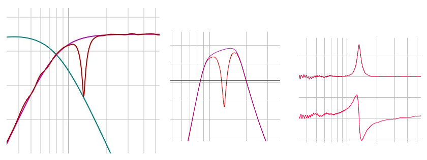

Not shure but could imagine phase of that dip maybe can be a little wild, what i mean is its not pure linear phase and not pure minimum phase but a mix of both, guess a chance to repair that then into REW you need to divide a carefull alligned measured line array IR with textbook target of a carefull alligned target curve IR, to ignore HF stopband from measured IR then filter the two IR before the divide command for example 1/1 at 125Hz and export that as frd file, then over in Rephase use whatever mix of minimum phase and linear phase filters it takes to get that hump flat as pancake in both the amplitude and phase domain, below should be some pointers 😛
attachment.php

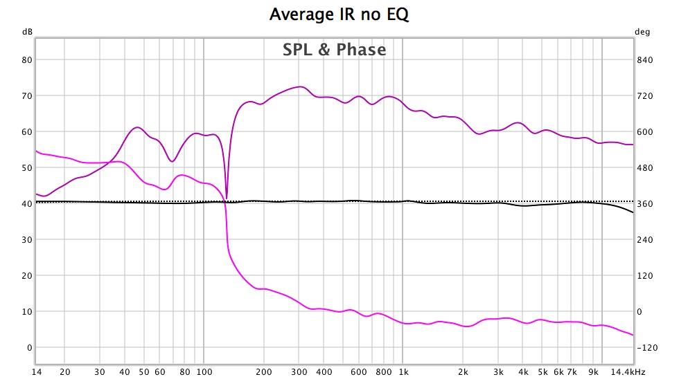

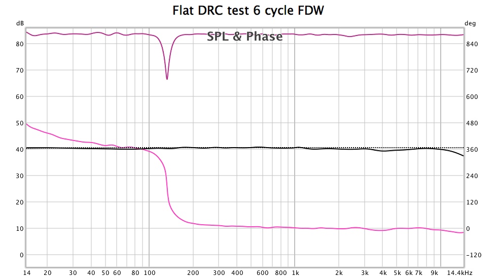

This is a RePhase exercise right? Not a real null in the mains, just a virtual one done by EQ, right?
No the null is real, it appears in the averaged measurement and DRC does not try and correct it.
These images show it, 6 cycle FDW to clean up the phase and unwrapped to see the cliff more clearly. The exercise part is combing the real corrected measurement with pure impulses to represent a perfect sub.

I'll have to read that one a few times to understand it 🙂 I don't think it can be corrected electrically, but needs a combination of absorption and mitigating with the sub channel if possible. I have had no success with dividing impulses before, it always sounds wrong somehow.

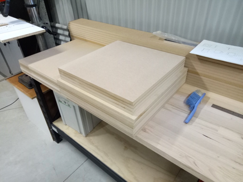

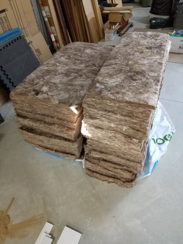

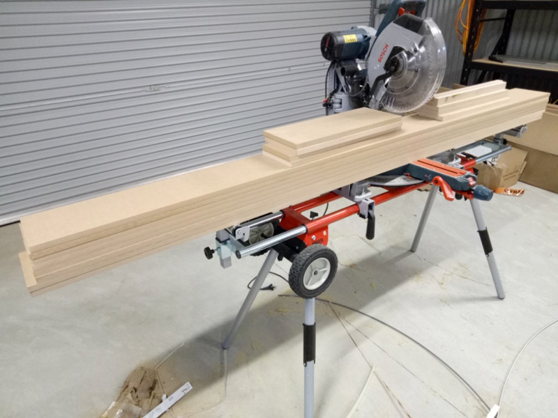

Some progress has been made in the physical world 🙂
Pile of Glass fibre batts
attachment.php
Pile of MDF
attachment.php
MDF cut for sub cabinets and absorber frames
attachment.php
attachment.php

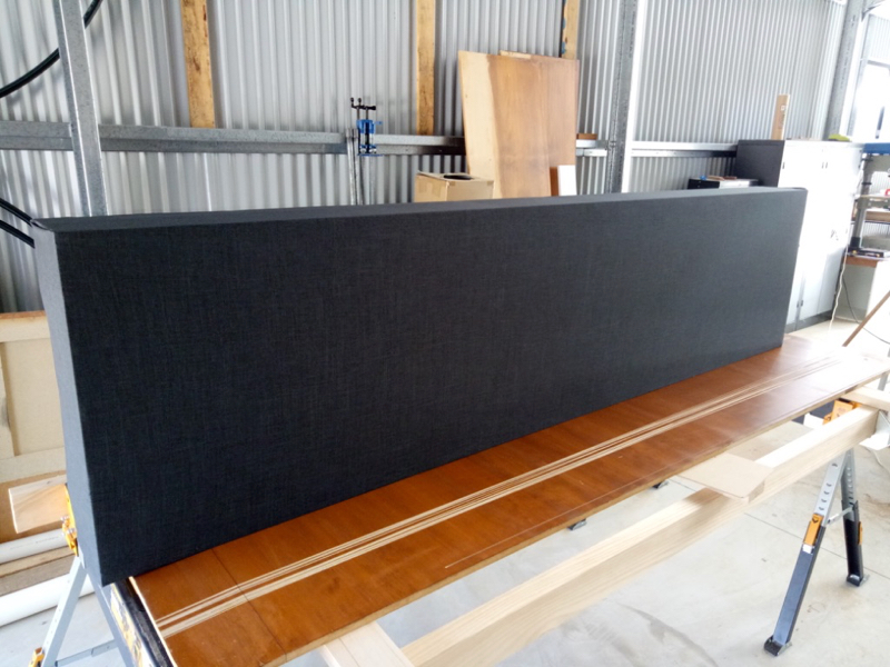

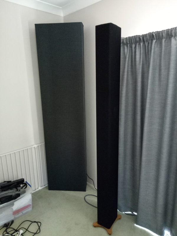

The original idea was for corner traps and first reflection control. Having measured, the ETC shows less early reflections than I thought but a few bass nulls, so I will try to see if I can reduce the front wall null enough to be dealt with by other means.

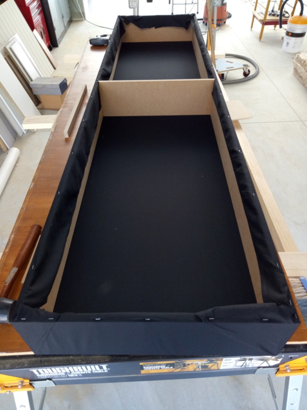

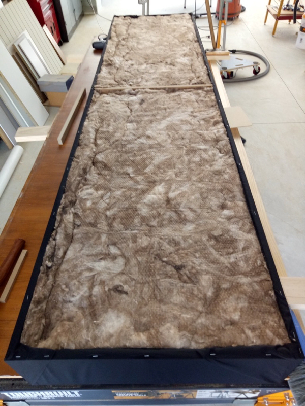

Here are some progress shots of the absorbent panels, one completed so far 🙂
Basic frame with backing fabric attached (excuse the perspective the divider is in the middle of the frame)
attachment.php
Filled with fibreglass insulation
attachment.php
Front fabric attached
attachment.php
In room next to array for scale, even with no bracing these things are awkward to move around.
attachment.php
