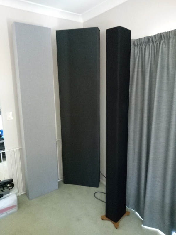

Thanks! An ugly mess next to the array just wouldn't cut it and I don't have a handy curtain to hide them behind 🙂
Looks very slick fluid - I am a little late to the game but wanted to mention that you will increase the absorption by keeping the sides open.
If waves are allowed to enter from the sides you effectively increase surface area used for absorption.
For me it worked quite well to have the array closer to that damping panel, as it took out first side wall reflections as seen from the listening position. I'm guessing that side wall reflection would hit in front of the panel as it stands right now (as seen if you put a mirror there from the listening spot). I'm guessing this was just a preliminary picture to show off though? 🙂
I considered doing that but decided against it, I wasn't sure I really needed more absorption. I could still do it on all the others but it's quite a lot more work, hmmmLooks very slick fluid - I am a little late to the game but wanted to mention that you will increase the absorption by keeping the sides open.

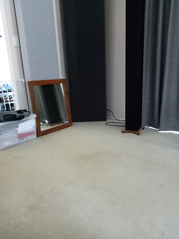

The reflection is on the far left of the last picture, the positioning is not fixed yet but I did plan to put the larger width panels across the corners as shown to be bass traps. The original plan was to have another panel to the left for that reflection. It may work better to have the panels behind the arrays rather than across the corners to try and reduce the 140Hz null, time will tell as I will test both. But you are right it was a good position to show the scale compared to the array 😉For me it worked quite well to have the array closer to that damping panel, as it took out first side wall reflections as seen from the listening position. I'm guessing that side wall reflection would hit in front of the panel as it stands right now (as seen if you put a mirror there from the listening spot). I'm guessing this was just a preliminary picture to show off though? 🙂

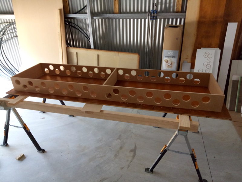

How stable do you find that Bosch sliding compound saw on the folding stand shown?

Thanks, the stand is good but not quite as stable as on a bench, just needs a bit more care to keep things in line when doing sliding cuts. The saw throws a fair bit of dust even when hooked up to a vacuum so I tried the stand to make it easier to clean up, works well so far.Nicely done.

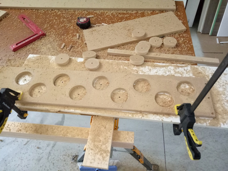

I used the TCT holesaw I bought for when I planned to make the array baffle by hand, so no routing.

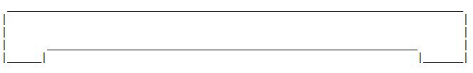

The point is to have as a much surface area of the absorbent exposed without compromising the structure of the frame too much. GIK use an ellipse cut into the sides which seems a good solution but the holesaw was easier if messier.I would acieve a similar result by cutting out 25% of the depth of the side panel, to form a gap between side panel and wall.

Side by side (display only)
Moved into better position with mirror

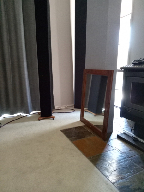

Other side
No time for measurements as yet but in a quick listening test I had to remove the 60Hz boost I had put into one channel to deal with a null before. Had quite an enjoyable time listening, not right yet but new measurements and redoing the correction should help.
