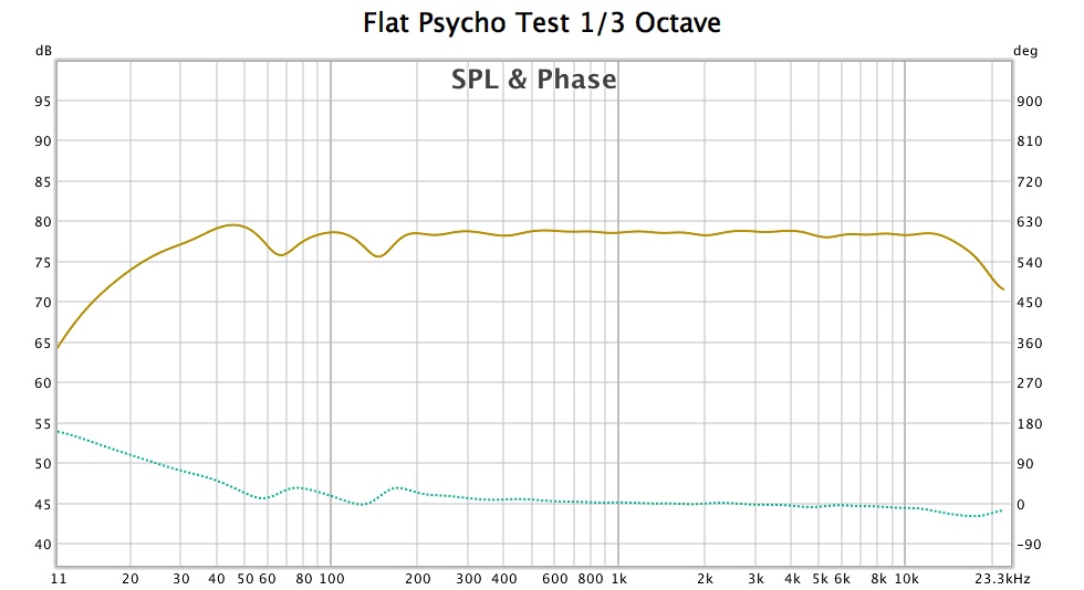

This is what the 1/3 Octave smoothed prediction looks like. I could take out the phase bumps at the dips with rephase more easily. What is the thinking behind that?Regarding phase correction: there is probably a better way to do this, but basically I loaded the (flat target version of the) predicted correction ("ImpulseResponsePrefiltered.wav" convolved with "PsychoFilter.wav") into REW, smoothed 1/3 oct, exported as .txt, zeroed out amplitude (freq) values, inverted phase values, used as a target response file with PSFilterType = L applied to a clean impulse, and implemented in a 2nd convolver instance. Not my idea of a good time 🙂.
Thanks 🙂Added the target response to post 1 of the convolution thread. I'm still partial to a linear tilt as of now...
Those remaining dips/wiggles don't seem that invasive anymore.
I know we are looking at highly smoothed plots but even then, I would not expect a huge difference. Sometimes you can be lucky to straighten the phase and "fill" the hole somewhat. But it would also create some pré energy before the main impulse, use sparingly.

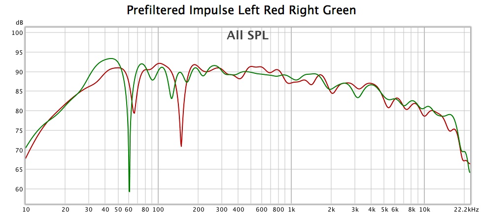

What I would do here is to look at it unsmoothed 6 cycle and remove some energy where a dip is forming and boost the opposite side. Around 3 dB on each side can make a difference. This way you can create a left + right sum that is flatter than each separate channel. It looks like the dips are slightly offset from each other in left and right channel so it brings me hope this trick might work.
So a small dip at 67 Hz in the purple channel and a slight boost at that same spot in the blue. Repeat it for the 59-60 Hz blue dip. Same goes for the 153 Hz purple dip, if you end up with a good summing left + right signal it will be quite forgiving in listening.

The last graph is the pre filtered impulse response from gmad's first stage processing combined with the psycho correction filter further smoothed 1/3 Oct with gentle EQ, so far from raw.Those remaining dips/wiggles don't seem that invasive anymore.

This is the prefiltered impulse response that the psycho filter is working on, the dips and crossover are quite clear here. Energy swapping might work, I need to look at the pre treatment plots to compare the higher dips and see if anything changed.What I would do here is to look at it unsmoothed 6 cycle and remove some energy where a dip is forming and boost the opposite side. Around 3 dB on each side can make a difference. This way you can create a left + right sum that is flatter than each separate channel. It looks like the dips are slightly offset from each other in left and right channel so it brings me hope this trick might work.

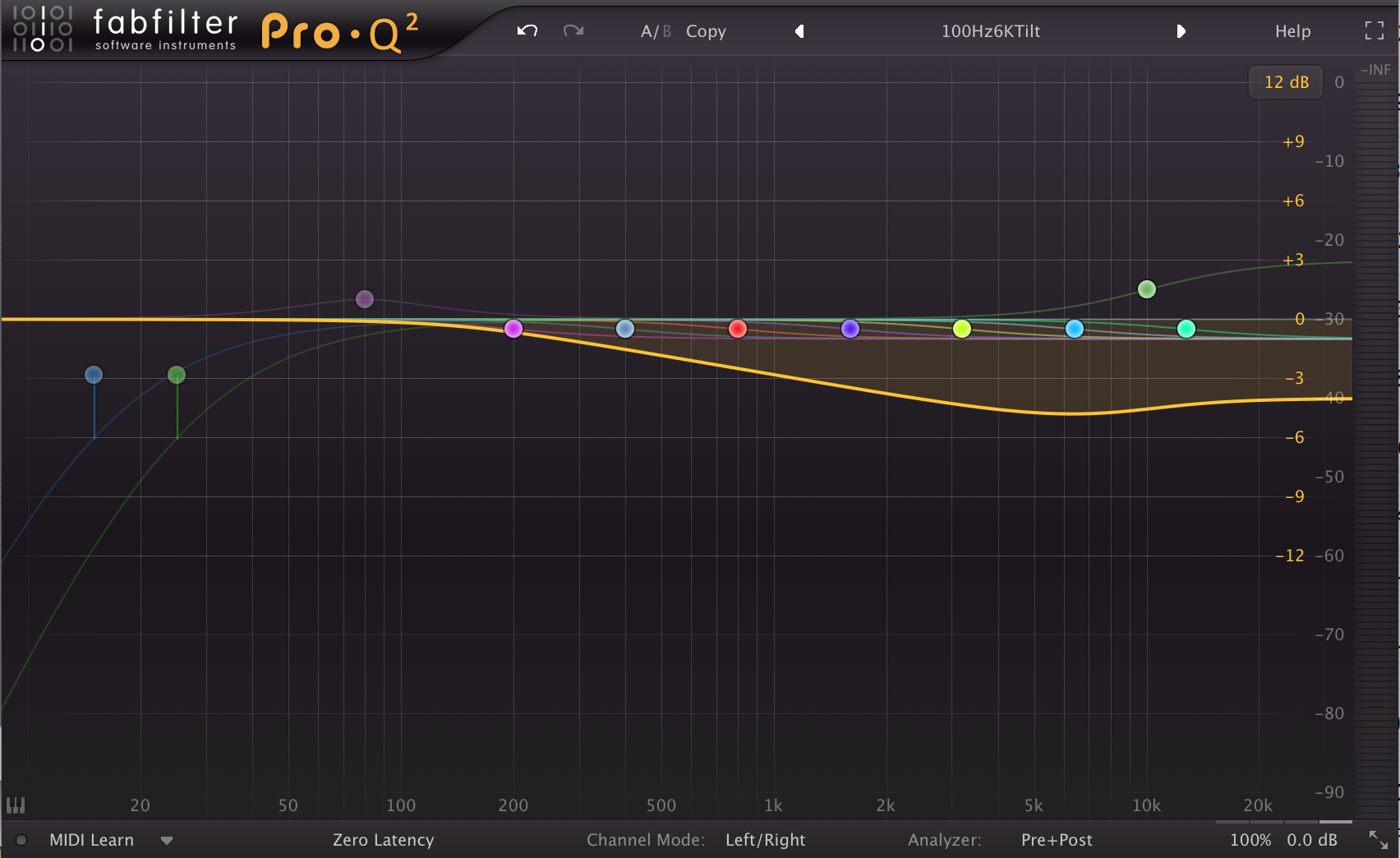

I'm using the flat target DRC filter and applying minimum phase target EQ over the top. That has the advantage of being able to switch between the target presets more easily without the long delay of switching convolution files.
I've attached some examples of the targets I've been trying, all sound different, nothing is quite right on everything yet, maybe that is an impossible task 🙂

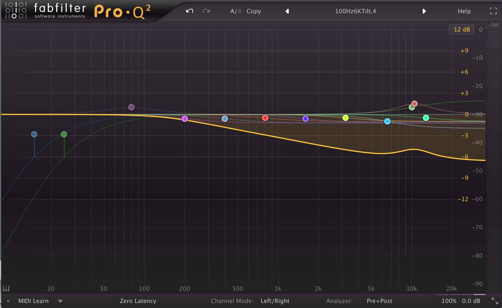

I checked out fab filter pro q. It looks really "cool". I've been using JR's parametric eq for quick tweaks but its problematic because you can't visualize the filter shapes so its shooting in the dim unless you take time out to measure.
And I definitely need a way to try different target curve shapes easily. I notice all of yours start down at 100 Hz and go down about 6 db before flattening.

it's a little expensive, but I highly recommend the FabFilter ProQ2.
Very well done plugin and behaves as it should, whatever settings you ask of it.

Well, I can't find the post, but if memory serves me right, Byrtt said to add a small 2 or 3 dBs high shelf, and use the Linear Phase - Maximum Latency option in ProQ.
In my experience, this has really cleaned up the vocals and they come right and clear.

I have pro-Q3 and the Flat Tilt filter is interesting but I don't find it easy to use for this purpose as it tilts from a point up and down either side. I want the EQ to go down from a defined point so I have used a series of 12dB High shelf filters spaced an octave apart with a Q of 0.707, the gain then sets the db/oct slope of the tilt and can be "bent" by using different gain values at that point.
I have recently started using kilohearts Carve and Slice EQ. Slice is quite similar to FabFilter, whereas Carve is a Graphical EQ that you can literally draw the shape of on the screen. Both can be bought together for quite a reasonable price.

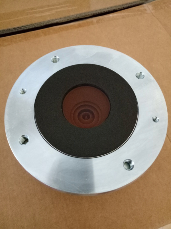

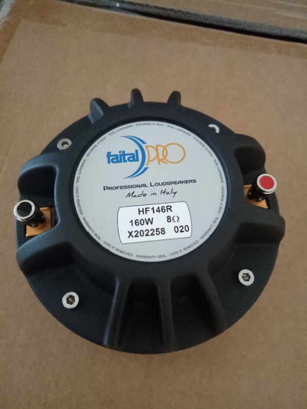

On an unrelated note I have been inspired by camplo's 2 way thread to build a high efficiency design, I've have XT1464 horns for a long time and just got some Faital Pro HF146R compression drivers delivered today, the price was too good not to try
So now I have to eval Slice EQ🙂
Your HF146 strikes a cord. I have a pair of SEOS18's 1" throat waiting to be synergized. But is that the right horn to put all that effort into?
Big question for me is how large does the horn have to be gain sufficient leverage over the room. Since we know the room can be conquered with horn-less line arrays, the question is more about vertical directivity or pattern control or ceiling treatments. The 1464 horn, I think, is almost square which makes it a good choice for use with a vertically expanding array of woofers.
I would love to see an 18" or 24" printable square horn come out of the Mabat thread, with a 2" throat so it doesn't need to be synergized.
