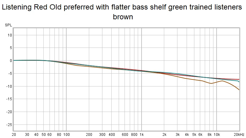

The newer psycho filters were not a resounding success, ultimately they are not preferred to the old faithful recipe. It has highlighted the issue in the high treble that I am hearing on some material. More experiments with top end windowing are in progress to see if anything can be improved there.
An interesting shot of some target curves below (well to me anyway 😀). The difference between the old preferred target and the new listening curve is very small the only change was a reduction in the bass shelving which was higher before and was the thing that I struggled to get right before. Compared against my best try at a Trained Listeners curve, not much difference there either but it is too bassy for me. The difference between low and high is just a touch too much.
Given that these were done in two separate locations with two very different rooms I am a little surprised that I was able to tune them that closely by ear to what I obviously consider to be right 🙂

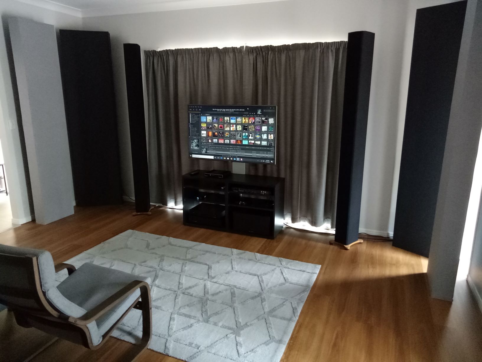

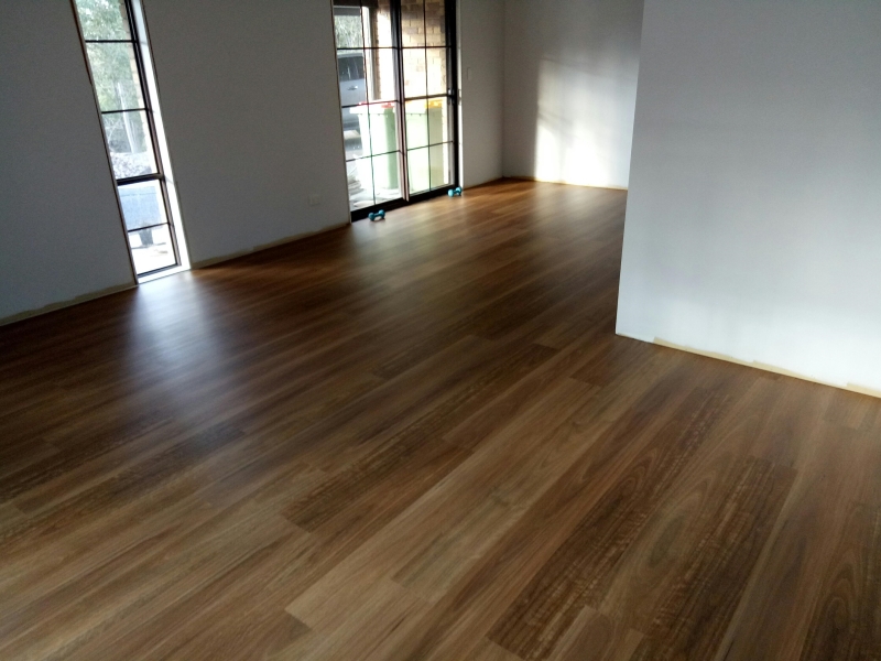

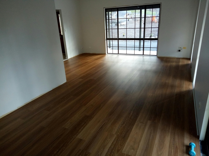

I have been renovating the room I use for listening in, took it back to the gyprock and concrete. Carpet tiles and old fireplace are gone, replaced with Hybrid Flooring.
I have been reminded how much damping ordinary everyday items provide. With a concrete floor, full height windows and nothing else inside made for a very impressive echo chamber 🙂

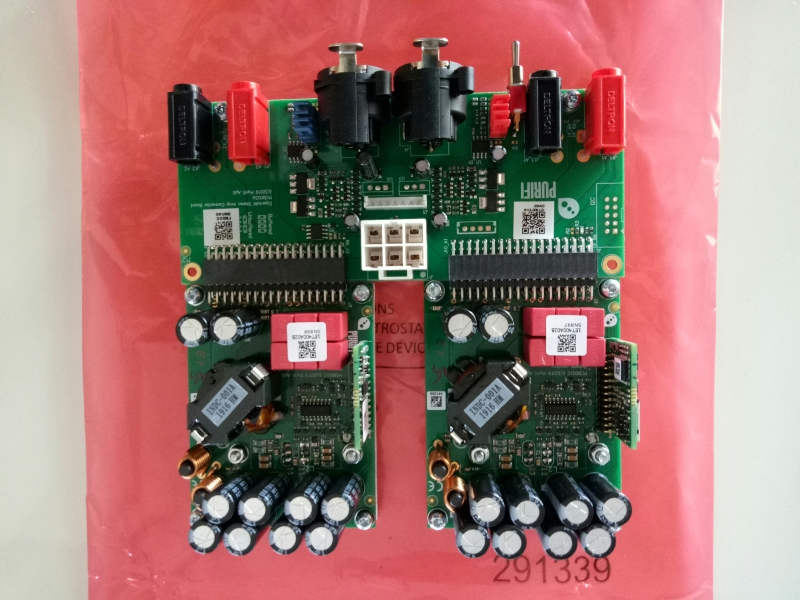

I also bought myself a new toy to play with 🙂

:up::up::up:... Renovation looks good
Looking good! You're quite some time ahead of me 😀. Nice work!
Thanks guys! So much work still left to do though....
nice toy you got there, enjoy and have best build process with that purified amp signature..
This should be the easiest amp I have ever assembled electrically. Hardest part will be getting the chassis holes in the right place. I couldn't find a Taobao seller that would CNC the holes on a one off case in the size and colour I wanted this time, so punch and drill press it is.

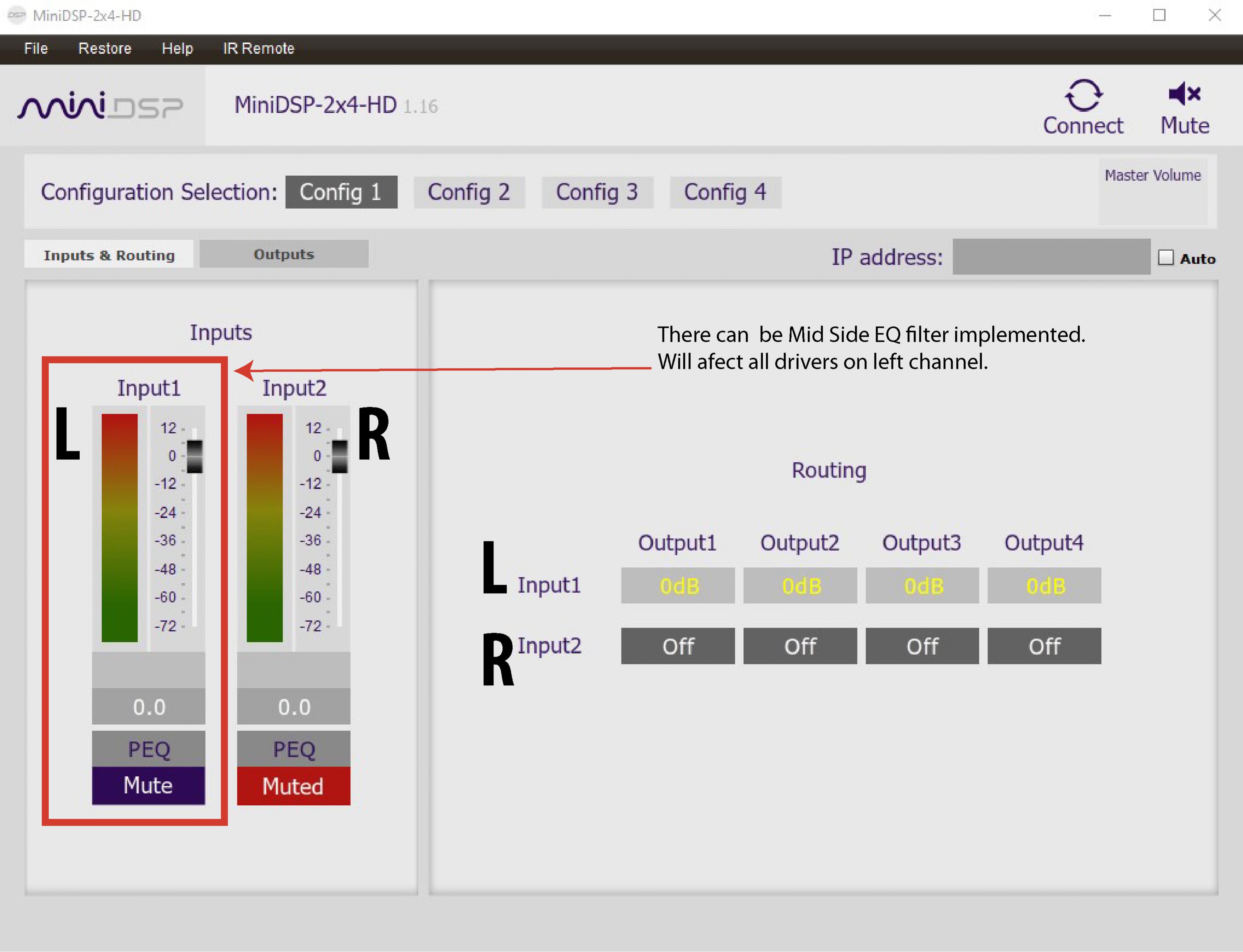

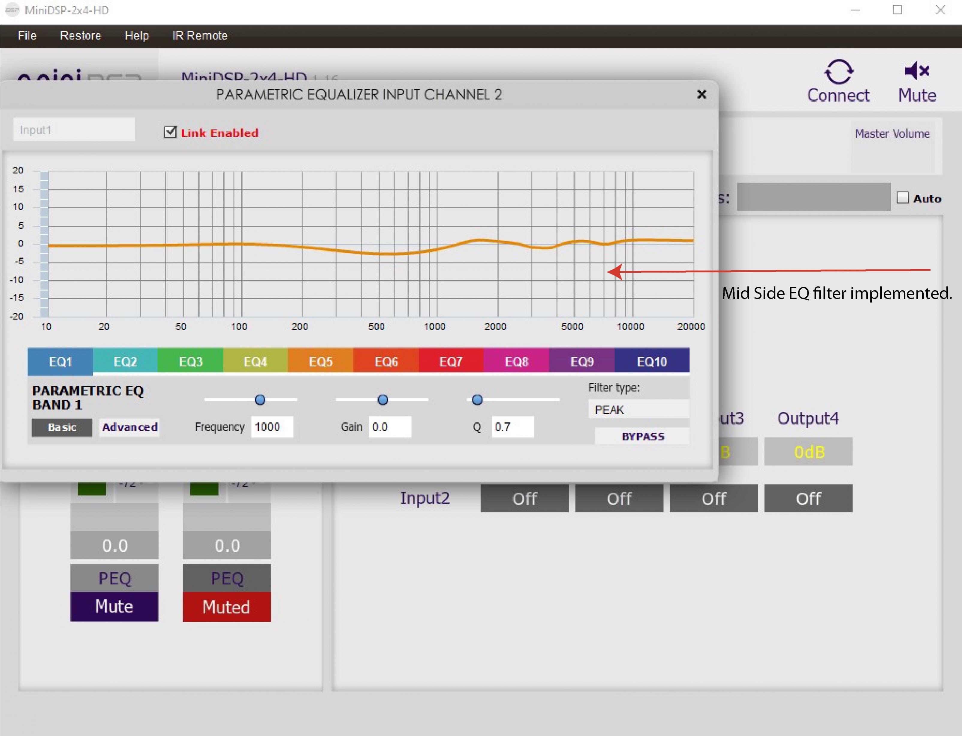

I'm not really sure what you are showing there, there needs to be a way to decode the Left and Right to Mid and Side process them separately and then recombine them back to Left and Right.
Yep..that MiniDSP won`t do..:sorry: but can do this filter :
Low Shelf 80Hz Q 0.70 Gain -0,5
100Hz Q 0.5 Gain 0.5
600Hz Q 0.5 Gain -3.0
1550Hz Q 1.5 Gain 2.0
High Shelf 2470Hz Q 0.5 Gain 0.8
3000Hz Q 3.5 Gain -1.0
3700Hz Q 2.7 Gain -2.0
5500Hz Q 4.0 Gain 1.0
7200Hz Q 3.0 Gain -1.5

No worries, it is the processing of the Mid separately to the side signal which is the key to the EQ working to reduce the darkening of the phantom centre when early reflections are reduced.
Also the Q definition of the MiniDSP is not the same as the equalizer the settings were programmed on so they will be similar but not quite the same. 🙂
True...those Q definitions is not the same among different hardware ...
Can get crazy really fast when for same one "Q" means "Q" or for other one it is a name for a beer ...😀 Industry should agree about same standards...
I have not tried to put the absorbers directly behind the arrays, when I do some measuring I will move them around to see what the effect is. I put the room back mainly the way it was before in the hopes that the existing filters would work and so far that seems to hold true.
I have tried it, while making measurements. Not a big difference strangely enough...
I even put fiberglass absorption on top of the arrays and measured it that way. There aren't many places that I didn't try while measuring it on the go.
Not with a finished panel like fluid shows, just some raw fiberglass panels moving around in the room. (on a day that I was all alone in the house)
So no absorption needed behind the arrays was pretty acceptable for me. I relied on the measurements to show me that.
The only influence I could find from the back wall was bass support. That determined the baffle from wall distance for me.
