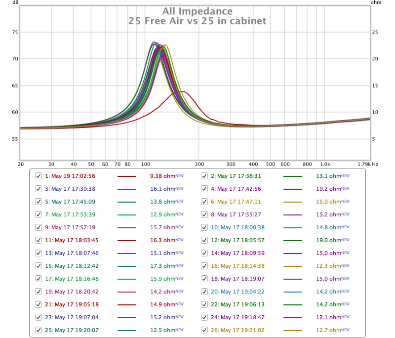

The drivers free air resonance goes up when placed in a box, the TC9 went from 124Hz to somewhere between 140 and 170Hz.
It is hard to say exactly what will happen for another driver. The closer the tolerance of the drivers the less likely things will change too much.
Here is an image of the individual impedances along with the combined in box impedance
Thnks. So it look like you're showing that even with 25 drivers together the impedance bump still went higher in a cabinet. It looks like multiple drivers has little to no effect on fs, unless the cabient was very small. The red curve is 25 together right?
Yes the red curve is 25 together in a cabinet. The effect of multiple drivers is to spread or flat top the impedance peak in comparison to a single driver. The only reason there is a difference is due to the drivers not being exactly the same. Theoretically if they were perfect there would be no difference.

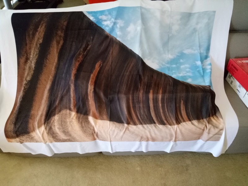

Here is large piece of printed fabric to be used in a panel on the back wall as it is very close, part of a significant attempt to reduce early reflections

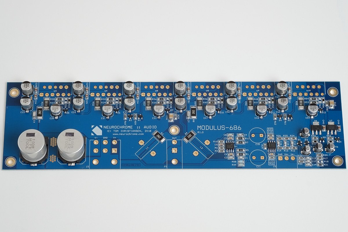

A pair of MOD686 boards from Tom Chr

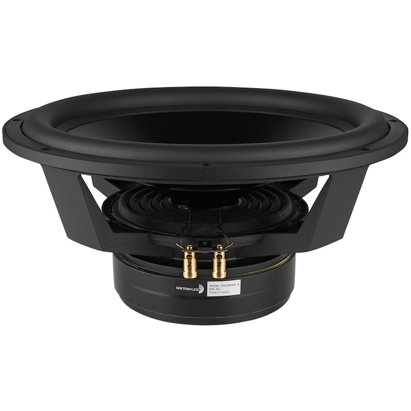

And a pair of Dayton RSS390HF-4 subs, I have procrastinated about these for ages and a 10% offer tipped me over the edge, Vd of 1161cm3, each about 4 to five times what a single array can do

Are those nice mod686 power amps intended to drive arrays or subs or is it for both ?
I hope they are for the arrays. If I didn't have the Goldmund clone, these would have been on my wish list.
Hope the money was not spent mostly on the fabric! 😀
Jokes aside, Tom's Mod-686 should be a good addition to your system. And that 15" Dayton sub looks like it means business... your house is about to get a mighty wallop... that is when you've done some building and ready to rock and roll.

MOD686 is for the arrays
Yep arrays, they might resemble the Goldmund clone a little from the outside as they will be in a 5U chassis that I already have.I hope they are for the arrays. If I didn't have the Goldmund clone, these would have been on my wish list.

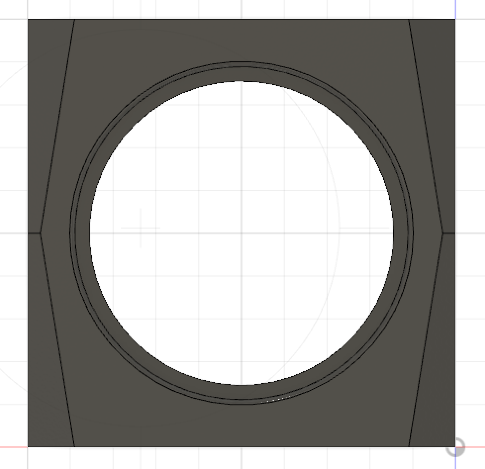

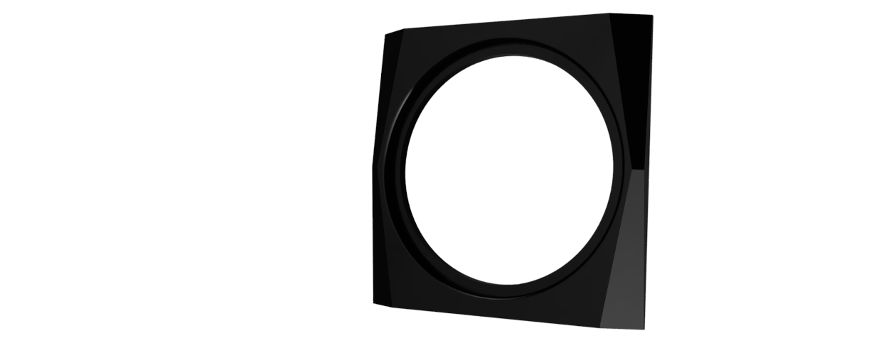

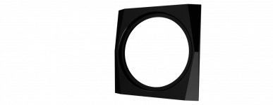

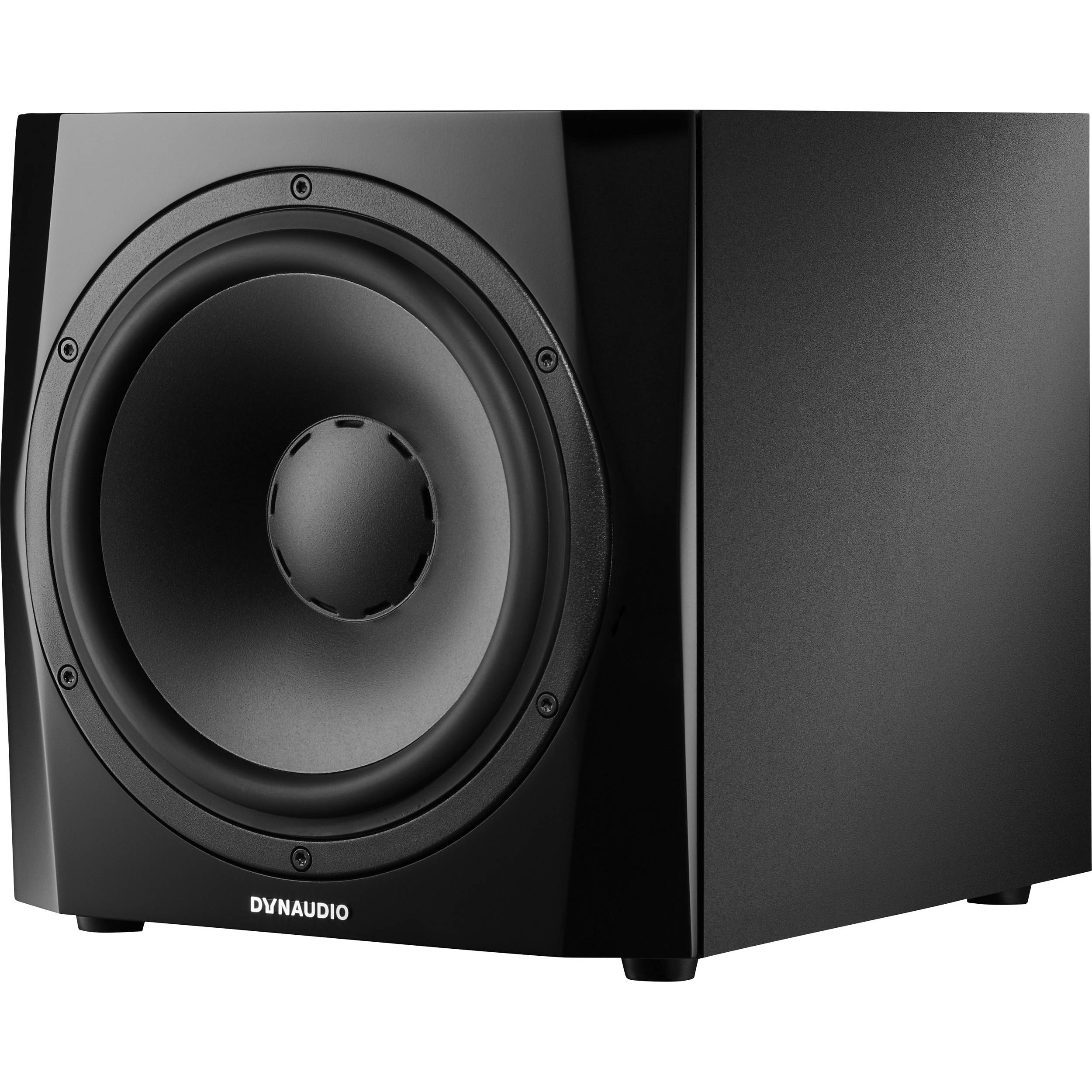

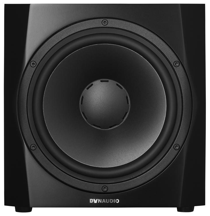

The sub drivers should be here soon so I have trying out a design
I am thinking of this for the front panel
Inspired by this Dynaudio sub, mine will be much bigger though 😀
Two laminated pieces of 18mm MDF for the front baffle. Everything else works out to be too expensive.

Should look nice with the chamfered/faceted design you've done.

Thanks Zia I am trying to build something that doesn't just look like a big square box! Which is hard when it is big and square 🙂
