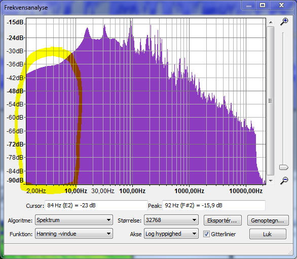

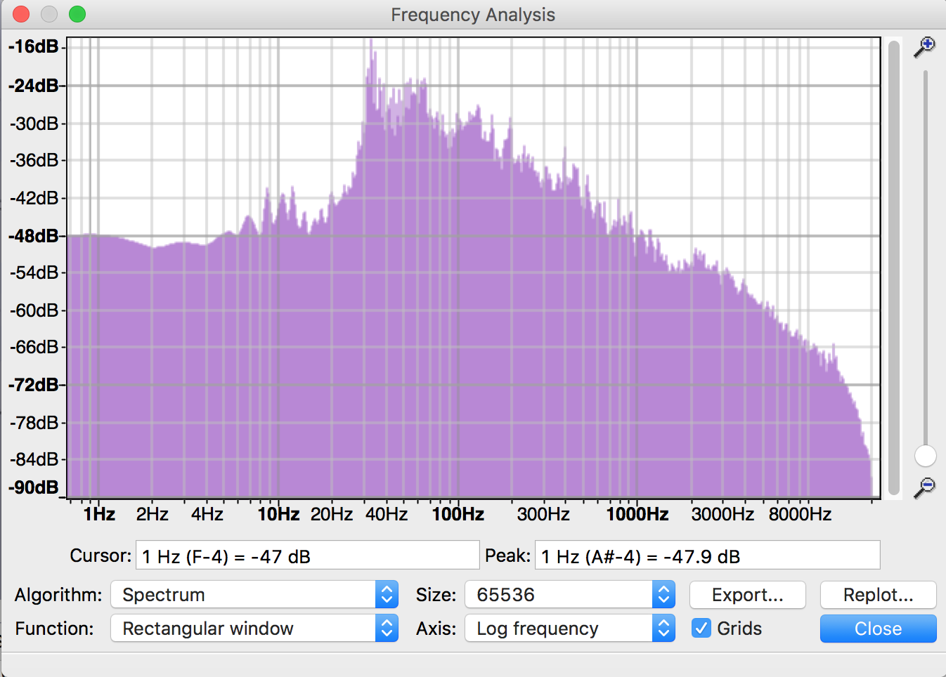

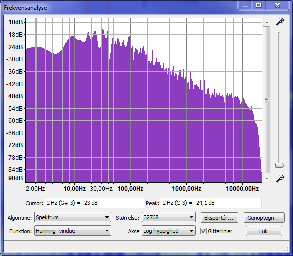

I may have found the cause of my amp shutdown issue, not 100% confirmed yet though.
It has happened every time I played Flamingo by Infected Mushroom, which seemed a little too coincidental hmmm....
So I checked the spectrum with Audacity and got this, that level of ULF could be enough to trip the DC protection in the First One 1.4 as it is DC coupled. Time to try a steep High Pass at a low frequency and see if that fixes it.

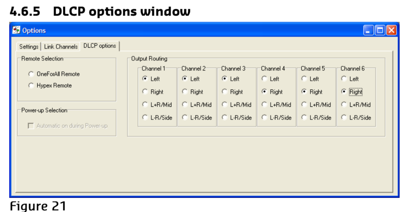

Neat. Thanks for the plugin offers but I currently don't have a platform to execute them on. My Hypex DLCP has possibility to extract and EQ m and s stream but no way to combined them again - not that I can see anyways. And EQ would not be FIR.
I'm thinking about a MiniDSP OpenDRC-DI....
A'm not really sure what these options do actually...
