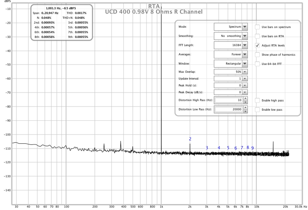

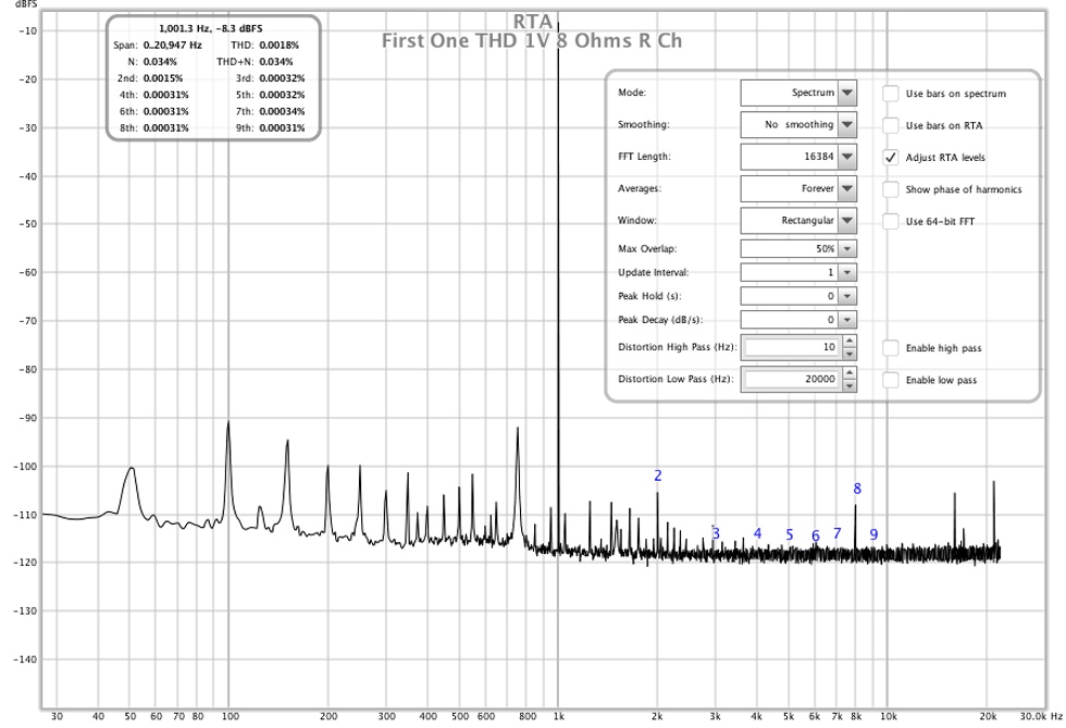

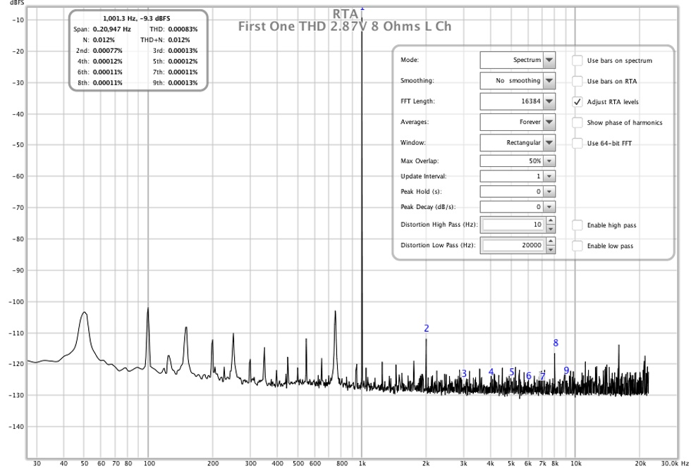

I did some REW testing of my amplifiers to verify the Distortion performance. I wanted to make sure that the bias setting of the First One 1.4M was correct as someone else had seen quite a change in distortion due to biasing.
It is tricky to do because the VAS bias changes with temperature and getting it to be stable takes time. This also means that the amp does need some time to warm up before it sounds right.
I saw no discernible change at 1V to 2.83V with bias between 18ma and 29ma so I set it at 18 which is the standard, overall bias is 280ma which is why it runs warm. The left and right channels give different results and the test setup was not ideal from a noise perspective so I will redo it later on for more conclusive results. Distortion is pretty low and only rose to 0.05% at 25V on an 8 ohm load.
Here is the best result I got from the First One which is really very low at 0.0008% at just over 1W. Given that the soundcard itself shows 0.0005% on loopback through the analyser, meaning only 0.0003% was due to the amp. This must have been a sweet spot or getting the grounding right because no other readings were nearly as good.
I tested the UCD400 at 1V output, and overall it looks very good. Only the tiniest bit of 2nd harmonic and the differential input seems to have done a better job of suppressing power supply noise with the noise floor being flatter below 1K, either that or the Hypex power supplies are considerably less noisy. I might test a differential input for the First One later to see if that evens it out. The spike at 16K appears in most of the measurements not quite sure where that is coming from.
The First One at 1V measures about the same but with lower noise.

Edit to post above First One at 1V has peakier noise not lower.
This is where the measurements can't be used solely to determine perceived sound quality.
The UcD looks better but it does not sound as good. I do prefer the First One, the bass is better and overall the sound is smoother, both are very good but there is just something about the UcD that I don't like as much, this has been the same on every speaker I have tried it with.
