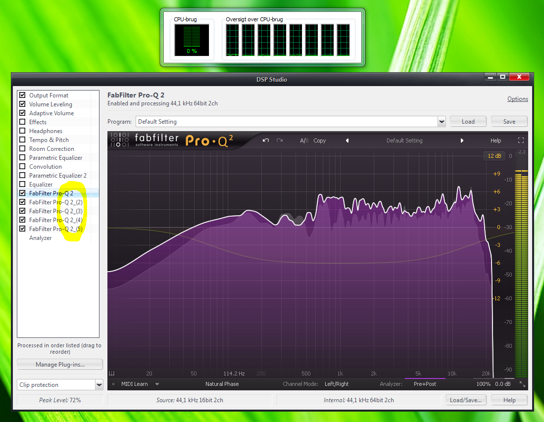

Have a little tweak to share for Jriver if some didn't know about it, when we load a VST in a DAW we used to it works multiple times on as many channels we want to use it, in Jriver its possible chain same VST multiple times by rename dll-file multiple times as long as CPU power allows load, in DSP Studio/Manage Plug-ins point to all the renamed dll-files and they show up as in below example where its loaded five times in a row shown with yellow marker : )

Byrtt that is a good tip and would probably allow the free Plugin Equilibre to work with the full mid side EQ as you could chain two plugins together to get the required number of bands within Jriver.
I could use it to get rid of metaplugin from my chain as I only had it in there due to Fabfilter having a limited number of bands for my pre EQ.
