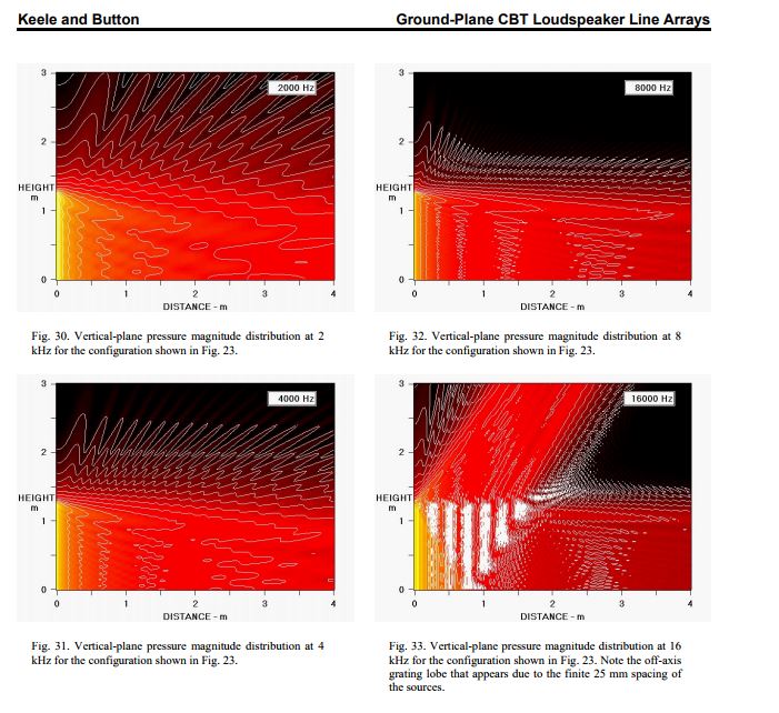

*Each perfect reflecting surface should give a 6 db rise in SPL. So that should be 6 dB for floor + 6 dB for ceilling = 12 dB. (Assuming a perfect reflecting floor was not found outdoors)
*The 45 degree Field at wavelength same as element distance was interesting (16k in the paper, but much smaller element distance)
*Put a thick carpet on the floor between you and your multiway speaker🙂

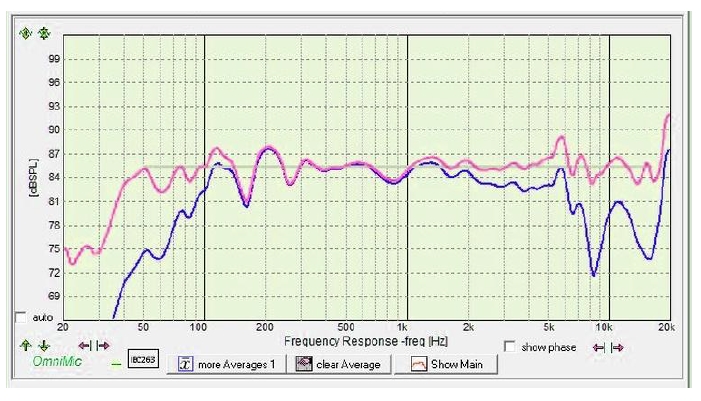

The graph you linked that shows the dip around 500 to 600 is interesting and shows part of what I was saying about the averaging techniques. Impulse averaging weights the dips more heavily. Even though you can see that quite a few of the measurements have peaks at that same location. The dips outweigh the peaks with impulse averaging.
I don't know if DRC is smarter than you but the algorithm works well because it leaves that area fairly well alone. It has made it better but has not tried to fix the unfixable.
I think DRC correction is another area where you are assuming facts that are not in evidence here. This is predominantly speaker correction and any room correction is only really done over a very short time period. It was wesayso's more unconventional approach to using processing that attracted me to read more about arrays and I saw enough in that to build my own.
As wesayso said the measurement was based on an average and it won't be totally different 2cm to the left. It will be different but the amount will be less. That is no brute force correction to make everything flat no matter what. This is what is good about speakers that have well controlled directivity whether it be narrow or wide. The reflections are broadly similar to the direct sound so they are less distracting. They also respond better to correction because the power response and DI is flatter.

Array boundaries: Keele uses and models one boundary with reflecting index 1.
In real world that means granite or marble floors like in churches or large buildings.
This kind of reflecting index is not often found in small domnestic rooms.
If both floor an ceilling has index 1, e.g. both are flat polished granite, the room will be very hard to hold an conversation with more talking people inside. So very few rooms are made that way.
That floor and ceilling should also give you a 12 dB rise in SPL. Look like you have about 4 dB rise and it is not uniform at all frequencies. So I think it is safe to say that boundary condition of reflecting index = 1 is not met.
So then the array/room will generate reflexions from floor and ceilling that is different from the reflexion described by dbkeele

I would like to see the measurements of your system as it might help to understand where you are coming from. If you can't or don't want to show I can understand.
Hi Torgeirs,
I made some measurements to determine the changes in response with height for my floor-to-ceiling arrays. See here (starting post 127):
http://www.diyaudio.com/forums/mult...line-array-using-vifa-tc9-13.html#post4584857
In post 129, there is a measurement very close to the ground and you can see there is considerable drop in response there, which means the array is directional. If you look at the impulse response (not posted by me in my thread), there is no reflection where you would expect one in the array measurement. It is definitely there when measuring conventional cone/dome speakers in the same position.
