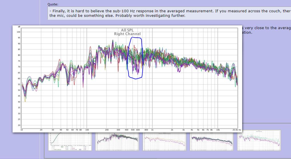

As of the DRC comment:
Inside the listening window, the sharp notch created by the back wall varies inside 500 to 650 Hz. That is 30 % span in frequency for a sharp notch summing filter. (Sum of direct and reflected sound)
The time spike will have to move accordingly to generate ONE dip between 500 and 650 Hz.
Even if DRC is time correcting it is still convolution so can only be perfect in one place in space.
But then again, maybe DRC is smarter than me🙂
Anyways as I am sure DRC is not created with arrays in mind, I am impressed if it works flawlessly with one.

Why do you think I worked for more than half a year optimizing settings in my own DRC template. Other than that, its still math whats being done here and why should it not apply to arrays? I'm close to giving up here. Do you want to learn something or in it for the argument....
A DRC discussion is completely separate from the arguments you're trying to make.
Even with that wall reflection (which is absorbed in my own room) your assumptions are wrong. It will be valid for every position that has that reflection in that same time span. You do remember this being the result of using an average of 9 measurements, right? I'm thinking you don't get what that averaging does. Its very similar to what the arrays are doing with their multiple full range sources.

wesayso: I understand your argument if:
*The array are real floor to ceiiling with less than one element gap between element and bounadary
*The floor and ceilling is made of untreated concret. Or other stone hard and decimeters thick material.

All I can conclude from the measurements in other posts is that floor reflections are hidden in the floor reflection. Hidden is not the same as non existent. (But in this case I don't think floor reflection matter as the other reflexion dominates)

I also made several measurements with an absorbing panel above the array to see if it would make a difference. Guess the outcome of that experiment.
