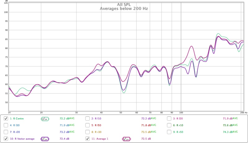

- Regarding the sub-100 Hz response, I do see significant variation. For example, if you look at your individual measurements between 30 and 40 Hz, and between 60 and 80 Hz, there are significant variations of up to 20 db. This is what I would expect. Maybe in the earlier measurements, the single measurement was close to the middle of the couch and the average just happened to be close to it. But you can see how correcting the average in this region will not be optimum for different positions.

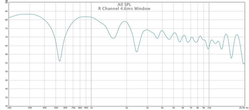

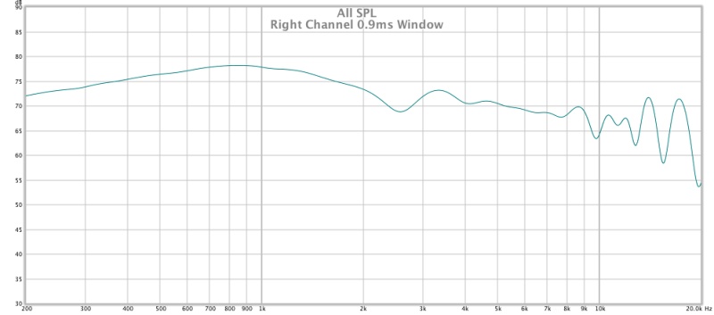

Windowing normal time response and looking at the freq resp. will give a clue of the HF spectre of the reflections. So the trick is to start the windowing just before the reflections (as if they where the main lobe in the time responce)
The length of the window gives the frequency resolution, 1/T where T is the length of the window.
I have added a window at 0.9ms just before the front wall reflection
This is at 4.6ms just before the back wall reflection
Is this what you wanted to see?

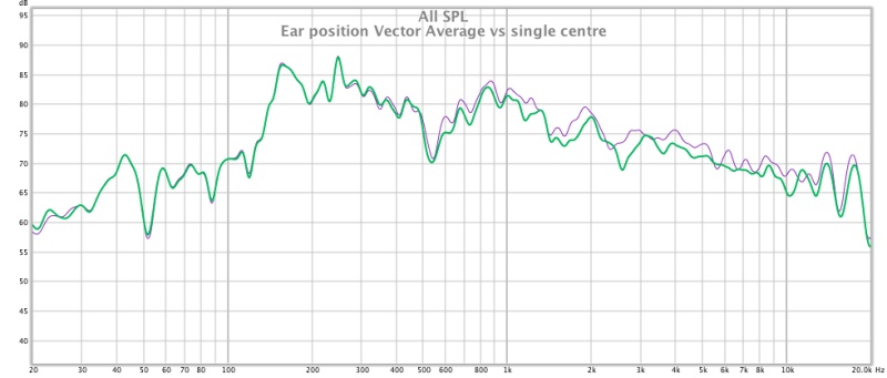

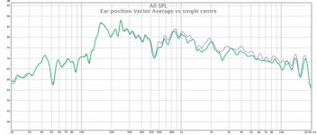

I would have to disagree with you below 300Hz as those graphs are actually much closer in agreement. Distances set the modal behaviour which dominates below the transition.
The main difference between the averaging methods is how dips and peaks are treated. The impulse averaging takes account of phase and weights the dips more heavily. The basic frequency average weights the peaks more. In either case it is actually beneficial to try "optical" averaging where you look at all the curves together on the screen and your eye will see the general trend quite well. You might well ignore a peak or a dip that is prominent in one of the mathematical averages.
The more variation there is in the measurements the less reliable the average is. If you have 3 measurements, +2, +2 and -4 you end up with zero as average. Not a good representation of any of the numbers.
In the graph above you can see that the frequency average has a peak at about 112Hz. That is because there is a peak there in most of the measurements, the impulse sees it differently.

To me spatial averaging works better at reducing the room contribution while still maintaining higher resolution. FDW's work more to represent how we hear and reduce resolution in the measurement. I find they actually work quite well together rather than being an either or choice.
Obviously you can get a more specific correction if you are shooting for only one point in space. Some of the negatives attributed to room correction are partly based on this. Move an inch and it's not valid. What my results show is that I could use a single position measurement and it is pretty close to the average in frequency response when smoothed. The time response is a different story though and because I will be doing time correction I want that to be a little cleaner. If I had a lot of treatment it probably wouldn't matter.
You don't hear what is in the middle of your head you hear two things separated by your ears processed by your brain to make sense of it. If you are aiming for a single seat correction I think the best way is to do an average of both ear positions rather than one point in the middle. This graph shows the difference between an average of 10cm to the left of centre and 10cm to the right vs a single position between the two. The main differences are in the 1.5 to 5K region so they will impact perception and be quite audible.
The impulse averaged measurement includes all the strong reflections the ones from the main boundaries. What is averaged out is what is different between the positions the tiny differences that only matter at that point in space. I think you seem to be missing that point and it might explain why you can't see a benefit from the impulse averaging procedure.

I didn't mean the graphs are different below 300Hz. They are very close. However, above 300Hz, they are different. So, a target curves based on the two different averaging methods will have different performance above or below 300Hz depending how you see it.

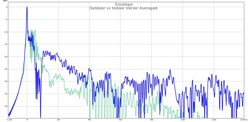

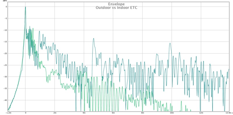

Here is ETC of the outdoor and indoor single Centre measurement. What I see in this is that the very early stuff is the chatter that occurs because there are 25 separate drivers with time of arrival differences. Then I see a reflection at about 0.96ms. This corresponds with the front wall distance. Then I see another at 4.66ms this corresponds with the rear wall distance. I do not see a floor reflection. If I was to treat the front and rear walls I could probably get rid of most of the early reflections acoustically.
Now here is the outdoor vs vector averaged ETC. This one is for RA7 to show that the same reflections are still there they are just at a lower level and the general chatter has reduced quite considerably.

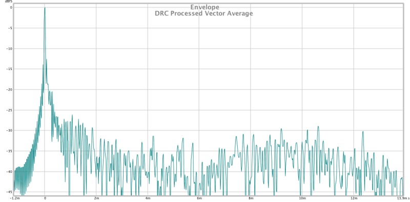

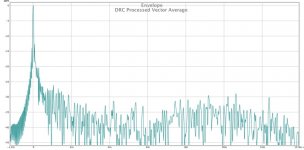

And then here is the reason why DRC is going to be used to help fix some of these time related issues. Where did all the reflections go 🙂

No problem happy to help if I can. I think the graph in #678 show what I am talking about quite well. In all the graphs there is a hinge at the transition frequency where the overall trend of the line swings from.
The impulse average leaves all the dips in which are real and mainly caused by reflections so they need to be treated carefully and not just filled in with EQ.
The level steadily declines as more of the overall reverberation effects have been averaged out. When a correction based on the average is played back in the same room the reverberation will be added back bringing the overall level back up.
The basic frequency average ignores all the dips because there are corresponding peaks in other positions so they end up at zero which isn't really correct anywhere. The level is higher because the reverberation effects are still there and do add together because they are quite dense.
Where and how to draw a target curve has a lot to do with taste, but you can see how the general trend for the reverb is to add more and more to the level as you go beyond the transition so it makes sense to have a target curve that is somewhat the opposite of that to end up with a flatter perceived response.
Ok, so its the back wall that is the main offender. But is it the only one?
Can't rule out the floor from the ETC as the reflections are as high as they are between 1 and 3 ms.
Actually I meant starting the window at the points you have stopped them.
But this is also interesting.
I am supprised the dip is that big, caused by front wall reflection.

Torgeirs, a hint, you're not looking for a single floor reflection in the ETC. You're looking for 25 of them 😉. And to make things worse, they are destined to look like the output from an array of 50 drivers.
The ceiling reflections would be a similar story, though they might be easier to find due to the gap between the array and the ceiling.
They won't look anything like the usual speakers show you and will be down by 25 dB Or more. Good hunting! :-D

.....And then here is the reason why DRC is going to be used to help fix some of these time related issues. Where did all the reflections go 🙂

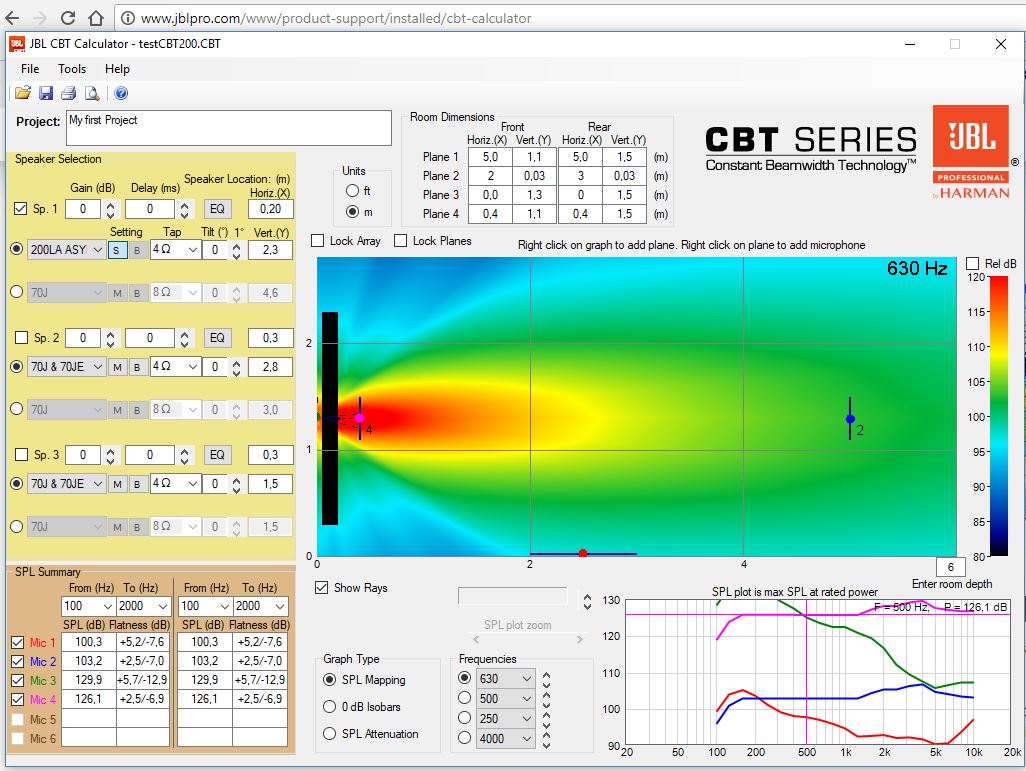

I downloaded the JBL line array program,CBT and made simulations with the 200LA that most closely resembles your array.
See the SPL at floor reflection is down about -6dB so that's quite a nice attunation.
I also had an explanation for the extreem back wall reflection mid speaker.
As you can see the SPL is the same 20 cm behind the speaker as 20 cm in front of the speaker at 500 Hz.
