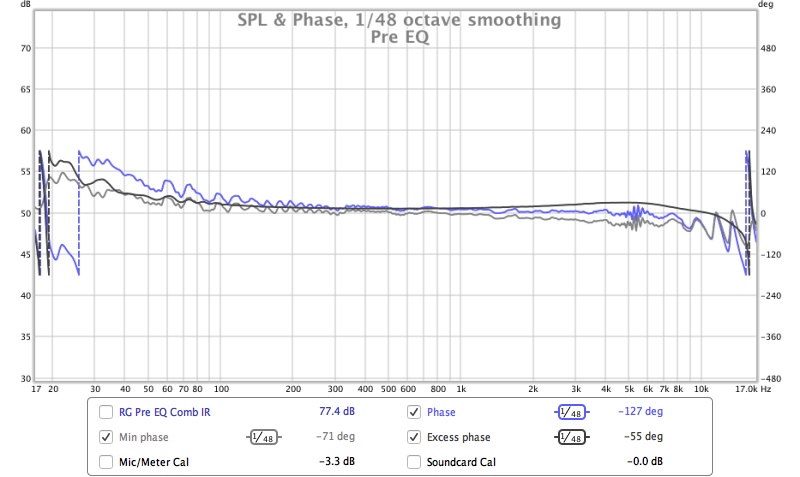

It was a test to see what DRC processing did to my "virtual ideal room measurements".
This is what I did:
Outdoor measurement convolved with EQ to mimic the predicted room gain. (An attempt to avoid excess low frequency correction like in the original rough EQ that was nearly flat to 20Hz outside)
Basic Pre EQ in REW to generally straighten things out and bring it closer to flat making DRC's job easier. Convolve that EQ into the impulse to feed to DRC.
Clear as mud? 🙂
I don't know if it just the scale of the graph the FDW or something else going on that makes it look that straight.a comment could be the purple correction would probably improve a bit in rhytm feel if phase exactly follow amplitude using "Generate minimum phase" button to show the phase target differences from that pretty straight purple phase curve, that said take your time to investigate the different corrections and comparisons.

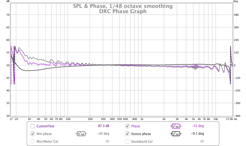

Here is a non windowed phase graph with the DRC corrected version and the REW generated minimum phase. They are not really that different and there is no excess phase correction in the filter used. The low rolloff goes towards 180 degrees but the top end does not. I think that is partly due to the comb filtering the general trend goes down but keeps bouncing back up again.
What I find a little strange is minimum phase is above the DRC corrected phase but below the Pre EQ phase hmmm.

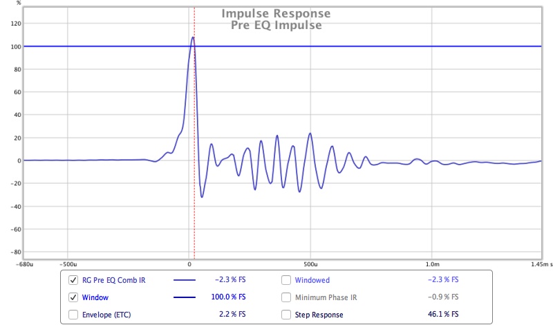

The impulse is interesting as it has changed the pre ringing into something different but it has done a pretty good job of straightening it out. Maybe it's the double sided windowing used?

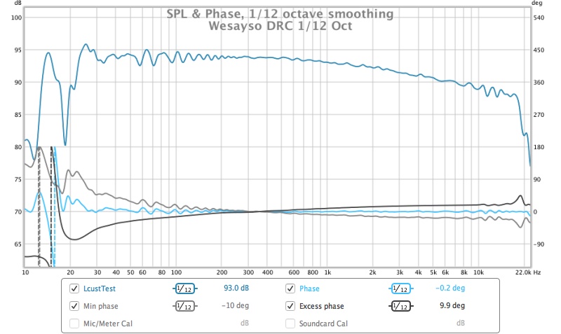

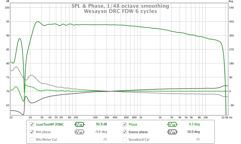

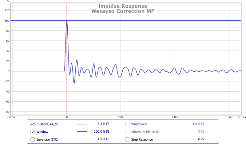

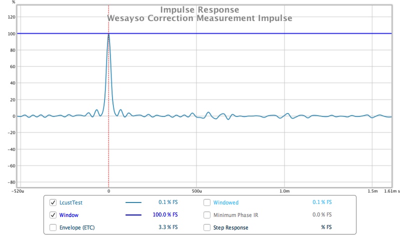

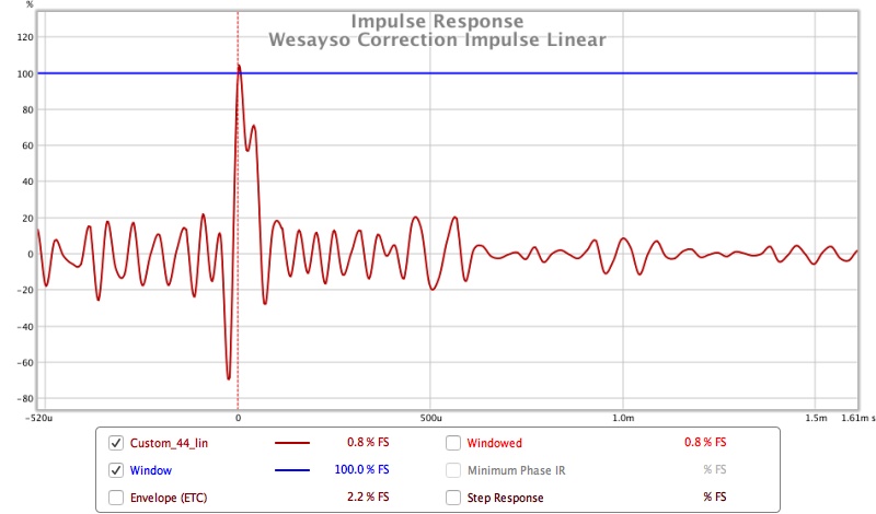

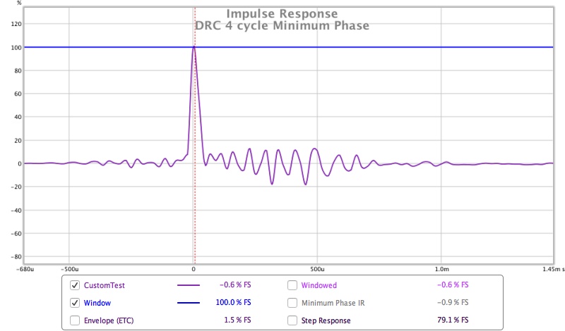

I ran the same virtual measurement through DRC with wesayso's sample template.
The longer windows have smoothed the response out even more. I made a minimum phase version to compare to one with excess phase correction.
The frequency response and phase of both came out identical even though the correction impulses are really different. Both deviate from minimum phase of the frequency response so I will need to see if there is something I can do to change that in DRC.
1/12 Oct Smoothing
6 Cycle FDW
Corrected Measurement Impulse
Linear Phase Correction Impulse
Minimum Phase Correction Impulse

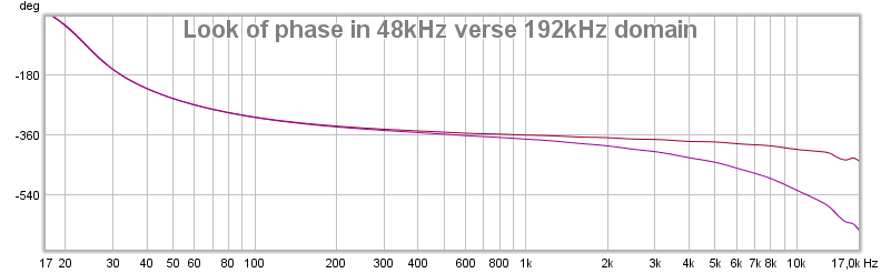

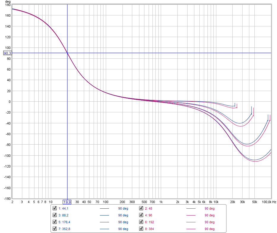

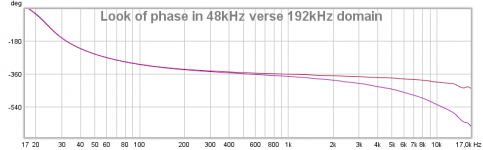

About why would the sampling frequency have an effect on the generated minimum phase of the frequency response?
I'm not good into subject but over time have observed the differences that happen, and it looks phase at HF part always start out at zero degree point at the selected sampling frq and also we know that above half the sampling frq there will be no amplitude data to calculate phase. To show the differences created all eight possible sampling frq over in Rephase and imported to REW, they based on 20Hz-20kHz BW2 band pass so we know phase should be exactly at +90º/20Hz in low end and at -90º/20kHz in top end, as seen in top end it goes wrong and no one is exactly at -90º/20kHz point, only into Rephase phase curve in top end looks right. Could imagine because of those differences that to get best precision creating target curves and manipulating curves with math that its best to always use same sample rate into simulation as is used for measurements.

Byrtt, thanks for the graph it does show quite a big difference and I think you are right to match sample rates in virtual simulations to those in the application with such a variation. I don't understand why it happens, but to know that is how it should look in a graph will have to do for now!
In some ways losing those posts is not an issue as I have found the reason why the phase in DRC won't follow minimum phase myself.
There appears to be a lot of excess phase in the virtual measurement at the ends of the frequency response and the overall trend in the measurement fed in is what is coming out. I hadn't realised that which is why I it made no sense!
I should be able to verify it by exporting a minimum phase version of the IR to feed into DRC.

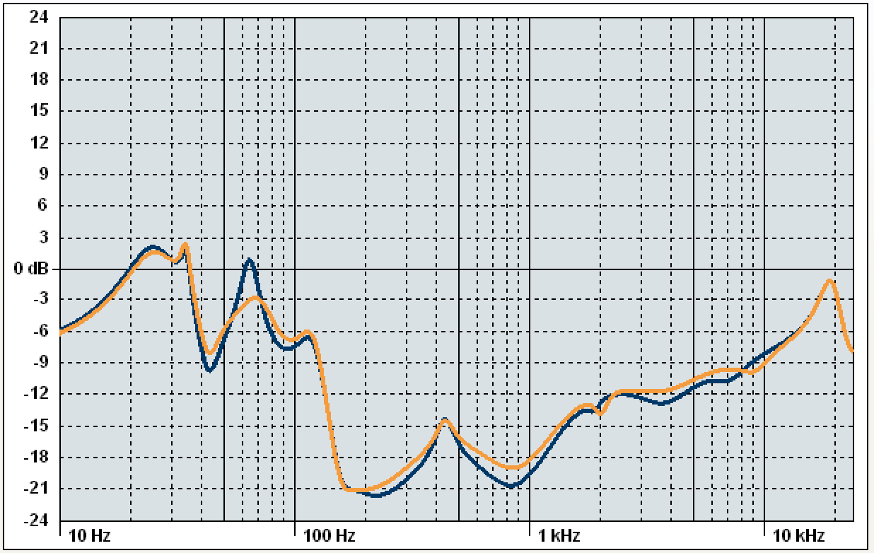

This is the EQ I have set now and sweeping REW's oscillator from 30Hz upwards the output is quite even apart from a few places where it dips and peaks a bit.

Your EQ portrays the very high Qts of the TC9. Around 0.5 would have been very nice.
And regarding the LX521, the hot high-mids may not be due to your room. The stock crossover settings are hot and a lot of people have attested that.
Thanks!Thanks Fluid, will wait for the graphs. Good lucking tweaking the arrays!
As it's electronically equalised the Q could be changed to anything. The problem is the drivers run out of excursion quickly when the frequency goes down so a Q of 0.5 would leave a lot of very low frequency boost below the f3 point. I am targeting a 24dB rolloff at 20 to 25Hz to get good extension but not risk sending through too much ULF stuff. If I went with a lower Q I would have to roll off higher to reduce the risk of over excursion. I will be trying the phase correction on the low end so in theory the transient response should be very good without the need to use a low Q alignment.Your EQ portrays the very high Qts of the TC9. Around 0.5 would have been very nice.
I was referring to the woofer crossover being a bit hot as the EQ and level interact to make it hard to know exactly the best balance. I use the HF shelving EQ as when I took it out for a flat response it was too bright. I introduced a similar correction to my Orion and that was an improvement. My Orion's are the older version before rear tweeters were added. I know the room is pretty reflective in the mid to high frequencies as seen in the RT60 measurement. It's the reason my averaged measurements change more than wesayso's compared to a single point. I suspect I would like the LX521's more if I absorbed some of the rear radiation, at some point I would like to measure them in room for comparison purposes but who knows when I will get round to that...maybe after I rewire them for 4 way active 🙂And regarding the LX521, the hot high-mids may not be due to your room. The stock crossover settings are hot and a lot of people have attested that.
