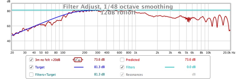

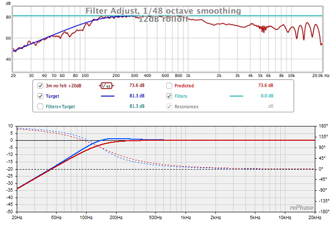

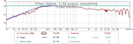

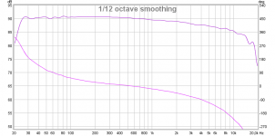

It looks like the normal 12 dB/oct closed box fall under f-3dB for single driver.
In the array outdoor measurements it looks like it falls att a higher rate. Is it just higher Q value?
I think it is just the scale of the graph that is making it look steeper.
I have calculated the Q from the impedance response and it came out at 0.8.
Here is an image with a 12dB slope with a -3dB point at 140Hz. Seems to match pretty well to me.

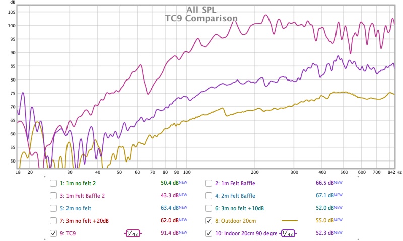

Here is a comparison of some TC9 measurements two by me at 20cm one indoors one outdoors and the other by Byrtt. They are not exactly the same.

That is true but it is not what is being done here. The driver is being driven below resonance certainly but there are 25 drivers to share the load so each one is only doing a little bit each.

Think dip between 50 and 100Hz will need other methods to investigate if its really there or not, myself live on the country and even i think here is nice silence then below 200Hz looking at a RTA is a really scary picture, and think those noise probably sum to measurements because its noise floor sits so relative high and we probably need a ladder more than few meters to get really clear of it.

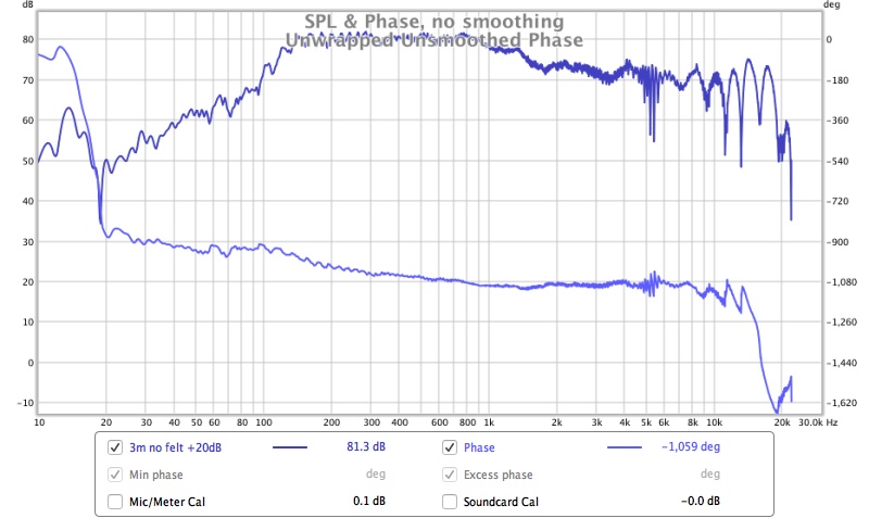

There is an important difference between an RTA and a logsweep measurement. The logsweep has an inverse filter applied and it results in a very high signal to noise ratio. It does a very good job of rejecting environmental noise if the signal level is high enough.
I was very disappointed with my outdoor measurements until I turned the level up. Once I got it up to 80dB signal I got a very good measurement.
I got these as high off the ground as I reasonably could. Lifting a 2m+ heavy tower onto a higher table is not something I plan to do 🙂
I actually think that the directivity of the speaker in the vertical plane means I can get away with it.
Here is a graph with unwrapped unsmoothed phase I think it is good to 20Hz before environmental noise takes hold. I do have plenty of others that look nothing like that though (too low signal) 😉
attachment.php
I measure my Q at 0.8 so there is a little bump before rolloff. If I reduced the target level in that graph by 0.5dB or so that would account for the Q bump.

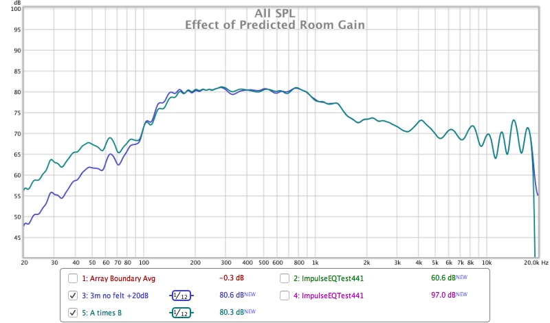

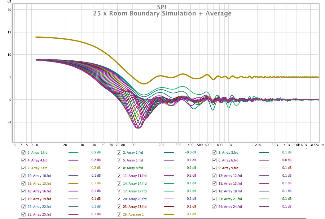

Your post got me thinking about Byrtt's room gain simulation. I read a post by Jeff Bagby recommending to switch it to power response rather than axial response which makes sense.
I used the boundary simulation only as the pressure gain was mainly below 30 Hz and was constant anyway.
I have simulated each of the 25 drivers separately at their heights where the towers are currently positioned in my room. Individually there are some horrible dips but when averaged together it is a very nice curve, yay 🙂
I think this can be used to backup the claim that the arrays work very well in a typical room as compared to a speaker at a single height. The single speaker needs to be moved away from walls to avoid interference whereas the array can be closer getting the boundary loading without so many of the serious dips.
Here is a graph of the average offset 5dB from the individual responses.
attachment.php
I then did an A*B of the array plus simulated boundary gain compared to outdoors, about 8dB of help at 30Hz.
attachment.php

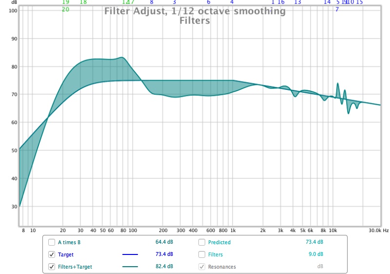

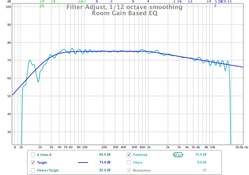

I re-did my virtual EQ based on the outdoor measurement and the predicted room gain. Much less boost needed this time. Below 20Hz is noise and not signal so ignore that.
attachment.php
attachment.php

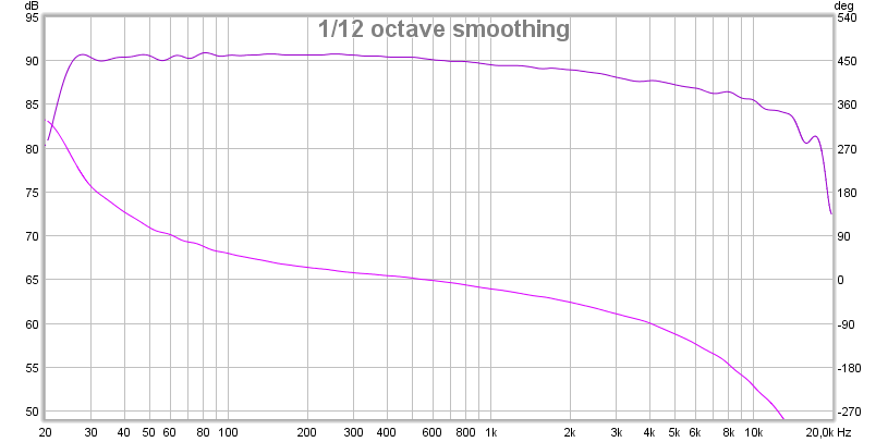

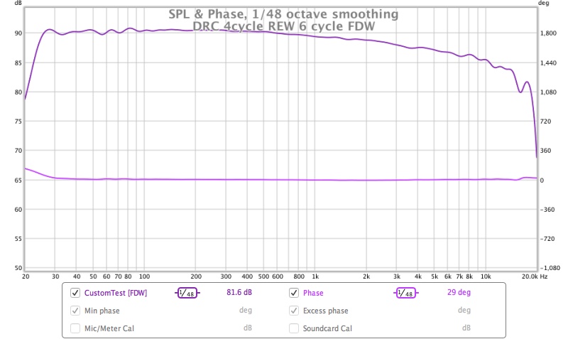

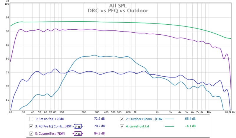

I have been playing around getting DRC up and running so I can use it with in room measurements.
Here is a graph that shows a comparison of a DRC correction (purple), vs a virtual file of an outdoor measurement combined with predicated room gain and some pre EQ (dark blue). The other traces are the outdoor measurement (aqua) and the target response (green).
attachment.php
I have used a 6 cycle FDW in REW as this shows the differences quite well, (as DRC has made it's calculations based on a FDW), the raw graphs are better but harder to see the differences without zooming in more.
attachment.php
In the above graph I used gmad's custom minimum phase template. The phase is pretty straight!
I'm going to try Wesayso's sample DRC file next to see what the changes in windowing do.
I will be interested to listen to these different corrections versus basic EQ and then DRC based on averaged in room measurements to compare the different strategies.

Nice results fluid and they probably sounds really good, a comment could be the purple correction would probably improve a bit in rhytm feel if phase exactly follow amplitude using "Generate minimum phase" button to show the phase target differences from that pretty straight purple phase curve, that said take your time to investigate the different corrections and comparisons.
Not if you drag the perfectly corrected speaker into a room that's average 🙂.
In my opinion we can't separate the room from the speaker and vice versa...
Unless we live/listen in rooms with anechoic like conditions....
I get a little confused what you mean and also not sure if purple curve fluid showed is in room at listening position or it is some synthetic predictions, below is extracted minimum phase for fluid's amplitude curve isn't that what to target at listening position if actual room will allow it to be possible ? 🙂
