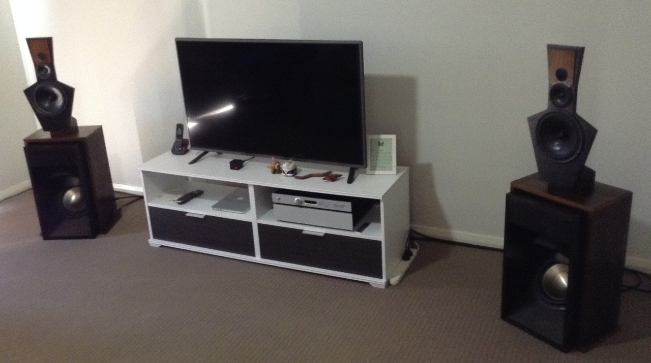

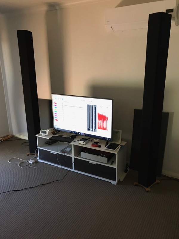

Curious about this one. What was the configuration of the LX521 [front wall distance, side wall distance, LR spacing, side wall toe in angle]
Maybe pictures will do instead, the 90 degree nulls were aimed at the TV unit and toed in so back of drivers pointed at the wall corners.
Arrays are 1.3m from side walls, 0.5m from front. LX521 probably closer to 1m from sides and bit further forward. Frequency response is likely the main culprit as I can also make the arrays sound rough with the wrong EQ. The extra room contribution from not being able to have the speakers as far from the walls as I would like is my bet for the other. Putting foam sheets against the front wall towards the corners had a noticeable reduction in the amount of perceived reverb on drums.
Thanks for the pics.
My understanding, is the LX dipole design's 90deg "nulls" minimize lateral reflections from the side walls. The front wall reflections (rear lobe) require a min distance or wall treatment. Given these are in place, it also has multi way drivers that should perform better than a full range driver.
I have no doubt the LAs sound good and look good. So don't take this as criticism, its not. The LX should have a flatter wider freq response than your LA, as it has more specialized multiway drivers. Probably lower distortion as well, as the drivers are optimized for their operating band. Could it be the LA sound field shape (semi cylindrical) that makes it sound better?.

The dipole pattern gives a figure of 8 so there are nulls to either side. I aim the inside ones at the TV to reduce interaction from them and the the outside ones will reduce side wall interaction. The front wall is the closest and I try to deal with that by toe in aiming the bulk of the rear figure eight response into the corners to give the greatest distance. The fact that placing foam sheets (at the points where the wall is closest) has an effect on the perceived reverb says to me the distance really should be greater for my taste.
That is why I say that I think they would be better in a bigger room or with damping behind them. Most of this is track / genre specific though. Orchestral or acoustic music that has "space" in the recordings sound really great on the LX521 with very minimal EQ that is designed into the system already.
As to being flatter without any assistance the LX's surely are. There is a built in HF shelving tilt that can be removed. It is too bright with it off, again that could be my room as it has a pretty high RT60 in the HF's. Wider, maybe, but not anywhere that matters to me and we would be talking the extremes of the audible range.

No doubt they would sound different but I was talking of quite gross differences. If the frequency responses were similar then the sound should be closer than not. Assuming that the speaker has quite well controlled directivity, if there are directivity problems with the speakers it is difficult to get the frequency responses the same as they will change more markedly with the axis of listening.I suspect that even if the FR is the same, but the radiation pattern is different it will sound different.
Part of that thinking comes from measuring and EQ'ing the arrays, it isn't always the biggest change in frequency response that causes the biggest change in perception.
The arrays are not really that low cost the way I built them but they could be done for less money. Shipping costs of drivers plays a large part for me the LX521's cost a lot to ship from the UK due to the weight of the woofers. Even though the cost of the drivers themselves was less than the cost of the drivers for Orion. So driver cost is not really the overriding factor in performance if that was your point.Echoing other comments, I agree that the speaker and room are one system. What is interesting in your comparison is that you have a) low cost mono driver LA + DSP compared to b) higher cost multiway driver dipole + active XO. The cost of DSP processing can be cheap (or free with your PC) and may be required anyways for DRC for either system. Even a dedicated $50 Rpi3B can easily run a large convolution based filter. That holds promise for making gains on any moderately priced driver. It also seems to me, that in both cases, a specialized driver (sub) is still required for really low end.
Where the arrays get a price advantage is not needing 6 to 8 channels of amplification unless, you add subs and ambient speakers 🙂
The only situation where I think a sub is needed is for loud or reference level home theatre playback of the .1 channel.
Both the arrays and the dipole woofers go very very low but they can't do that at the same time as being very loud. There is a trade off there due to the amount of Volume displacement that is available. I used a High Pass filter with the Dipoles when I did use them with movies as the effects could cause some massive excurions. The reason Linkwitz developed the Thor subwoofer.
For music at reasonable volumes both have enough for me.
