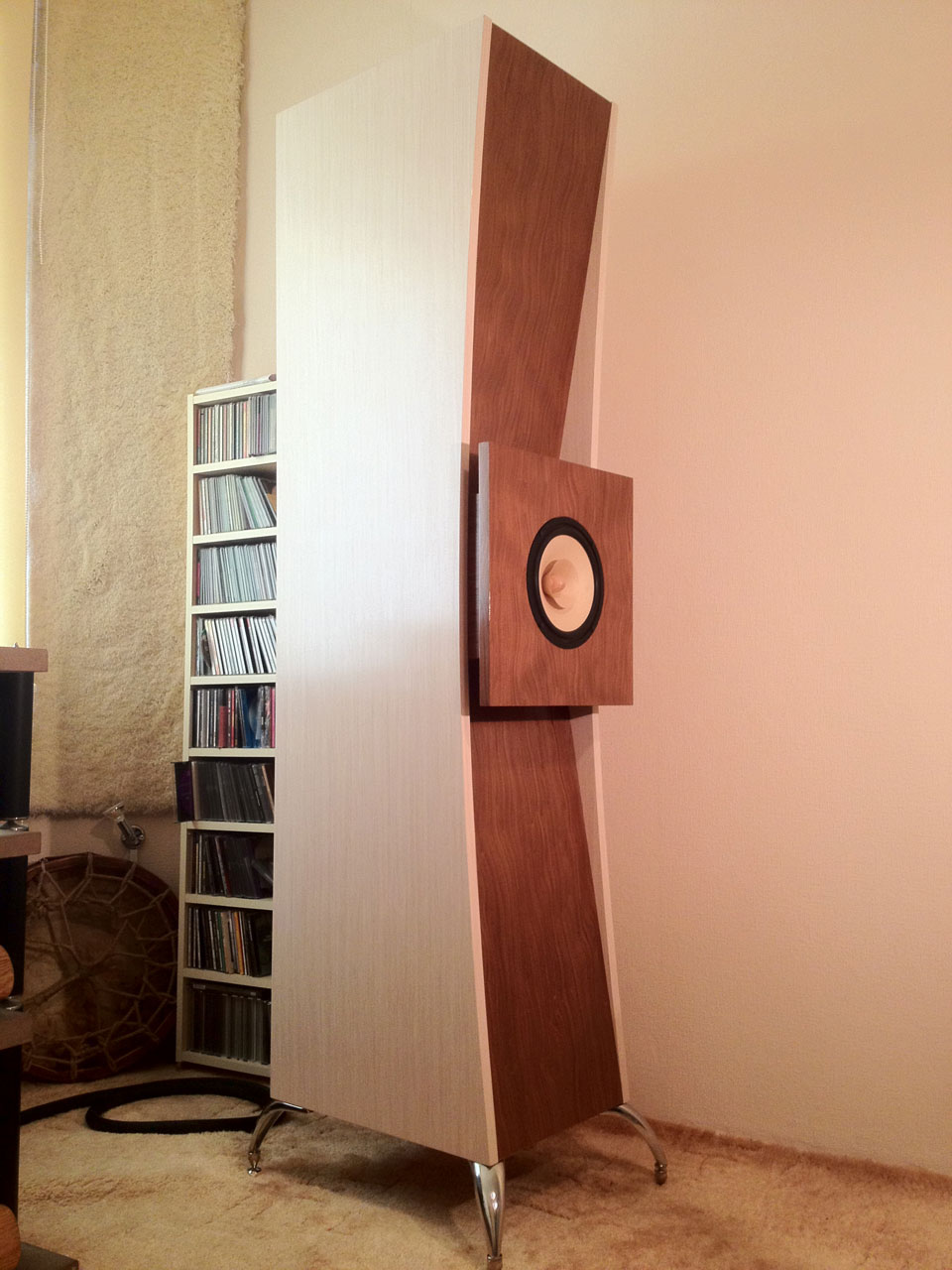

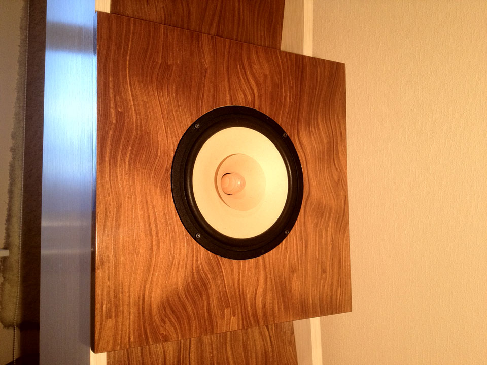

Sonido 200SFR, BLH "sandwatch"
front- amaretto root, sides - white oak. Fine line veneer and plywood.
Stunningly beautiful.
WOW! Nice work Charcoal!

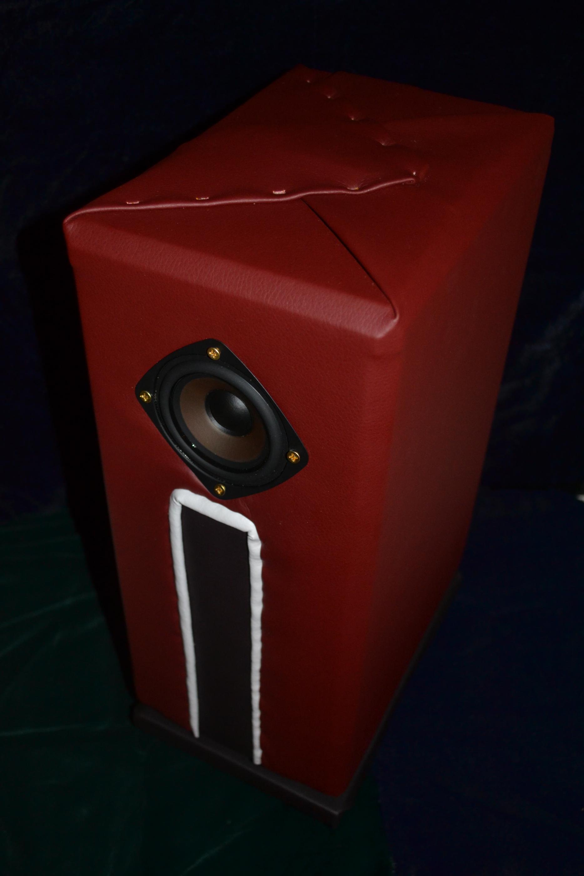

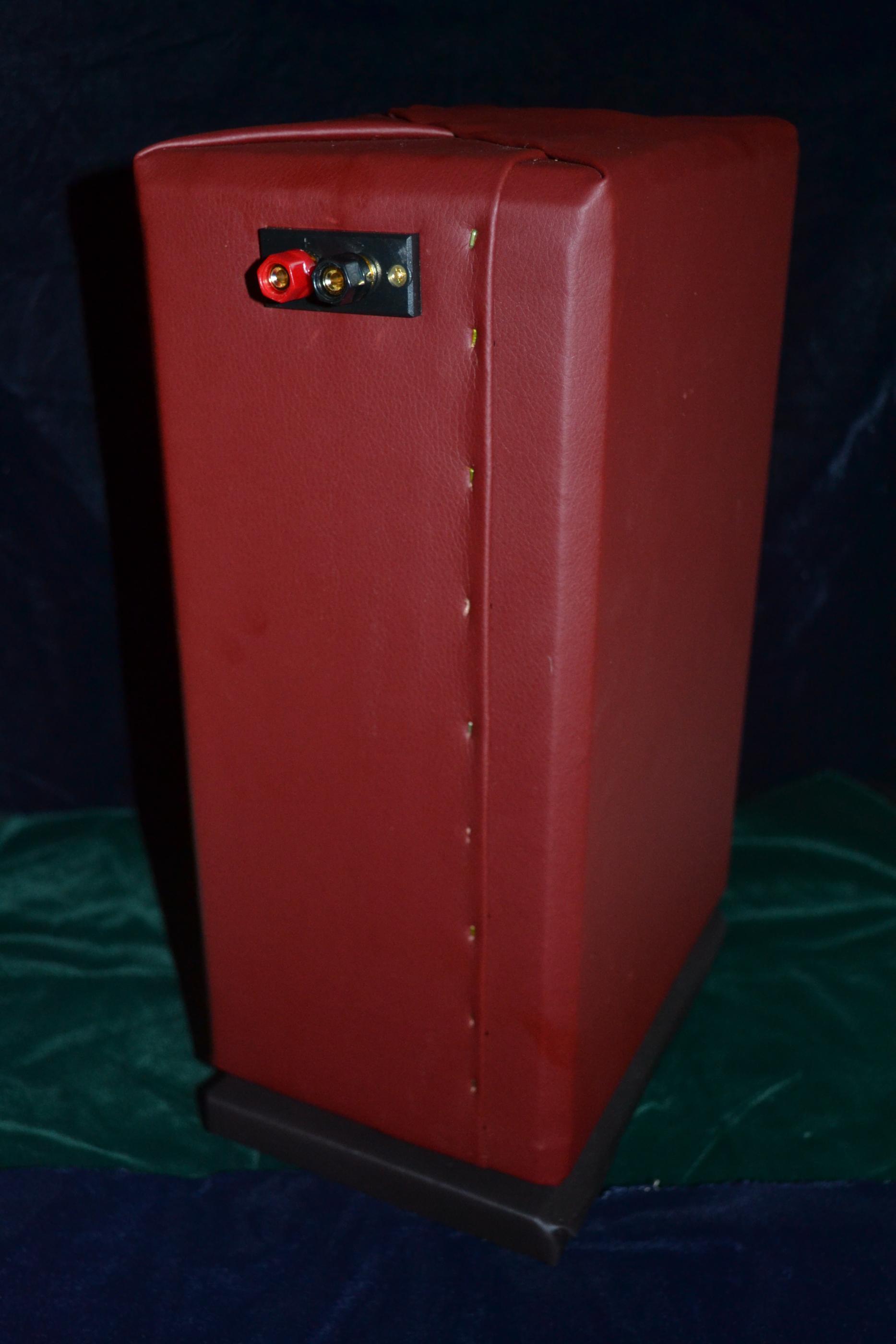

Just finished some little bookshelf bass reflex full rangers. I use the Tang Band W3-881SI 3" driver. The bass is surprisingly good for a 3in driver. Can't say I had high hopes. I'm planning to sell these if I can find a buyer.
.3 cubic feet, tuned to about 50 Hz, upholstered in vinyl. The port is down-firing because I didn't have a port cover, there is a FleXy like stand on the bottom holding up a base plate with about an inch gap from the bottom of the speaker itself.
Very nice, any chance you could give some detailed listening impressions? i am very interested in building a pair of these, what is the bass like?
Bass is tight, each instrument is "readable", good "attack". Perfect for everything besides trash-death etc. High presence effect and comfort, natural sound. Dynamics is good also.
If you like jazz - blues - soul, classics, aqustic instruments - that is the way to go.
Sorry I do not know all those termins in english, just translate what we often use in Ukraine to describe the sound.
Realy nice!!!
what driver are you using?
A special one or something I can buy somewhere?
Lovely speakers, how much for a pair? Could not see anything on their website regarding pricing
Price is very reasonable in terms of quality\price relation.
You should e-mail to them. Istvan Varga is designer and owner, he speaks english and russian (I can see from your nicjname that you speak russian?).
I used his various drivers in BR, TL, horns - always good results.

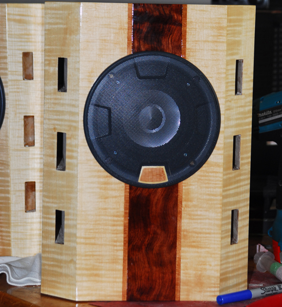

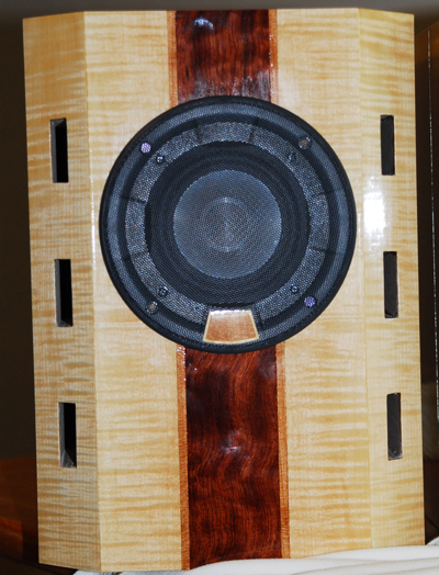

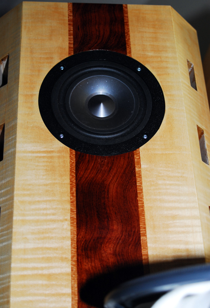

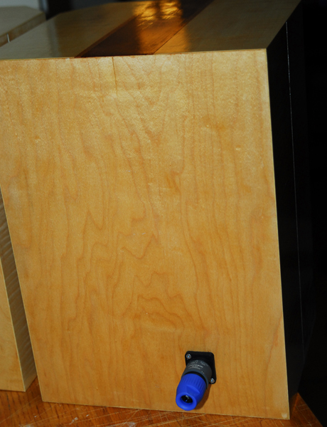

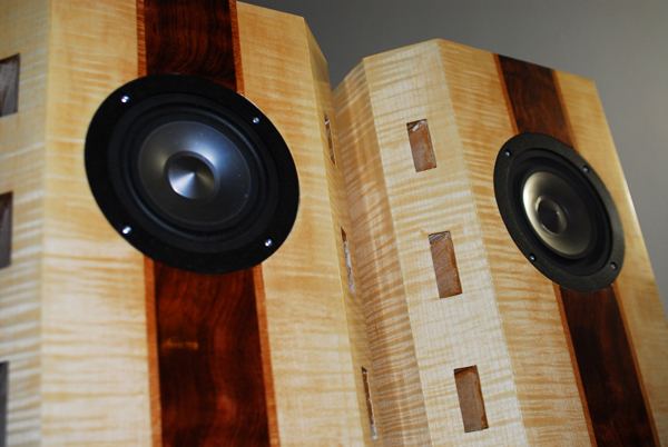

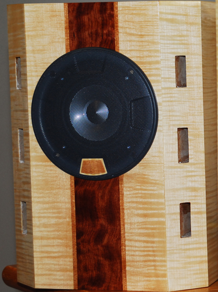

dMarKen..... All dressed up.

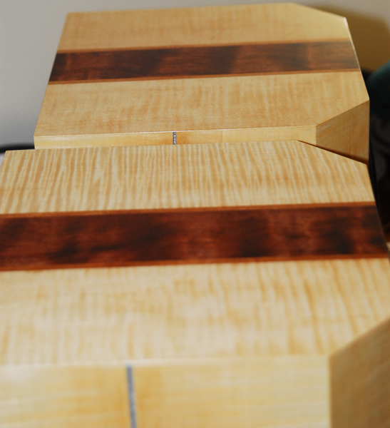

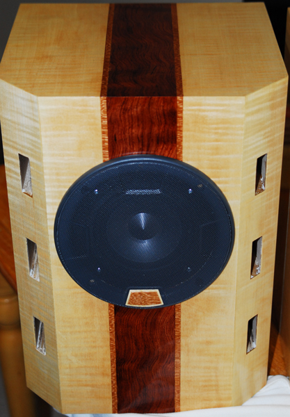

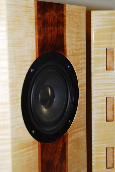

Figure I owe it to Dave (Planet 10) since he allowed me the honor of building this pair as a test pair. Got to say they sound great, although they are intended more for small rooms on their own. Anyway here you go Dave, dMarKen in figured Sycamore accented with quartered cherry and waterfall bubinga, finished with hand rubbed tung oil, shellac and poly.... pictures don't do the figure justice. And Dave I will eventually do a report for you on these... 😉
