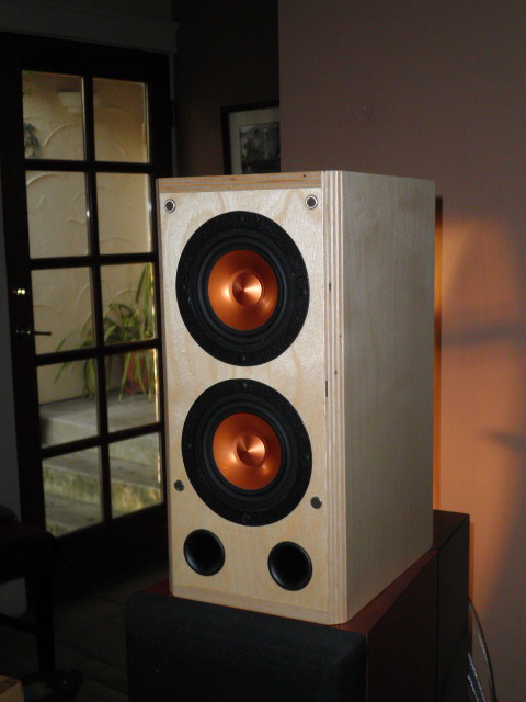

Just finished a pair of Mar-Kel70's in birch ply with hardwood port spacers, finished with maple veneer and darkened with a bit of dark walnut stain. They sound great! Much more open sound than the smaller milliMar-Kel70s. I loved my millis, but the EL-70 in a bigger box truly sings.
*note: veneering the angled faces with the ports is a pain! 🙂

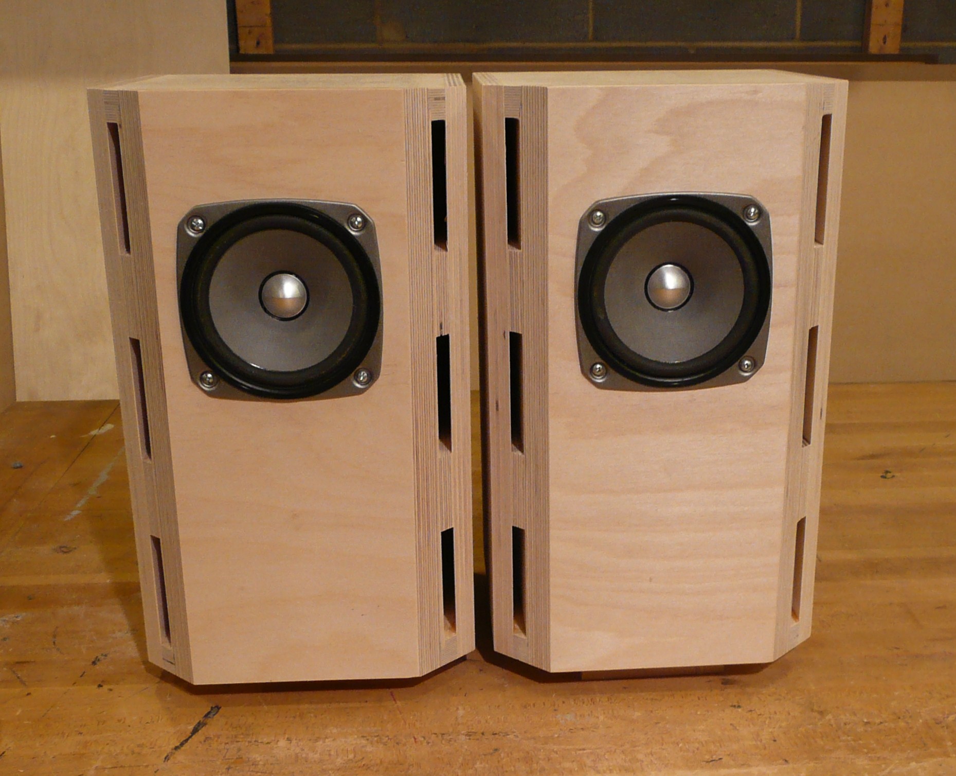

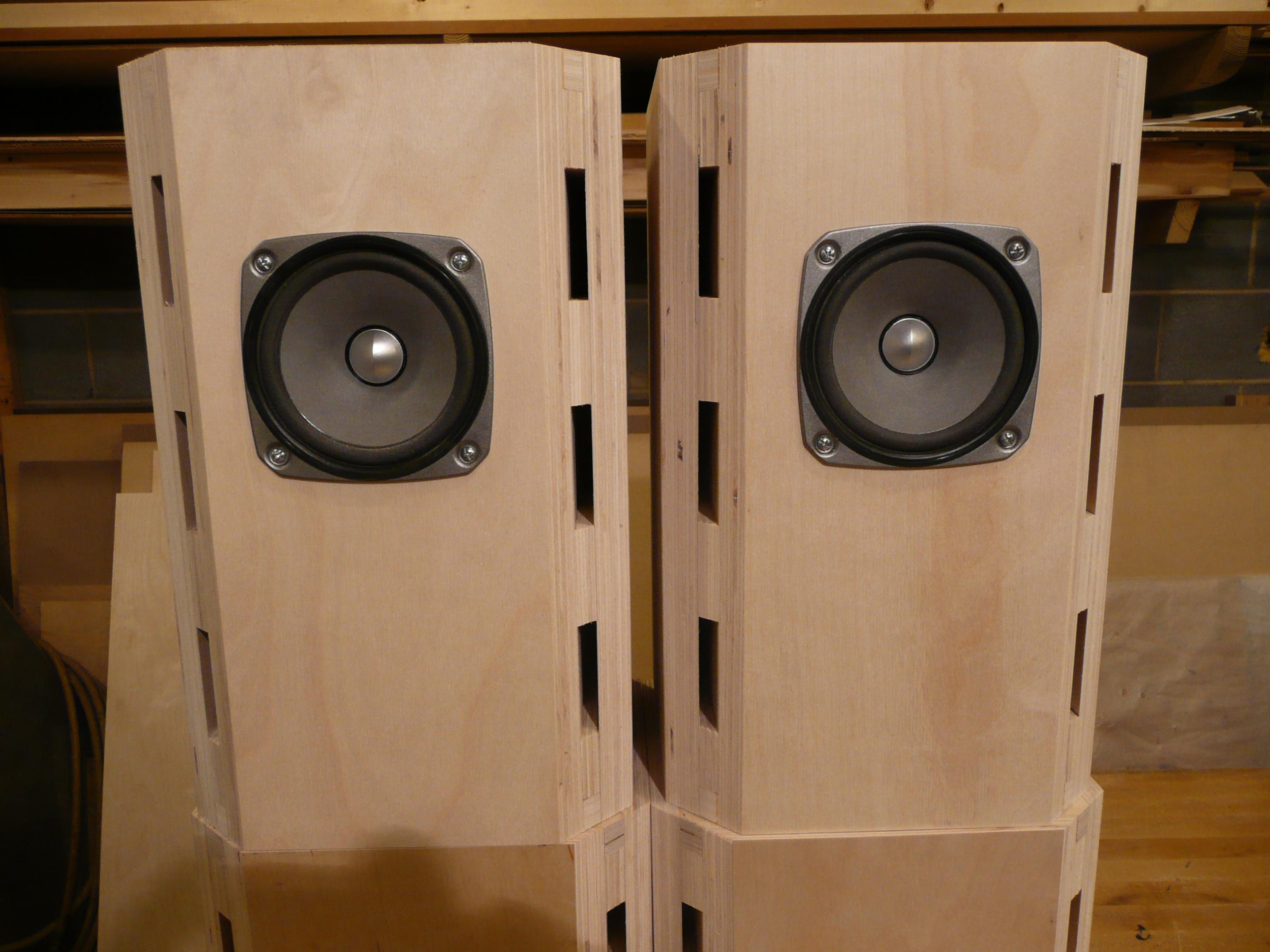

Just finished a pair of Fonkens using the Fostex 125wks.
This pair (pic 1) seems to work the best, the bass is pretty good; the overall sound is very warm.
Some other builds from the last couple of months (other pics).

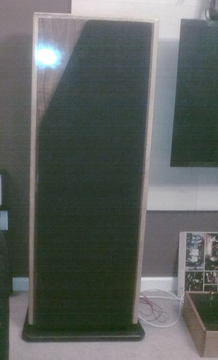

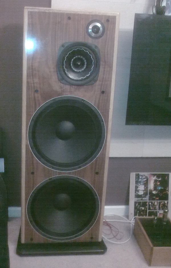

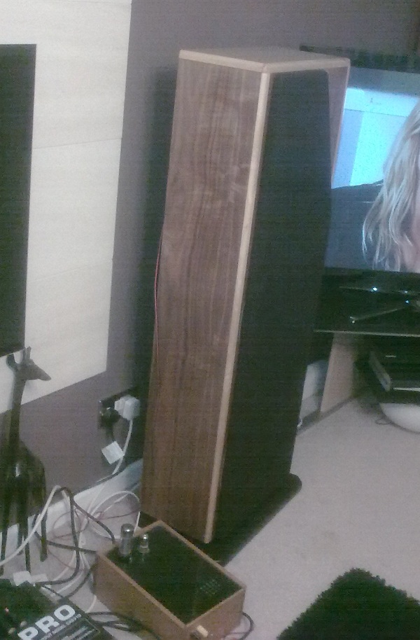

Recycled FE207/FT17 Curvy Changs, now reborn as OB with twin Alpha A15 per side, active cross-over between Alpha's and the FE/FT combo. Result of over two years playing about with different combinations (also got FE166).
U frame for the alpha's as H-frame didn't look right.
When I get the time I hope to detail the build a bit more. Not completely finished as these are heavily dampded design with a 36mm thick baffle. At the moment I cant find the camera with the build pictures, so these are of my phone.
As to sound, love em, dont play them very loud due to UK terreced house, but do enjoy the OB sound.
Oh and when I am playing them I do move them into the room more than shown on photos.

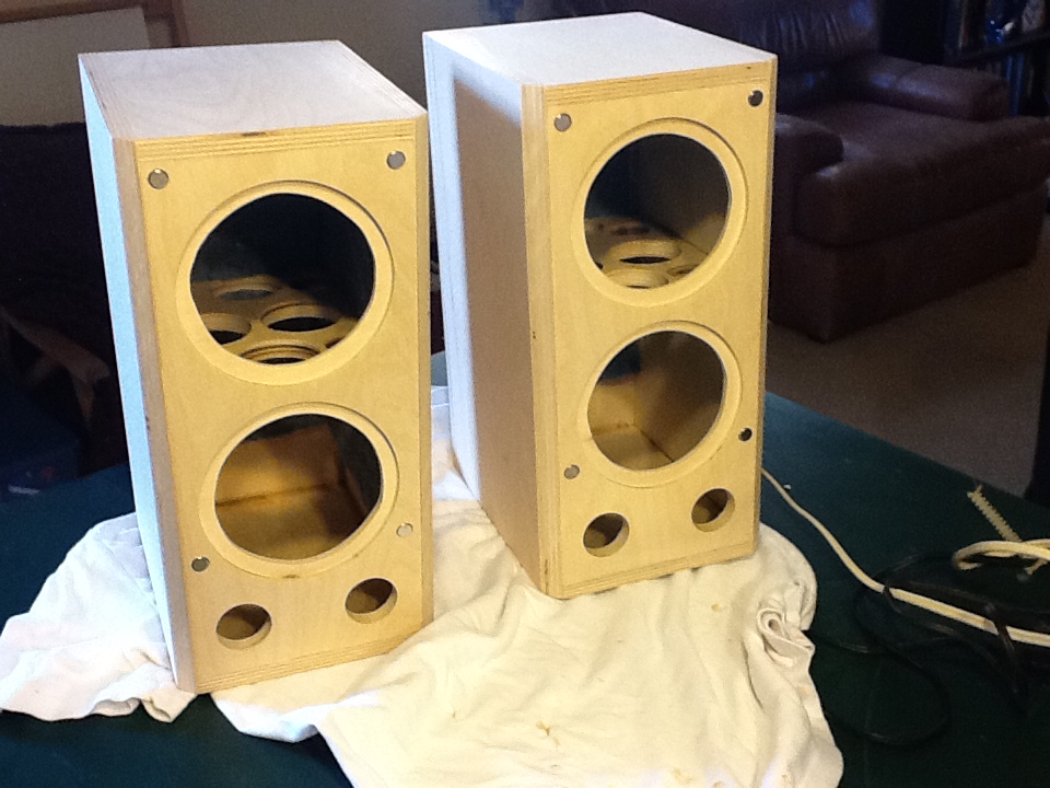

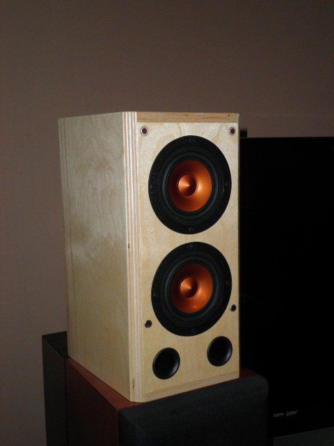

Mark Audio Double Till's with twin CHR70 g1's wired in series. The boxes were holey-braced and lined with CCS denim treatment and the baffle edge of the sides were chamfered.
They sound great, much more dynamic than I had expected having previously heard only single driver variants. To my ears they don't really need the tweeter help which with they were initially auditioned...great value on the MA drivers once again.
