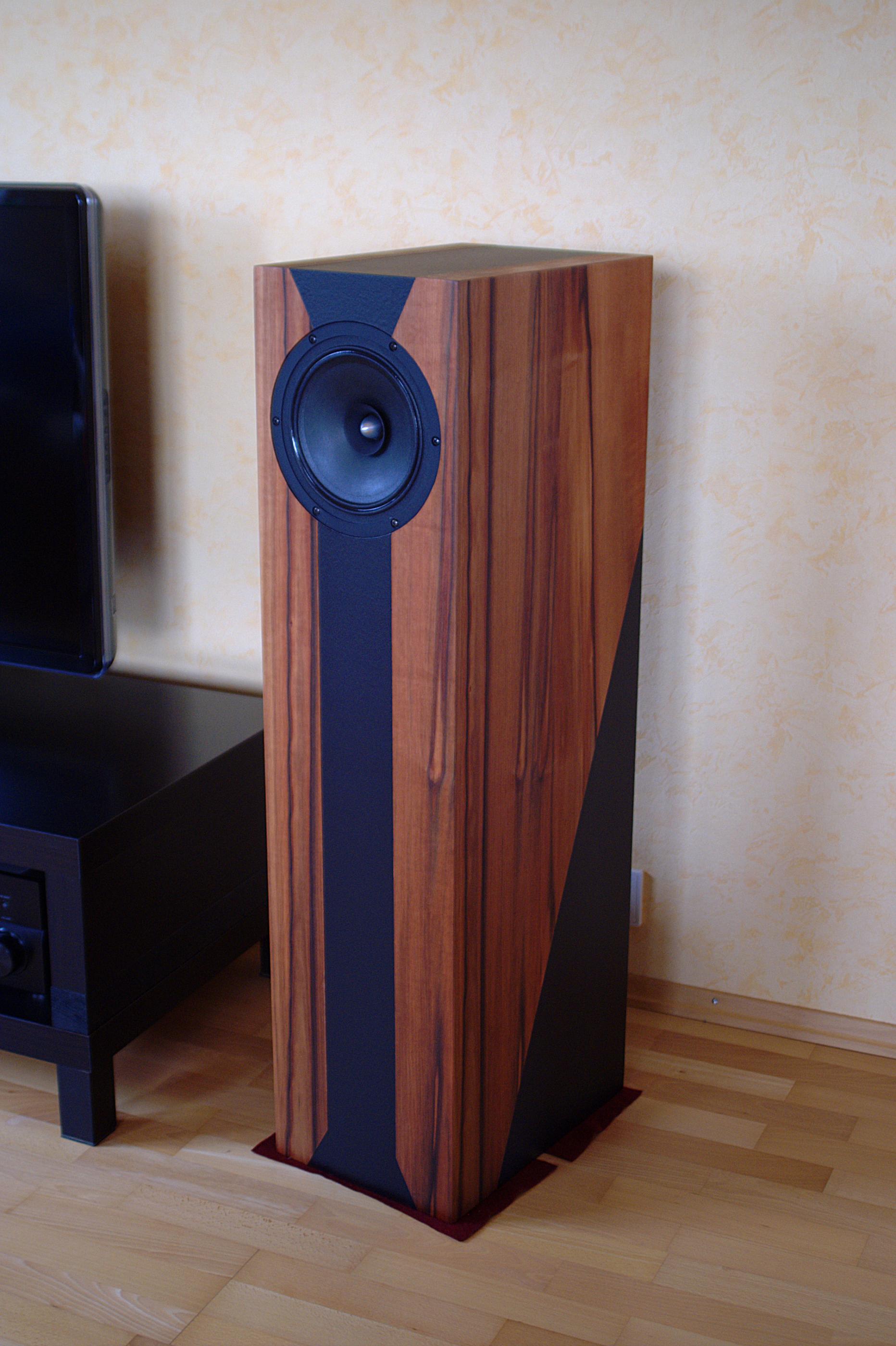

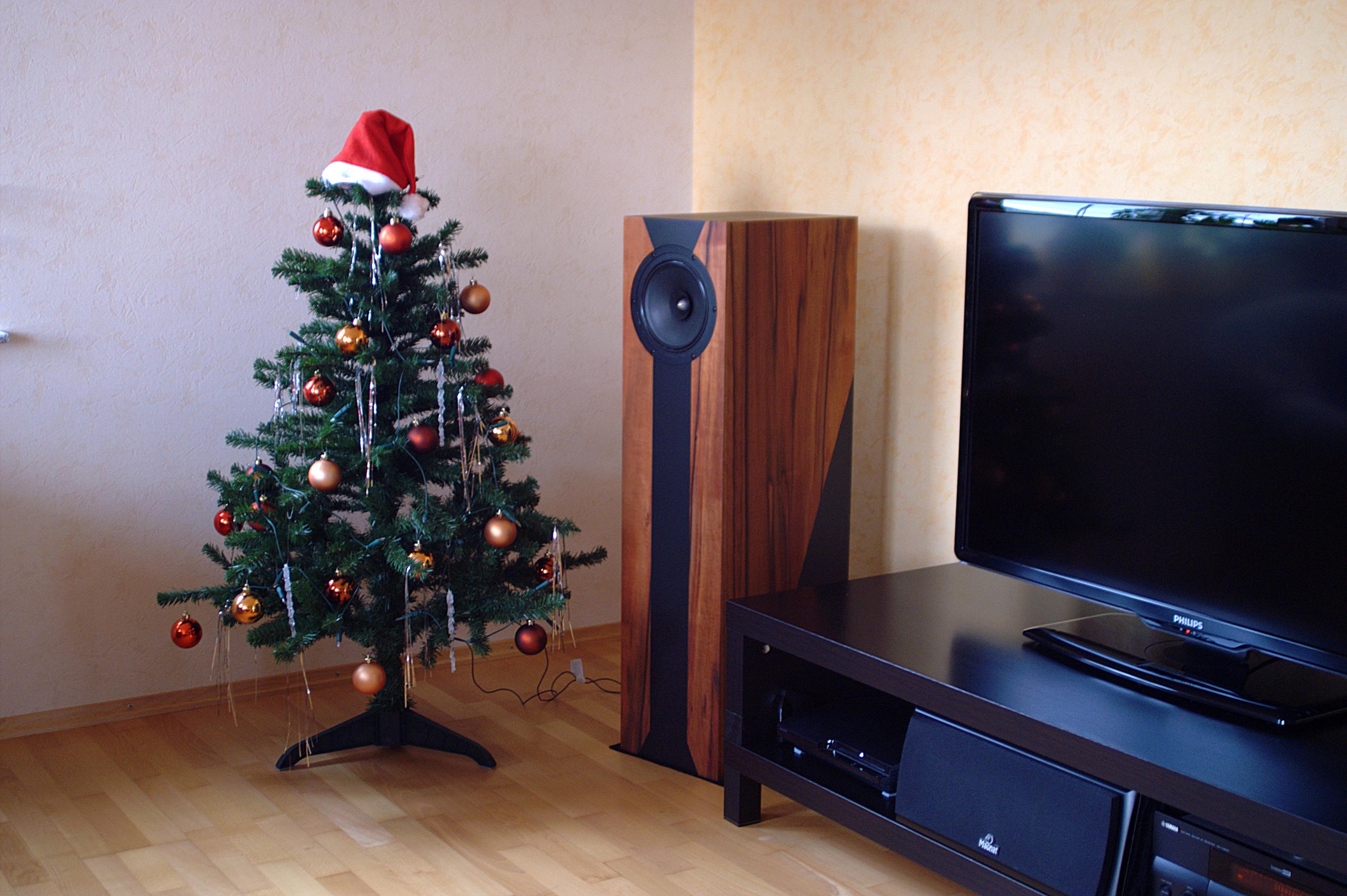

Finished right before christmas...my TQWT with Gradient AX-08.
Unfortunately the feet for them are currently not in stock so I have to wait till next year 🙁 . Maybe I'll try tri-absorber from viablue (image attached.
Merry christmas 😀

bAD kLOPFER,
Those bad boys look cool! How do they sound? Are both near corners?
Merry Christmas!
Hi zman01,
they sound very good. It is quite impressive what this driver is capable. As all full range loudspeakers there are some problems with big orchestras but if you stay with a smaller amount of instruments (in fact everything other than a symphony orchestra) you'll be quite happy. My mother heard "Tides of Time" from Epica, some tracks from "Tron Legacy" OST and "Stars" from Sara K. a "little" louder than normal and was impressed. 😀
The left box is ca. 1 m away from the corner, the right box roundabout 2 m.
The box is tuned to F3=31,5 Hz.
The guy who did the plans for this speaker did some measuring. I attached one of the sheets (TQWT in red).
