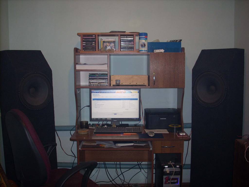

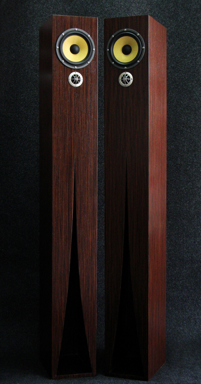

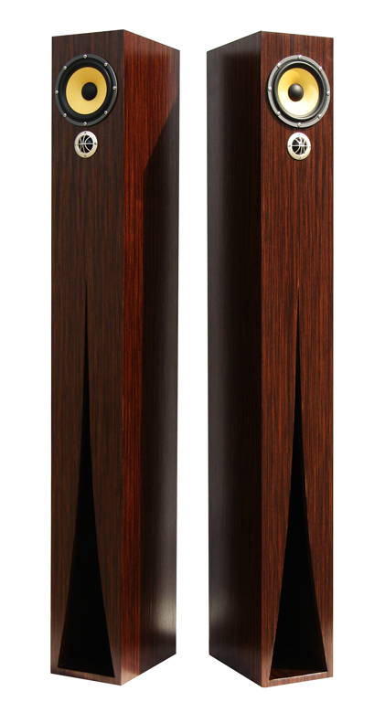

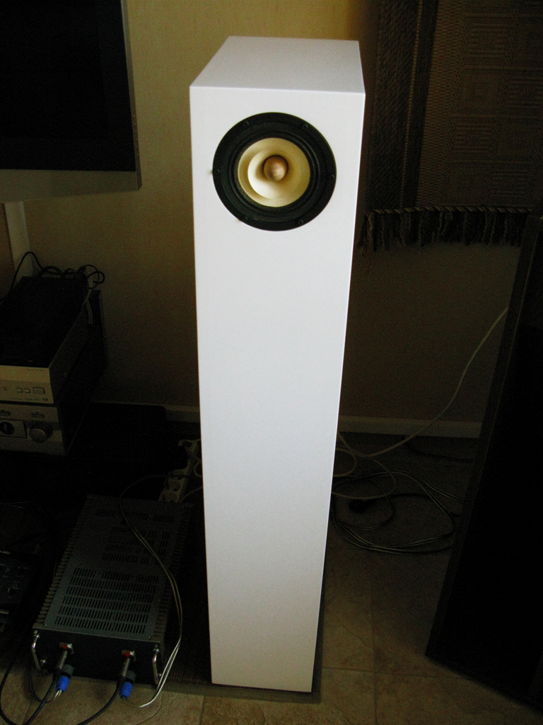

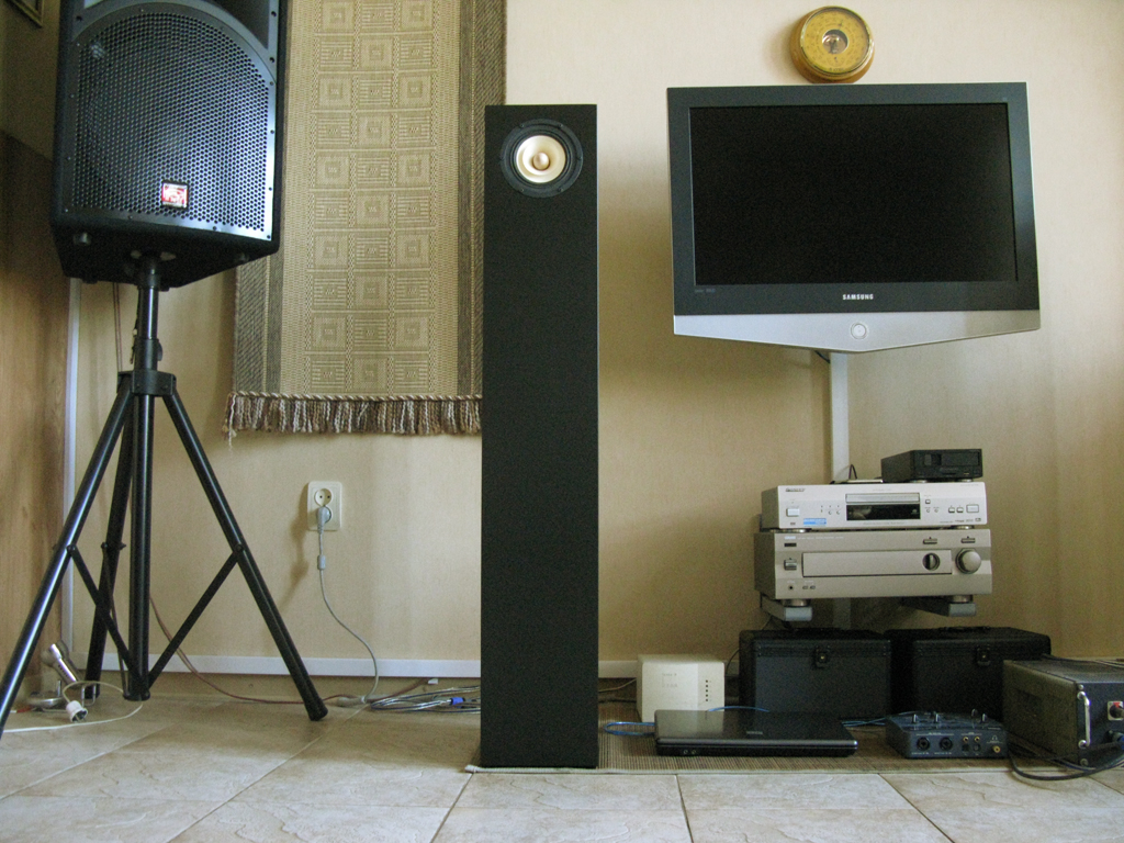

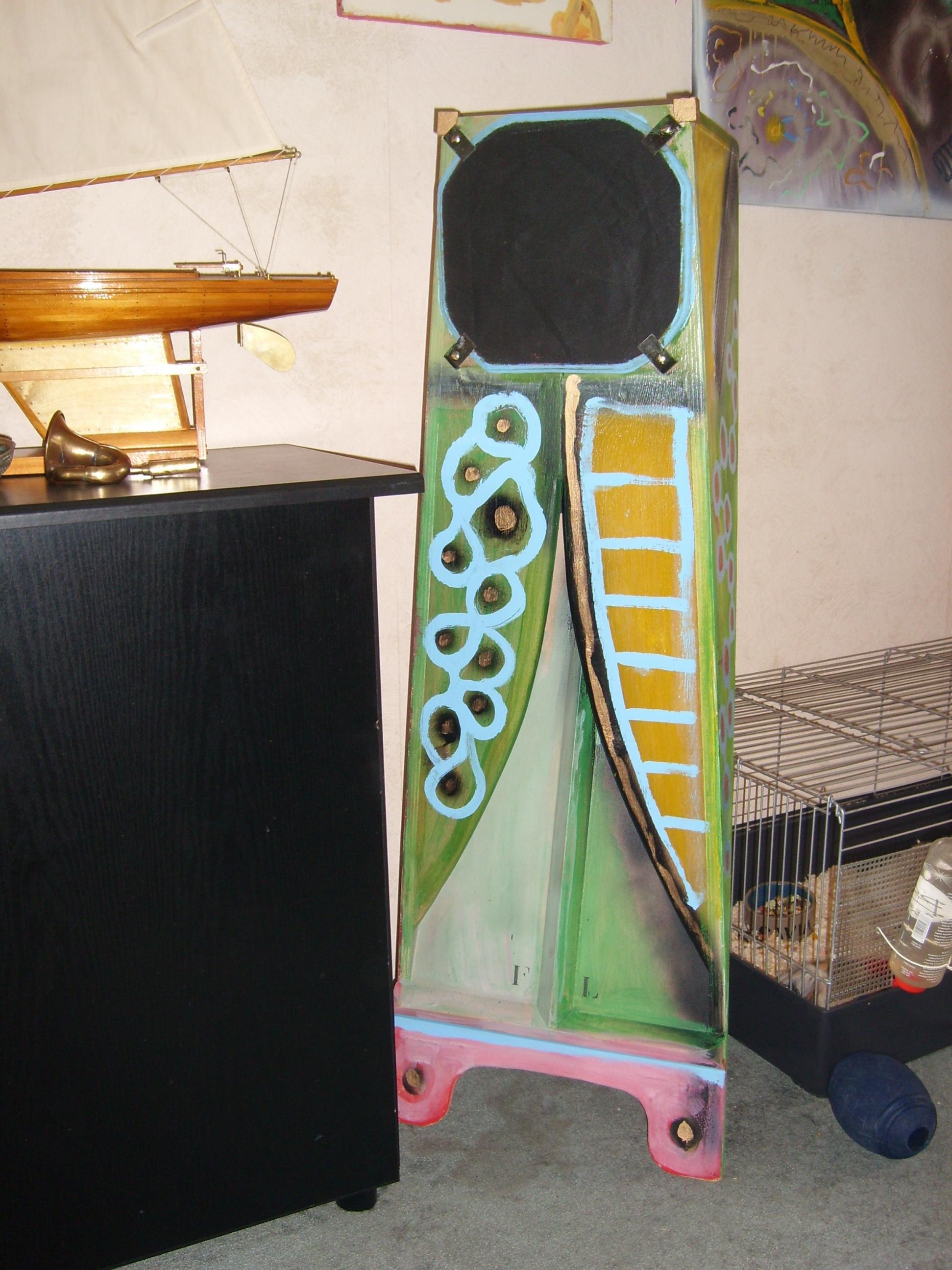

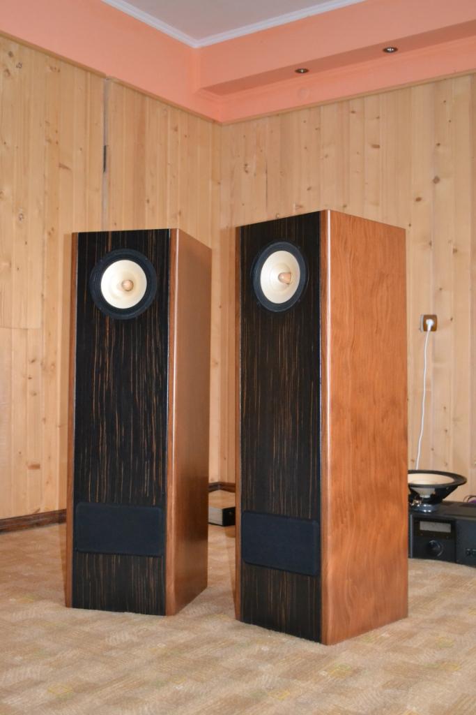

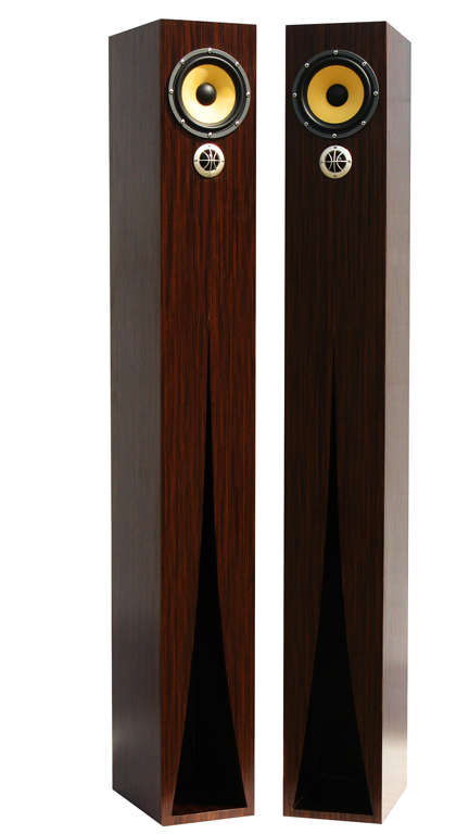

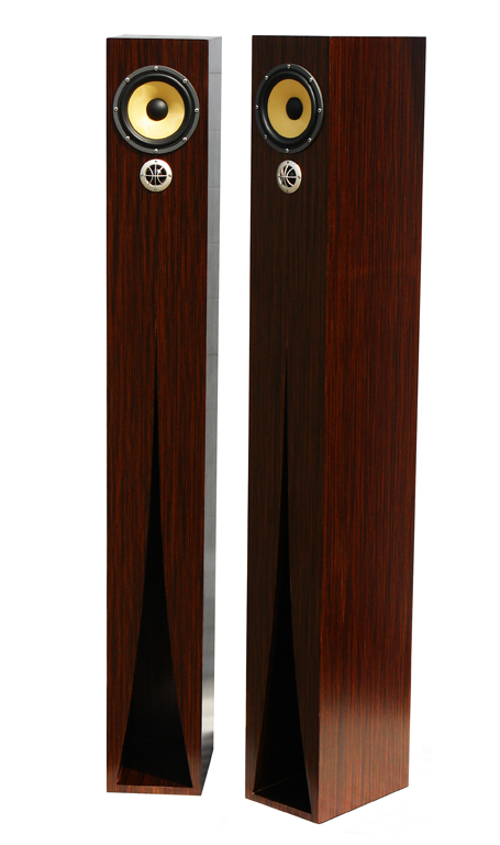

Sonido SFR200 in labyrynth enclosure, channel of the TL is designed to be triangular (no parallel wall resonanses).
labyrinth -looks like BLHorn? good thing
no, its like constant cross section TL with drivers displacement. horn would be more than twice bigger...

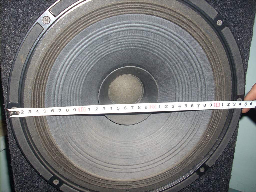

Hi all.

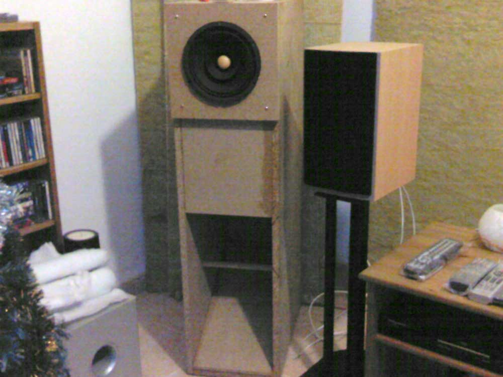

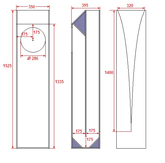

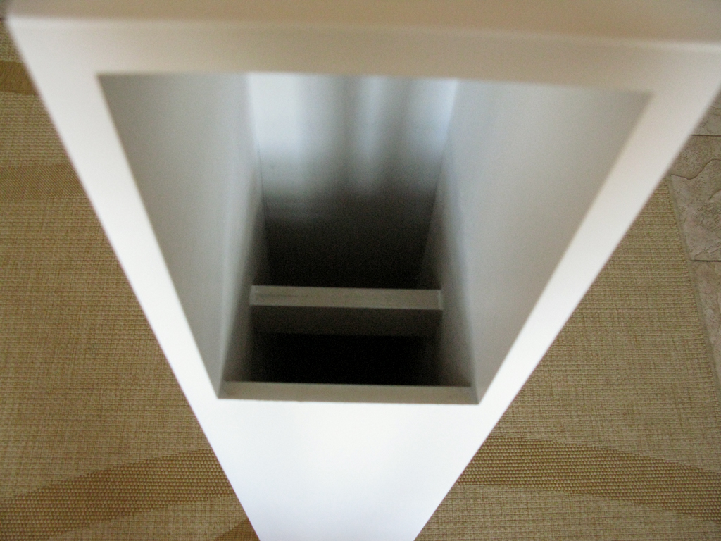

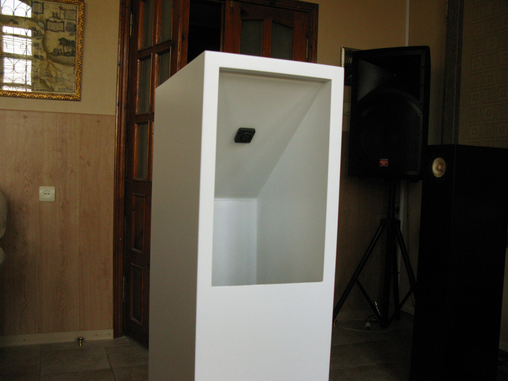

On the big 12" speaker did anyone else?
50-15000 Hz, 100 watts, sensitivity 97db
Design - transmission line with an exponential cut to half the entire length.
In this design has made a powerful impact at low frequencies
diman, that is what I was thinking about also, but wanted to prolong back part upwards, to have 2\3 of total length K-slotted

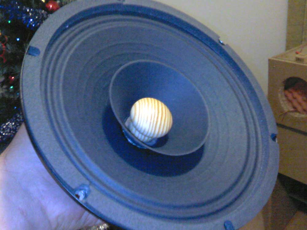

Driver is 100ГДШ or 4A32?
I I did not do the above - the family does not understand.
yes.., it would look somewhate strange and ugly)

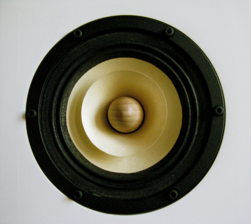

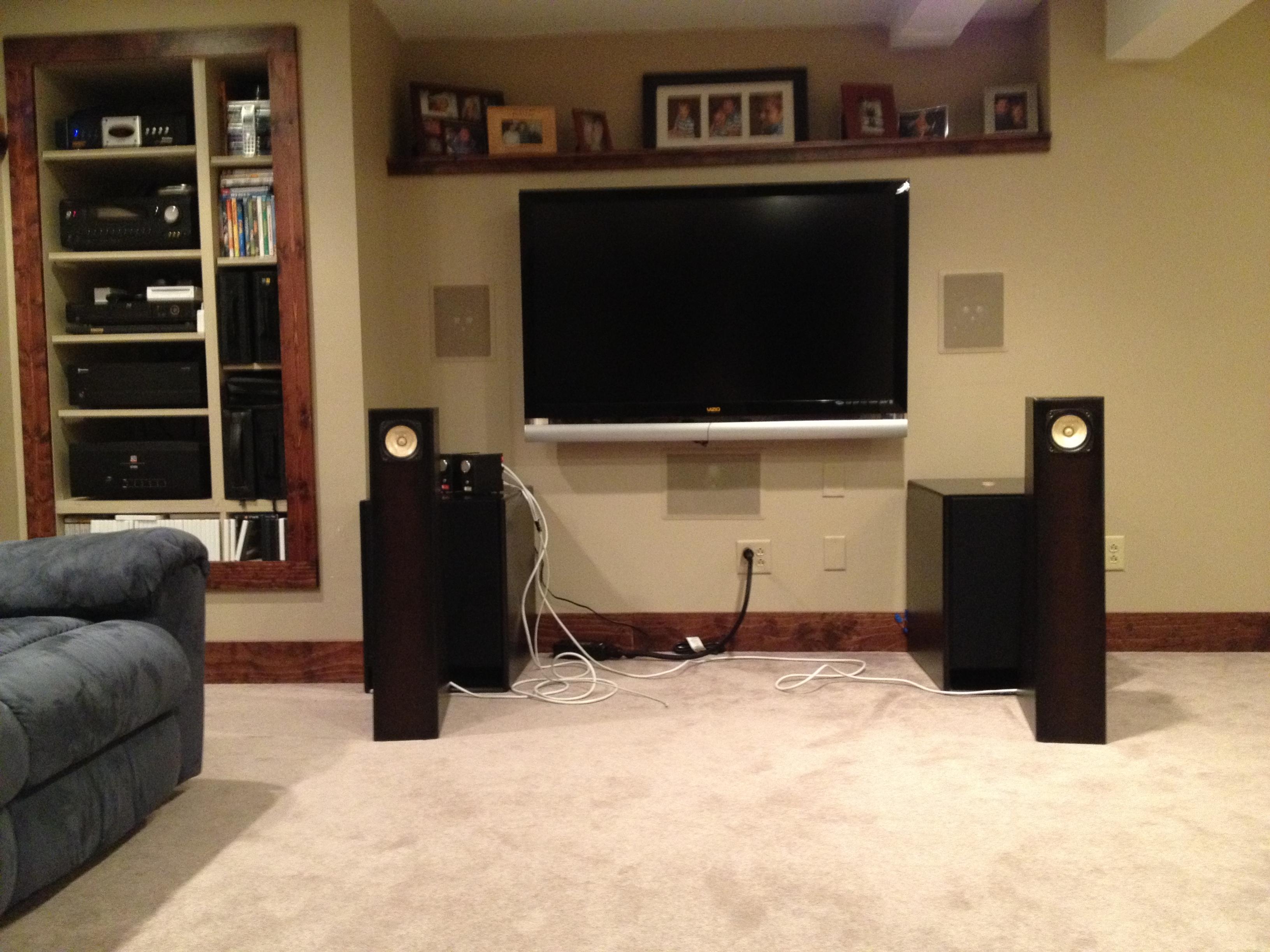

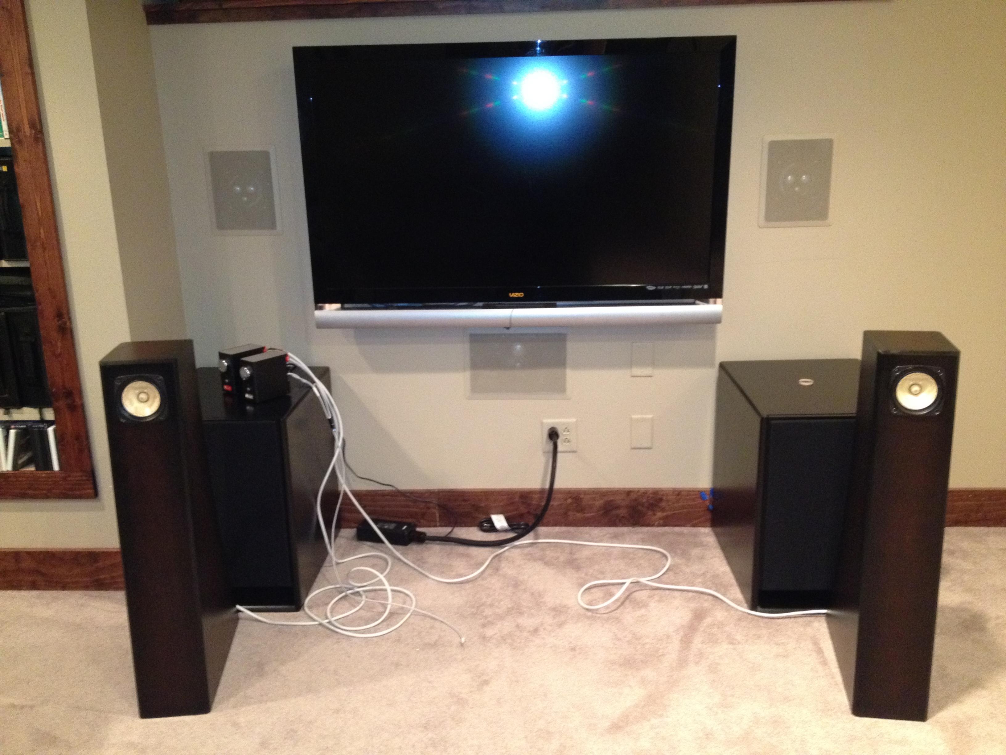

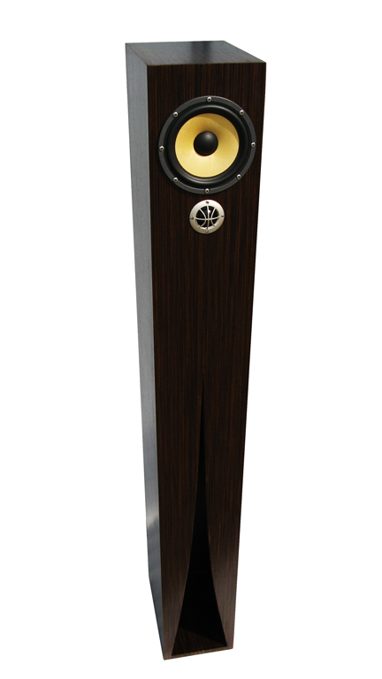

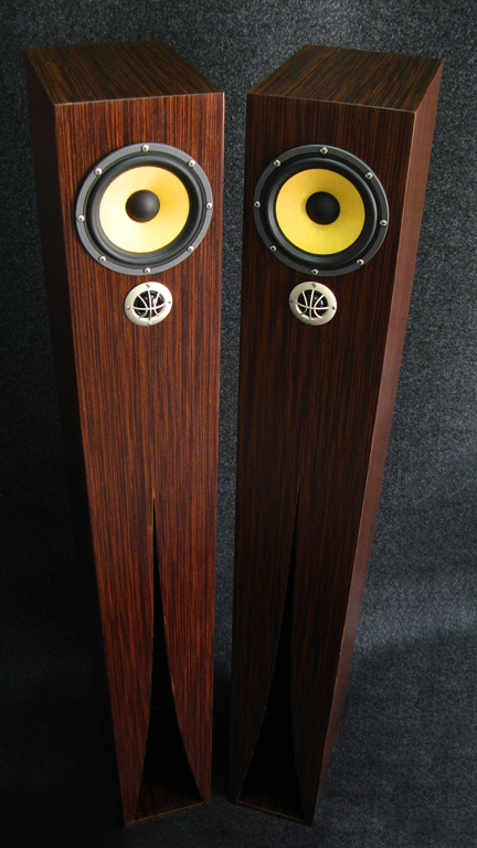

here´s another familiar project,still being fine tuned,the famous Viech,with modified Beyma 8ag/n.
I´ve been trying to sort some problems with the midbass,but somehow,I´m always enchanted by it´s sound quality,considering the build´s price tag.
I´m completely hooked on full range speakers and from now on,it´ll be the only way to go for me!😀

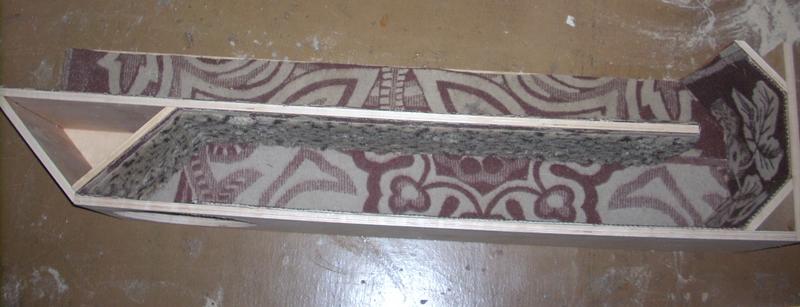

dman86,
It looks like you covered the inside surfaces with carpet. How many surfaces did you cover & how much by the speaker?
I plan on copying your design for my Wharfedale 12 CS-AL speakers.
Thank you for the plans.
dobias
dobias

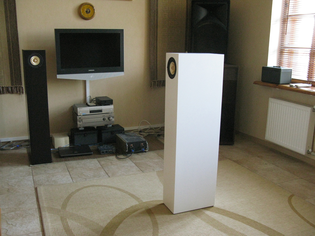

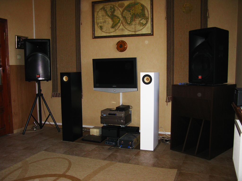

And my Sonidos 🙂

I used two old woolen blankets.It looks like you covered the inside surfaces with carpet. How many surfaces did you cover & how much by the speaker?
For every loudspeaker - just one blanket, without the rest
Even inside band synthetic fur. (leopard).
Might need synthepon, filling to 1/3 the length of the tube.
