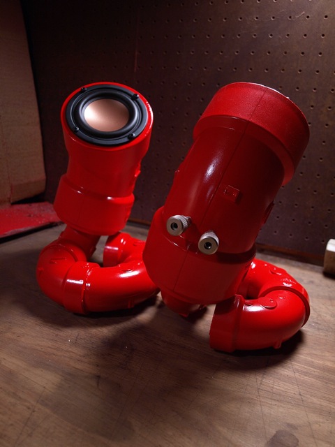

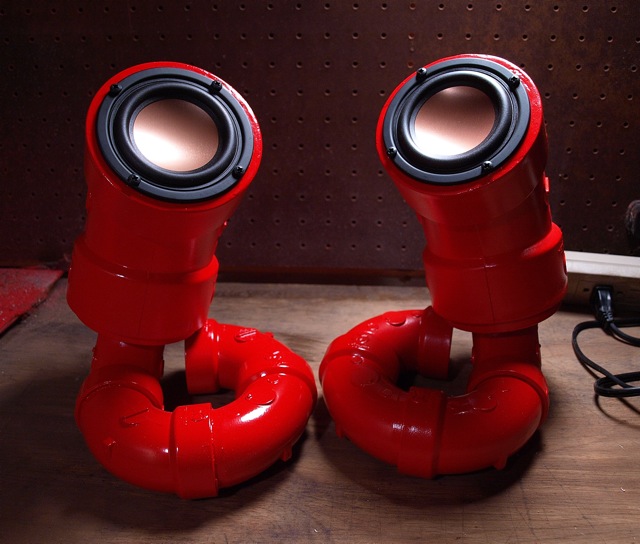

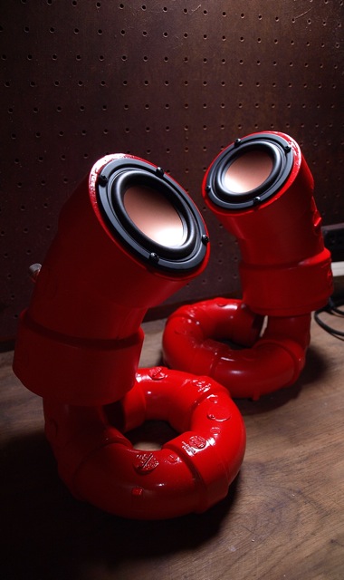

New PVC Speakers "Red Lobster"
speakers i made from PVC pipes, each houses a Hi-Vi B3N 3" magnesium/aluminum alloy full range driver. frequency response is 65-20,000. 3 way binding posts on back. the bass port is on the end of the 1-1/2 pipe/stand. nice sound and a very good sound stage, lots of low end bass for a small speaker. Let me know what you think. check out the video as well
YouTube - "Red Lobster" DIY Handmade PVC Audio Speakers with Hi-Vi B3N 3" drivers
thanks

Very cute, i like them. Given the Fs of the driver, the cabinet may well be better described as a daline.

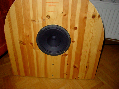

First and second try for OB's
Hi everybody , the pine one I tried first just for fun ... the sound was so inspirering , that I tried another one with dark mahagony wood stain and ply wood ...
The plan is here ... Open Baffle
Sounds great for me ...

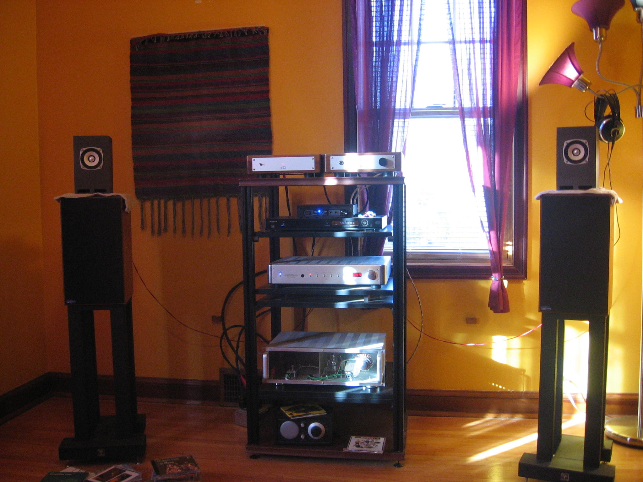

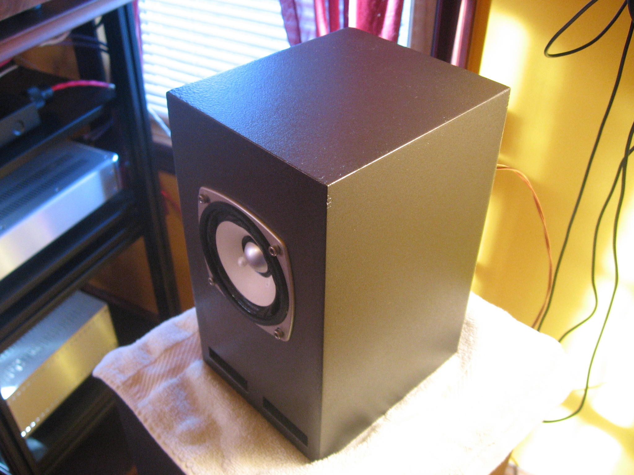

uFonkens
my first venture into DIYing speakers. hammered gun-metal grey uFonken a friend and i built. wow...awesome speakers. i also have another pair of drivers and cut BB to build a pair for myself 🙂. now i just need to find a sub to mate them with and
