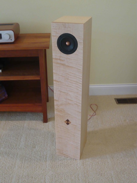

Here's a picture of my first DIY speaker project, a version of Timn8ter's Aria bipoles. Tim very generously shared his drawings with me. Performance has amazed me since the first time I hooked them up.
These are constructed of veneered 3/4 nominal baltic birch plywood and a solid tiger maple front.
Unlike my Heathkits, these provided no opportunity for me to solder a transistor or diode in the wrong way and send me running to my EE father for help!

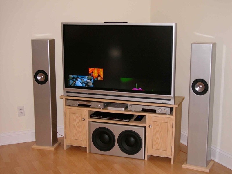

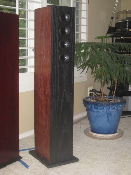

… and my second
These are a pair of Jim Griffin's Alpair 10s built for use in basement HT setup (along with the powered sub seen in the picture). Placement leaves much to be desired, but my initial impressions on music is that these are not as good as the Arias--too much harshness and sibilance in the upper midrange?
I used 3/4" nominal MDF and took them to a local auto body place for painting, which they did for what I thought was a very reasonable charge ($180 for two towers and sub). I used drywall mud to fill the MDF 'end grain' then coated them with a couple of coats of shellac.
Thanks to Jim for sharing his design with the community here.
Next project (now that I've caught the bug): an attempt to clone PMC's FB1s using SEAS drivers, eggcrate acoustic foam, and dimensions transcribed from their handy cutaway photos!
Re: … and my second
Very nice looking set. What drivers are those in sub?

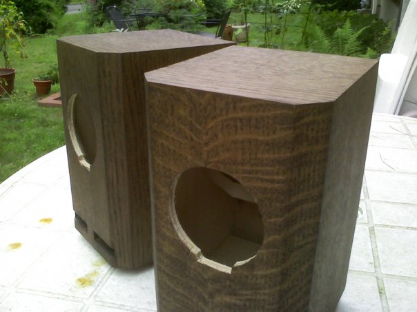

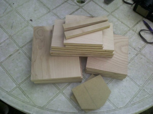

Here's a pair of uFonkens I build last week. I'm working on another set as a wedding gift for a friend.
Applied iron-on oak veneer I found at Lowes
Sanded with 120 then 220 using an oribital sander
Applied minwax dark walnut stain with a cloth
Applied 4 coats of minwax wipe-on poly, sanding lightly with 320 between coats.
After the last coat I sanded with 00 steel wool and applied minwax finishing wax and buffed it to a slight shine.

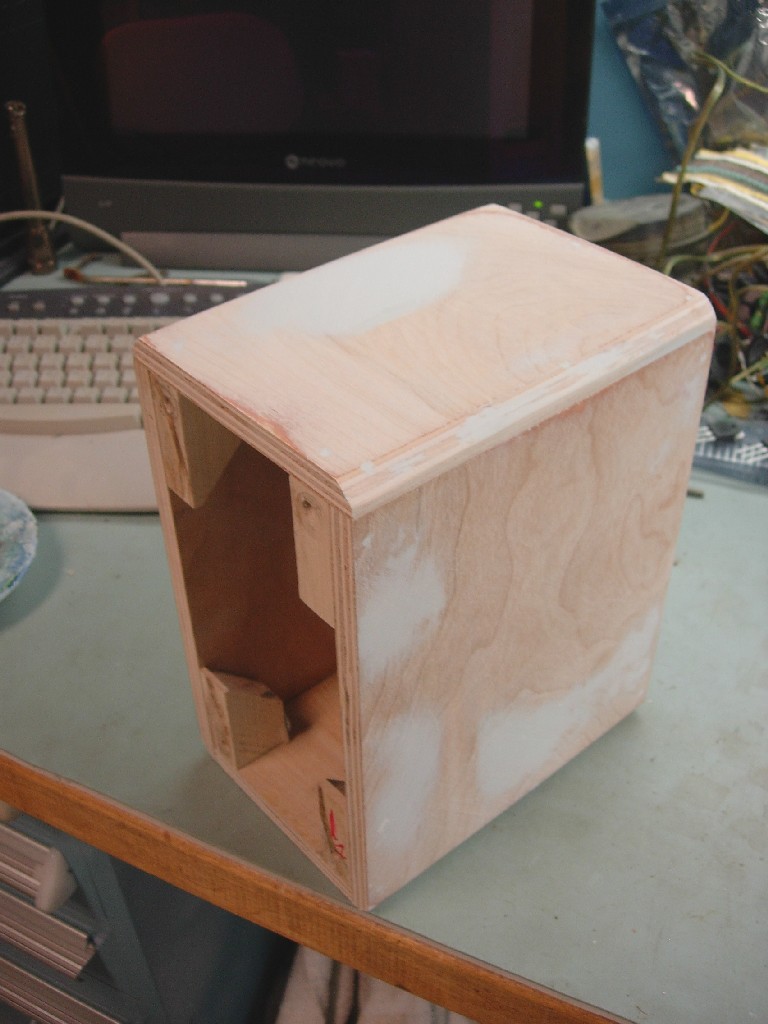

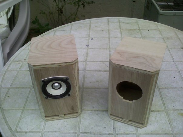

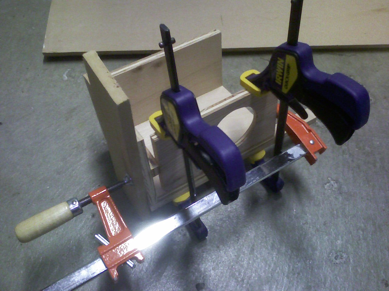

I have a few...
1) all the pieces cut and ready for assembly
2) the backside of the mounting baffle
3) waiting for glue to dry
4) fully assembled but before applying veneer
5) veneer applied and just finished staining

I have considered it...but I'm not sure if I am up to the task myself. The Frugelhorn FE126eN's were purchased from planet-10.
I am enjoying their sound as-is right now but since I am building a second set, I might purchase the enabled versions from planet-10 so I can do my own A/B comparison. We watched "Handcock" in our bedroom with them the other night and I forgot I was supposed to be critiquing the speakers about 15 minutes into the movie. The sound is smooth and nothing is overbearing that would make me want to turn the volume down. Sure there isn't much bass, but it is more than the TV would ever put out on its own and after listening for a few minutes you truely don't notice.
Anyway, It's a fun little build. I only had to make a few rips with the table saw. The rest were done with a mitre saw since the pieces are so narrow. Starting with a 2x4' sheet from Lowes I ripped two 2'x145mm boards. I cut the 145mm pieces and then ripped the remainder of the 2nd board down to 102mm to complete the final pieces. The two 2'x145mm rips were enough for everything except the inner brace which I cut out of some scrap 1/2" MDF. That left enough wood for me to make a second set from my original 2x4' sheet. I didn't use the table saw again until the very end when I ripped the 45-degree angle cut for the baffle.
Chuyler - as you've found out, the hardest part of this build is finding room for all the clamps
