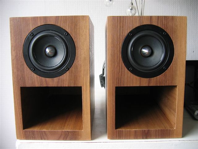

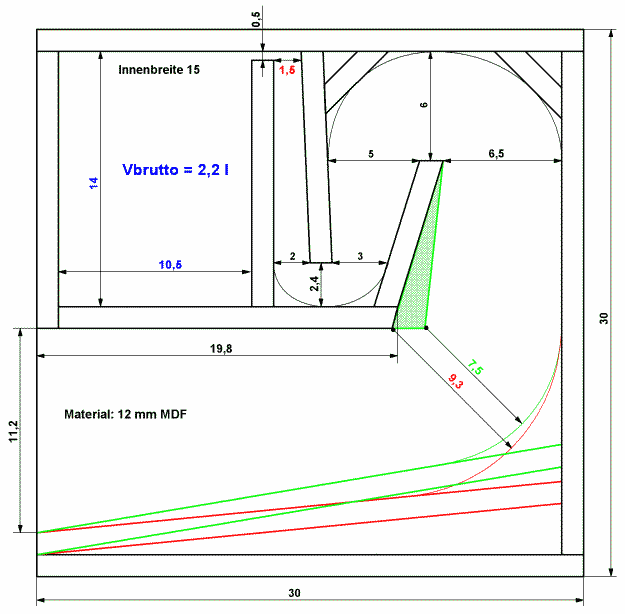

Post some (many) pics of my horns based on drivers from Hungarian company Sonido and diagrams from the same company.
The driver is a 5" fullrange unit:
A few pix from the assembly:
My cabinet (and cabinets):
Drives in place (and muffler as well):
The speakers (the red one) next to is bigger brother (6½" Sonido driver) at a DIY meeting in Gothenburg a month ago:
Sorry no figures or curves, just a subjective judgement:
There's no DEEP bass but still, if playig (acoustical) music you don't feel there's much missing. They are palying loid and what there is of low notes, there is. However mid and high ranges are VERY good, no sagging no resonances.
We compaired the speaker with a horn with dual Fostex FE204-something last year and the difference was enormous; the Fostex did play loud at the lower end but HEY! Where's the treble??
Comparing the smaller 5" with the bigger 6½" was also interesting. It seemed that my smaller boxes had a straighter curve (or line), whereas the bass was a bit thinner. Talking with Zoltan at Sonido I learned that the deeper bass at the 6½-inchers could give the sense that midrange was down.
I will check with my friend who brought the bigger horns if he has any curves.

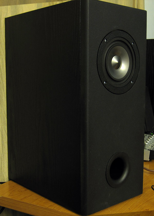

595ss said:W4-655SA horn, sound really nice but can use a little more bass
595ss. These look very nice... How low do they go?
CHR70 BR
about 12.5 liters, tuned to 45 hz
No baffle step but these (despite being fairly large) are designed for desktop use, so the wall, desk, and corner have a tendancy to eliminate the need. Still want to play with it a bit, but they sound pretty damned good as it is.
