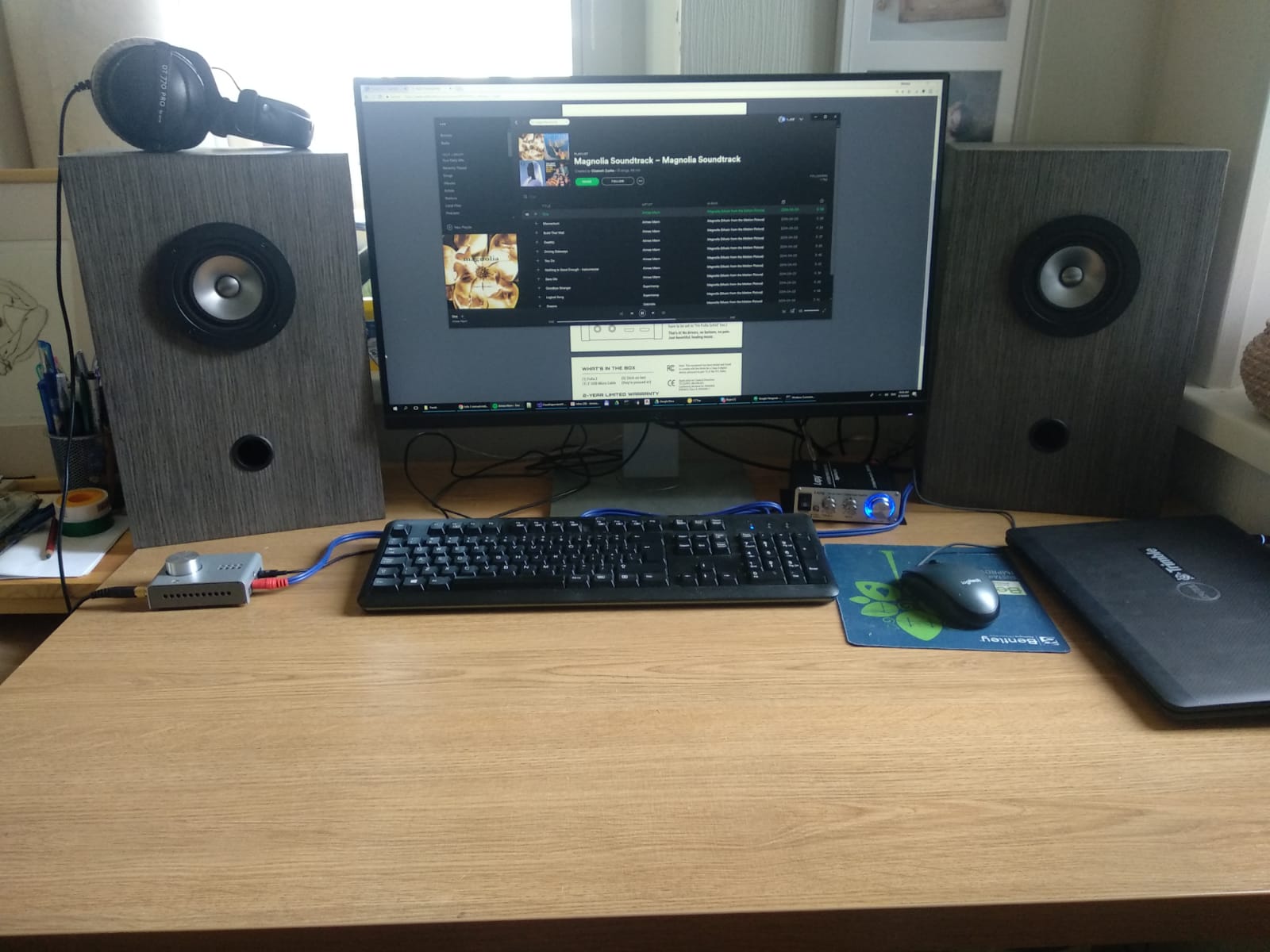

Basic yet brilliant, golden ratio Alpairs 7. My first build, grey oak veneered desktop speakers. Love the sound BTW.

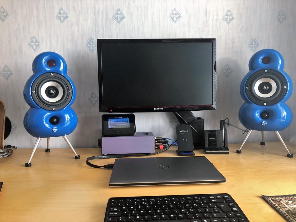

Its a long time since I posted here, but here are my current office system speakers. Jordan Eikona in original Blue Room Minipod cabinets. Amazingly they fit perfectly with no mods needed! So obviously the tweeter has been blanked off and the port too, so they are now sealed and roll off at around 70hz. Perfectly low enough to get good integration with a BK subwoofer. I tried a few small cabinets for the Eikona's but these sound the best, the shape certainly helps, very low baffle defraction effects, and also breaking up standing waves internally, aided by the damping material too. These are great wide range drivers, very transparent, clean, clear and work very well in the near field, about 3 feet away currently!
