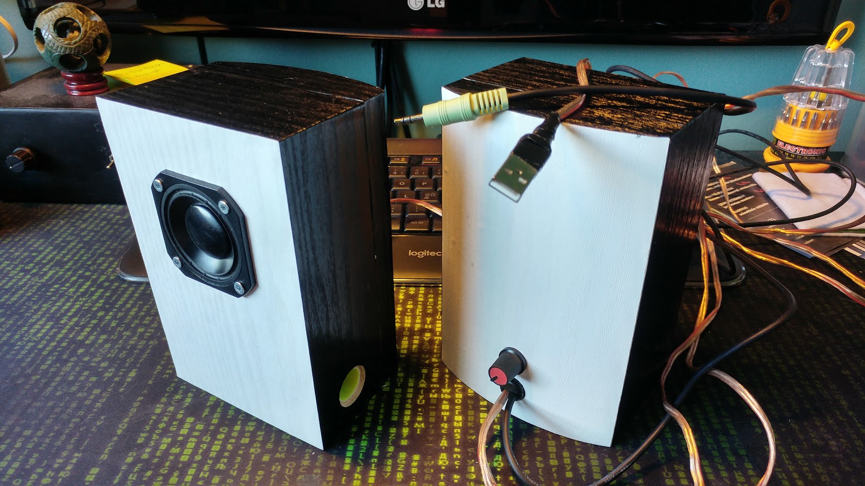

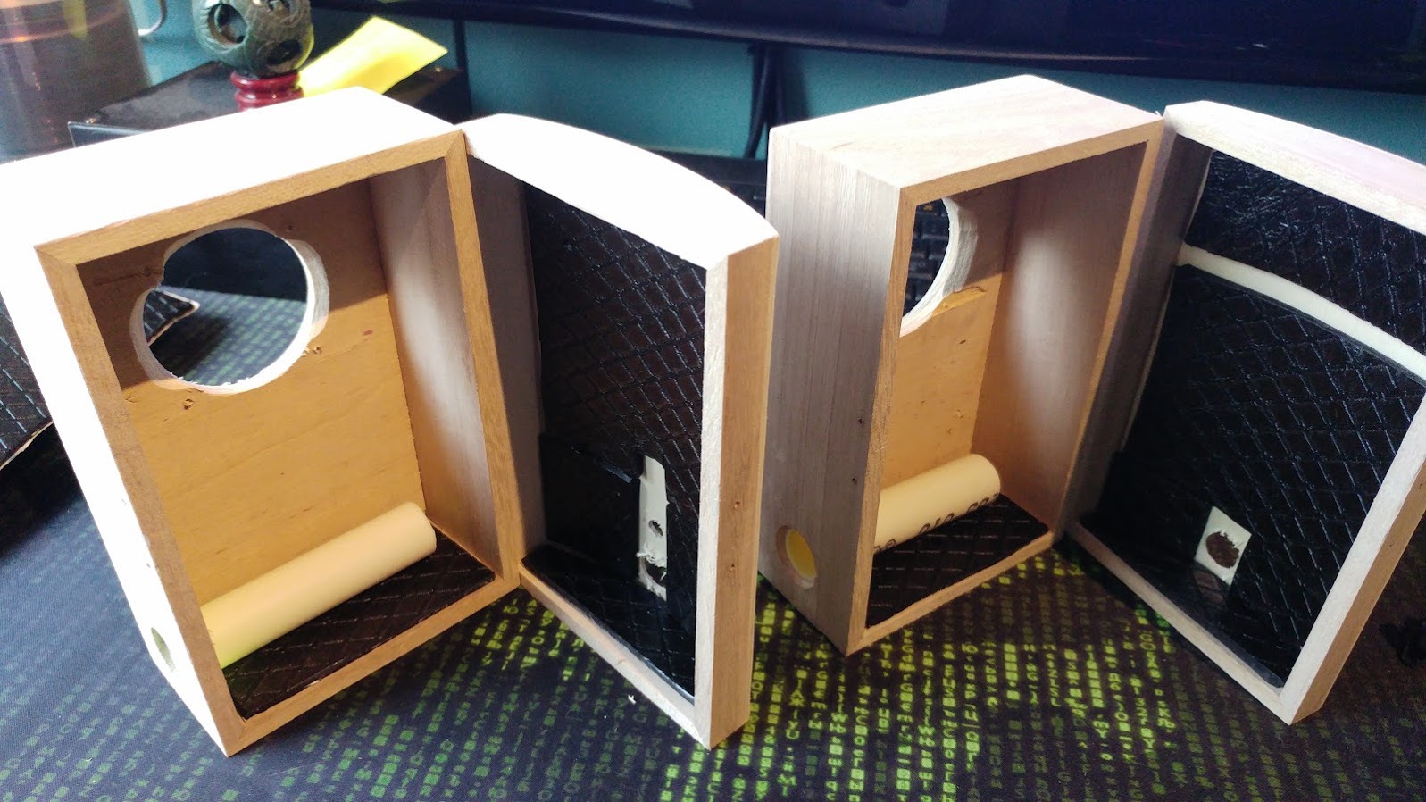

Made a quick build to get some speakers to my office.
Had these 2" peerless laying around useless, put them into wooden chests (4€/each), tuned them to 100hz. Made a thicker front baffle with a piece of plywood and some bitumen mat on the inside to add weight. Finally filled with polyfill and wrapped them with dc-fix. Amplified by 5 volt class-d PAM amplifier.

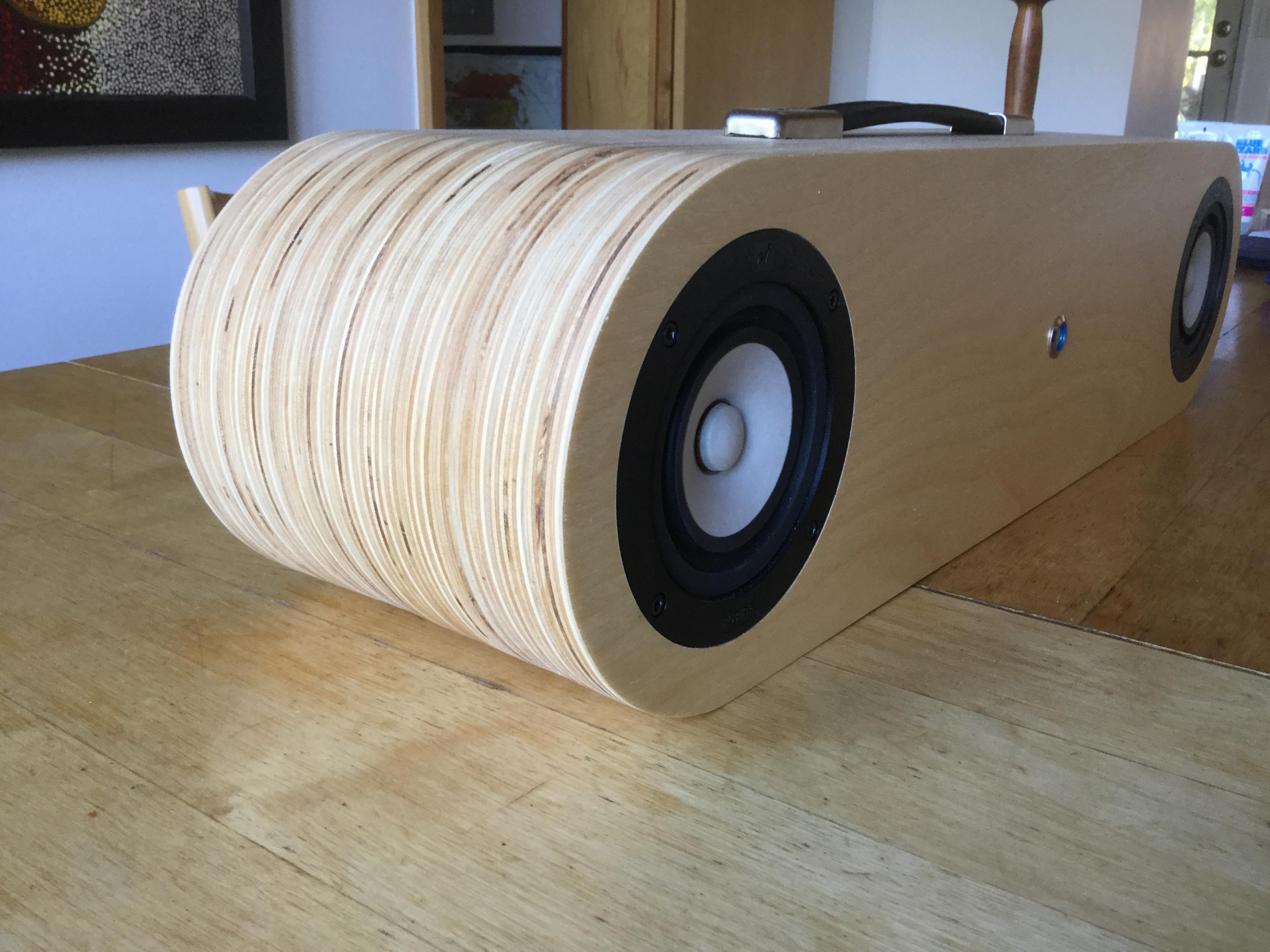

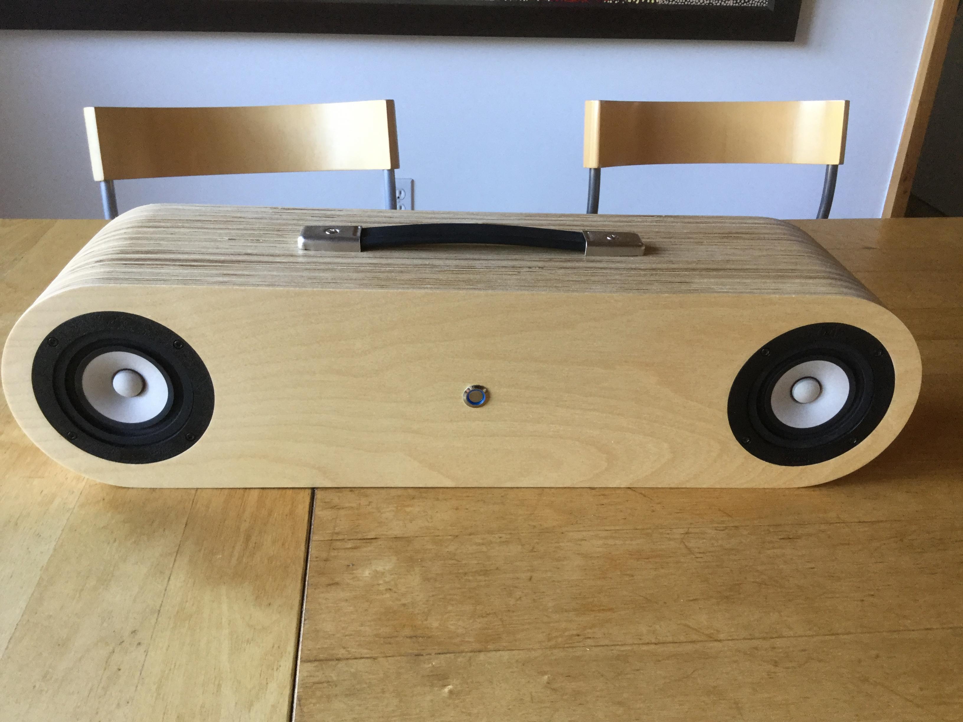

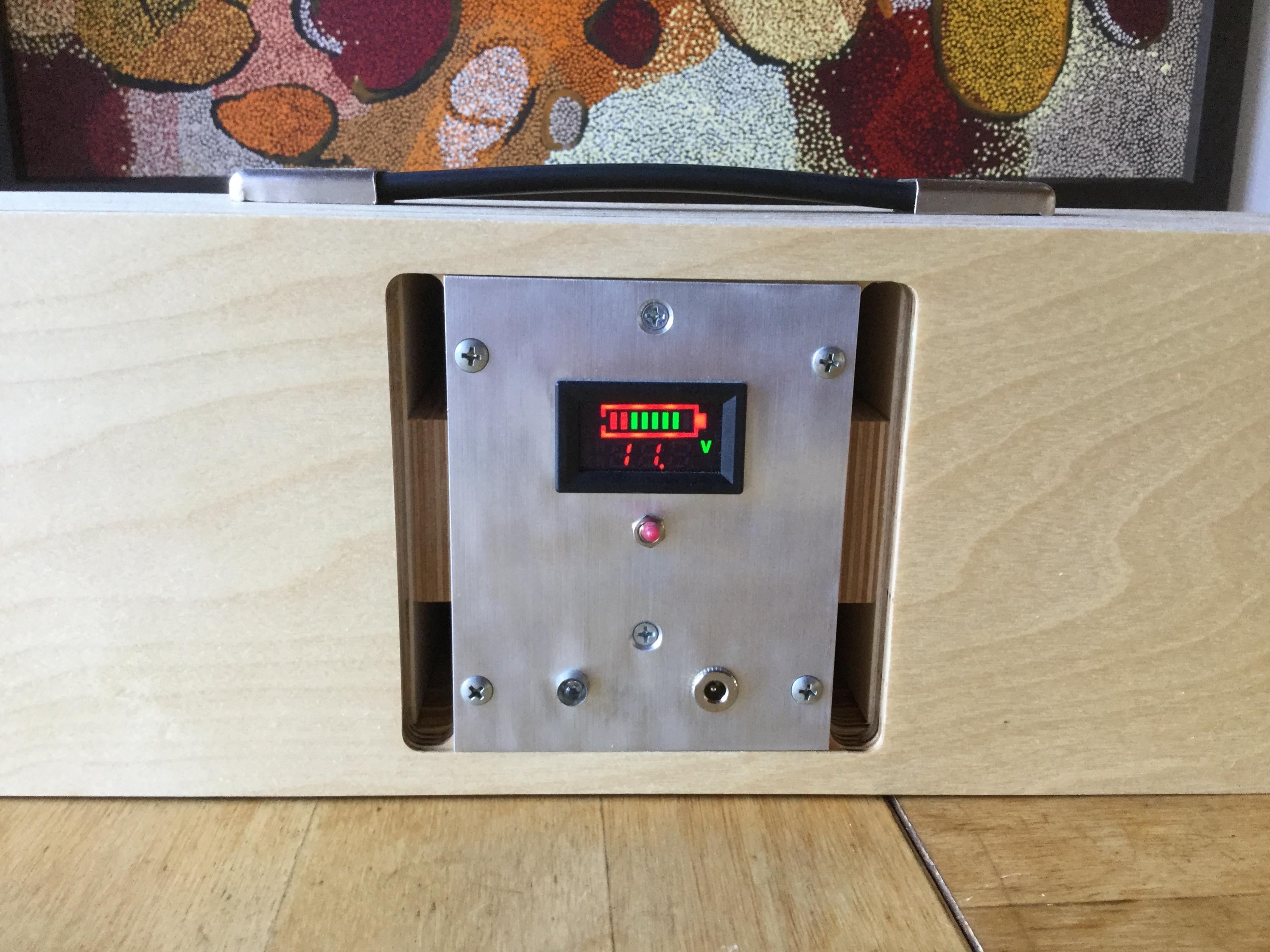

Finally managed to finish my Bluetooth 'soundbar' for summer. This is inspired by the micro-Onken with an Alpair 6P in a 3L enclosure tuned to 70 Hz. This uses a Sure 2x25W TDA7492 ClassD amp from Parts Express which runs happily all day from 3 18650 batteries.
After the drivers broke in, this thing sounds great. If I put it near a wall, the bass is quite impressive.

cool & awesome!
Nice work torrence! Did you get plywood pieces cut by CNC?
No, I ended up building a hack router table from MDF to cut each piece from a pattern. After gluing, a belt sander finished the job.
It is a bit embarrassing to admit I bought the drivers for this in 2013. It only took me 5 years to actually get this built...
So no shortcuts, and good end result. 🙂
Some projects take longer than expected, as other things always seem to get in the way... what matters is that you didn't give up and finally did build it.
Enjoy!

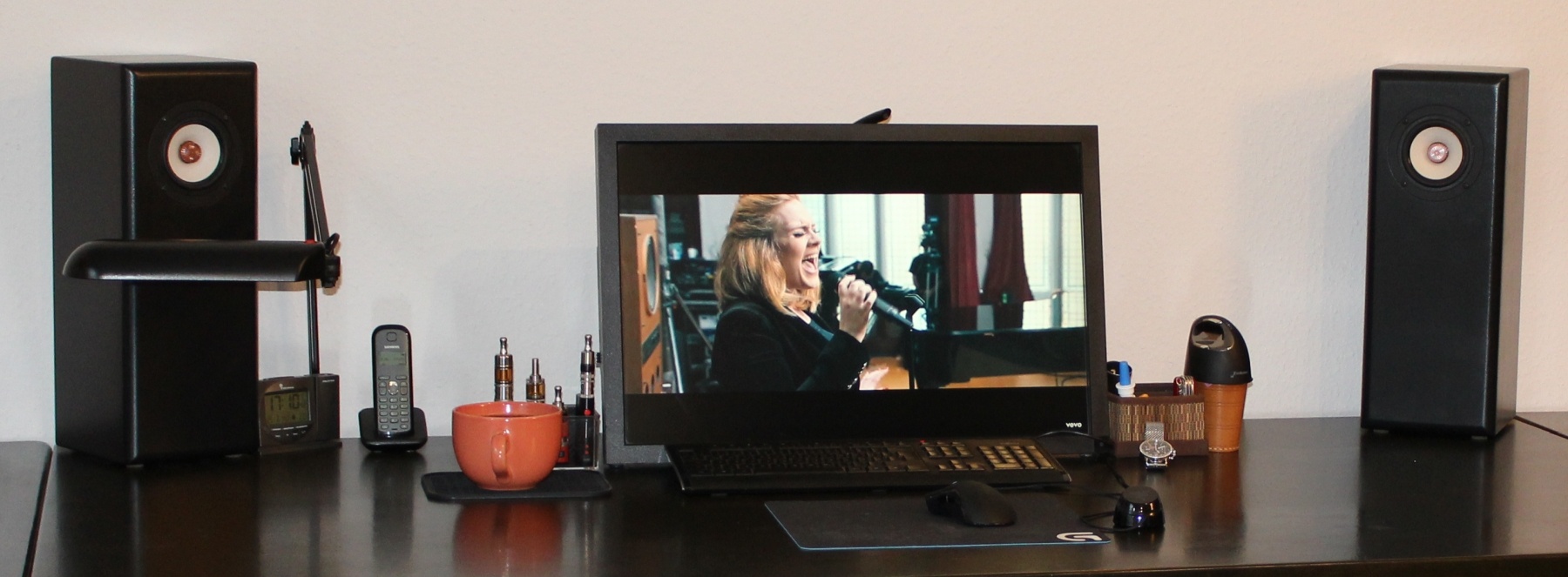

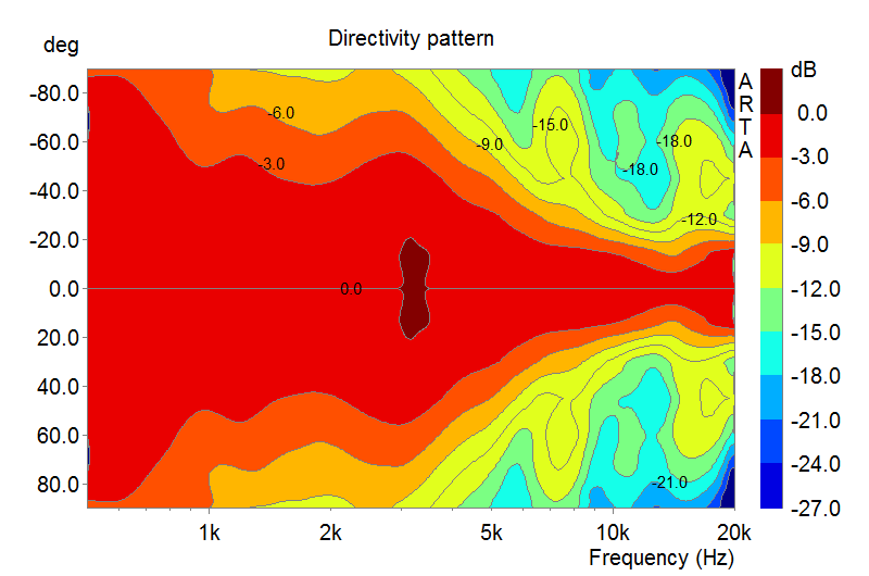

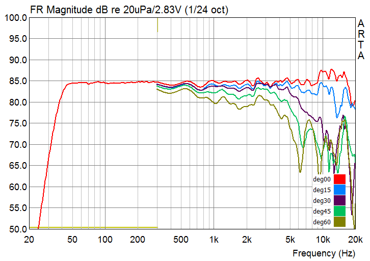

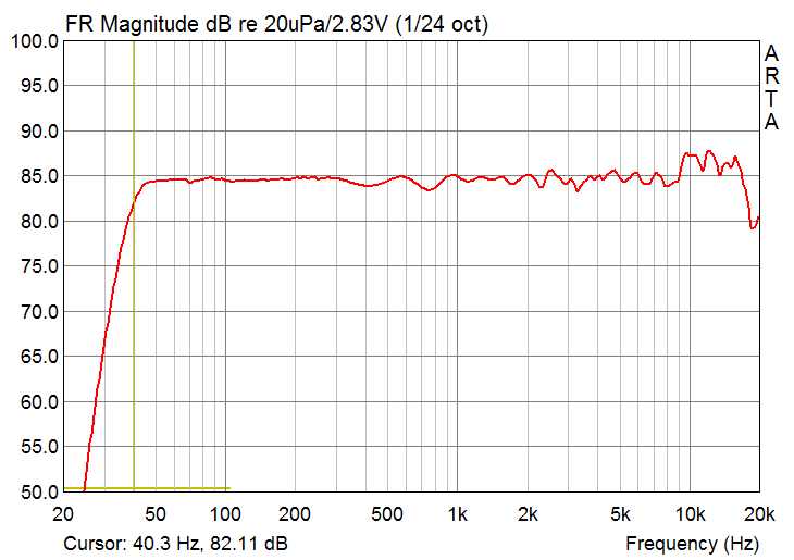

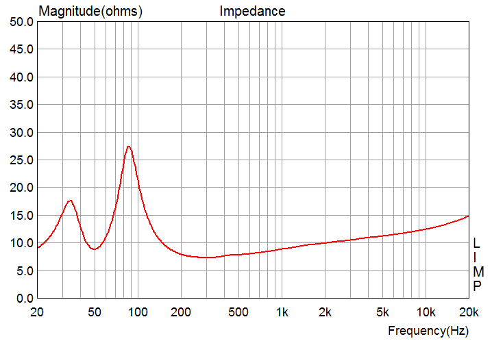

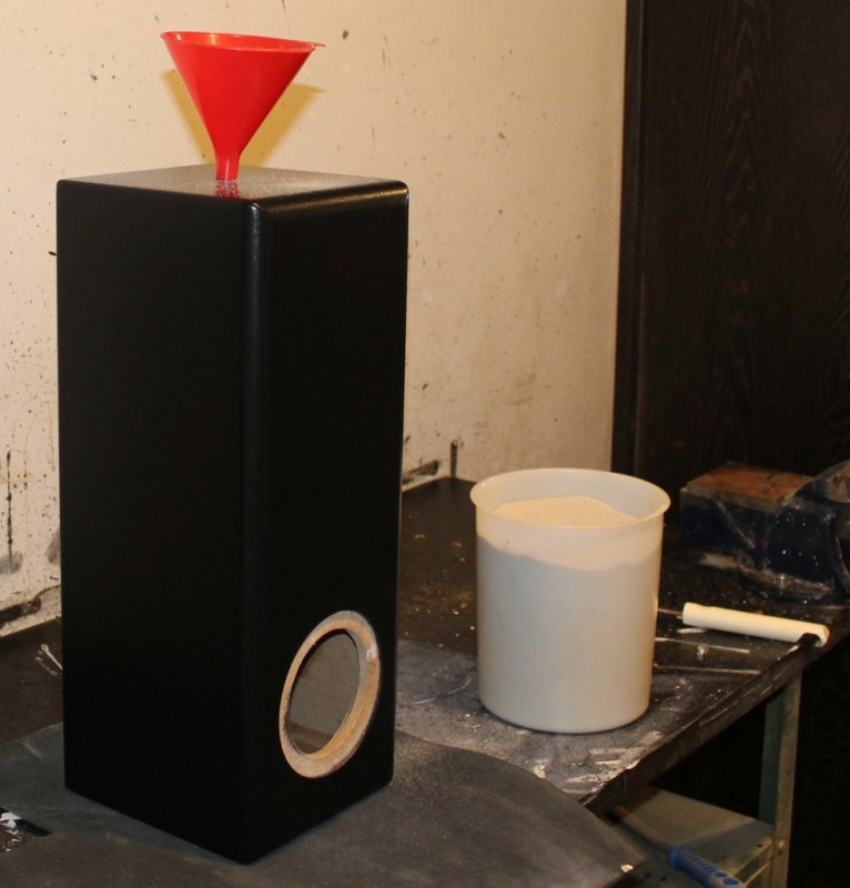

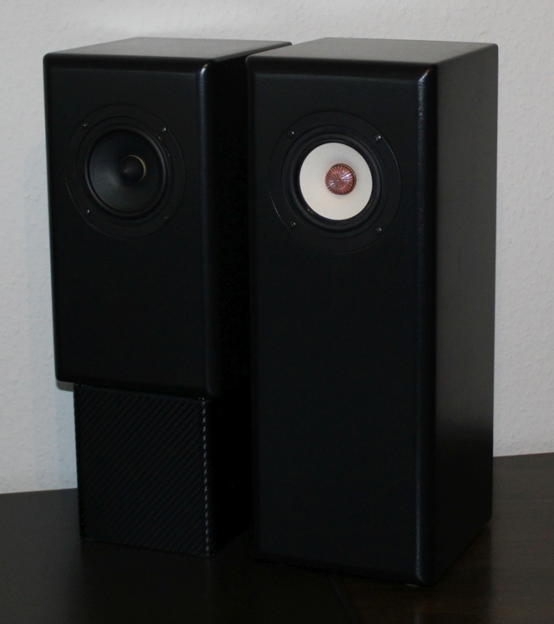

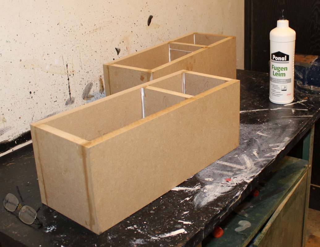

Tinuviêl - a DSP-controlled Desktop-Speaker with Tangband W4-1879
The pc-speaker of my dreams 😀
Deviant the original Tinuviêl a sandfilled stand was integrated in the enclourse.
The plans are available at my website (German).
