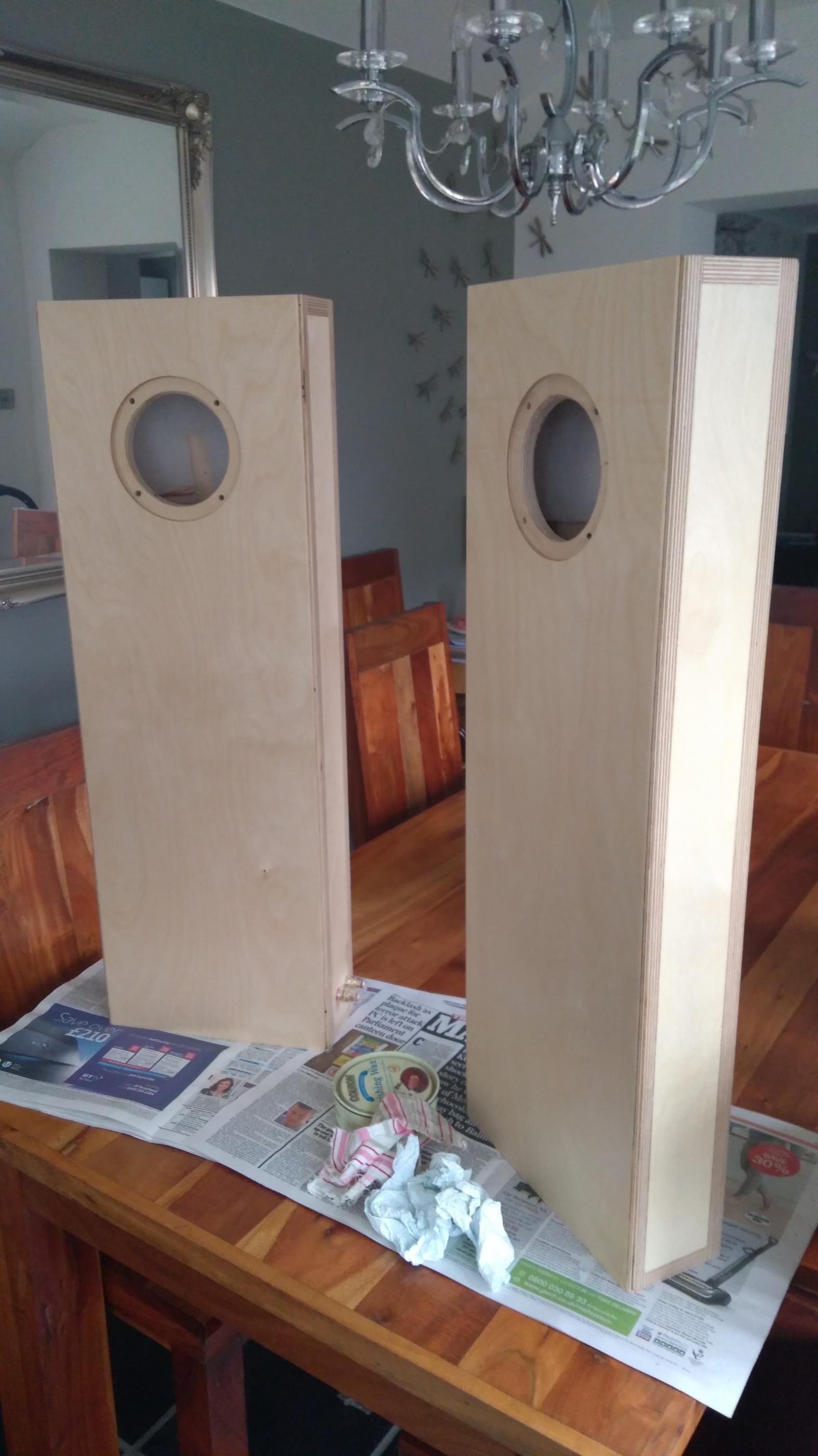

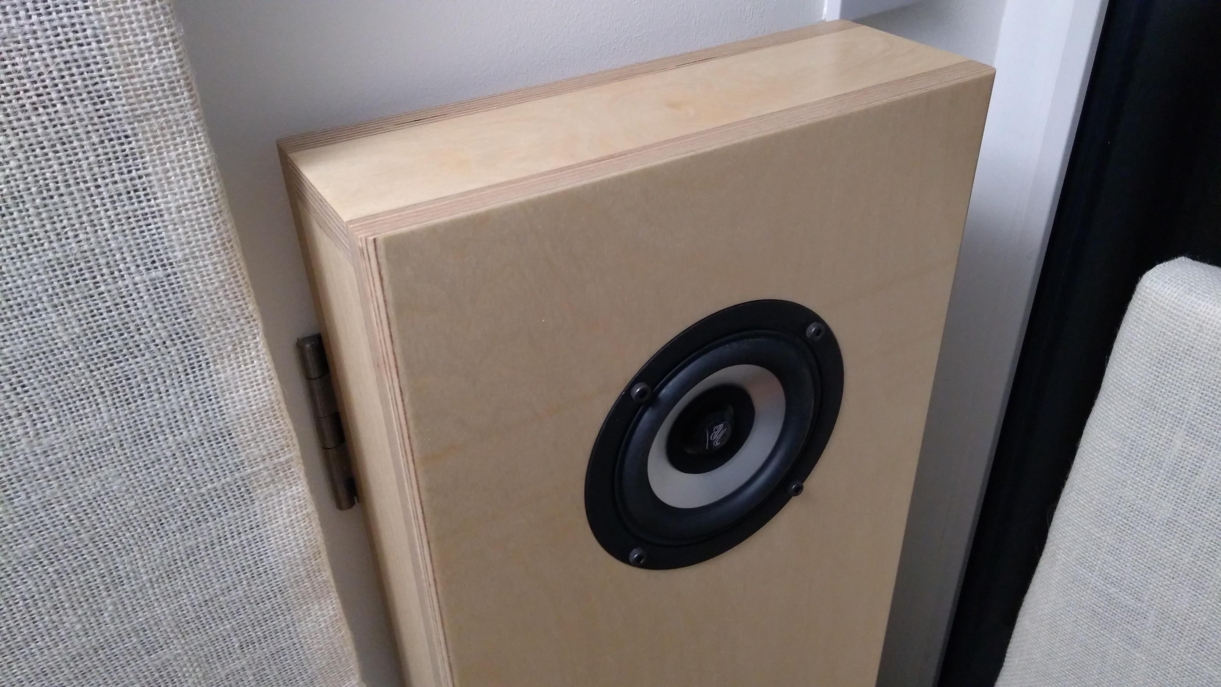

jordan eikona 2 vtl
Jordan eikona 2 vtl using the standard plan made from 18mm Baltic plywood finished in Osmo oil.
Sound good and surprisingly deep.
Attached to Amp camp amps and DAM1021 DAC.

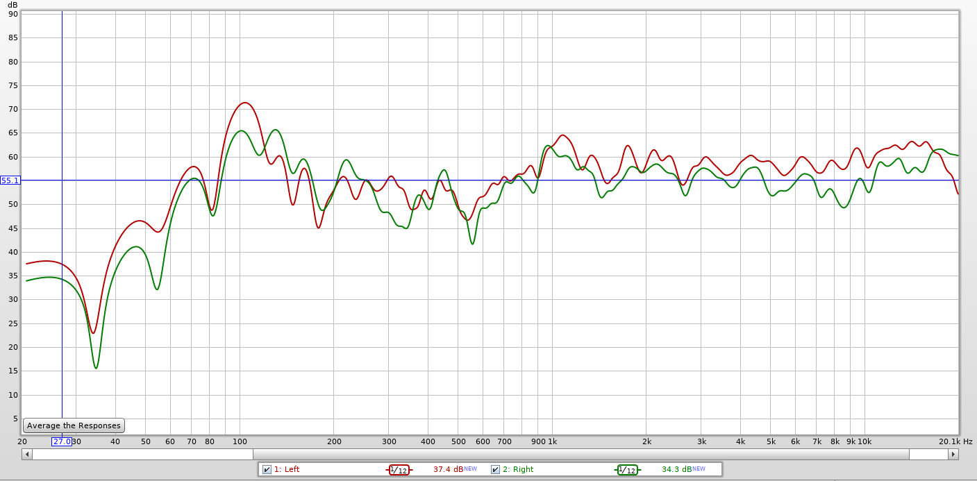

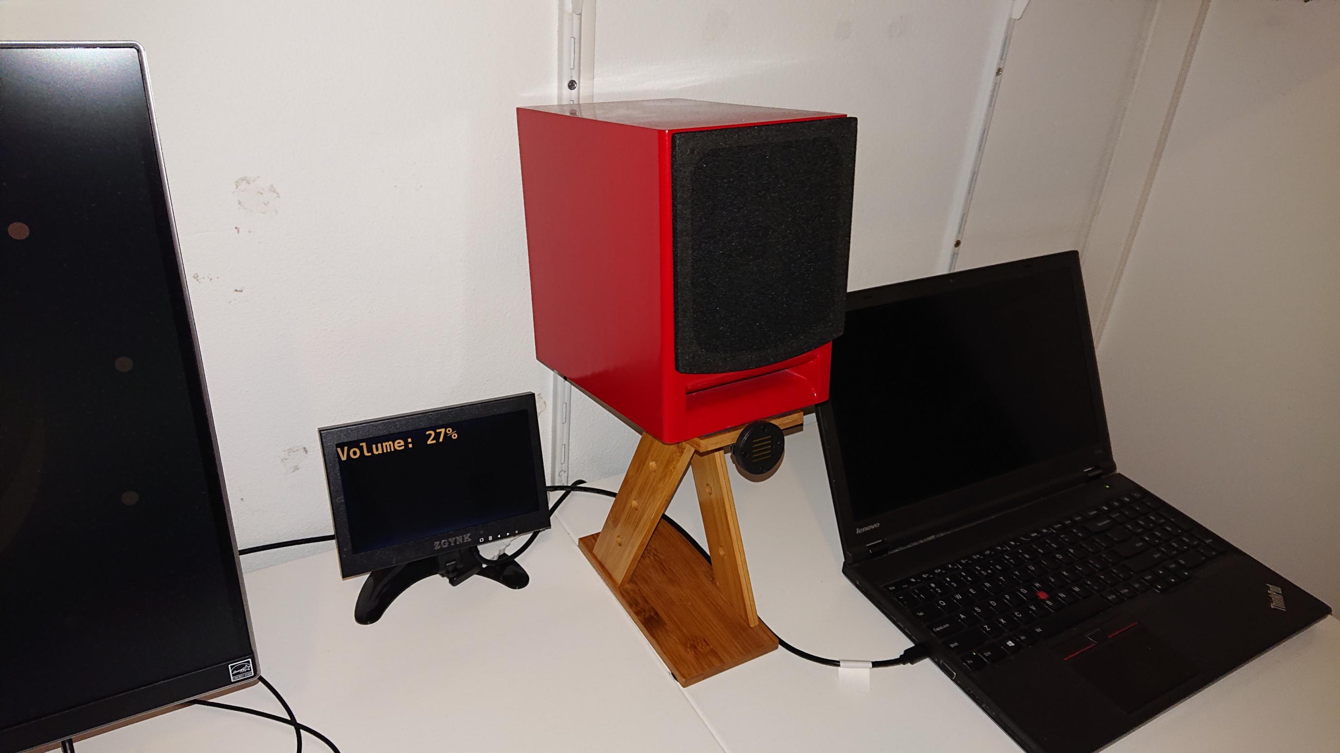

For my desk at home, Tangband W4-2142 in some enclosures I bought on AliExpress, painted red and close off the bass reflex because it was causing problems at around 800 to 1100 hertz, and it wasn't adding anything because I also have a subwoofer.
Below them is a small AMT tweeter crossed over with a 1uF capacitor and 12 ohm resistor in series, it improves the off axis frequency response.
I still have to add baffle step correction.
The stands are bamboo kitchen knife holders from ebay.

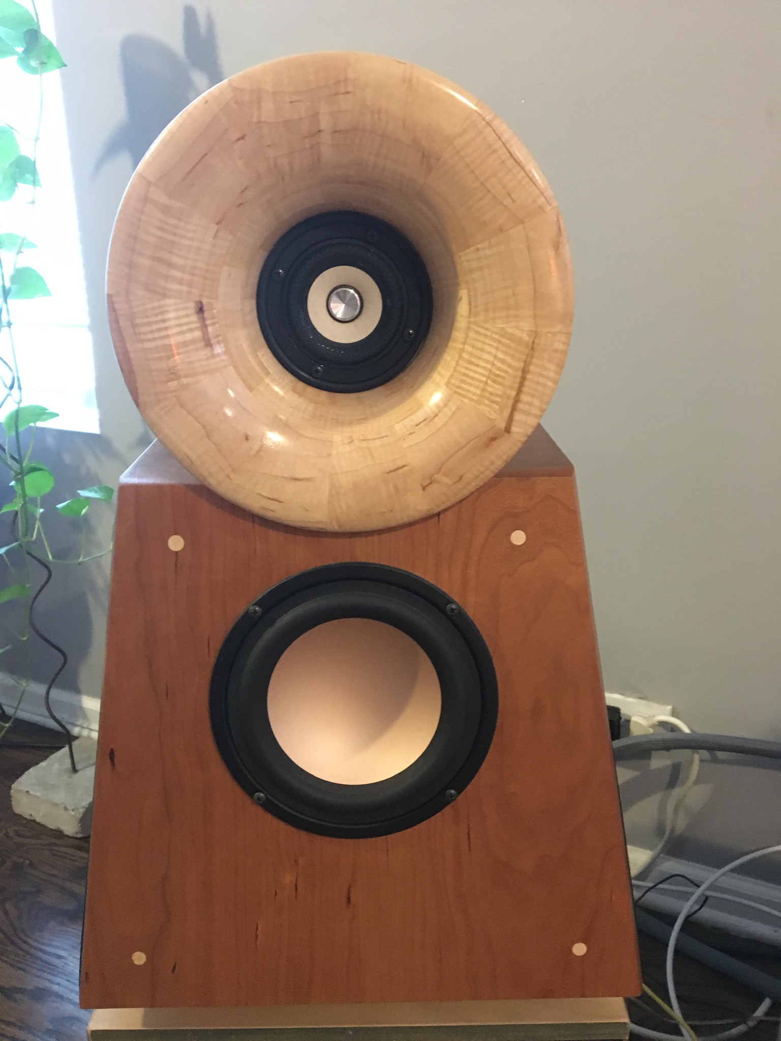

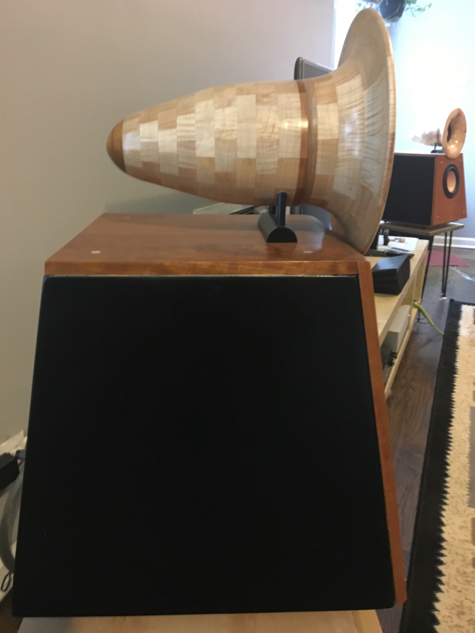

HiVi-Tang Band WAW for a Medium Sized Room
So this is my second speaker build, the first being some 20 years ago. Got back into the hobby last year and decided to use the HiVi M6N and the TB W3-2141 full range in a WAW design.
Vented box of approx 21 liters tuned to 47Hz. The pyramid enclosure houses the M6N, and the W3-2141 sits in a horn/ waveguide mounted on top. The enclosures are rock solid and weigh about 55 lbs apiece.
Crossover modeled in PCD is 2nd order L/R at 535Hz with a notch filter to smooth out a bump around 2000Hz.
Associated Equipment: NuForce STA200 Amp, CEntrance dacmini, Luminous Audio Passive Pre-amp, diy cables.
