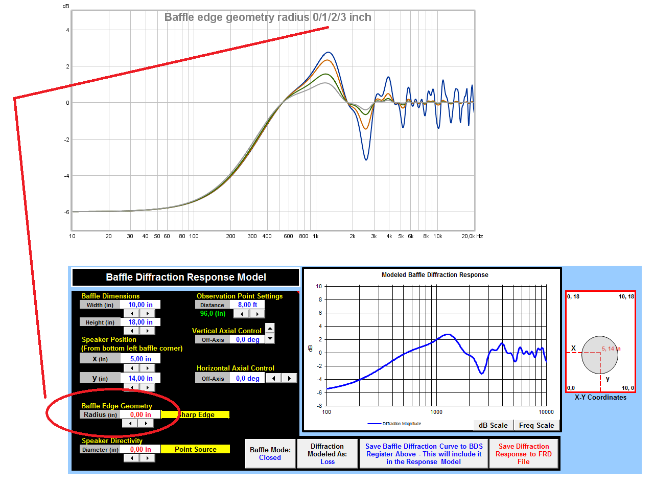

Would adding a rectangular baffle that mimics the front of a small book shelf enclosure, "fix" the problem?
It changes the problem. A rectangle without sides may or may not be better. Big bevels or roundovers are needed to minimize problems at the transition.

Thanks Dave,
Would a frequency spike or valley help determine the size/shape of the baffle?
tilroh,

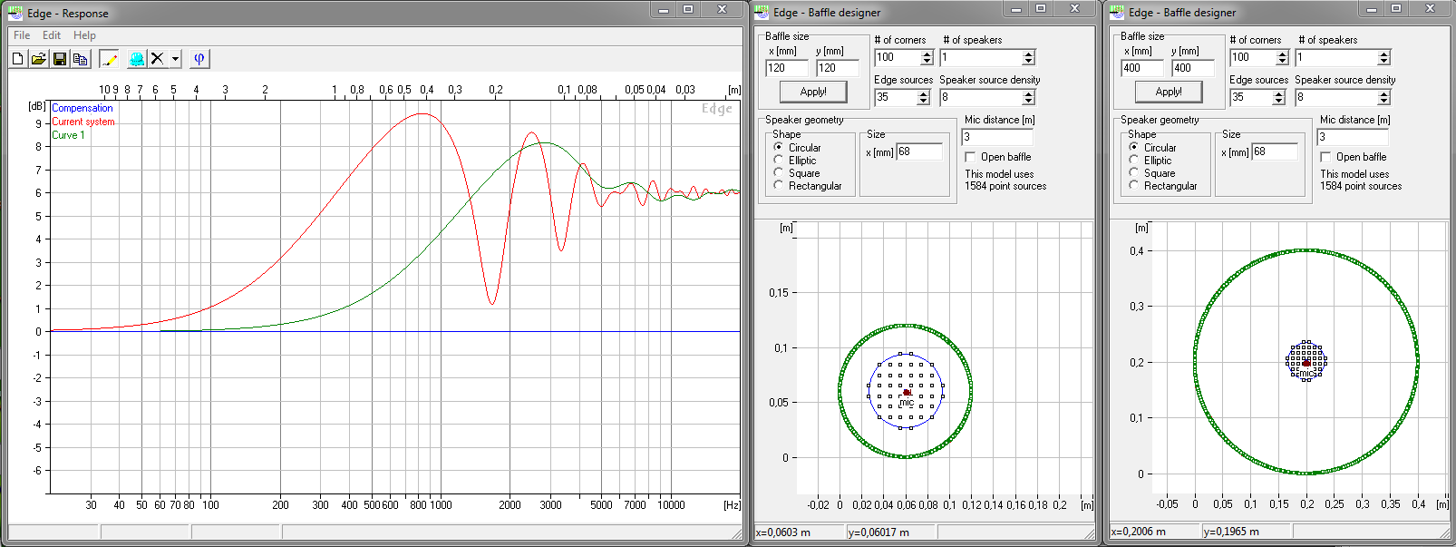

Here some examples for baffle and edge with different roundover radius, those are free tools available here Tolvan Data and software.

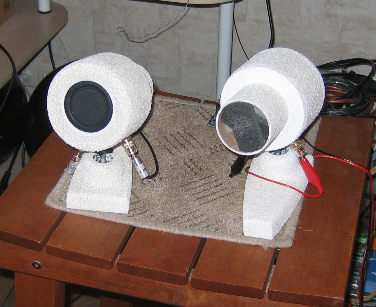

Crap! Looks like a cylinder is the worst possible shape. B.Brines said he mounted his Scan Speak 10F/8424s in PVC pipe, but he must have mounted the pipe in the woofer box.
How to save it?
Thanks, Mack
If you like the sound, enjoy it. Full range speakers have their limitations anyways. The Tao of DIY-loudspeaker construction is that what matters is not the end result, but what you have learned from it. For little money, you can buy a measuring mike and see for yourself what the effect is of enclosure shape on loudspeaker performance.
Thanks but I've measured it and the graph looks like crap as well.
I'll fix the sound by putting a baffle in front, which will hide the copper pipe look 🙁

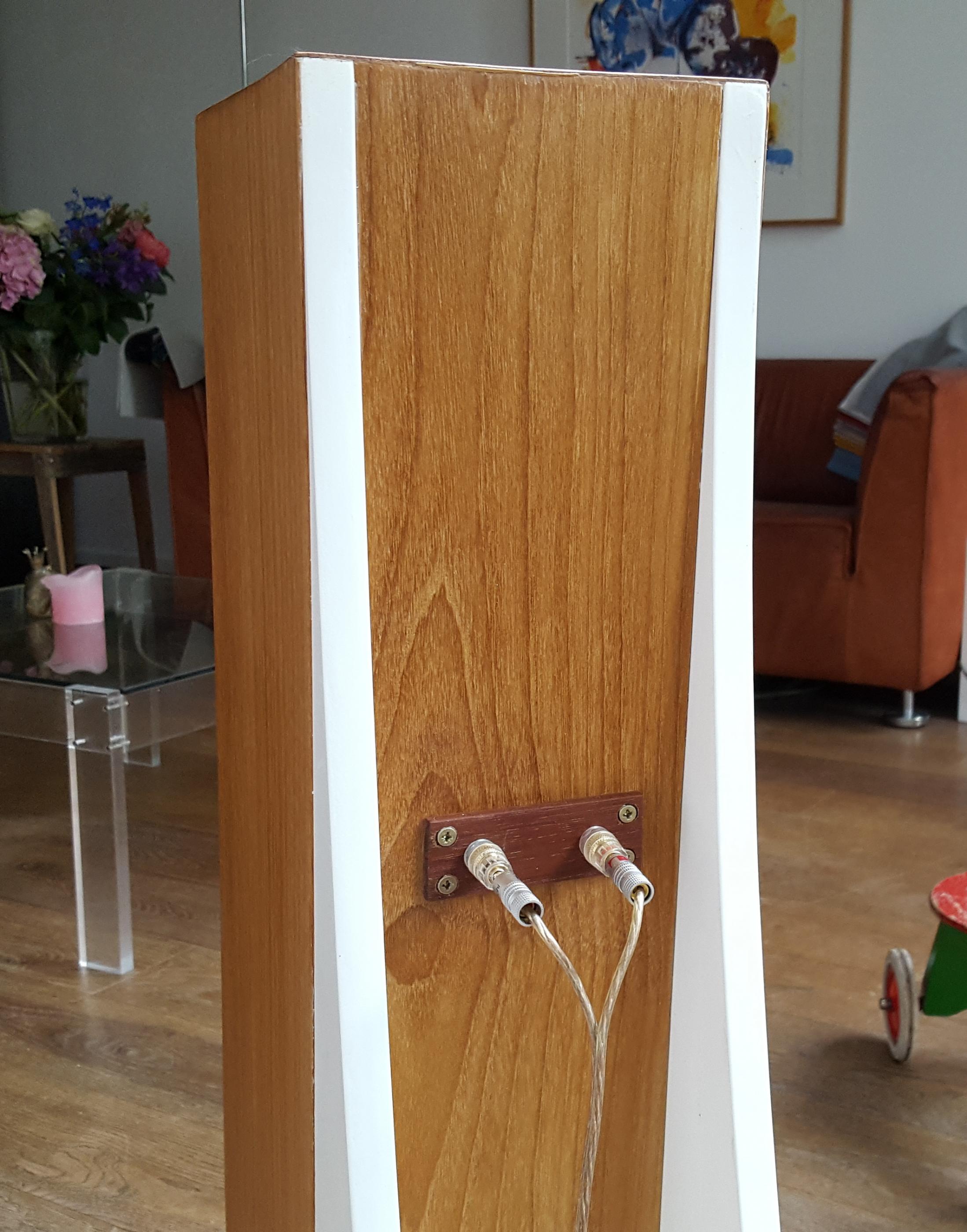

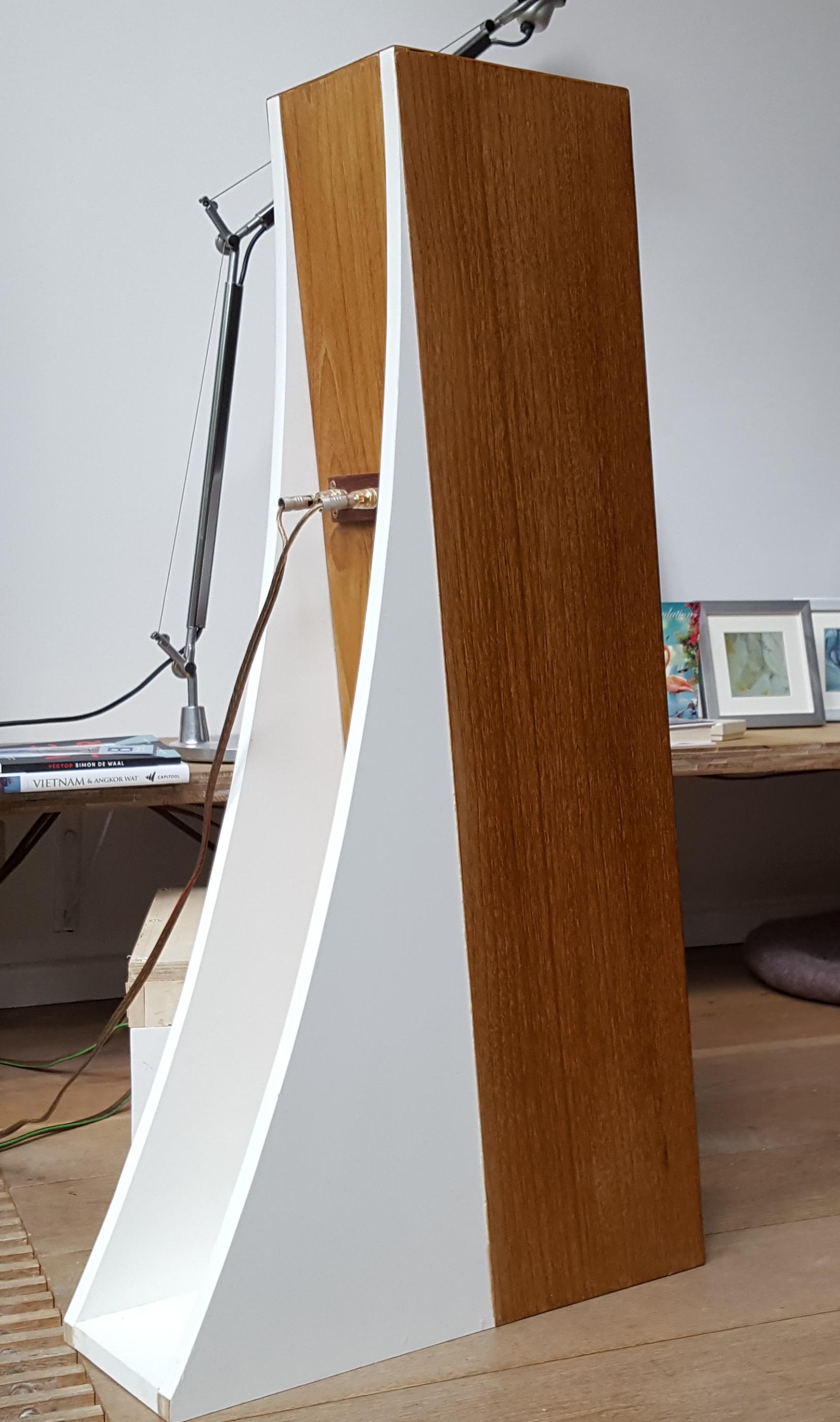

Looks great and I like the idea for mounting the binding posts on an additional piece of accent wood.
