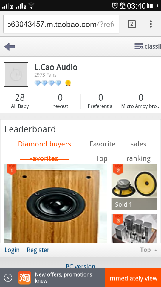

Yes you are right, it is a Tornado enclosure! Here is the original L.Cao site https://fullrange.world.taobao.com/...m=a1z0b.7.0.0.cFm1YB&user_number_id=478742437 where I have bought drivers
Alvipet I'm curious how you made a purchase from that site when it's in Chinese? I kept trying to change the language to English, but nothing happened! So please share with us all what you did , ok?

using chrome mobile browser is better for translation, and for buying items from taobao usually much more cheaper than from aliexpress or ebay
Hi gadut,
A small query. What was the driver price excluding shipping charges?
Thanks,
Saikat
driver price was $150 SGD, a real bargain for this driver. i had to wait for weeks until singapore distributor (neo) got restock. you can ask for cheapest shipping using singpost, 3times cheaper than regular package but maybe need more time to reach you, around 4-6weeks.
