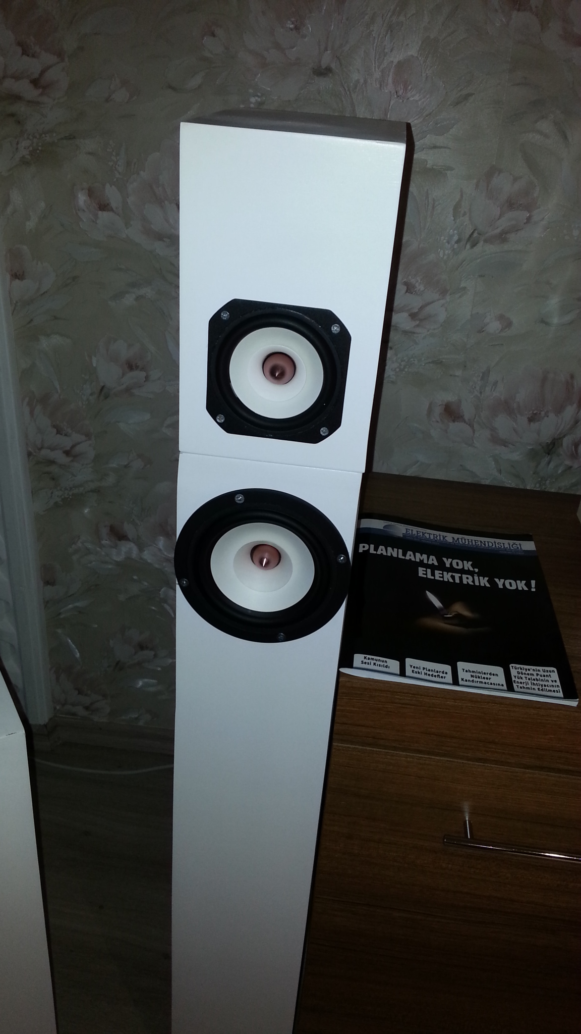

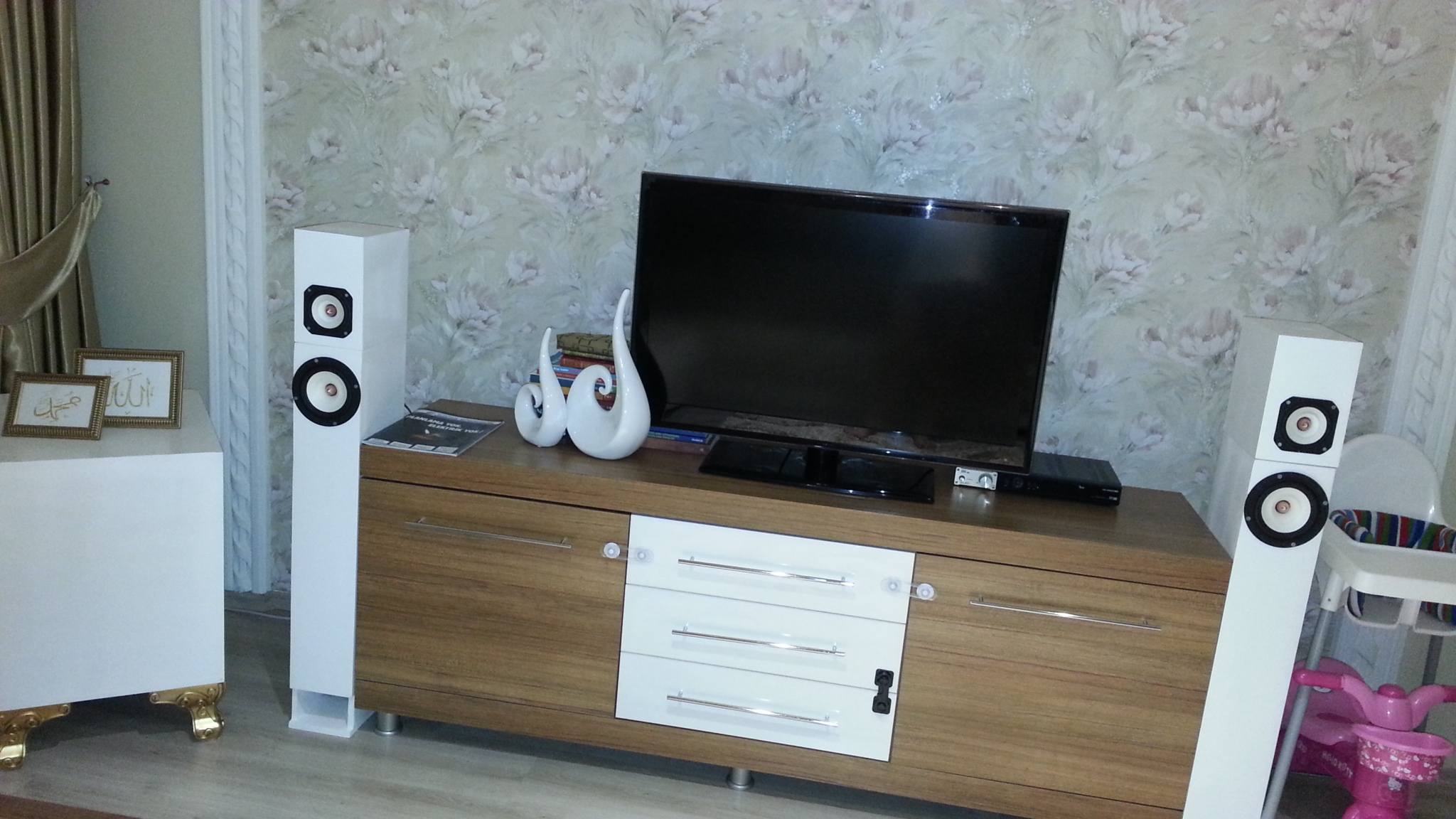

Hi all.These are Aucharm FR drivers.In the bottom is 5 inch Aucharm in a TQWT box and 4 inch one is on top.I will use them in some versions.Will cross them at 340hz,also can be worked seperated.It all depends on what i am listening.Also there is a WAF subwoofer on the left.All made by me to make accepted by Wife 🙂

Hello!Sorry i did not understand why buy again.I already bought them.These ones in the pictures are already the speakers built by myself.I am listening them seperately with TA2020 amp.I bought another more powerful Class T amp(topping TP22) to drive 8 ohm 5 inch ones because TA2020 is not designed to drive 8ohm 5 inch ones.I will make 2 way project.Crossed at 340hz.I will use active crossover or PLLXO.I did not decide it yet.Maybe i will try both of them.4 inch fullranges sound sweet to me in a sealed 5liters box(altough treble is not sharp/fast/clean, as my Vifa XT25SC90-04 tweeters) it also needs a low frequency helper woofers/subwoofers.What is your suggestions? Which crossover frequency will be a best for them?
Yes it seems 5 inch one has flatter response on graphic but 4 inch one sounded with better treble to me(IMHO)Maybe it is because of more bass of 5 inch driver.

My thread applies to those reading it not to you, you make the right decision buying them.

Oh ok i understand.Could you tell what other 4 and 5 inch have you listened so far?Is it worth to buy Markaudio 4 inch paper gen 3 drivers?Or maybe some other FR which more expensive.(I am a non satisfying man🙂 ).I will use all of them in FAST projects.Thanks

Hi.I think i will try some of your EN Fullranges in near future.Maybe you can get some Aucharm too.I think you can get good prices from China factory if you buy in wholesale.They sound sweet in 5 liters sealed cabinets(i only tell they sound sweet,maybe not very accurate sounding ones).Maybe you can make Enable process them too and tell us the results.They are 4 ohms and really have a very good synergy with TA2020 amps.
