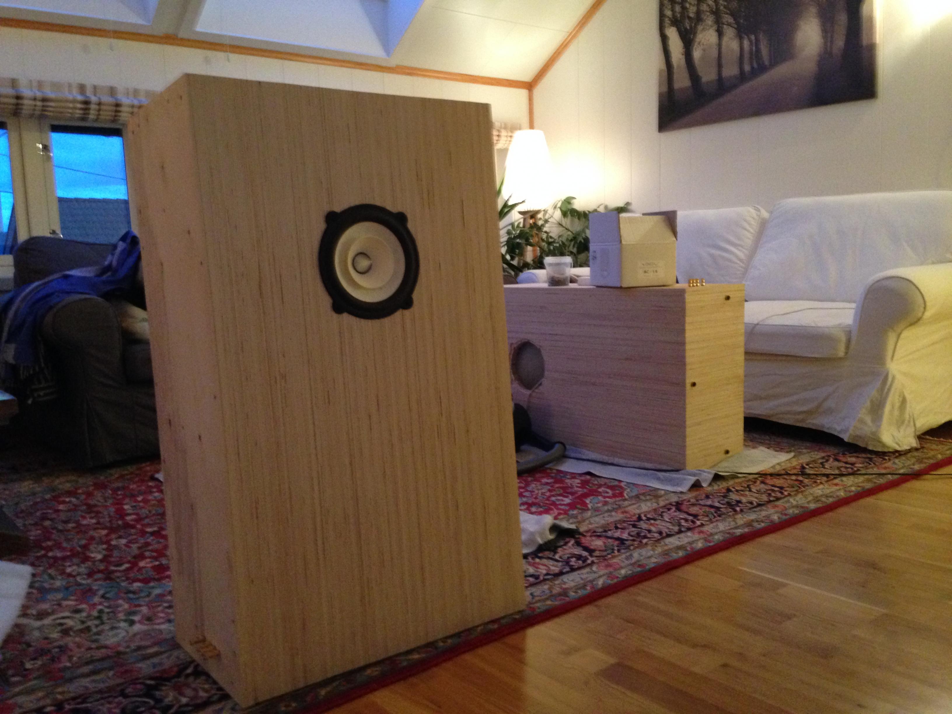

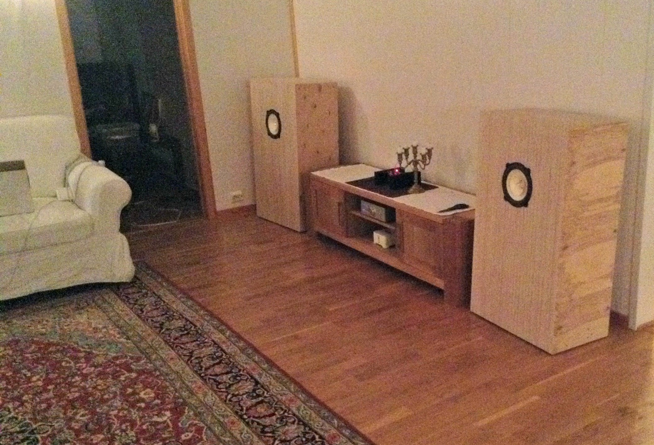

LoL no cars were harmed during the construction of those walls. The boxes were originally planned to fit in the backseats.How many cars have you stolen to get all those speakers!!!...😀
I saw a similar build in a thread at AK (couldn't find it), it was like this sub, but then they added an OB tower on top.
