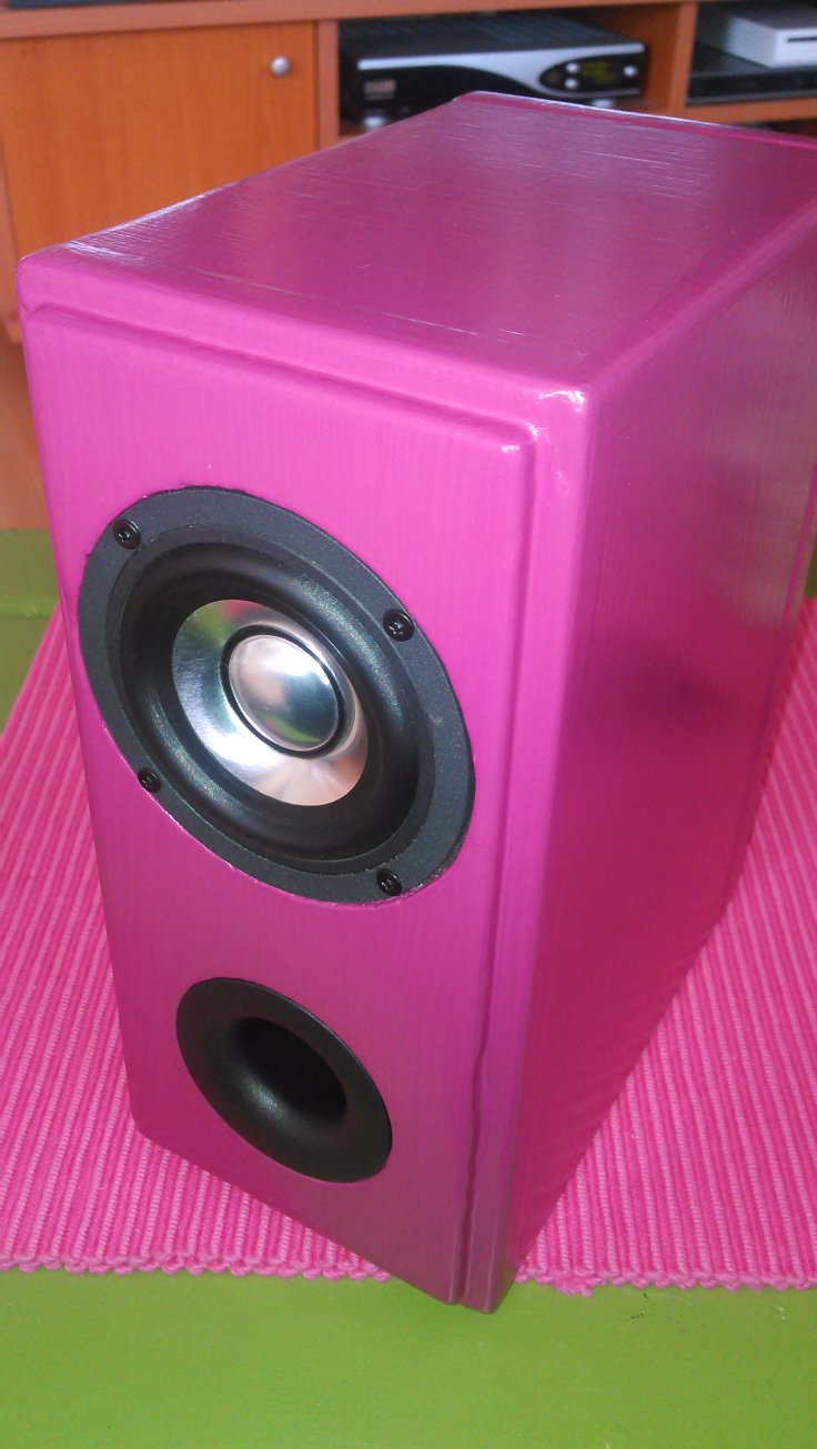

These are my first real speaker that I have made and enought happy with result. Parts are sawed very precise in local wood center, but all routing is made with dremel.
Just after routing them I think I find out how it shoud be done to get better quality, but didn't have sawed spare parts so I leave it like that.
Sweet pinks have FR88EX driver in 2.2L box and tuned to somewhere around 80Hz to get little kick for TV.

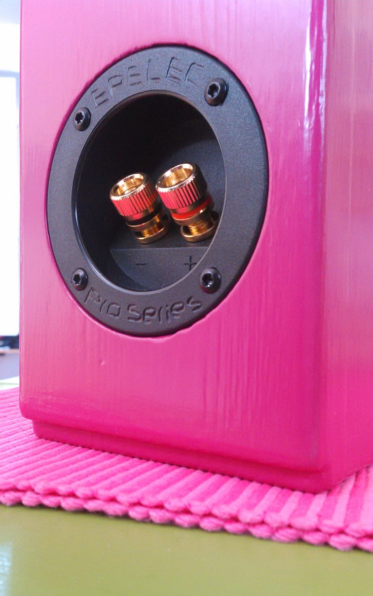

Color is compromise for placing them as TV speakers. As little bonus speaker terminals got little custom "brand" engraving.
