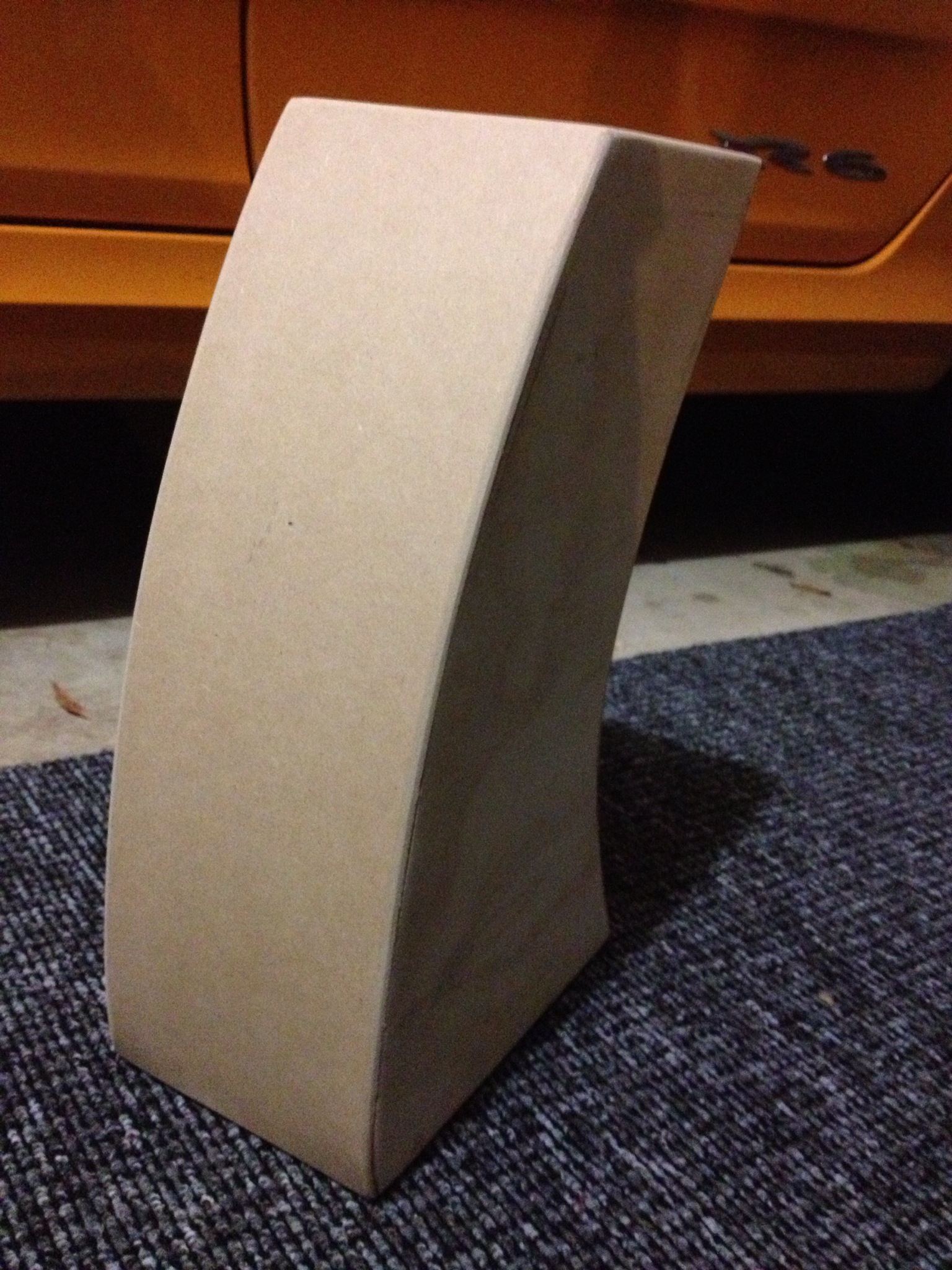

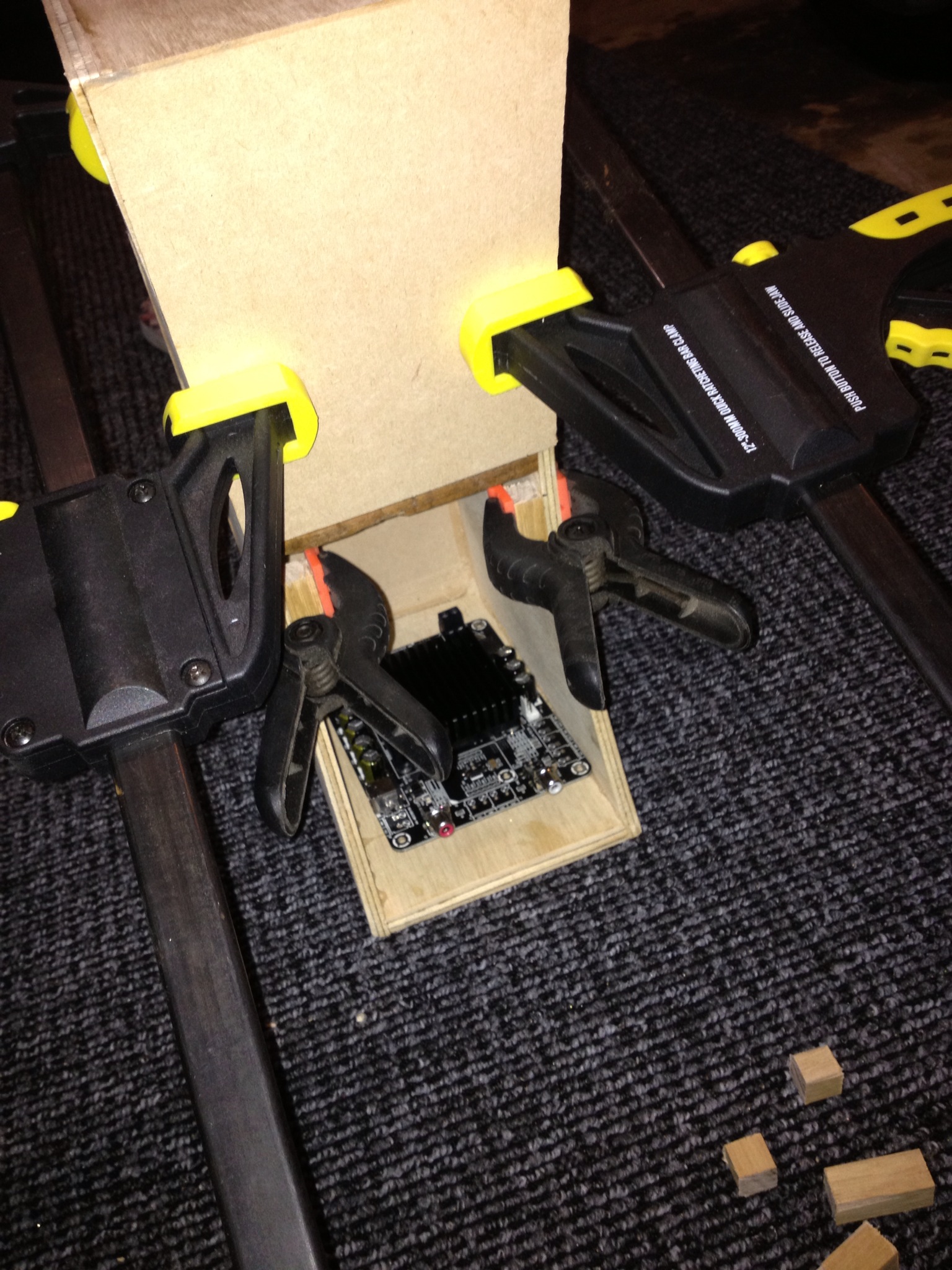

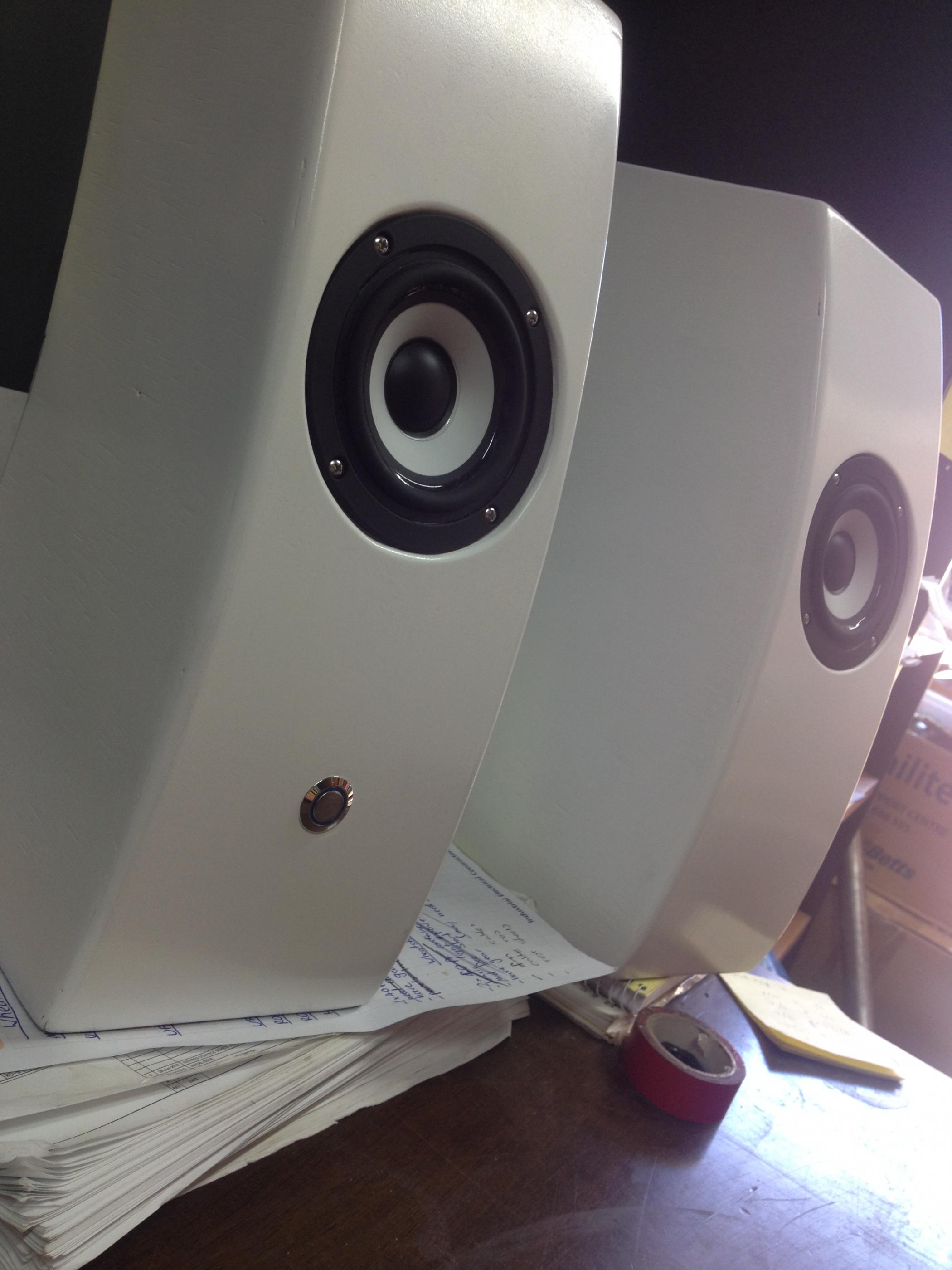

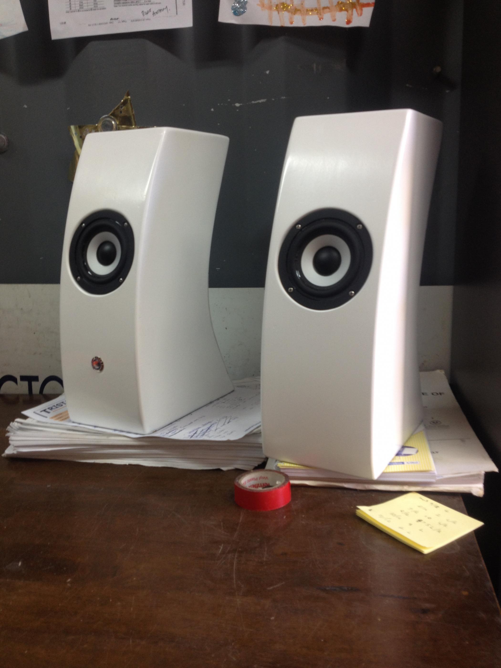

these are my laid back whites
used the tang band W3-315E 3 inch
boxes are 10mm ply sides and i bent and glued 3mm mdf over the curved edges
then glued reenforcing on the inside
inside is a sure 25W X2 the pump to a nice voume put a led push buttin in one
for power switch on
so far the have been my favorite to listen to at reasonable levels nice mid and bass for speaker size and wattage

Wow, impressive, Goodlagger! For the front and back, is that epoxy lamination or just thin ply with a thin MDF veneer glued and fixed to the sides? I suppose with a 3" driver, you could get away with a pretty simple structure. I've thought a lot recently about doing some ply lamination b/c I found it remarkably easy when building my cedar strip canoe. Hmmmm. And what prompted that particular curve?
Laid back whites
The structure is ply sides top and bottom then 3 mm MMF bent over that front and back then a bunch of 10x10 glued across to give extra strength prob didn't need it once the MMF is bent it doesn't move I sanded it smooth then primed and painted with acrylic 5 coats and hand polished to get a semi gloss finish I know the material used is thin but with all the tight bent wood they become a solid unit as for the shape I just like it its different I know a lot of people will disagree but apart from sounding goog they have to look good a talking pice in a room ect

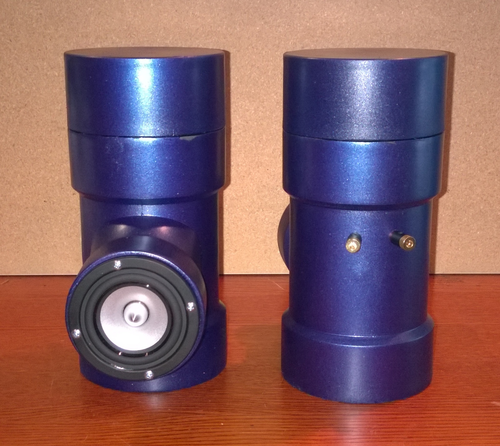

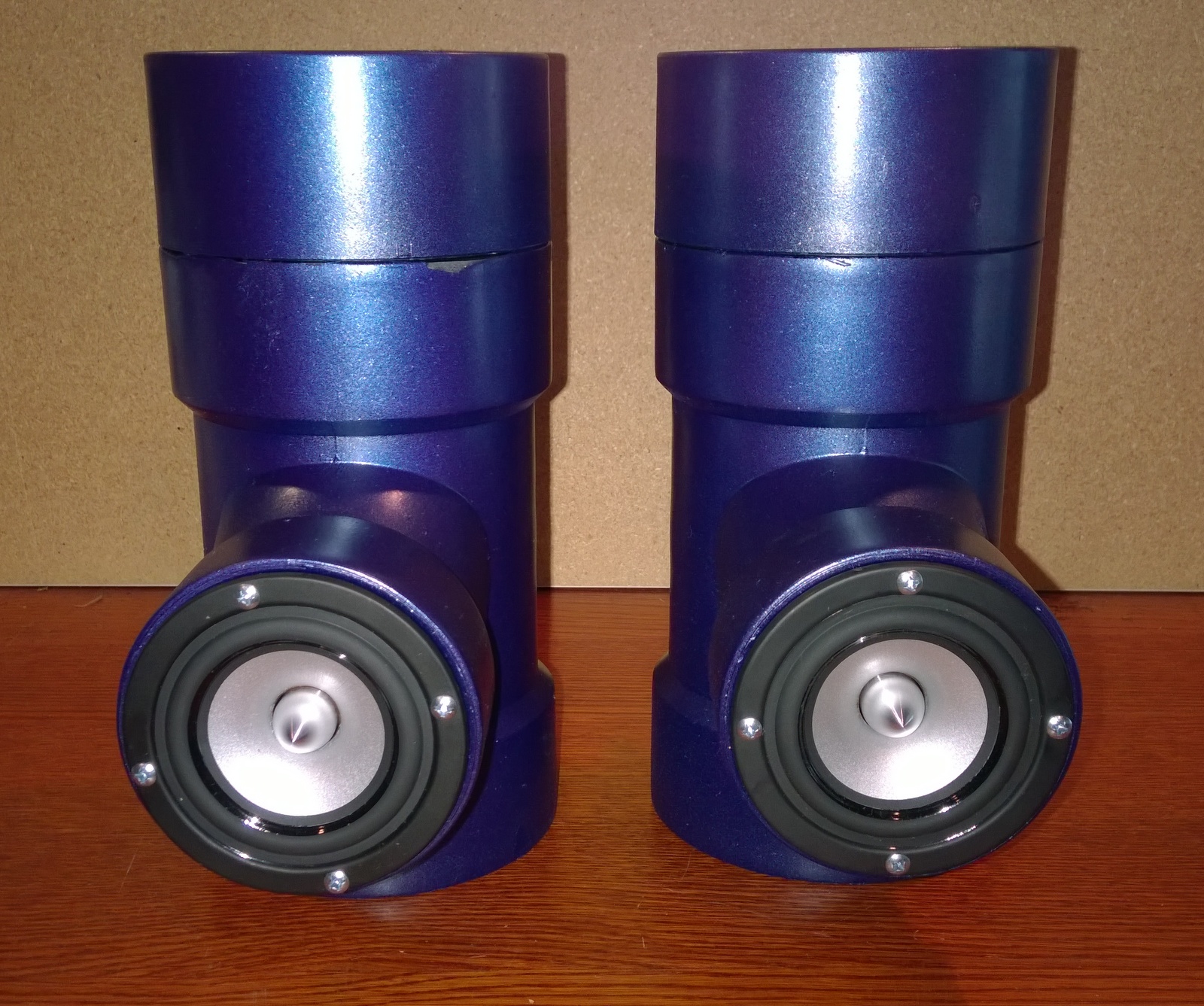

Here are my first speakers. I built them out of ABS pipe and used a pair of TangBand W3-871S drivers. I've actually had these drivers sitting around for about 7 years but last month I realized the fit perfectly inside a 3" ABS pipe. This is a sealed design and has just over a liter in volume.
There's a noticeable flaw in the paint job so I repainted them after I took this photo.

Good work I Likey much, much. I have some TangBands which I have had for 7 years also. I think mine are the 5" drivers. Bay be some old drain pipes could make some rustic boxes for them.

I agree with mhouston they do look professionally made!

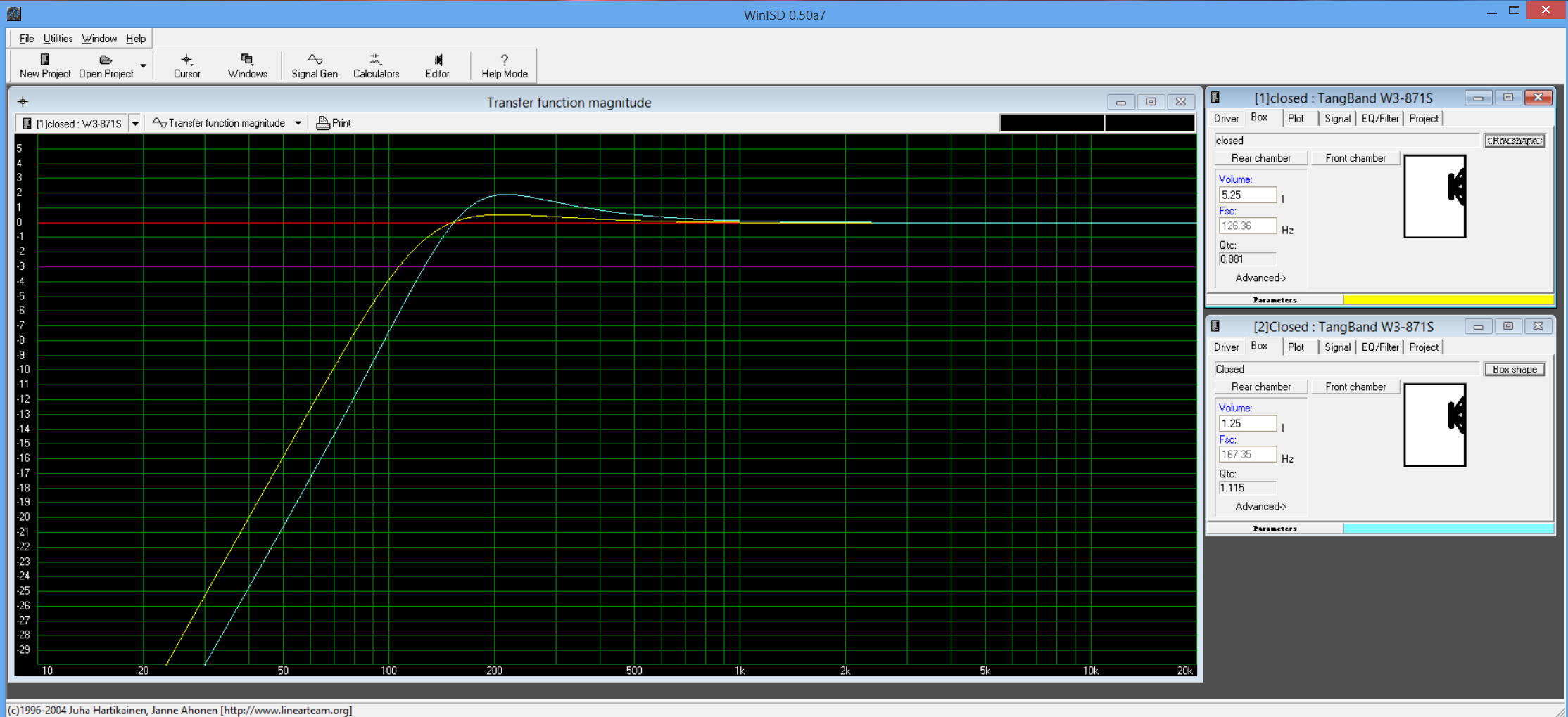

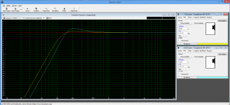

So I've decided to make an addition to them. They don't sound bad but just as I expected from my pre-modeling, they really need more volume. I'm going to add a 24" section of pipe between the "T" and the top cap. After compensating for the overlap I figure this will take my volume from a little over 1 liter to a little over 5 liters.

If you do this and keep both ends closed, you might have some 1/2-wave resonance going on. Opening the far end will result in 1/4-wave resonance. Either way, the behavior will deviate from a more boxy sealed enclosure. You can use MJK's workseets or Hornresp to get a better idea what this will result in. Hornresp is free and can now model stuffing, which might be something that could be useful here.
What was the simulated Qtc for your current sealed volume?

So I've attached an image showing the modeling within WinISD. Current setup is the blue line (1.25 L enclosure with a Qtc of 1.115. My planned arrangement is the yellow line (5.25 L enclosure with a Qtc of 0.881. I do plan to fill the extension tubes with polyfill.
Speaker building is fairly new to me (these were my first speakers) and I suck at wood working so my options are limited. I also don't have any way to really monitor the speakers after I build them so I'm just going by "ear".

Yep, sure does look like it might want a bit more volume. When using stuffing inside a sealed enclosure, you can raise the apparent volume by ~25% over the physical Vb, until the point where adding more stuffing starts to actually reduce the volume. Your planned 5.25L might look like ~6.5L if you add a fair stuffing density all over. If this is then larger than you want, adding enough pipe to raise Vb to 4.2L and stuffing would result in ~5.25L apparent volume. I would not advise going to too low a Qtc with a small driver with a high f3, as it will risk sounding anemic, unless you use a helper or sub-woofer. That new Qtc of ~0.88 looks decent to me, high enough to keep some liveliness to the mid/upper bass and the extra power below ~160Hz will definitely make a difference.
Everyone sucks at woodworking when they've never done it or only begun, don't let it discourage you. Conversely, don't let that stop you from exploring alternative enclosures such as the pipes here. :) Once you've settled on a volume and stuffing density you like, make sure to use ABS glue on the pipe caps to give it a good seal.
