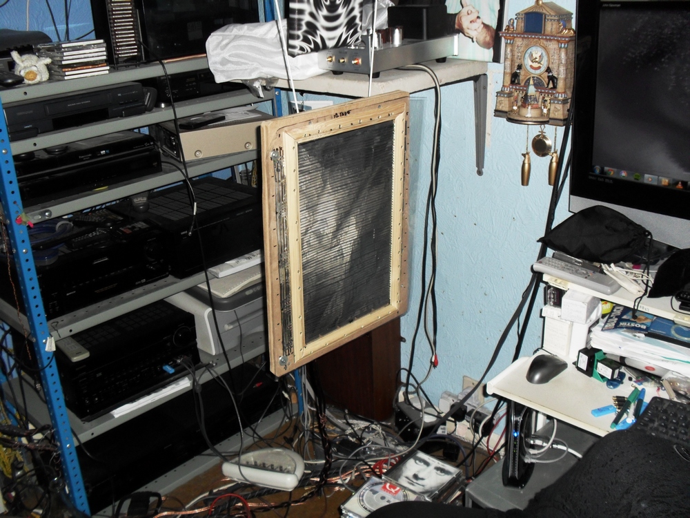

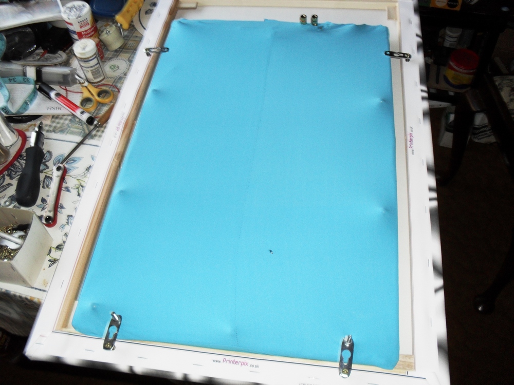

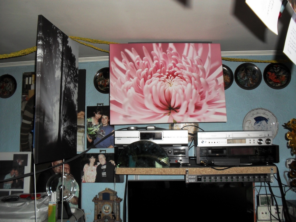

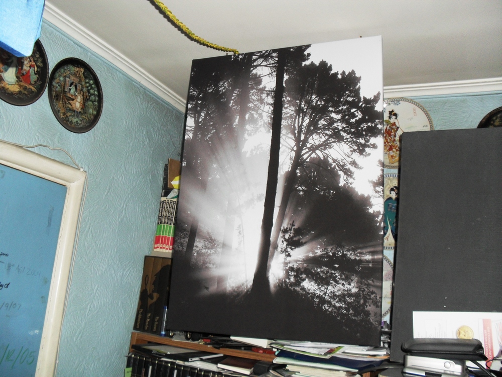

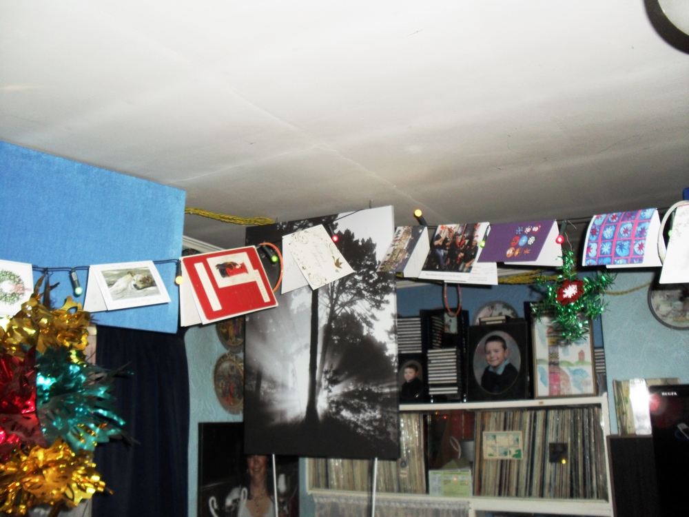

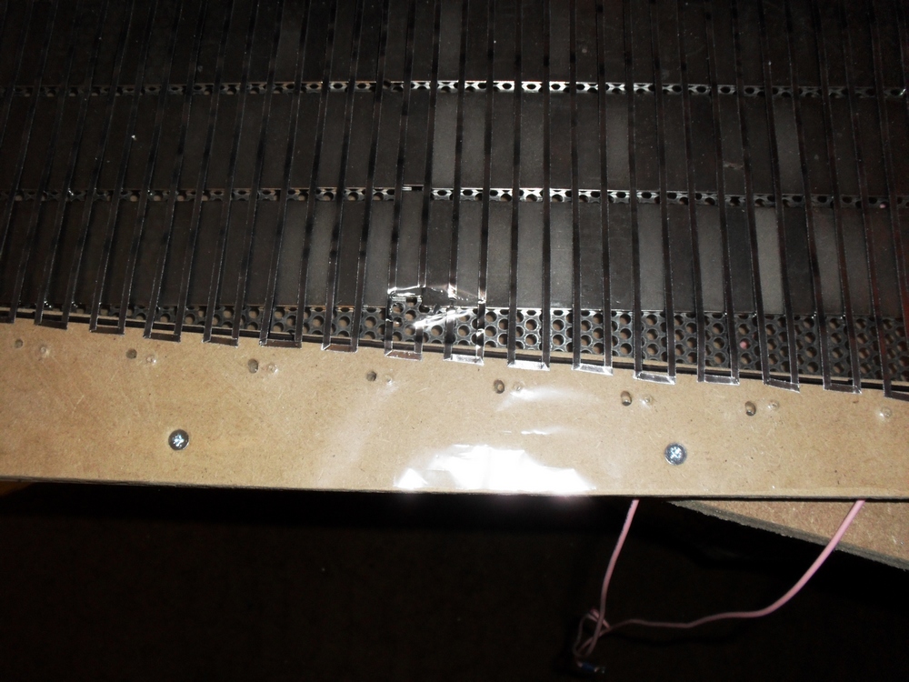

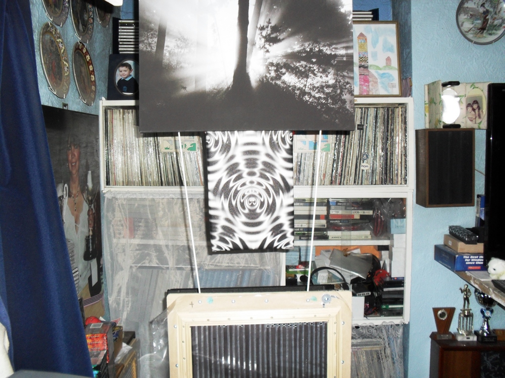

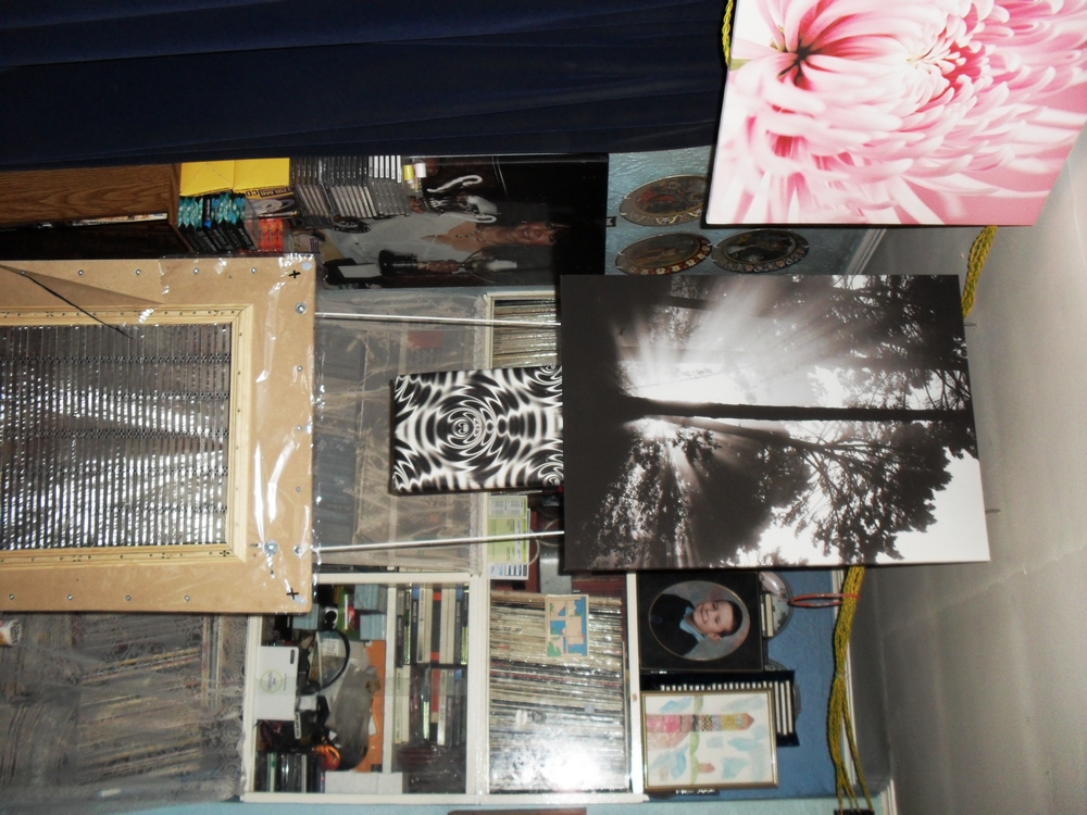

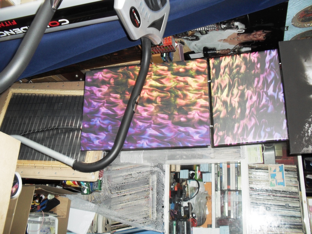

I have to rebuild all my neo speakers as well, now I am using 3 mm wide tape, more pain for the old back. I know neos are stronger than ferrites, I have the blood blisters to prove it!! After building over 60 full range planars of all sizes and layouts I think I know what I am doing by now. The secret to sensitivity is using all the magnet area you can. Which I aim to do with all my re-re-builds. I am confident I will increase sensitivity quite significantly with the same number of magnets. I did build one with gaps between the magnets, but gave up the idea, as the magnets were unstable even with super glue, and there wasn't any improvement in sensitivity, worth the extra work involved. As I said the 60 x 40 using ferrites is 8 Db more sensitive than the large 4' x 2' one using neos, which I already know are much stronger. The important difference is in the foil layout. The opposite is true when you just use the normal layout of putting the foil over the intersection of the N & S. If this makes me unqualified so be it!!

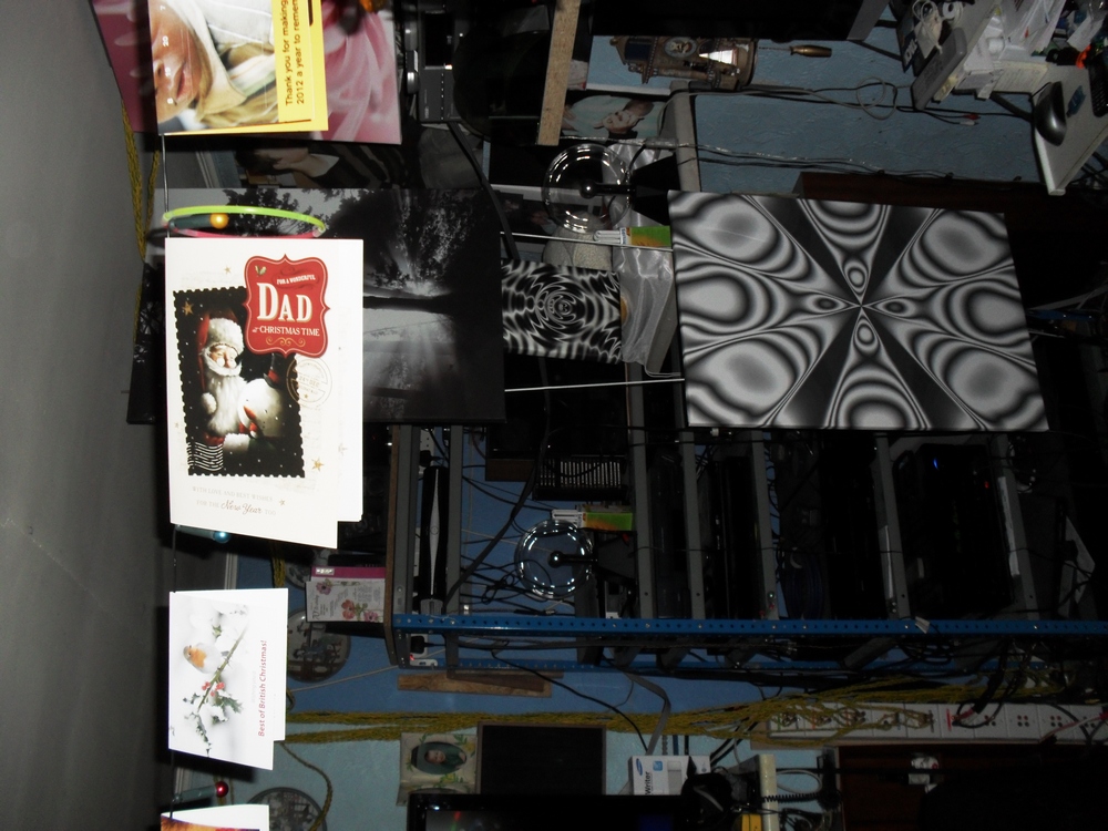

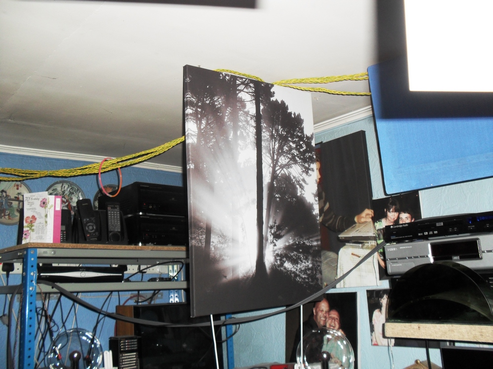

some more reduced pictures
some more pictures with new covers, canvases quite cheap.

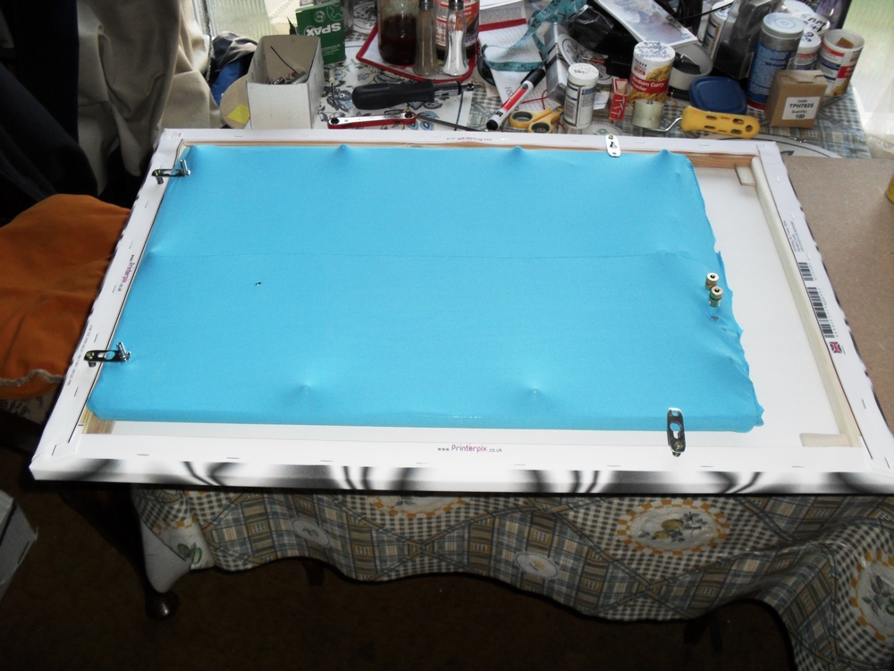

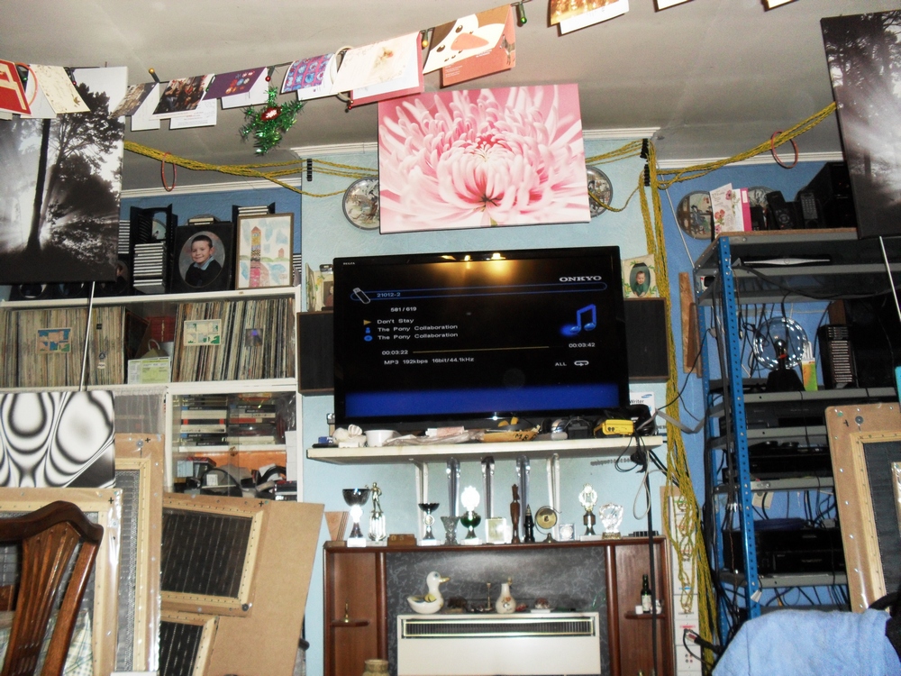

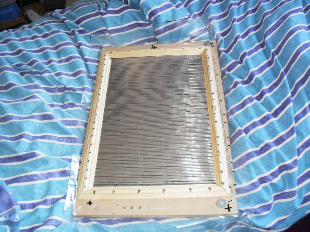

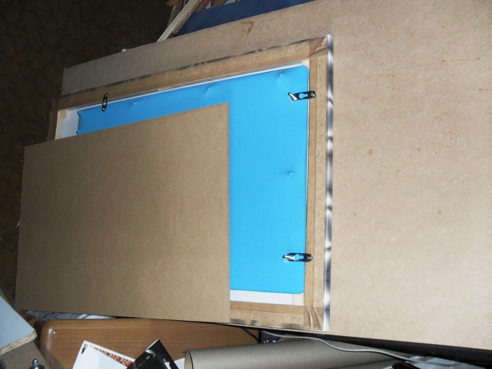

some more of the same
ditto,the blue material acts as a dust cover.!!

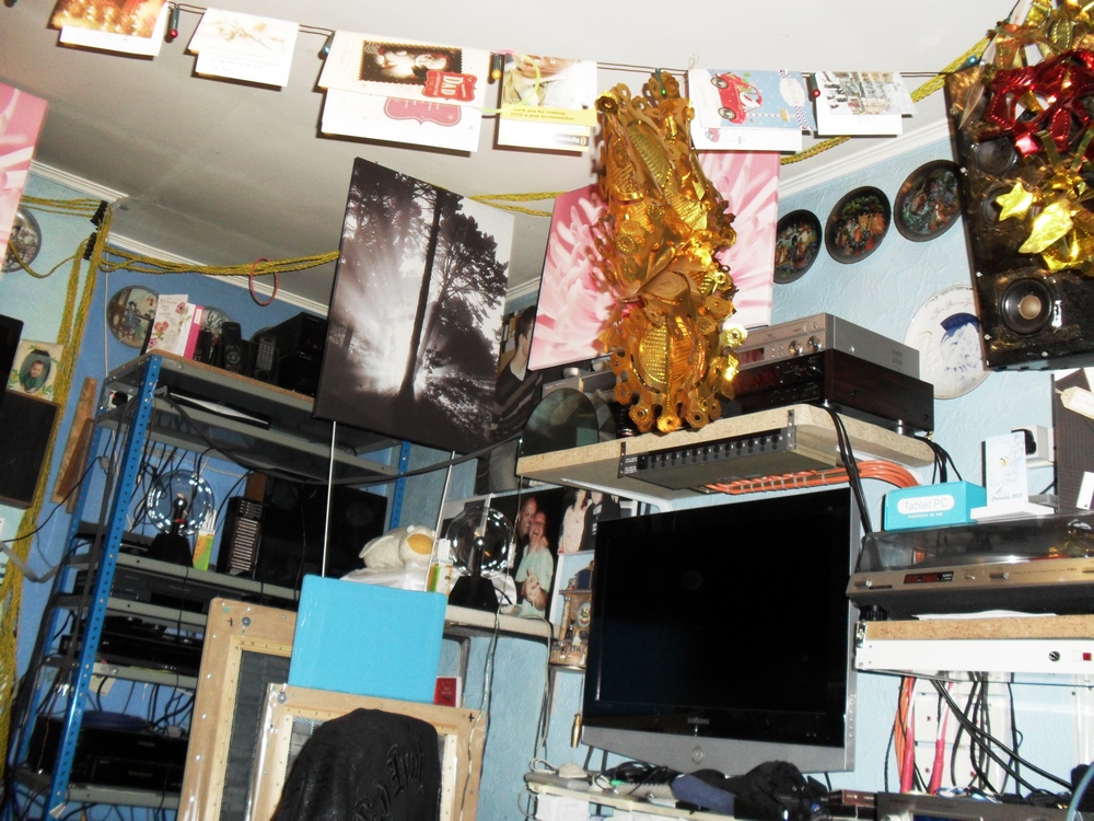

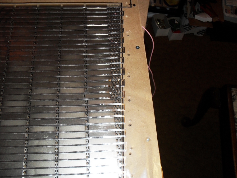

some more.

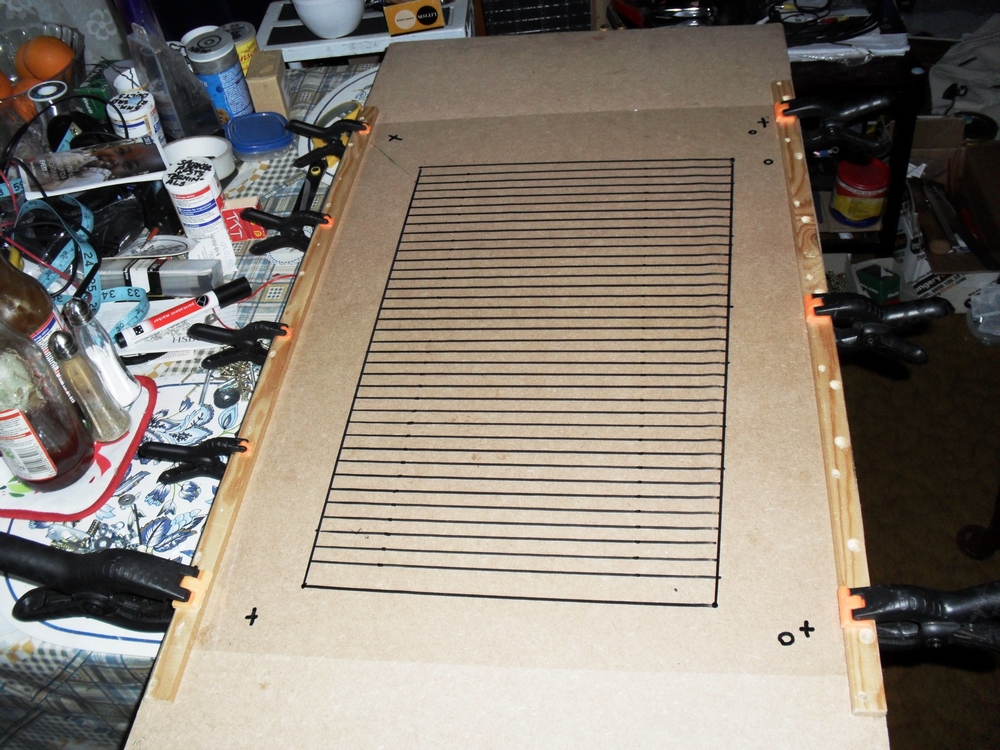

Still learning as I go along, very frustrating at times, especially when the same rebuild, does not have the same effect with a different speaker. magnets ,sizes, neos, ferrites you have to learn for each one by building it. Very time consuming, and can be very frustrating!!!£*)^%$😱😕🙁

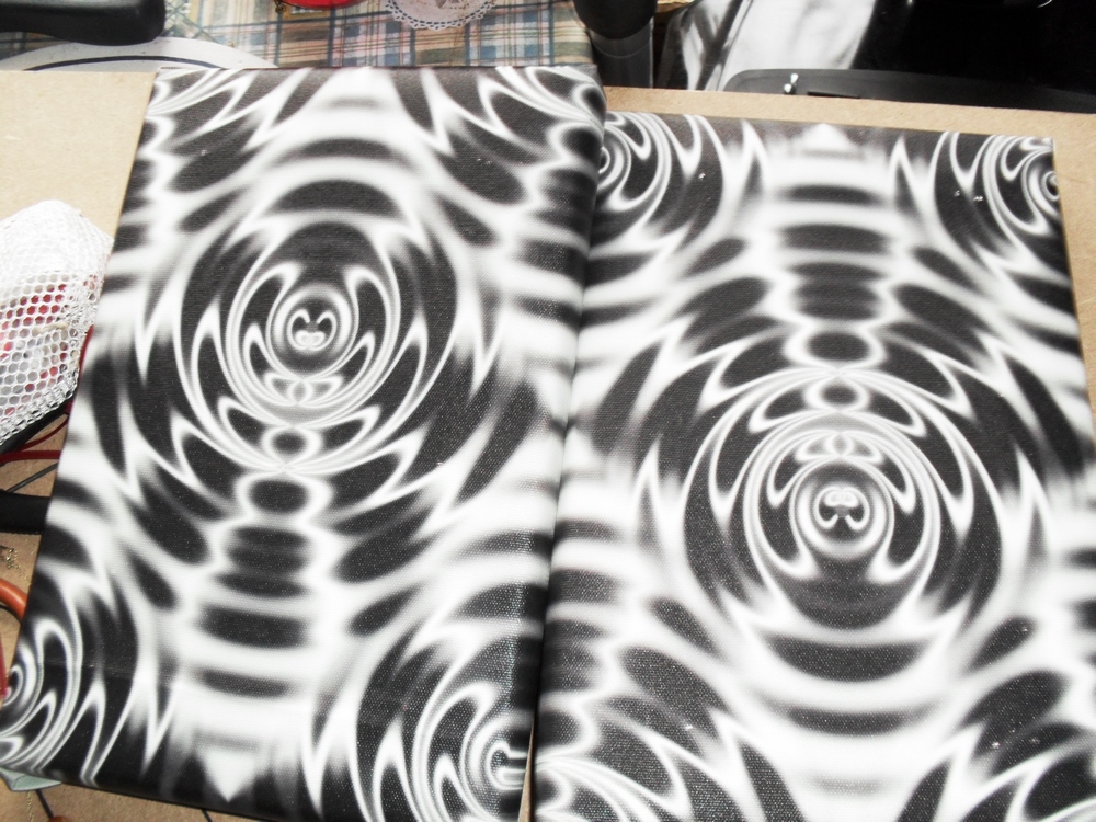

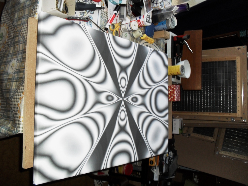

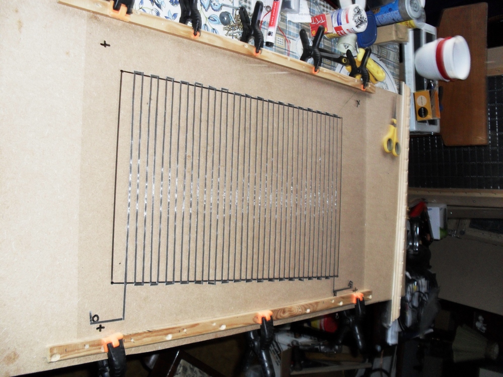

some more.
some more not finished yet a few more learned truths about full range planars to come next. As I have said I am still learning more as I go along.😱

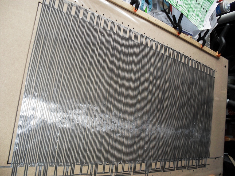

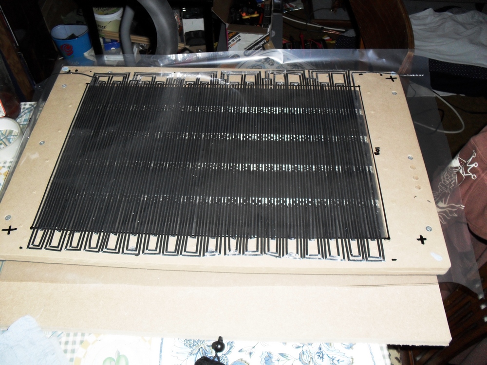

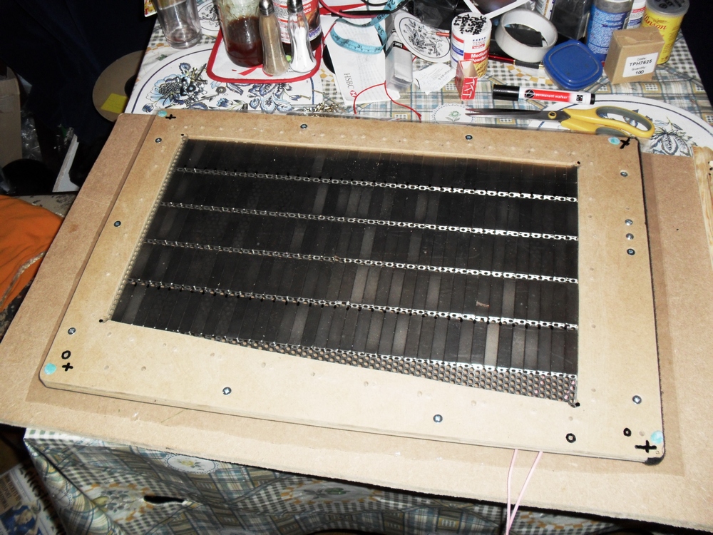

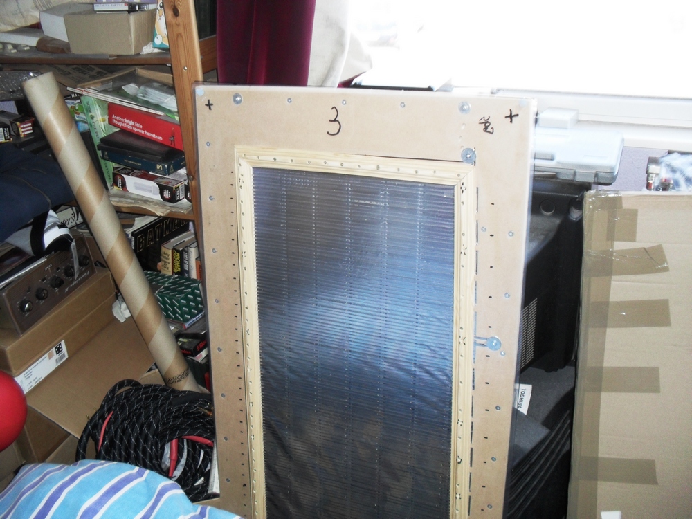

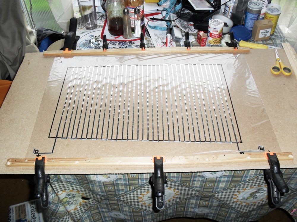

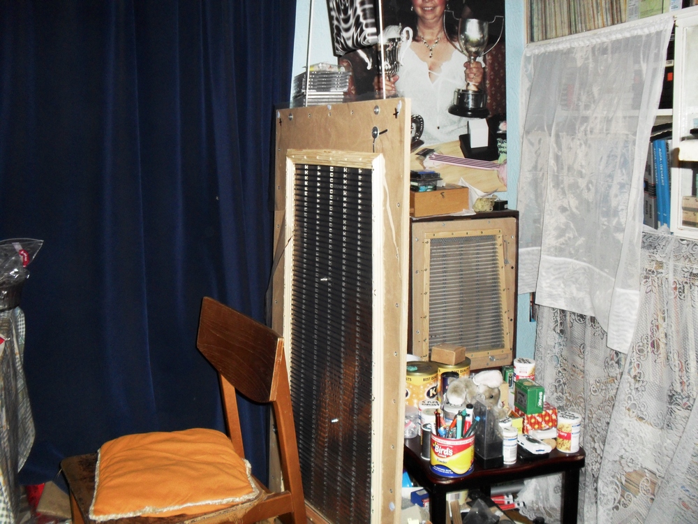

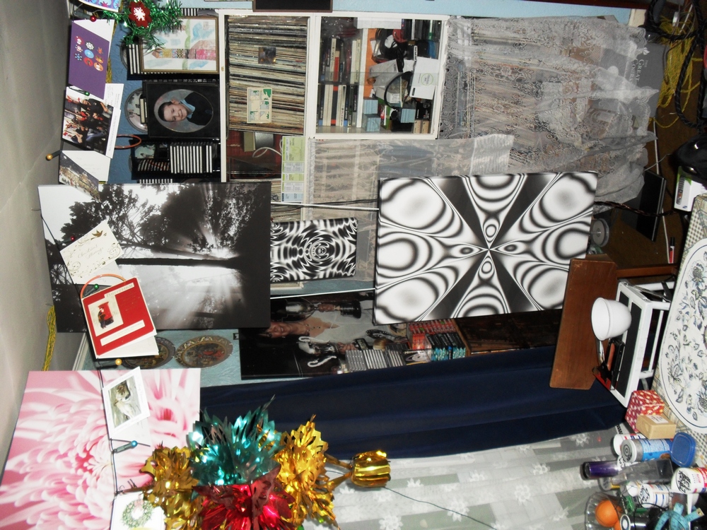

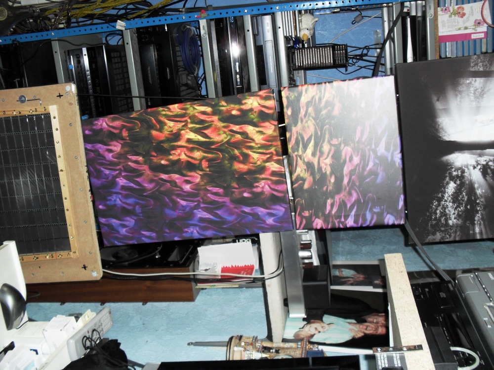

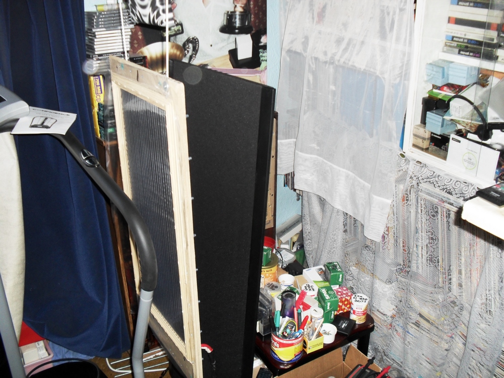

some updates.

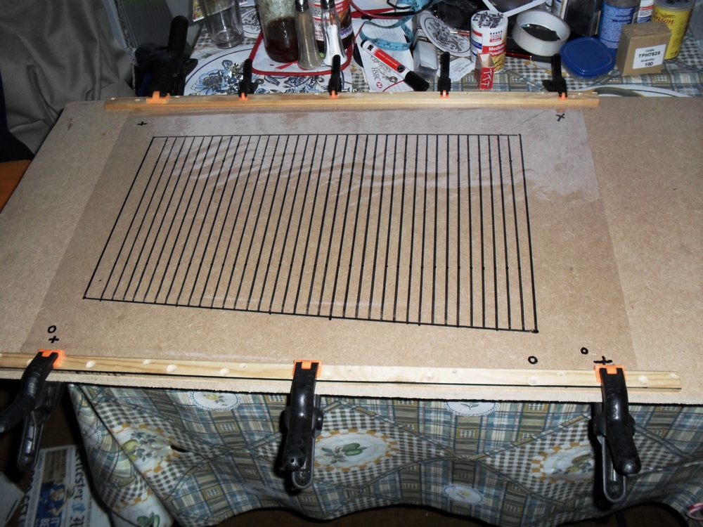

no. 1 & 2 are the same layout, using normal foil positioning. No. 2 uses a different type of plastic magnet same thickness and width. I had to cut the No. 2 plastic , by hand. It is 6 db more sensitive than No. 1
No. 3 is an improvement using the epsilon layout with an extra foil on the magnets, which are 3 mm thick neos. This was made possible by using the 3 mm tape instead of the 4.5 mm tape, I used previously. No. 4 is a 60 x 40 mm design using 6 mm thick neos, 12.7 mm wide. The original design was the normal layout, but with the new 3 mm tape, I reverted back to the epsilon layout, using the extra foil, which is a good improvement on the sensitivity. As I have said before the only way to improve things is to build the new layouts, it's the only way. All the new ones have to be built to compare with the old ones. It doesn't always work, but that is called progress. All the theorizing in the world cannot beat the actuality of building the dammed thing.

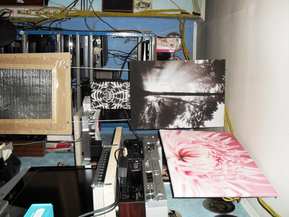

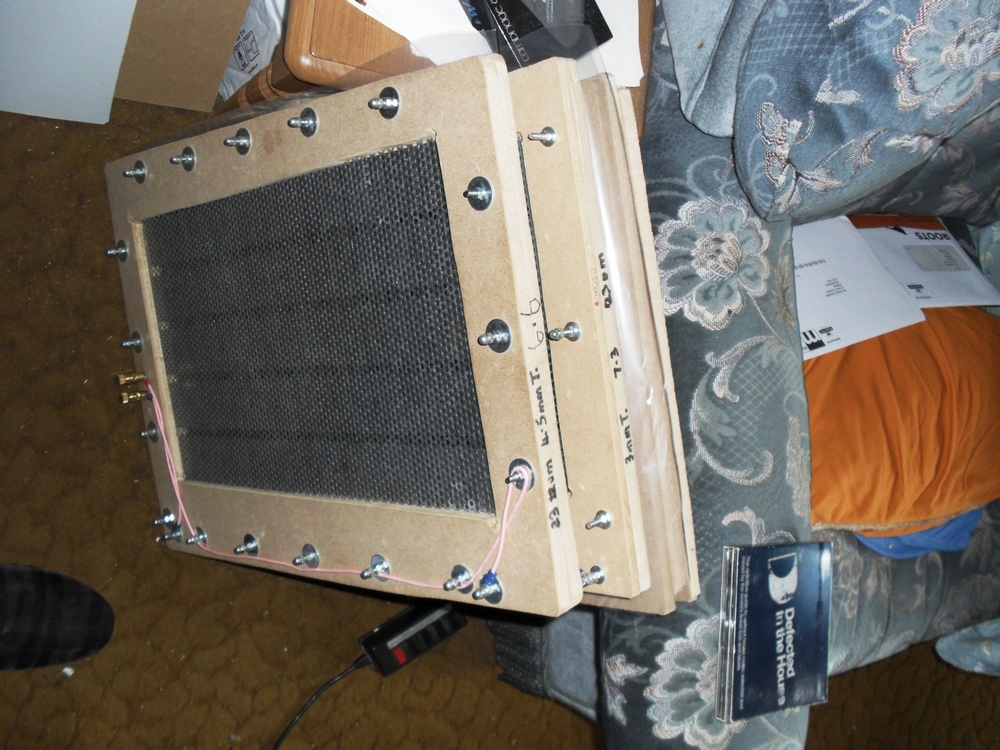

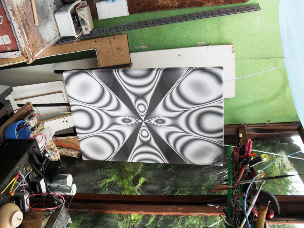

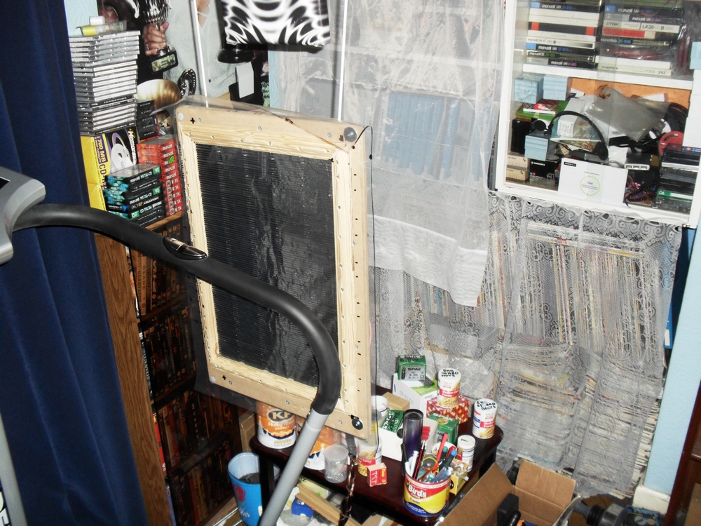

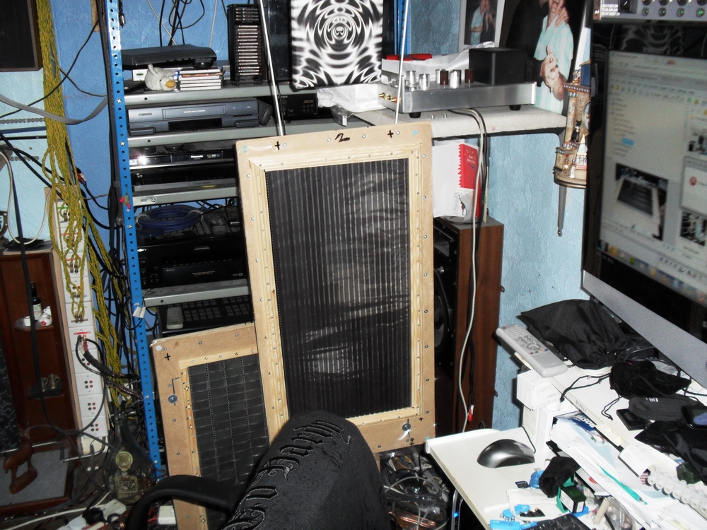

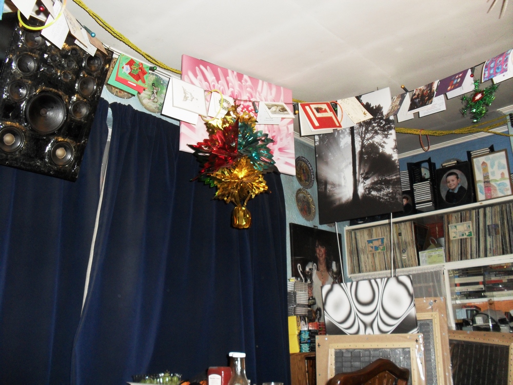

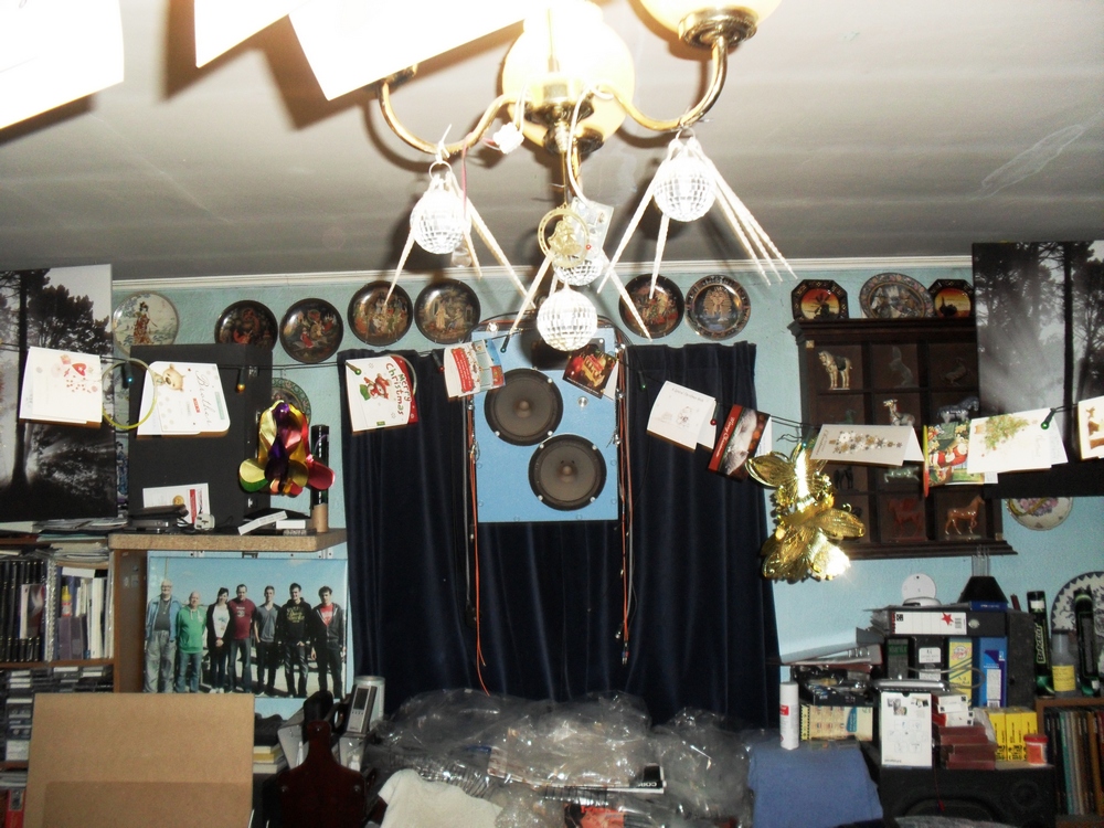

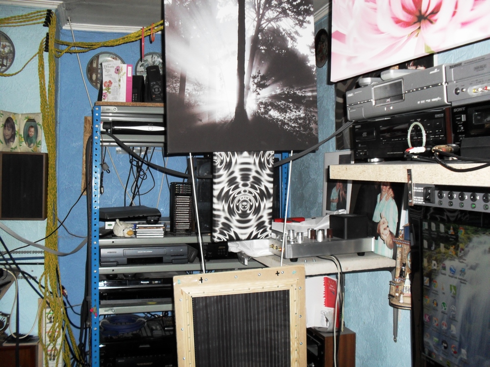

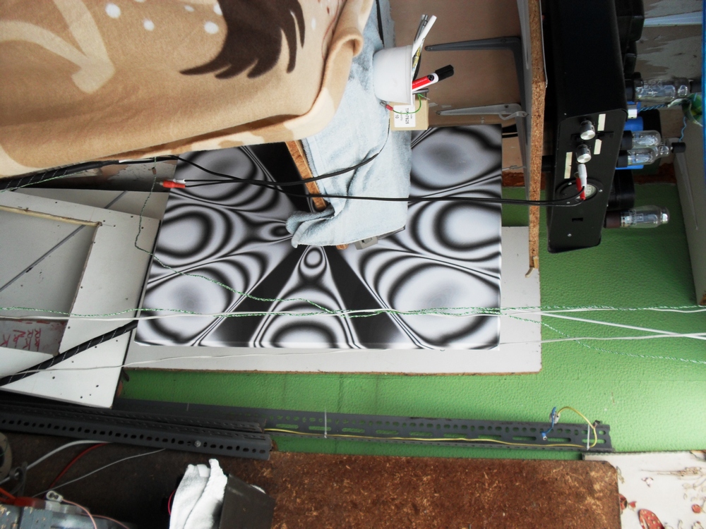

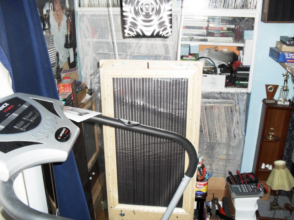

SOME MORE OF MY WORK, FINDING WHICH IS THE BEST DESIGN FOR DIFFERENTLAYOUTS AND SIZES
no. 1 Epsilon layout.
no. 2 Large one uses 6 mm ferrites 40 x 18 mm.
no. 3 Small one uses 50 x 12.7 x 3 mm neos.
no. 4 Blue one uses 50 x 12.7 x 3 mm neos.
no. 5 Uses 50 x 18 x 10 mm ferrites.
no. 6 Uses 25 x 6 x 2 mm neos. A4 size.

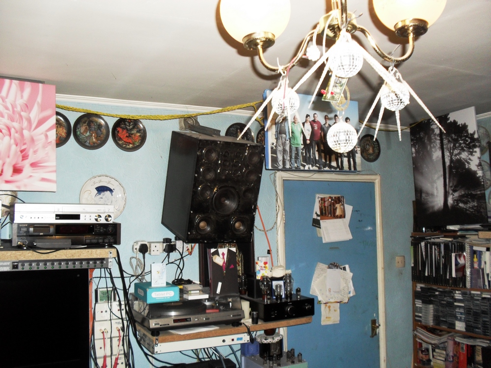

no. 7 & 8 Use 50 x 12.7 x 6 mm neos. These are being driven by SE Valve amp using EL 38 output tubes with 6J5GT input tubes and CV378 rectifier in my sun room. Plenty of sensitivity with the design using the epsilon layout with no gaps between the magnets.
