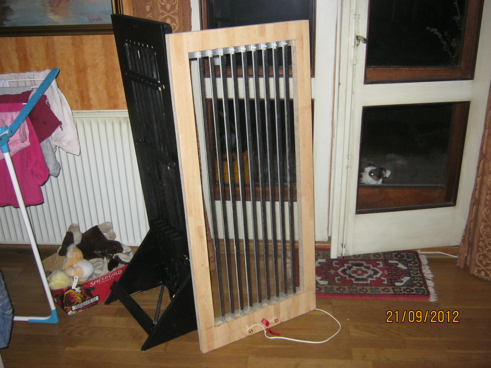

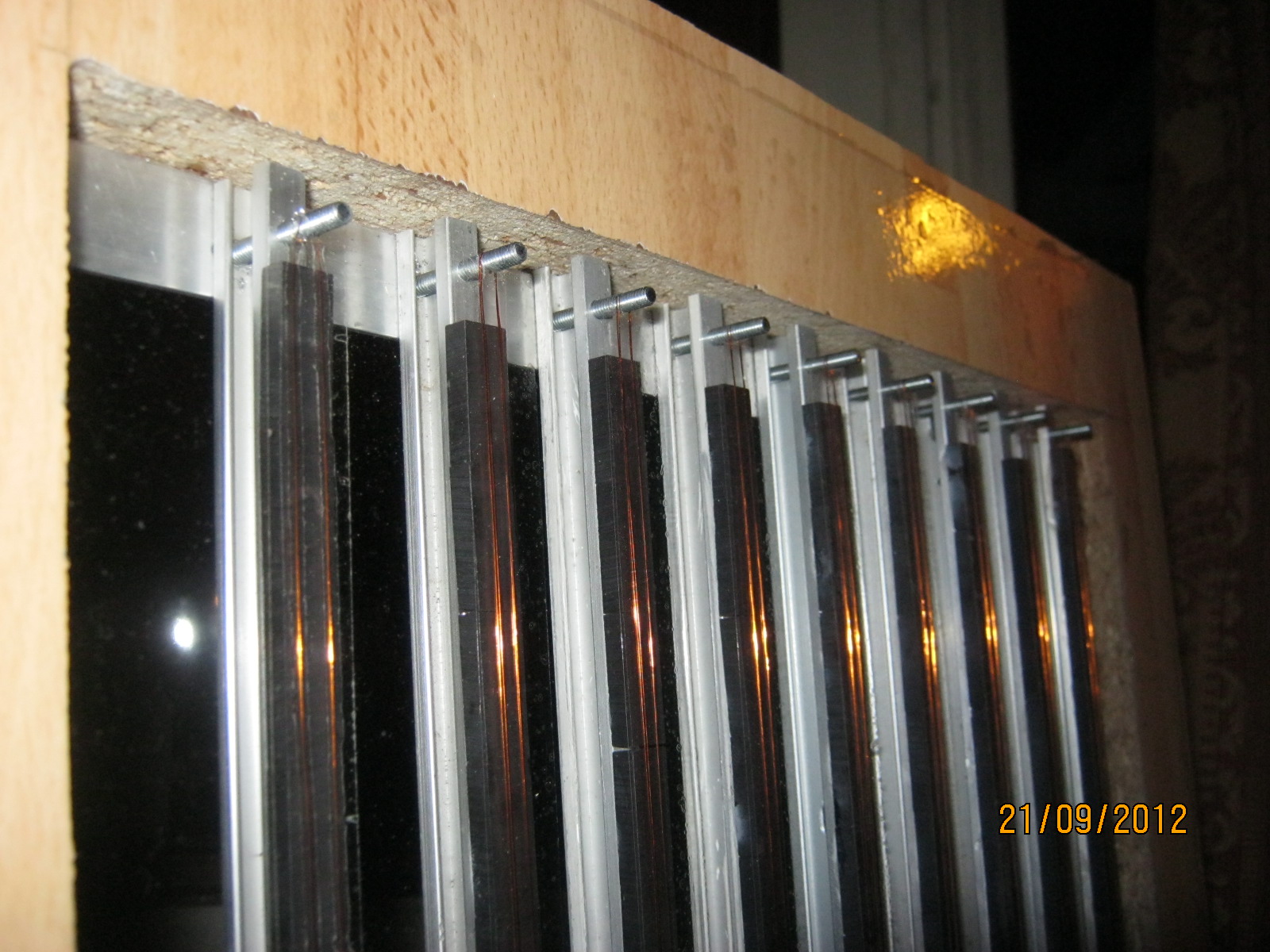

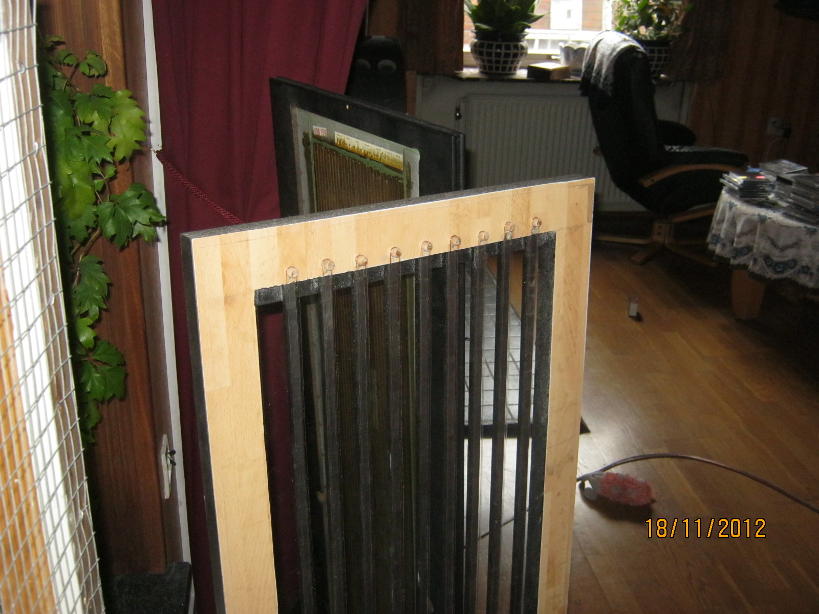

Good point. Several people have suggested that a gap should be left between the columns of magnets. I think they had other reasons, ie either to leave area for air to move or because it would enable the use of fewer magnets.
But it seems reasonable to believe that if the N and S were touching, the field would almost act like there was a short, there, and not as much would extend out to the mylar.
The configuration people are discussing isn't with the N and S poles touching, though. Instead it is with the N pole of one magnet pointing up and the S pole of the neighboring magnet pointing up. Even with the magnets touching, field lines will emerge from one pole and return to the neighboring pole (more or less).
Another good reason to separate the magnets (besides room for air to move) is that the change in the magnetic field with distance above the gap can be lower as a function of height above the magnets. Although increasing the gap reduces sensitivity, it also may reduce distortion.
Jeremy
Jeremy,
Thanks for getting involved and commenting. (But read the thread, please.)
The configuration being discussed was with the N and S touching at their edges. So yes, they were touching. Everyone here already realizes that the N and S are both facing the same way, and are the large flat faces of the magnets, which are all parallel to the mylar. And they realize that even if the edges are touching, there will still be field lines that emerge, to some relatively small and much less useful extent. But it is unhelpful to just state that field lines will still emerge, without any regard for the goals that are implicit in the thread, i.e. without noting that it would likely be a much less desirable configuration.
Since you seem to possibly be knowledgable about magnetics, we would welcome any help in learning to better-characterize the effects of the magnets' spacing and the effects of the height of the conductors above the magnets, with respect to the force vector exerted on the mylar when there is current in a conductor that is attached to the mylar.
Presumably there would be combinations that produce maximum force, and combinations that produce the best-behaved (most-orthogonal) forces, etc, etc. For example, I think that we would usually want the field lines to be parallel to the mylar, at the mylar. (But, of course, the mylar changes its distance from the magnets, as varying current amplitudes are passed through the conductors that are attached to it. So we would be looking for the "best" range of distances, and the best at-rest distance given the other variables.)
And it seems likely that the field strength, at some distance in front of the magnets' front plane (e.g. at the mylar), would increase as the columns of magnets start to separate, then reach a maximum, then start to decrease as they get even farther apart. At the same time, I'm guessing that the distance from the magnets' plane to the most-useful region where the strongest part of the field is most-parallel to the magnets' plane would also change, but maybe not in the same way or at the same rate.
It might be useful to be able to calculate (or simulate, e.g. with FEMM), in order to determine some sort of quasi-optimization, or at least just get a feel for how to guess at a satisfactory configuration, of the combination of 1) the foil width, 2) the foil's distance from the magnets' plane, and 3) the distance between the columns of magnets.
Ideally, maybe, it would be good to be able to characterize or even predict the maximum displacement of the mylar membrane to which the conductors are attached, for a given current amplitude, so that the resulting configuration would not cause the mylar to actually touch the magnets. My Calculus of Variations skills are basically non-existent so it would be a whole lot of work to get to the point where I could construct and then solve the forced-membrane equations. BUT, maybe we could come up with some very simple guideline, such as "tension the membrane while it's horizontal, until placing X grams in the center makes it sag by Y mm", if we could calculate or simulate to get the force on each conductor given the other variables.
In the end, we would also want the most-accurate reproduction of sound that we could possibly get for a reasonable cost, and a reasonably-large maximum sound pressure level from a typical rated maximum amplifier output power.

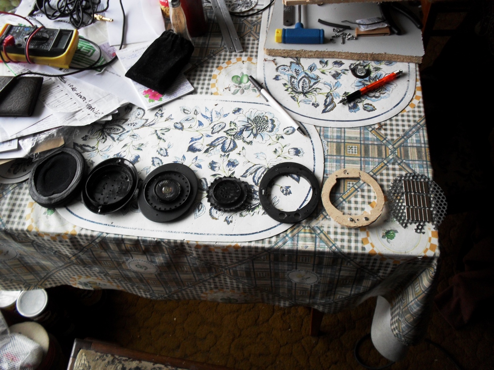

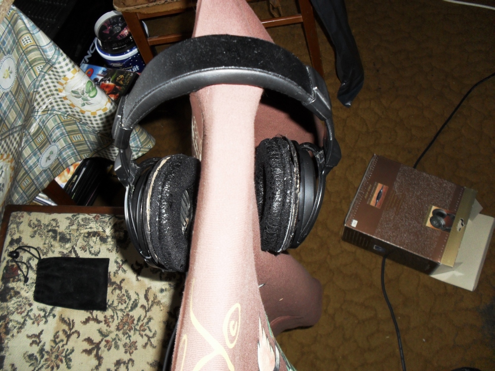

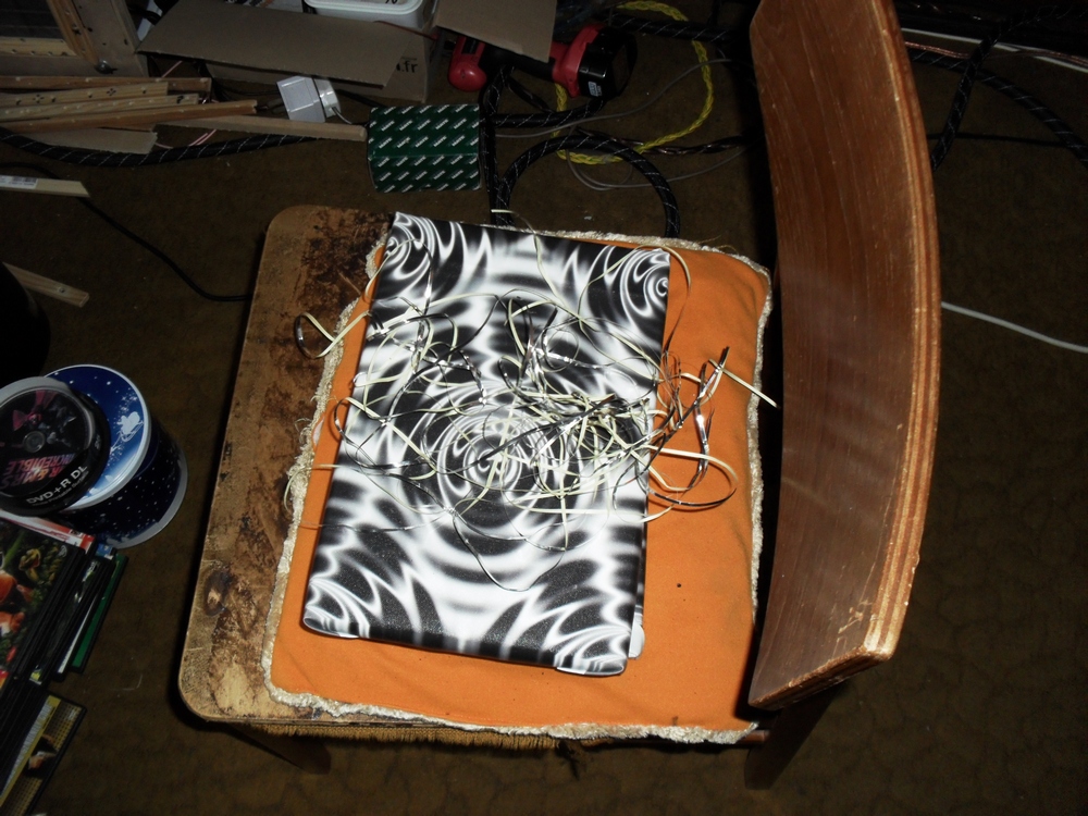

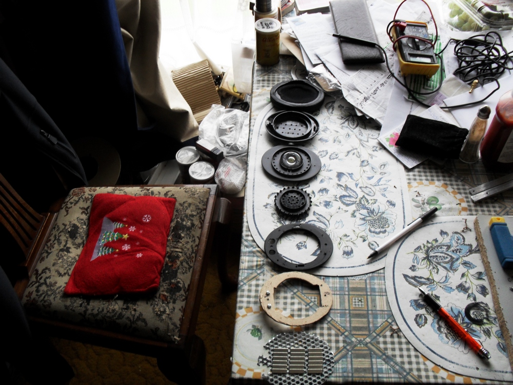

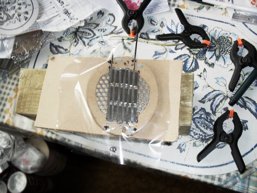

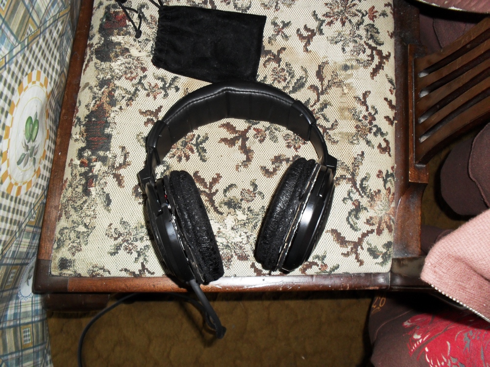

Finished building my experimental full range planar headphone, very pleased with the outcome, used a cheap headphone as the frame. A bit fiddly on one half the left which contains resistor and 4 wires, the right one only contains 2 wires. 2 different neo layouts were used and 2 different sized neo magnets. One side is a little louder I think! My ears are not as good anymore, can only hear up to 8k. This makes it difficult to tell by listening alone, one of the drawbacks of old age. I made it about 29 ohms although the Koss Pro/4XTC measures 105 ohms. I thought about reducing the impedance to about 6 ohms ,any thoughts on the matter from you technos?
Since a lot of people are using a speaker amp with their orthodynamic headphones I guess that 6 ohms should be fine especially if the sensitivity is a bit low.
thank you, have started another rebuild of a cheap headphone, which sounds terrible in comparison to my first rebuild. Can't take my planar headphone off, so good, it's like listening to speakers not like headphones at all!! Very happy with them.Have taken the next headphone apart. Supposed to be the same model, but is entirely a different setup and shape, oval in fact. A new challenge for me.

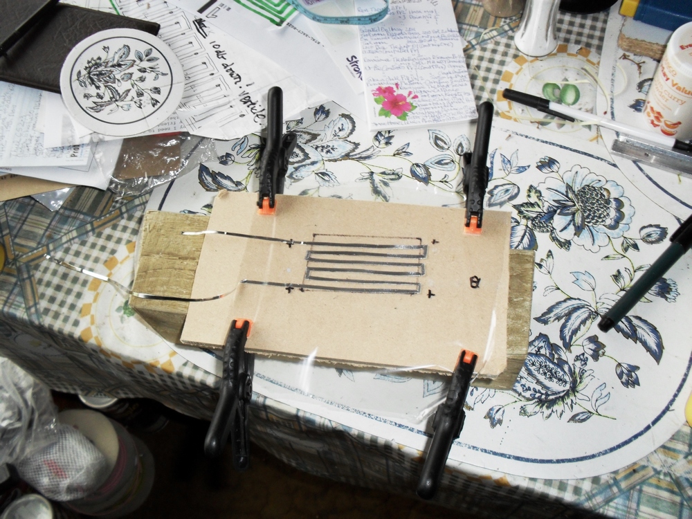

PLANAR HEADPHONES.
Finished at last, a bit fiddly made a few goofs on the way, but very much worth the effort very happy with result. Don't sound like headphones, more like speakers inside your brain. Wore them for hours and hours never wore headphones for such a period of time, unbelievable really. The next 3 pics are of my new headphone rebuild, using a cheap chassis so to say!!😀

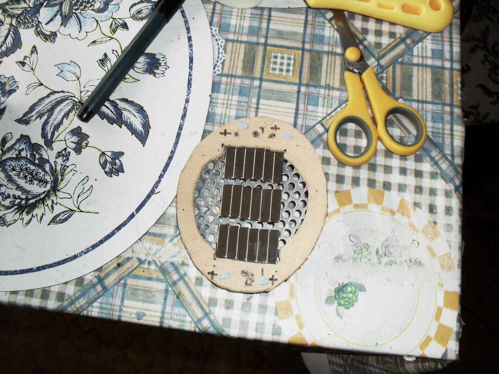

This is a more oval shape than my first one, and a different design and fit. I hope I don't make too many goofs this time, altho' I have made one already and broke 2 of my magnets already, clumsy aren't I
this time!!!

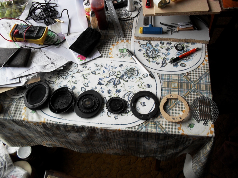

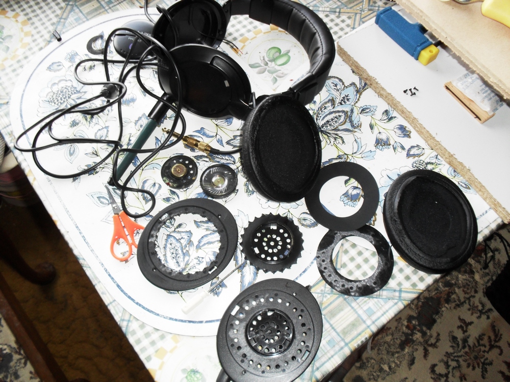

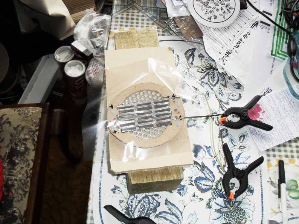

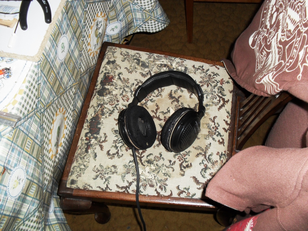

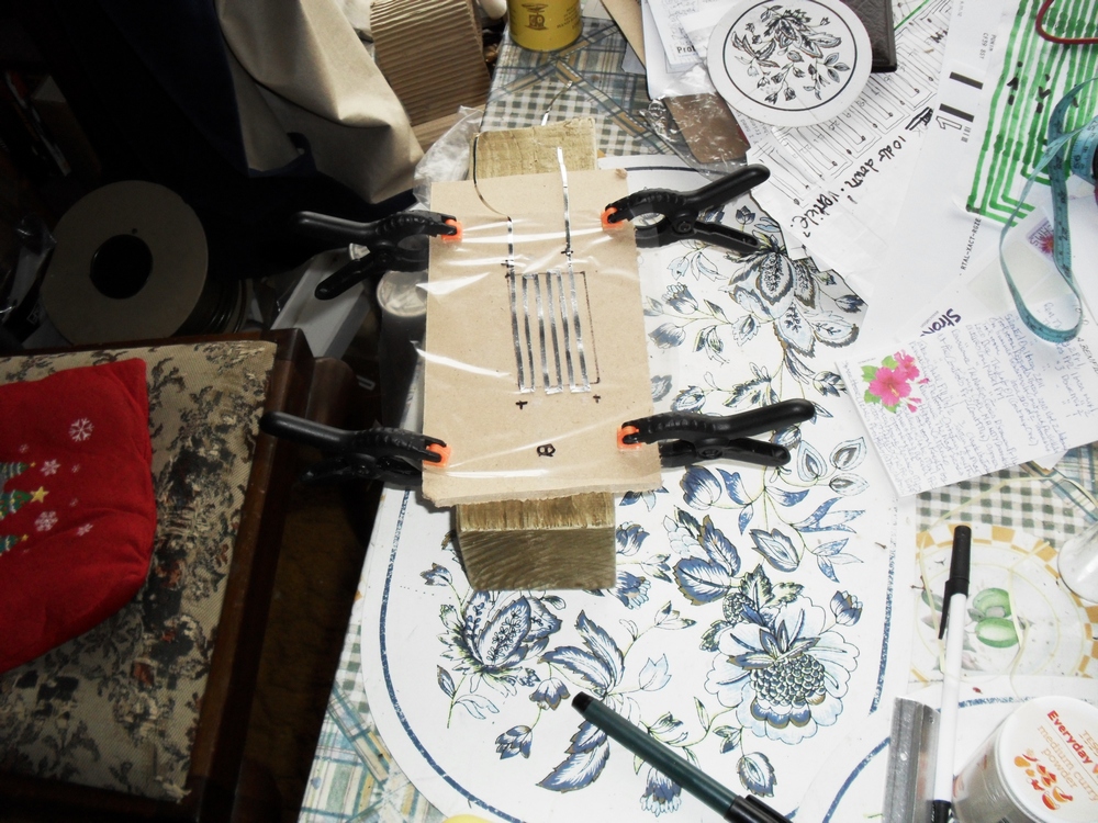

ANOTHER REBUILD OF A BOUGHT HEADPHONE USING NEOS.
PICS showing work in progress,the headphones in pic 8 are my previous rebuild, which sound marvelous, well worth the effort! Just a few things to change used 2 different layouts to see which was the best, the one on the left is slightly louder. So must redo the one on the right will see how my second rebuild goes, vis a vis the impedance before I change the first ones impedance, if I do!

do you mean my headphone rebuilds? If so they sound brilliant, have worn both pairs for hours on end, have never before worn headphones so long. Usually they grate on your ears after awhile but these full range planar designs are so easy to listen to. They don't sound in the ear as so many do. Like listening to speakers inside your head! You don't realize you have headphones on. Very strange feeling or should I say hearing! These spoil you for any other method of listening period. Certainly glad I finished both pairs. Even if the second rebuild was harder than the first. Different shape and layout, I used two different shells, of cheap headphones I bought from Amazon, so I didn't have to build the shell as well. Which would have been beyond my woodworking skills!!😀
