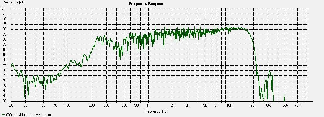

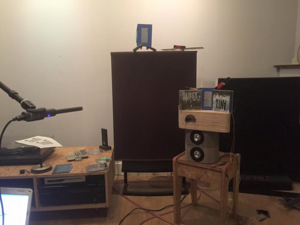

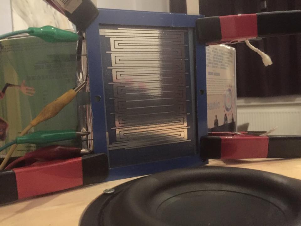

it measures actually pretty well 🙂 it ahs been a while since i've looked at these haha
