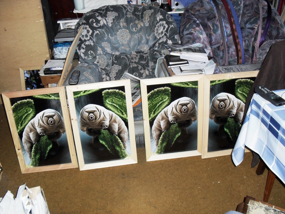

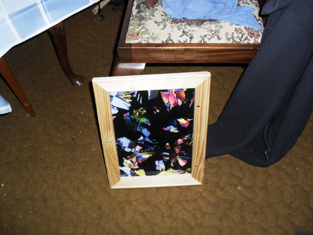

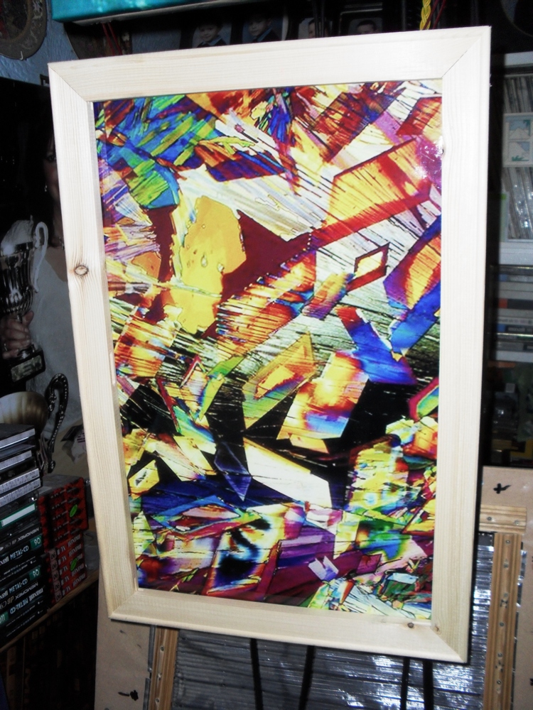

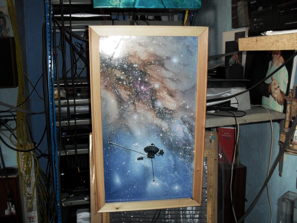

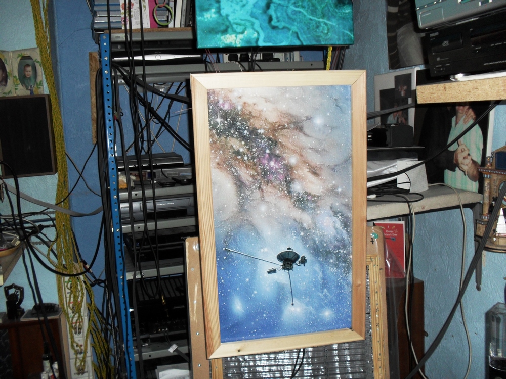

MY LATEST REBUILD
I have changed my design completely don't use mylar any more, these are my latest designs, and the last one is for my next rebuild!
