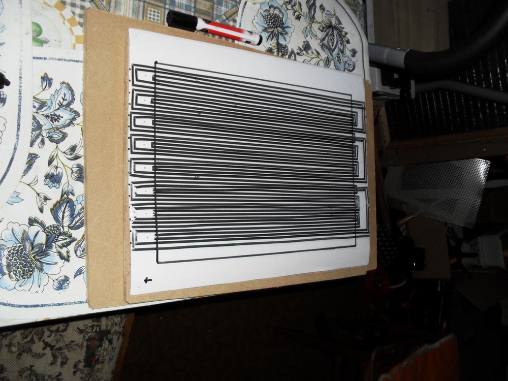

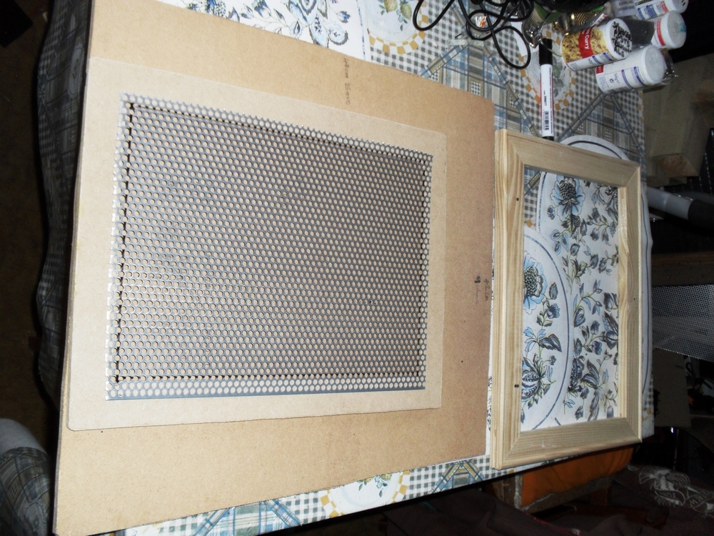

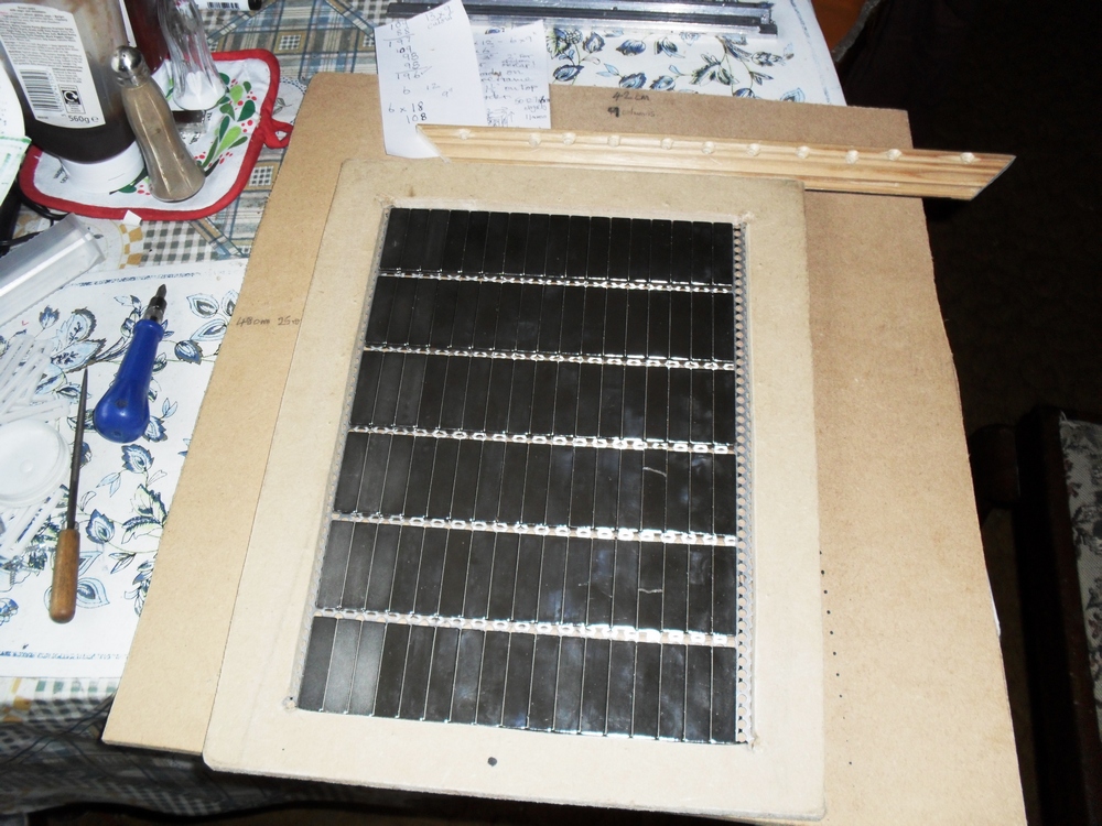

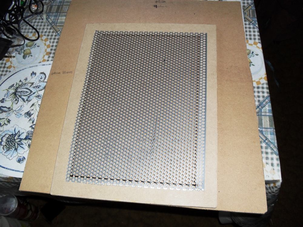

DOING MY NEW DESIGN, TO USE REMAINING 6 MM NEOS
photos of my progress so far, do you like the diaphragm photo? Size 16 x12. The foil will be on the inside, epsilon layout, gives more control, which you need with neos compared to ferrites.

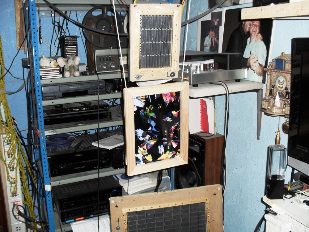

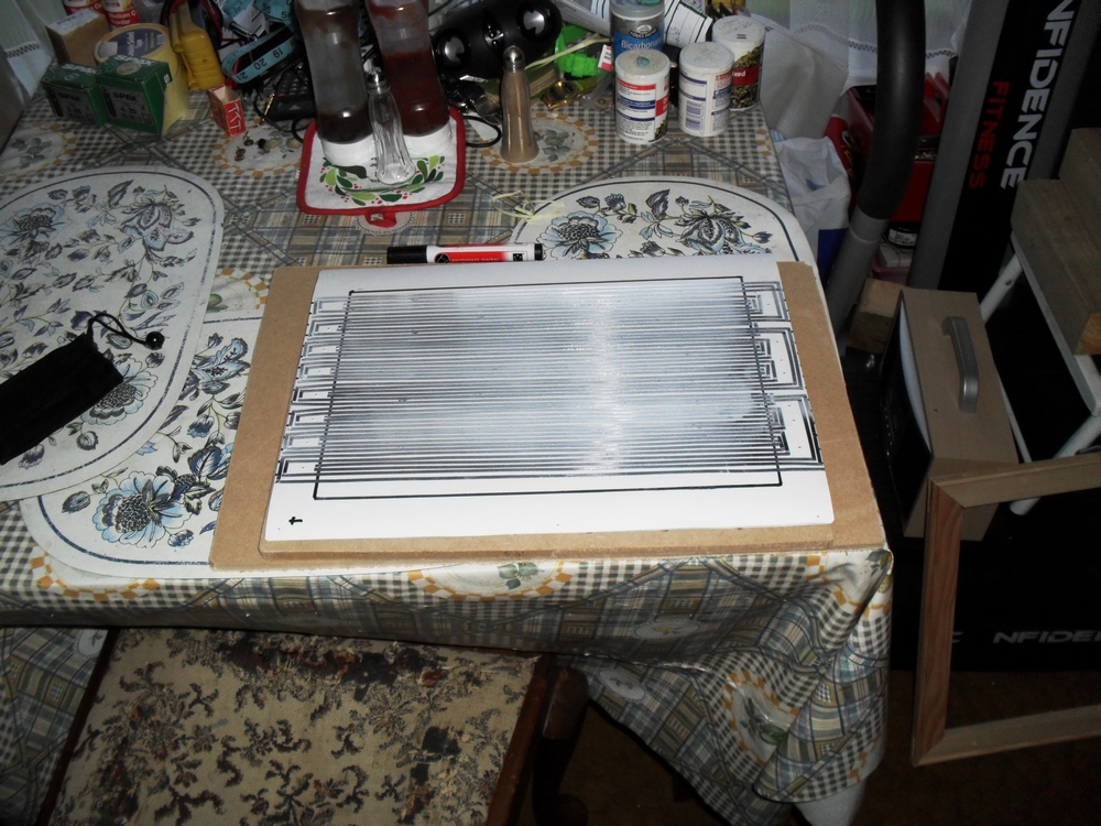

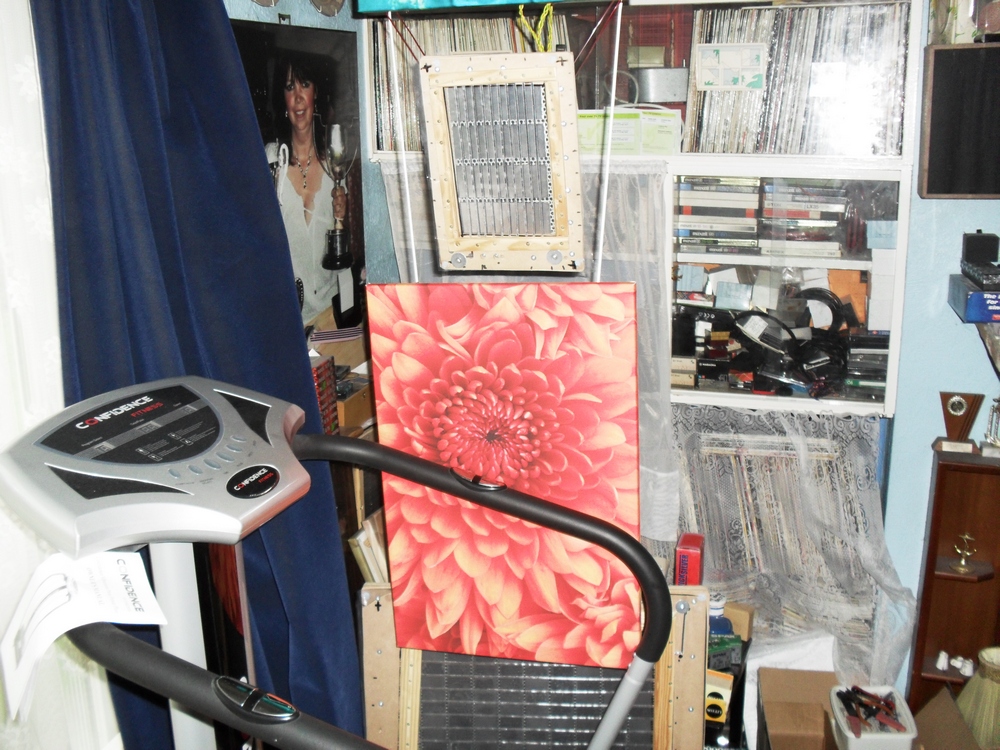

UP AND WORKING MY LATEST DESIGN
This new design is about 4 Db louder than my red one which is twice as big. Although I did use 6 mm neos compared to the red ones which are 3 mm in thickness. The new diaphragm is much more stable as it is thicker. Sounds good, and it looks more like a picture, and cheaper than a canvas, as it is only a photo in a picture frame
Will be trying different layout to try and rectify one problem, will see how it goes! Have bought the silhouette cameo die cutting machine today.

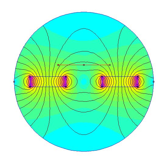

Is neodymium grade N50 vs. N38 noticeably better? So for example I could use 3mm thick instead of 6mm? Anyone made sims?
What mil mylar are you using now? and would you detail the magnetic tape speaker.Thanks for all your work. It have gotten the bug for do it yourself planers.

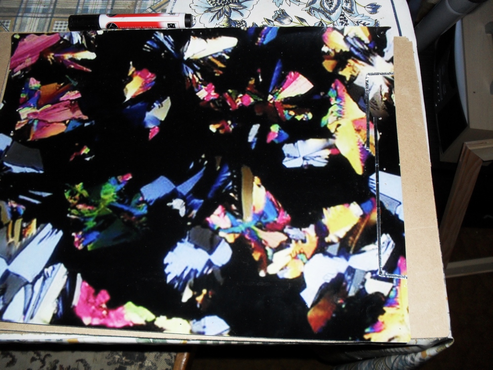

I use 6 mm thick ones for the Epsilon style diaphragm, but use the normal layout with the 3 mm thick ones. I have built a 16" x 12" one using the epsilon layout and 6 mm neos , which was more sensitive than a 24" x 16" one using the normal layout with 3 mm ones. The 6 mm one used a print for the diaphragm material instead of mylar. I used double sided tape to hold it in position' and a picture frame on top.So you could disguise your speakers as photographs.
I have started using the thicker mylar 23 um or even thicker. I find it gives more control and the thinner mylar is quite noisy when crunched. This has an effect on the eventual sound.So won't be using thinner mylar anymore.
Have stopped using Mylar too noisy, Use 90 um poly now with the epsilon type tape layout, much better control and lower resonance and funny noises which you can get with certain songs and recordings. Thin mylar is very noisy in itself.

Another thing that puzzles me is what is considered North and South on a magnet bar.
More specific, does a magnet bar have only 1 south and 1 north or do the sides, the front and the back of a magnet also have an north and south?
In the Magnepan long thin magnets are placed vertical.
The conductor is placed in the space between the magnets.
I will see if I can make a drawing and post it somewhere for now I try do make it clear in text.
|N| || |S| where || = the conductor.
If I understand it well, and please correct me if I am wrong, the magnets do have a N and S on the top and the back of the magnets too. The conductor get it's magnetic field from the music signal following this rule :
