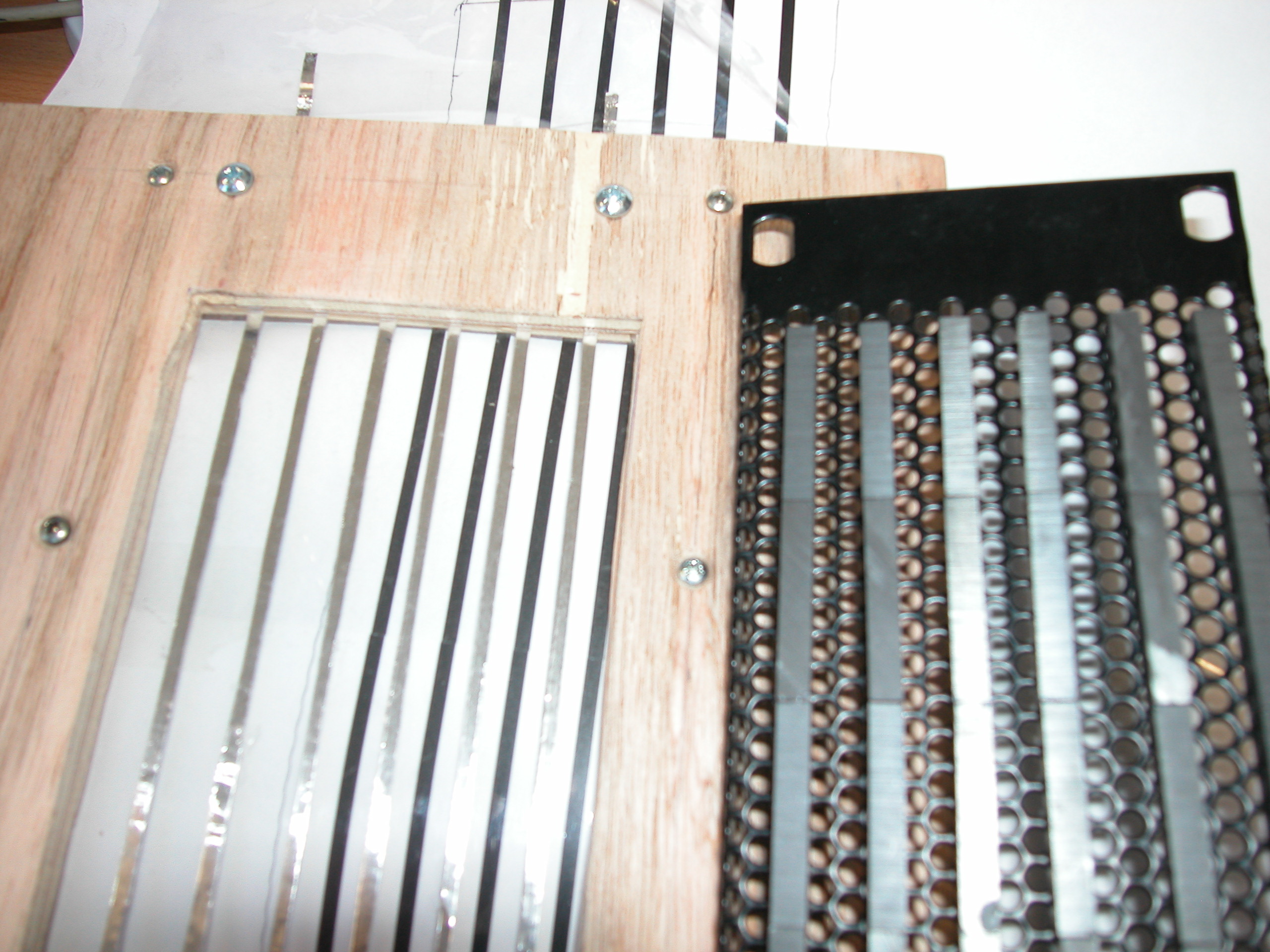

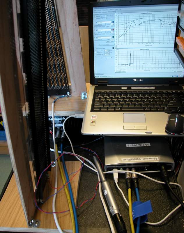

Hi all,
I wanted to have a go too...
I put this together with bits to hand around the office.
It will be a class demo to demonstrate that there are alternatives to ‘cones’.
This is a steel 2U 19” rack ventilation panel. The painted surface reduces the friction so you may need double-sided tape to prevent the magnets slipping together.

On the first attempt I didn't get enough tension on the mylar film before sticking the aluminium tape. It locks in wrinkles.
I started with the plywood sandwich but separated them to use the ply for the second attempt. Double-sided tape holds diaphram tension.
I distributed the magnets between the two by leaving gaps (see photo).
They are fine for demonstrating the operating principals...
Refinements for next time: Stick magnets, brace the 19" panel, try narrower tape, try wider panel.

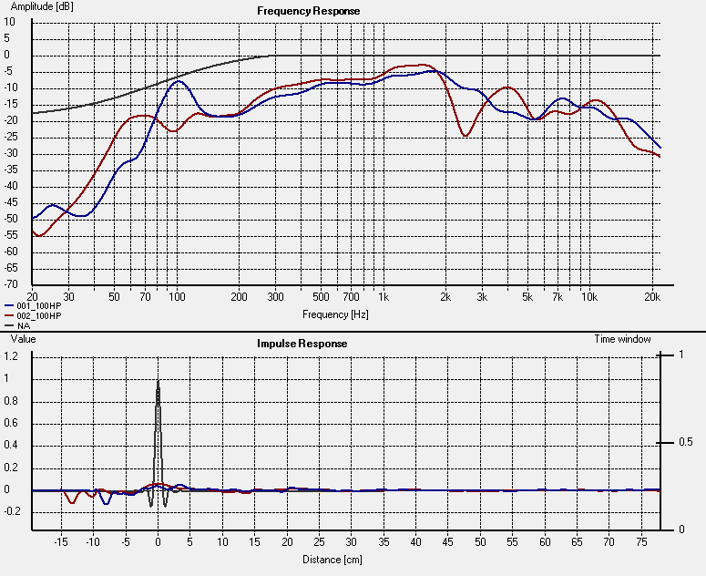

Red trace first attempt, Blue trace second attempt. (100Hz Highpass)
Chris
