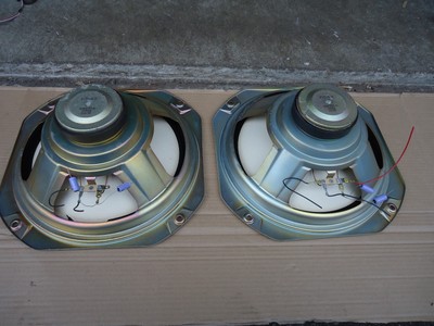

Looks like just a very large one: https://www.fane-international.com/view-product/sovereign-12-250tc#tab-5
GM
Then again, I could be wrong [am], so another whizzer to tweak to tame this 'beast': https://www.bluearan.co.uk/sales/fane/images/SOV12-250TC_a.jpg
GM
the double whizzer Fane 12 really goes high (dead on axis) - their 15 should get to 12K - played with 250 a little bit in Karlson12 and Karlsonator12. I had bonded Dacron over the K12's slit vents - clear mids, no low bass, Karlsonator had "bass" - might have been underdamped but didn't measure
