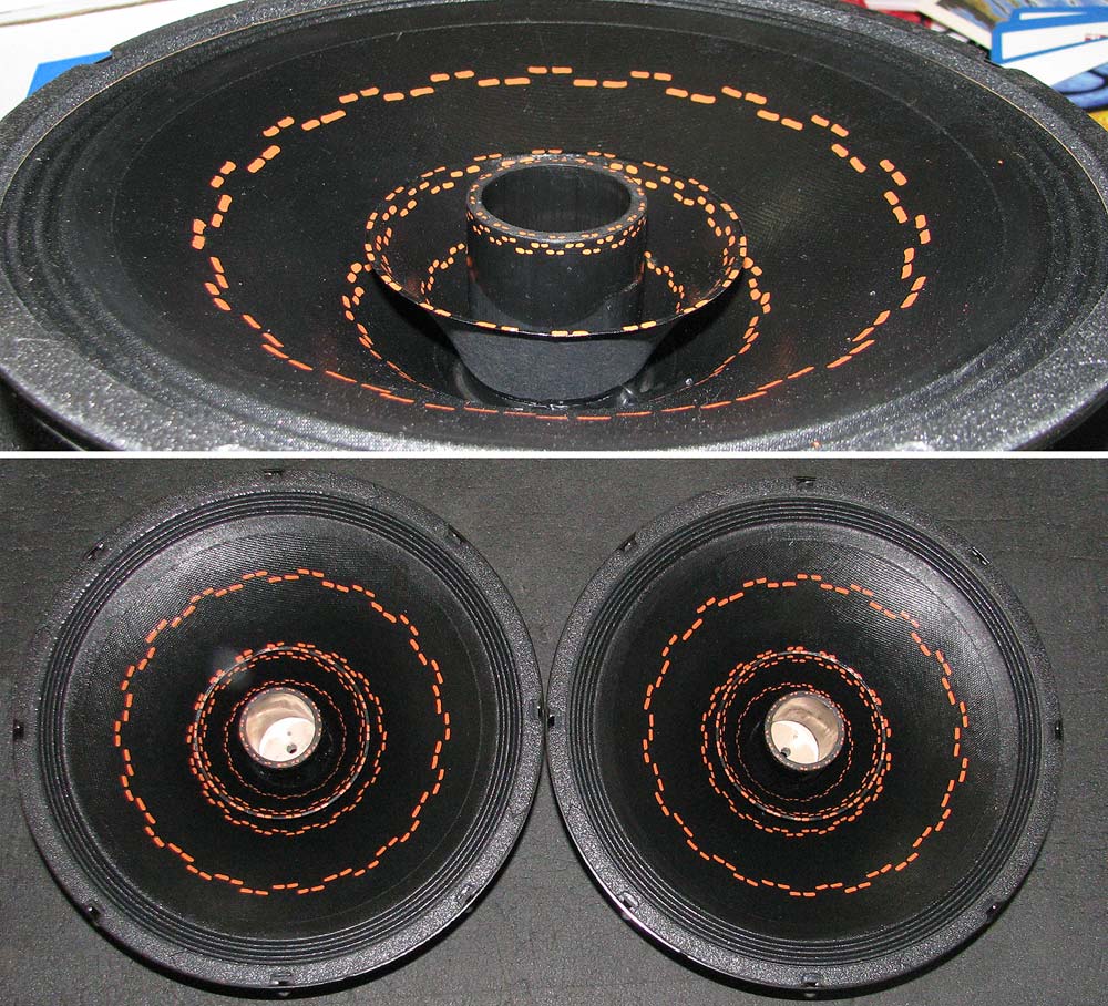

It is a wild driver. Took a lot of work to get them sounding OK. Big jumpp when i finally EnABLed them. You can see ours with th ebig whizzer in the Em-Ken i posted earlier. This one of the newer small whizzers for a customer. Prototype plugs made from plumbing pipe with a block of wood in the end to attach screws to.
