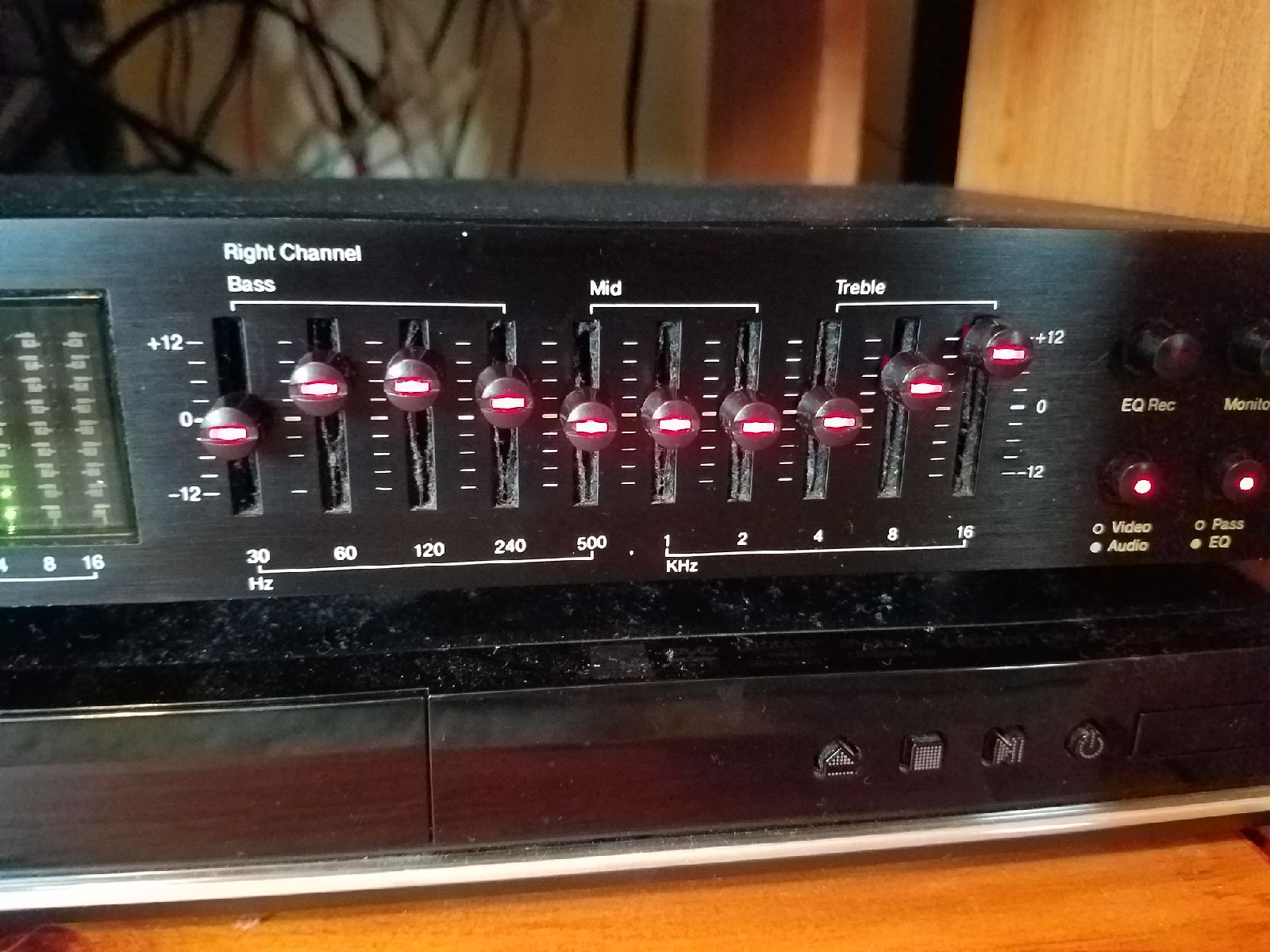

Okay, I had to hook up the equalizer and play around a bit... Searching for the definitive "punch" area. Its a 10 band, so no way to isolate it too much, but still fine enough to get a rough idea. Long story short, it seems to be anywhere from the 30hz band to somewhat of the 240hz band. (Bands are 30, 60, 120, 240, 500, 1k, 2k, 4k, 8k, 16k). Seems centered around the 60-120hz area, but the 30hz adds something, and the 240hz band adds a little too.
Ended up w/ 30hz band toned down so i could crank it up a good bit without the excursion getting out of control. And i did hear some distortion with the lower bands pushed up like that. Highs are up to compensate for there being pretty minimal sparkle.. i don't like a lot of highs, seem to be sensitive to them.
