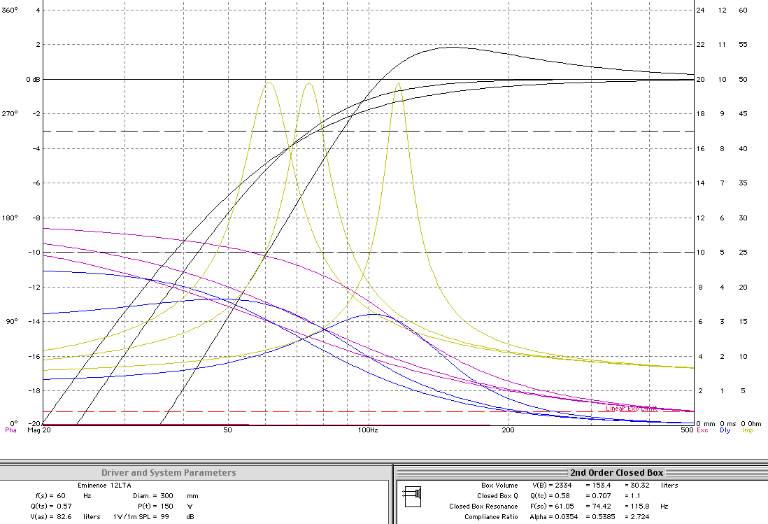

With a sealed box, one can target a Q=0.707 and then use the natural 2nd order rolloff as part of the XO. An additional 2 orders can be added to match a 4th ordr rolloff of the woofers. For the 12LTA — bs\ased on sim — would be 130-150 litre box and an XO just above 80 Hz.

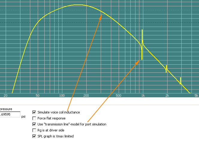

Right all basic T/S box calculators are blended in/done by the effective upper mass corner [fhm = 2*Fs/Qts'], so at best it will also show any rising impedance due to its inductance and IIRC it has to be defaulted to 'on' in WinISD 0.7 [the version you should be using]. Better to switch to at least Hornresp or LA's TL/horn and of course the AkAbak program.
Qts' = Qts + any added series resistance: mh-audio.nl - Home

WinISD is only modeling the LF rolloff. It does no simulation higher up.

Oh... this I did not realize. Thanks, suddenly things make more sense!

Thanks GM, this has been more of a learning curve than anticipated. Not attempting to become an acoustic engineer overnight, but would be rather disappointed if I make something that doesn't sound good! WinISD version 0.44, so apparently I've got an earlier version.. I'll have to look for version 7. I have HornResp but haven't played with it as much as WinISD as it seemed less intuitive. I need to spend more time playing with it.
It can show the effect of inductance, you engage the option 😉

Originally Posted by GM
will also show any rising impedance due to its inductance. actually 0.7.0.950 now 🙂
