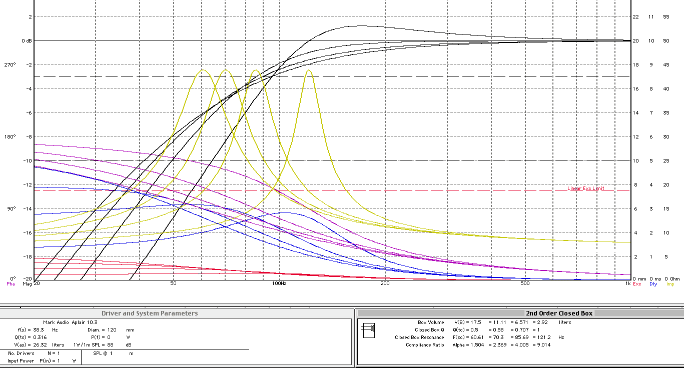

My mental picture of what to build currently looks something like a 15" or 18" in a sealed/slot vented/horn enclosure on the floor for 30-150(?) hz. And with something like a 10.3 Alpair on top in a P10 Onken design, or sealed, or just simple BR, or BIB (except due to its height it probably won't stack well), or other MLTL/TWQT design (still having a hard time seeing how the different enclosures affect the mids/highs) on the top for 150-16,000 hz.
No point in an enclosure that tries to get as musch bass as possible out of th emidtweeter if you are using it 150 Hz up. A simple sealed or aperiodic TL would be better.
I'm concerned that despite their nice freq plots, the smaller FR drivers might sound tinny and small... Is this just not the case?
No. You should check out how many times when people 1st here a set of FH3s people say “i can’t believe that it is only a 4” driver"

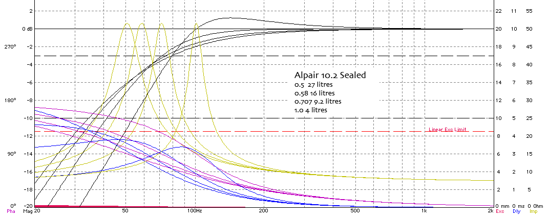

Don't even need a BVR/BLH for the late, lamented EL70, a stereo pair in little MLTLs had my buddies' apartment neighbors wanting to hear his new big woofer party speakers playing DSOTM 😀. A real pity we had no camera........
GM
The EL70 was able to do amazing bass… only surpassed by the Alpair 10.2 (just by a small bit) and the A12pw which is speciafically designed for bass and only extended range.
dave
