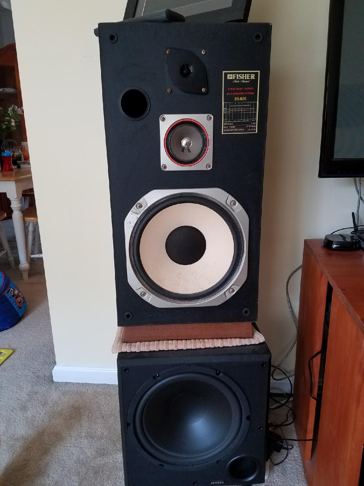

For reference, here's what we're trying to out do in terms of punch and sound quality:
Pretty much any modern, relatively cheap DJ party speaker should suffice and at $500/pr., buying decent used PA is an option, though some active or passive EQ will be required for small room apps.

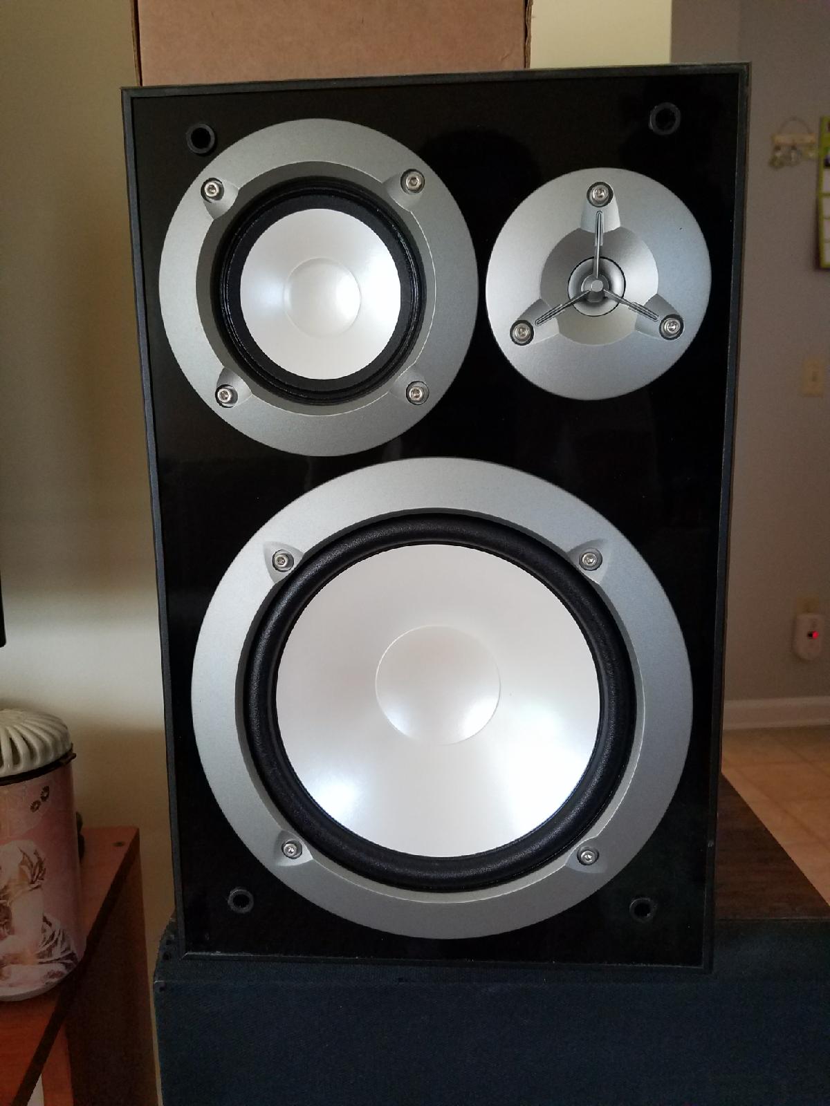

I just hooked a set of Yamaha 3 ways (model NS-6490) for a reference point - they are much crisper and clearer in the mids and highs vs. the Fishers, but get a bit harsh up at the top when you crank it up.
NS-6490 - Specs - Yamaha - United States
And while they seem to get down pretty low for being basically a large bookshelf speaker, don't have the punch that the Fishers do (as expected, given the smaller 8" woofers). There was audible distortion (exceeding xmax I'm guessing) when I cranked them up to 11 side by side with the Fishers (which were not distorting yet).
Somewhat comically, I liked the sound best with a Fisher on one channel and a Yamaha on the other - collectively the sound was pretty balanced, with one speaker making up the deficiencies of the other.
--So I can appreciate the nicer mids and highs of the Yamaha, maybe with the highs toned down just slightly, and with a much bigger woofer for punch.
Thus, what I'm aiming to build is something that would have bigger low end than the Fishers and have the clear mids/highs of the Yamahas (but in a single driver!)
Edit: those yamahas are cheaper than i thought they were, and couple of electrolytic caps on the connection plate is it for crossover duty
Looks like the oft-used Foster horn tweeter — quite decent — a mediocre closed back midrange, and i bet if you pulled the woofer it will have a small magnet which would give a hi Q underdamped tuning with a largish bump 80-160 hz (ie upper bass)

Maybe.. doesn't have a make on the back, looks like cheap plastic junk. Think it came from a cheaper smaller fisher speaker. Mid is indeed a closed back design. And woofer has a pretty modest magnet/motor assembly and feels pretty lightly sprung. But I wasn't planning on reusing any of the Fisher parts, these get moved to garage duty after new ones get built.Looks like the oft-used Foster horn tweeter — quite decent — a mediocre closed back midrange, and i bet if you pulled the woofer it will have a small magnet which would give a hi Q underdamped tuning with a largish bump 80-160 hz (ie upper bass)
